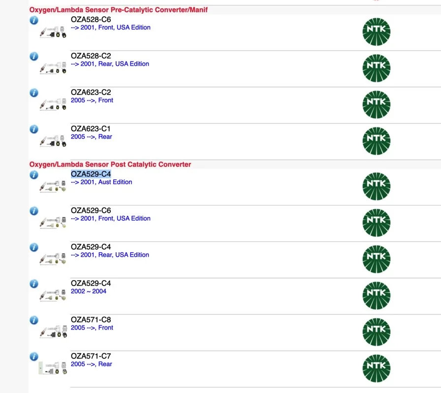

Thats not correct, this is the NTK catalogue for the 4.0 and if you look at the 2005- they are all the same. Just get the ones suggested in the 02 thread from Rockauto.

I bought the USA NTK spec for the 06 but my local jeep repairer over the phone said they were wrong so I wrote to NGK Au and NGK japan , NGK japan just said they were a different code and NGK Au said they are not for export models, I had quite a lengthy thread on them as I couldn't believe they would manufacture different 02,s for export models but I couldn't seem to find an answer other than the AU purchased NGK,s are about 4 times the price of the US NTK,s.
