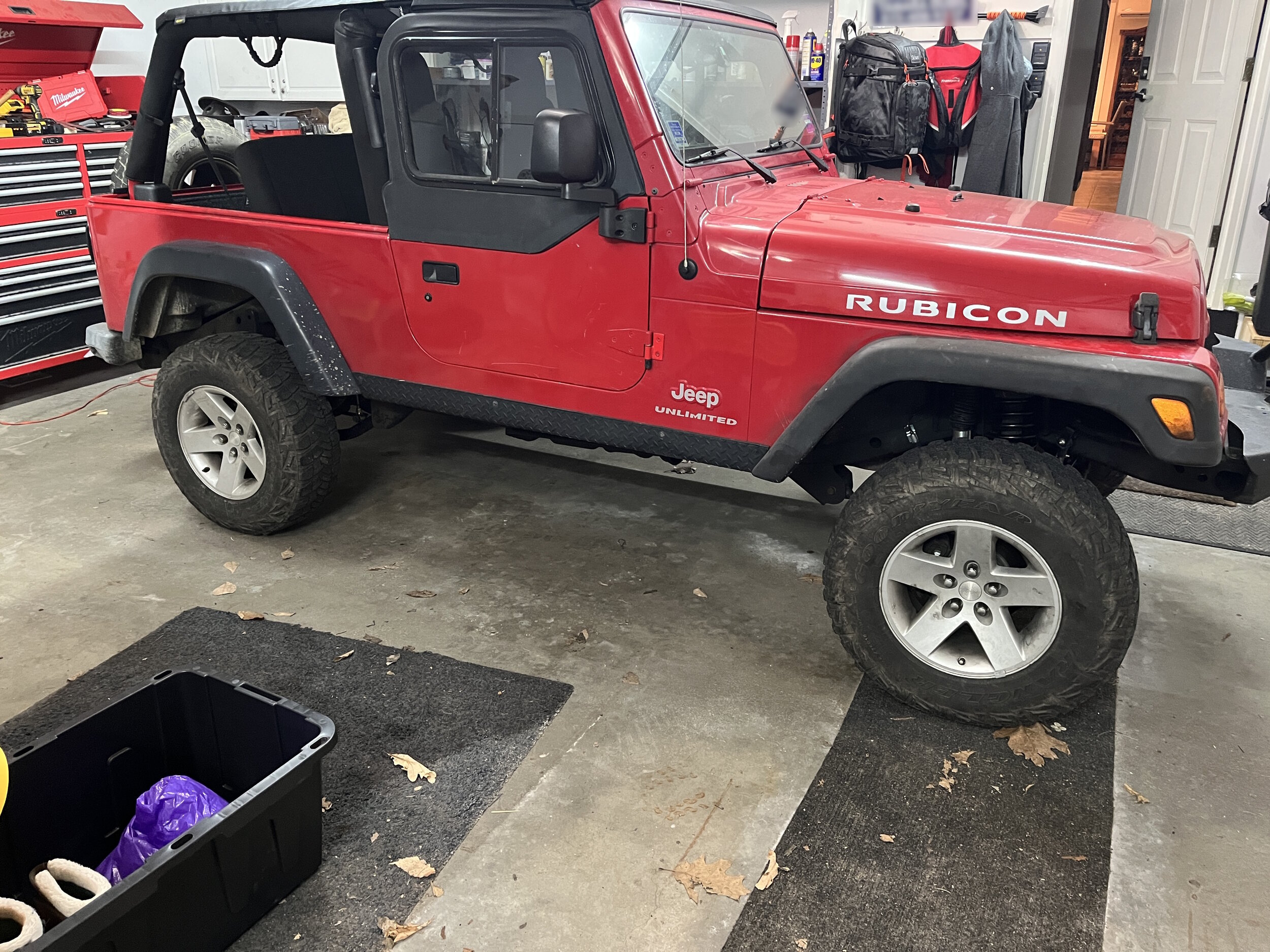

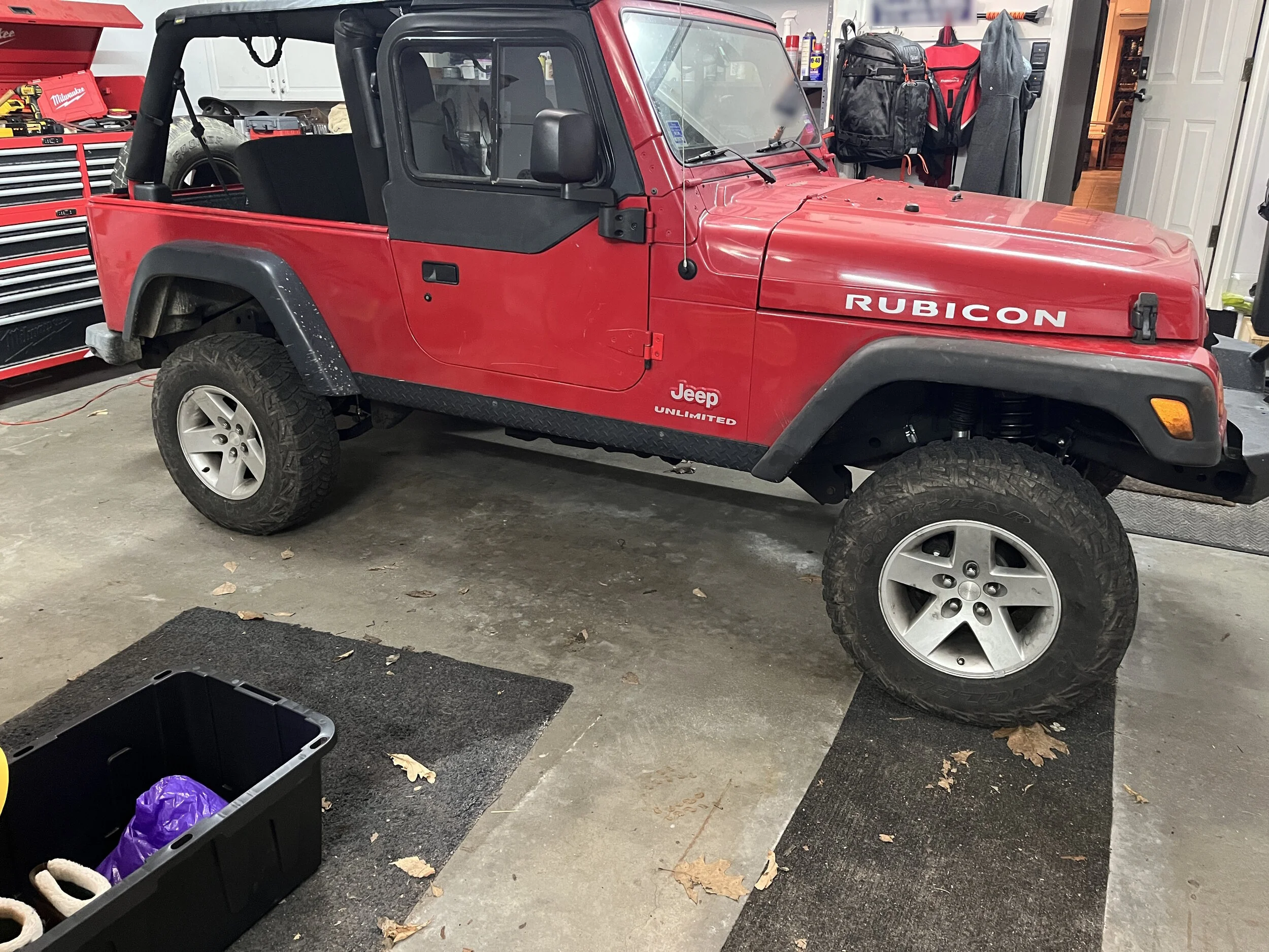

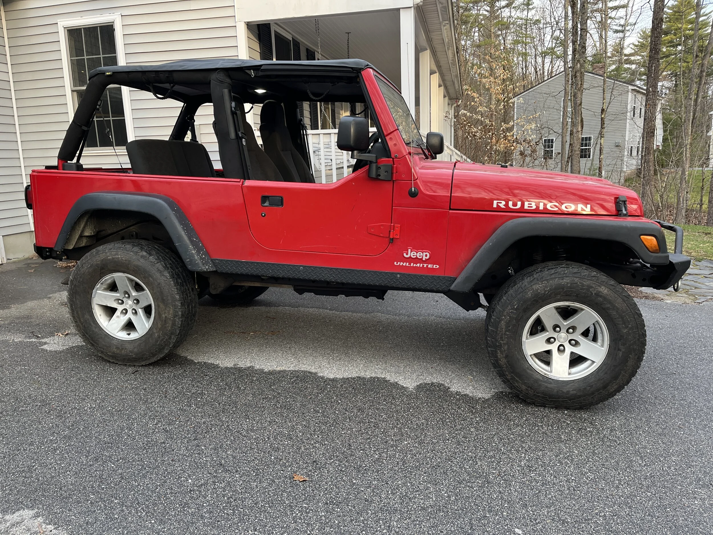

I picked the LJR up early--and it came out great! Parts installed:
  • Rock Jock CE-9132F1P 3" front coils (measured 21")
  • Rock Jock CE-9133RH 2-1/2” rear coils (measured 15-1/2")
  • Bilstein 5100 24-185287 front shocks
  • Bilstein 5100 24-185264 rear shocks
  • Core 4x4 adjustable control arms
  • JKS JKSOGS151 adjustable rear track bar
  • JKS JKSOGS128 adjustable HD front track bar
  • JKS-2001 Quicker Sway Bar Disconnects (front)
  • JKS-2942 Adjustable Sway Bar Links (rear)
I got it up to 65 mph on the way home, no wobbles to speak of. That mildly unbalanced tire up front must have gotten swapped to the back, because the 55 mph shimmy is gone.
I have a set of Falken Rocky Mountain ATS II tires in 285/75-R16 and 1.25" Spidertrax spacers ready to go on the Moabs... it's looking pretty anemic on the bottom with the stock tires.
It's level, still a little rake, but better than it was. I'm going to get a full-sized spare on the back and install the rear bumper... then maybe cut down the stock front bumper to a stubby and install the winch on that, so I'll see how it sits after that stuff. (measurements taken at the fender flares)

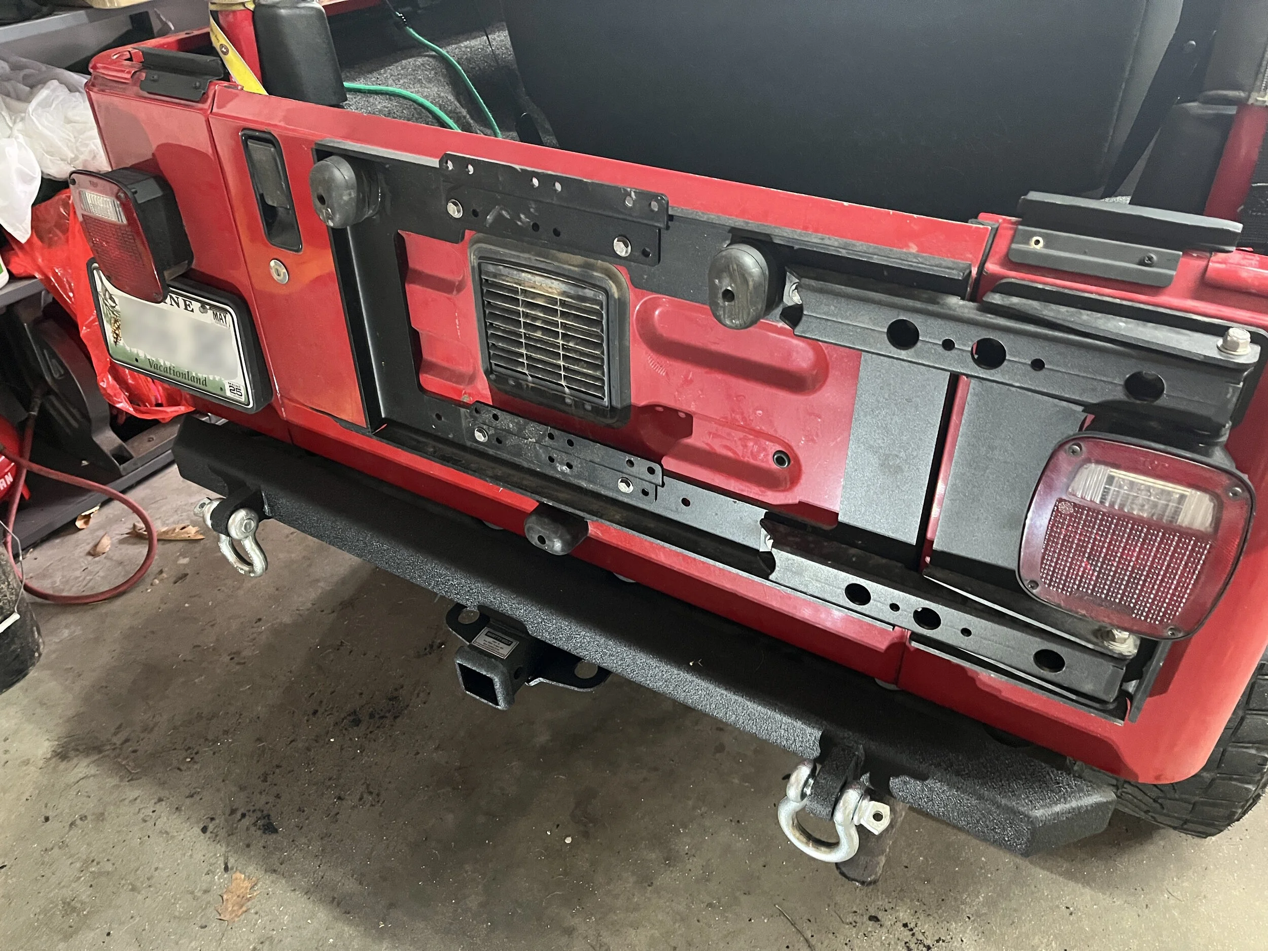

I removed the OE bumper and tow receiver this afternoon. "Removed" involved an angle grinder and some grunting. The Smittybilt bumper went on easily enough without help, but I cross-threaded one of the lower bolt holes. I have it tacked in place with four horizontal bolts and one vertical; I'll need to run a tap through the other vertical hole, and I'm only waiting for the paint to dry on the new holes in the crossmember to install the remaining four horizontal bolts.
Much to my surprise, I couldn't get the bumper on until I removed the stock spare... so, I removed the carrier and added the MorRyde offset brackets. I don't have a full-size spare yet, but as soon as I do I'll see how it fits up.
Shout out to @Just.Thorne71 for the info on the Barnes rear bumper tie-in brackets. Those will get installed as soon as they arrive and I get them powdercoated.
Noodling on this a bit… my OEM carrier is rusty. It’s not beyond repair, but I do have this shiny new JK-patterned carrier that came with the MorRyde hinge/reinforcement kit.
I really don’t want to space the spare out even farther from the tailgate. I’d like to mount it so it rests on the bumper. And it’s always bothered me a little that the spare is off-center... mainly because I want to fit a camera to it. So, what I might do is grind the studs off of the JK carrier and either bolt or weld a plate to its face, then install 3 studs spaced 5x4.5. That should let me position the spare where I want it while keeping it tight to the tailgate.
EDIT: it’s got to clear the inside of the wheel….

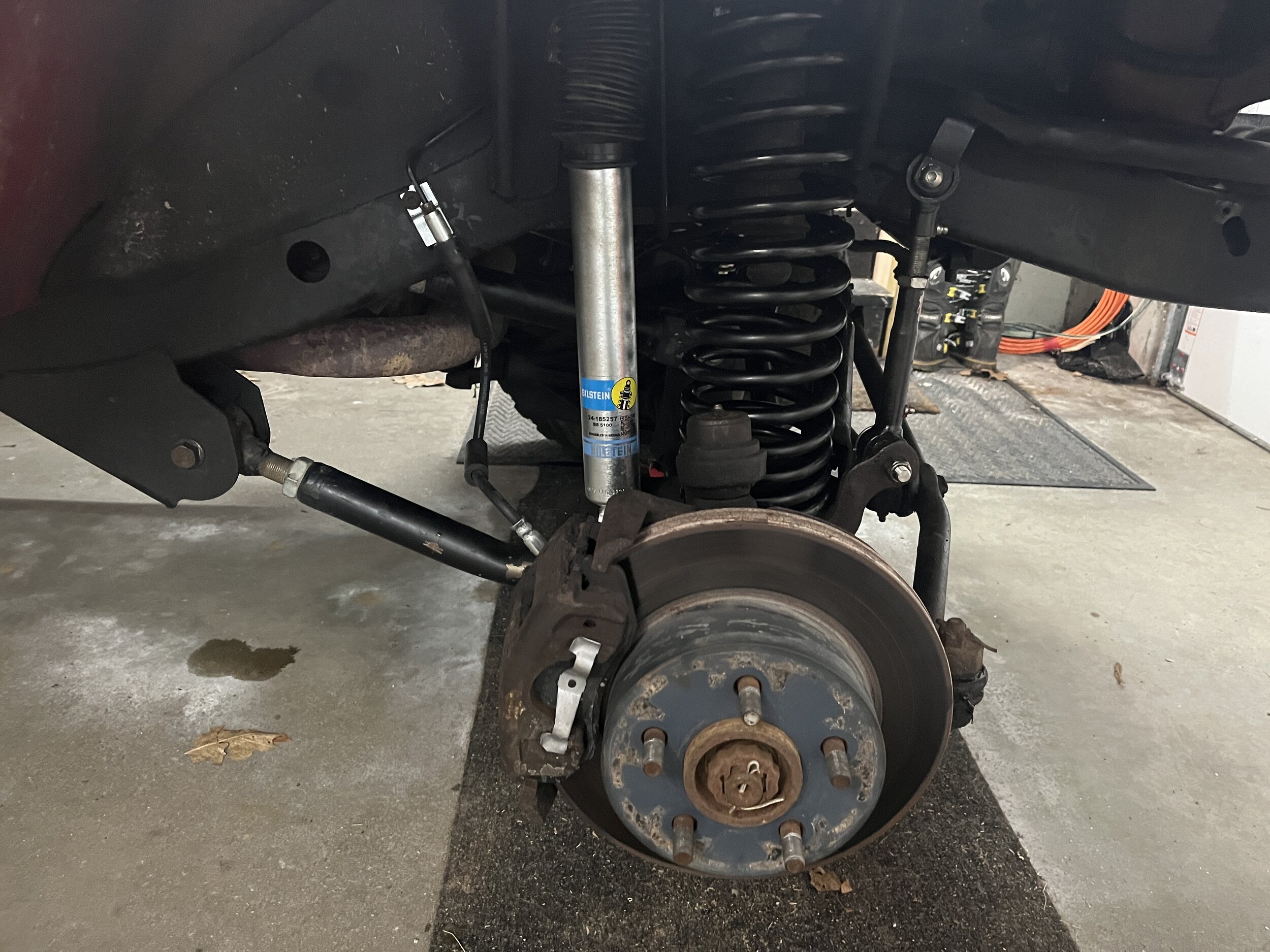

I pulled off both passenger-side wheels to get tires mounted tomorrow. I only have two jack stands, but my local shop is 5 minutes away and will just be doing them between jobs anyway. I'll have to make 4 trips (drop/pickup/drop/pickup).

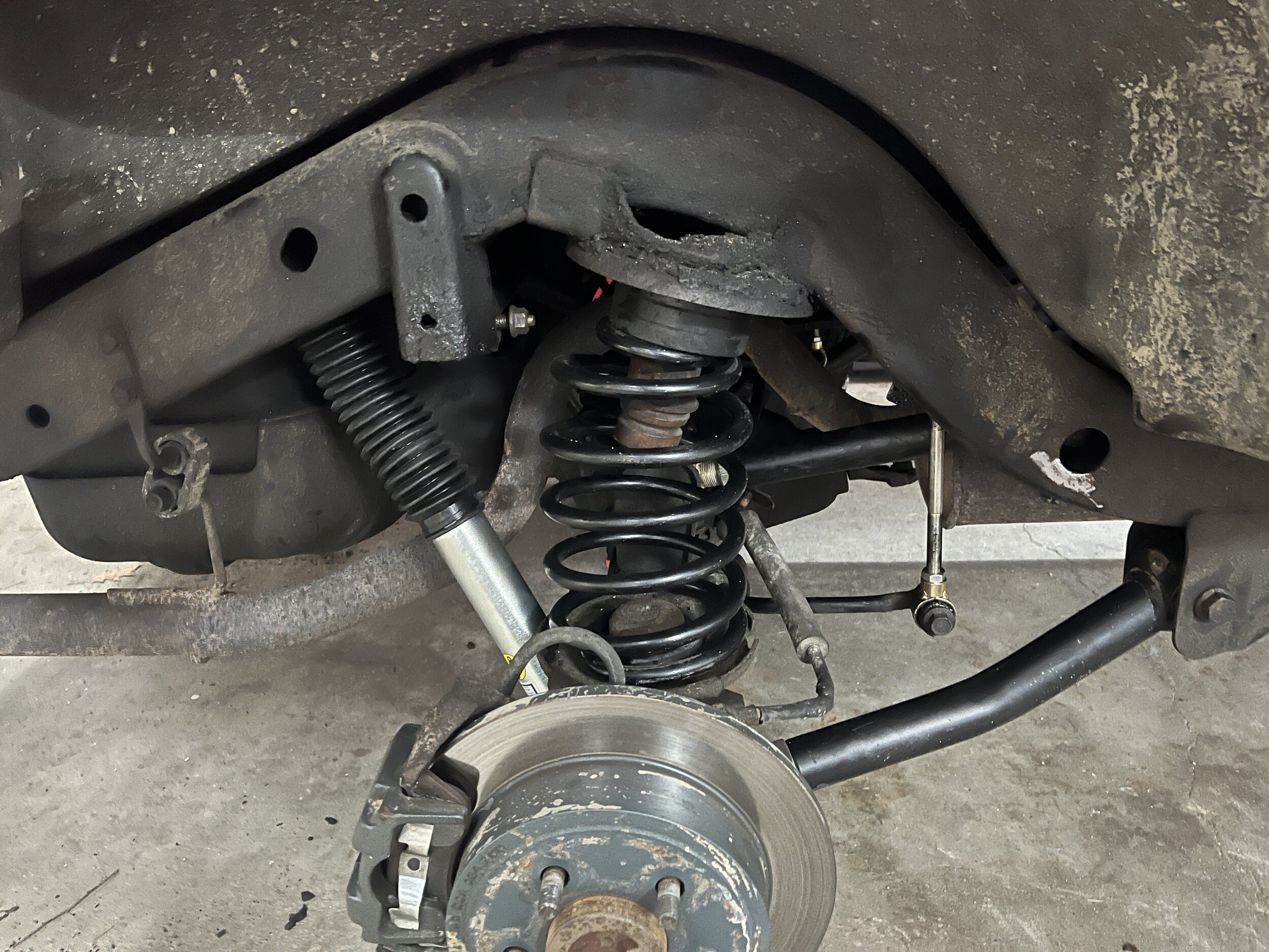

Rear spring looking alright as is? I haven't checked it's full travel yet. I'm trying to set aside some time to put on the MML/BL, and then I can set my bump stops.

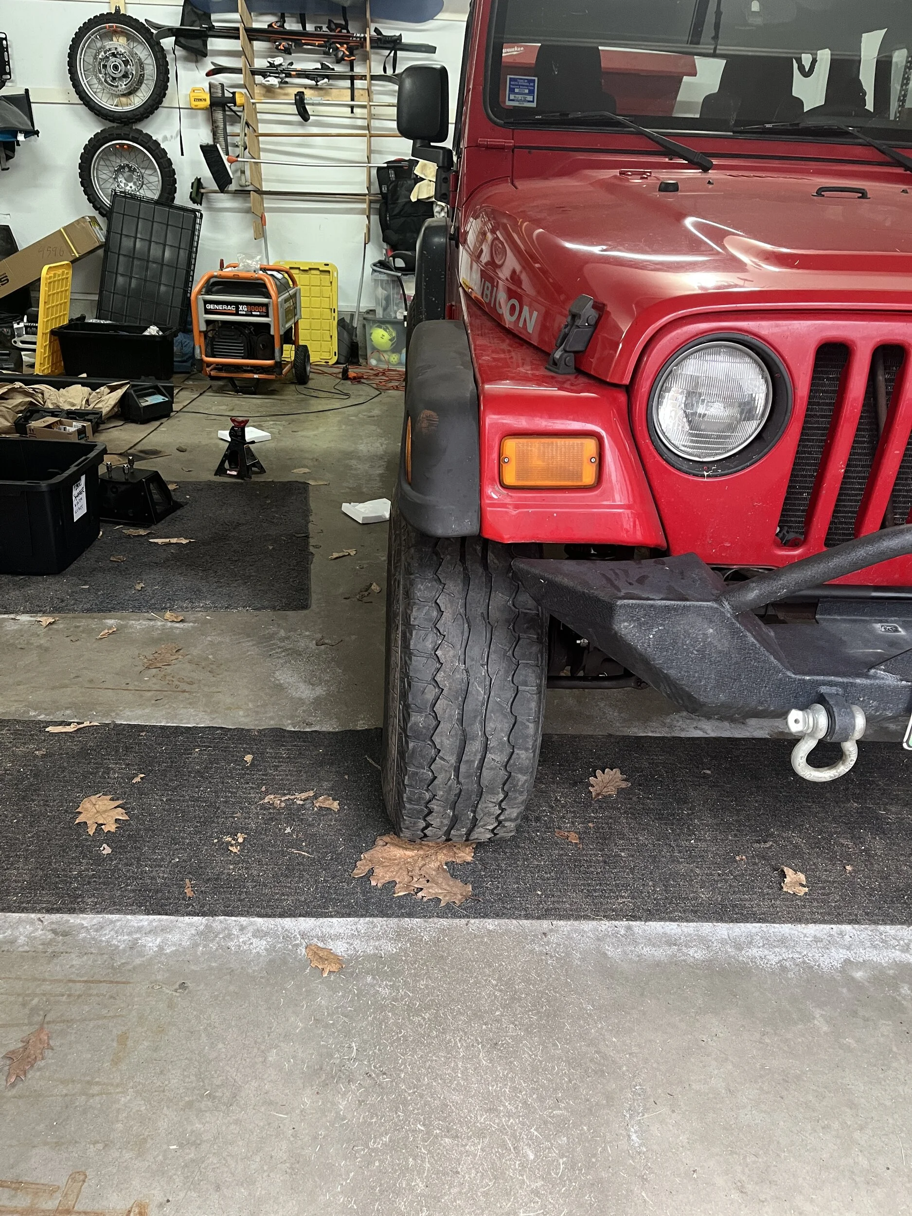

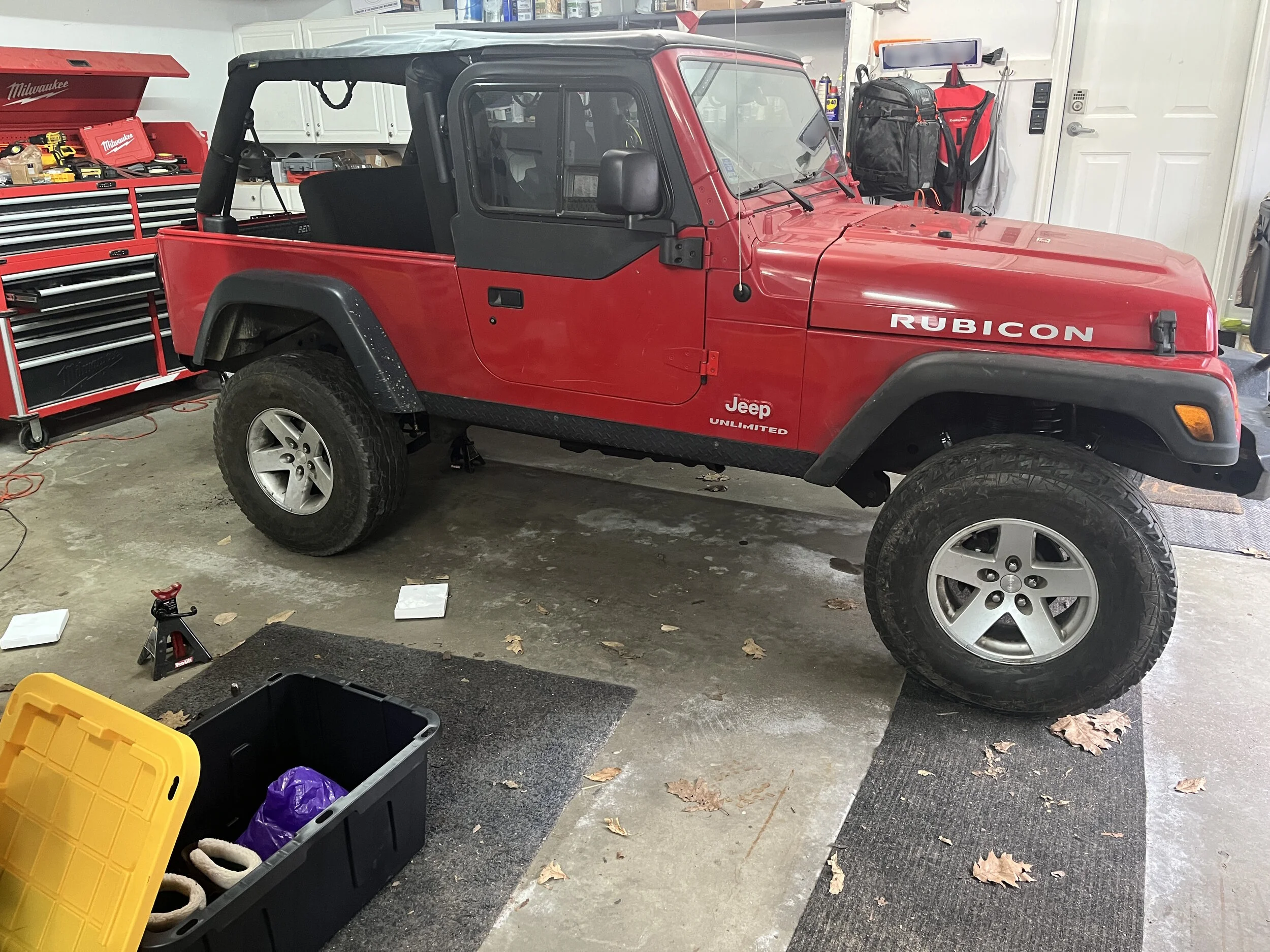

I installed three 285/75/16 tires today! I did not install the 1.25" spacers. I want to see if I can pass state inspection either with the OEM Rubicon flares or with the KBD flares that are inbound. And, I want to see if/where they'll rub.
I know the suspension will settle a bit, but look at all that room! I haven't even put on the BL yet. It makes me wonder if I should consider 35" tires next year.
I get the last tire mounted tomorrow and it'll finally be back on the road. It's been a long week.
