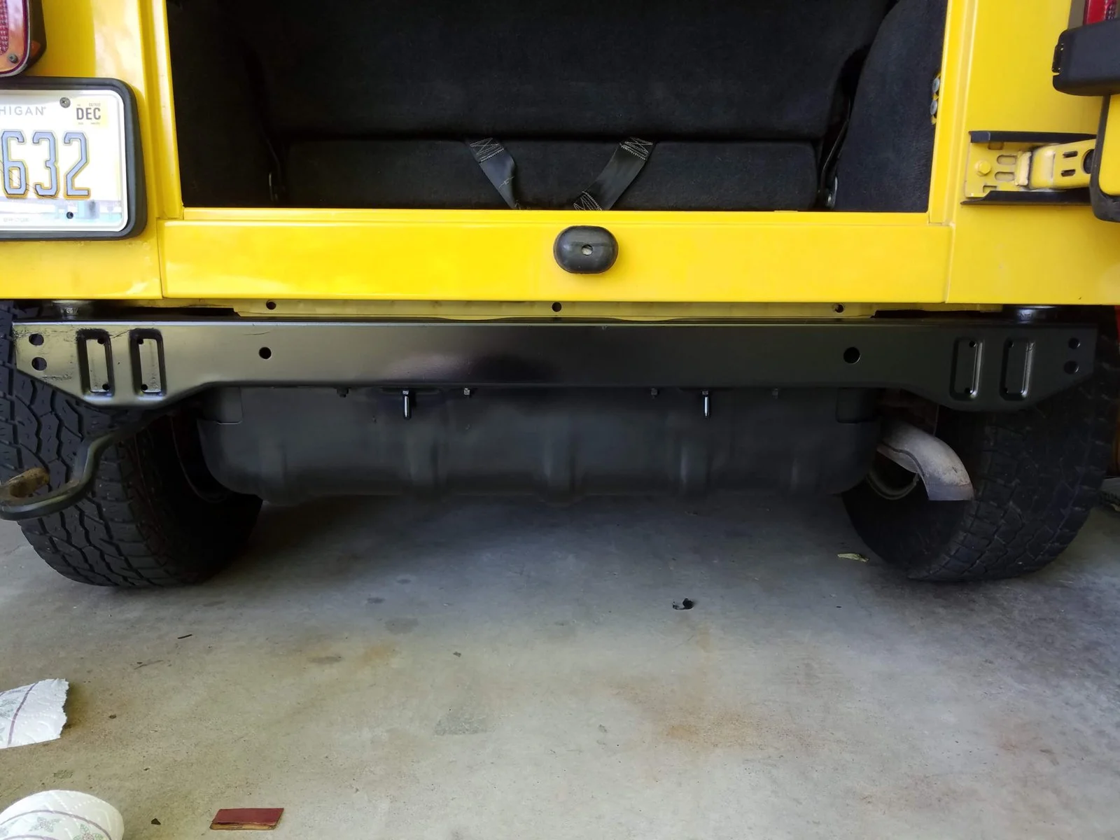

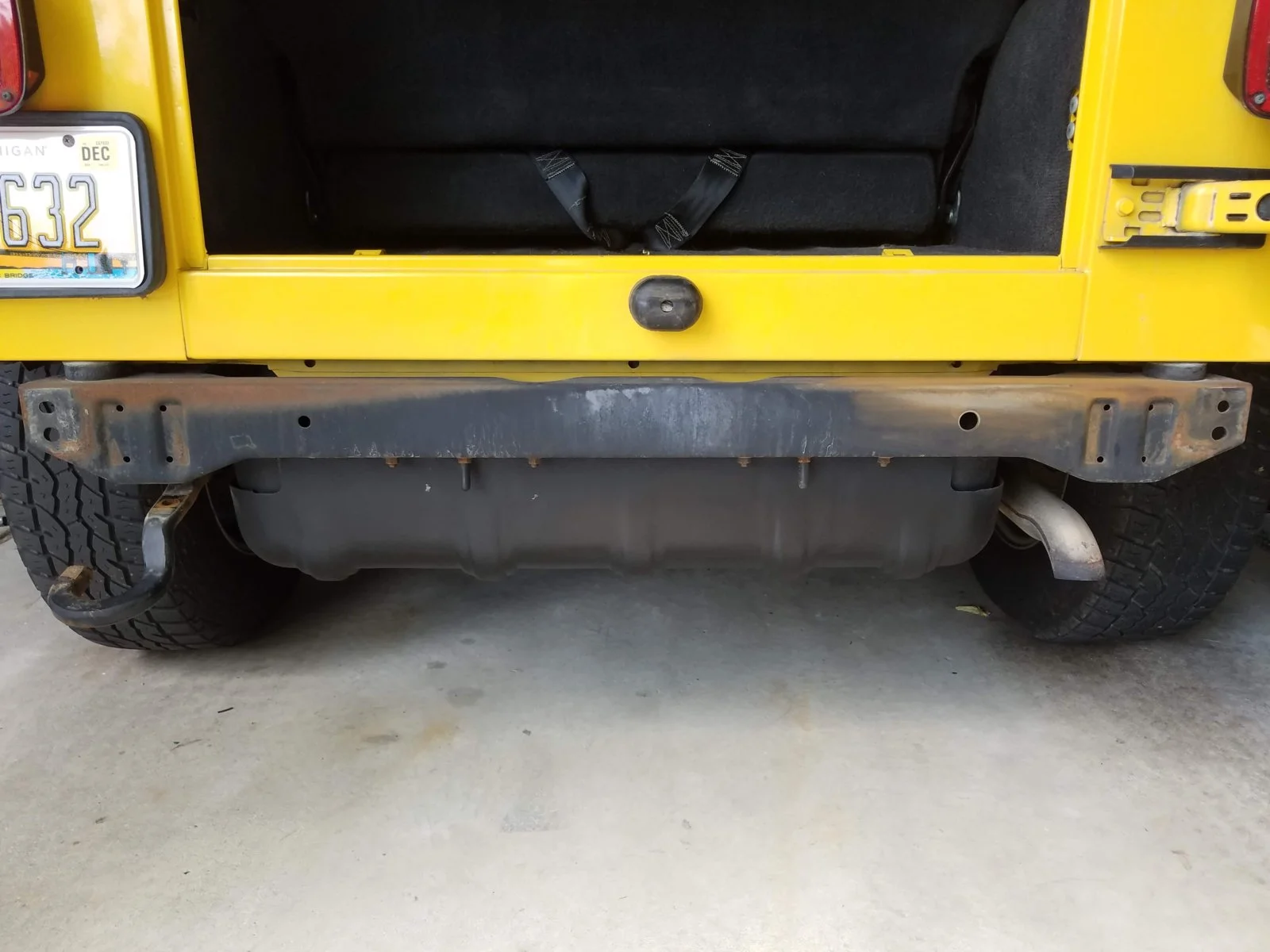

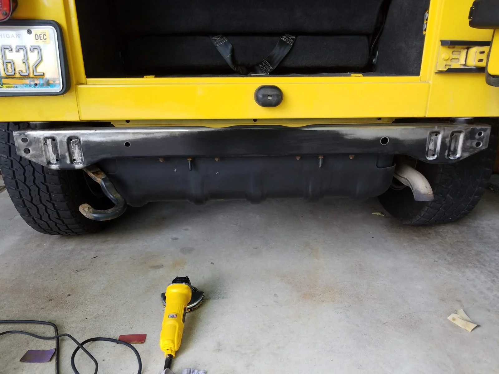

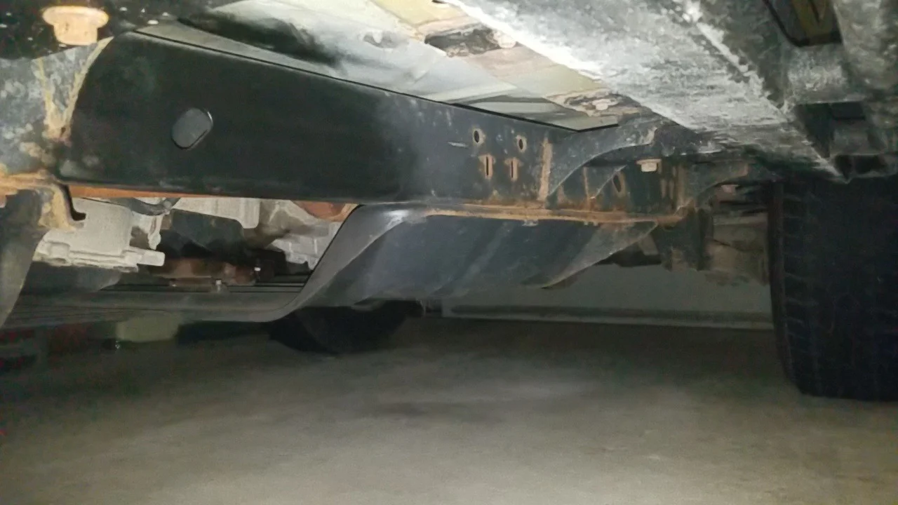

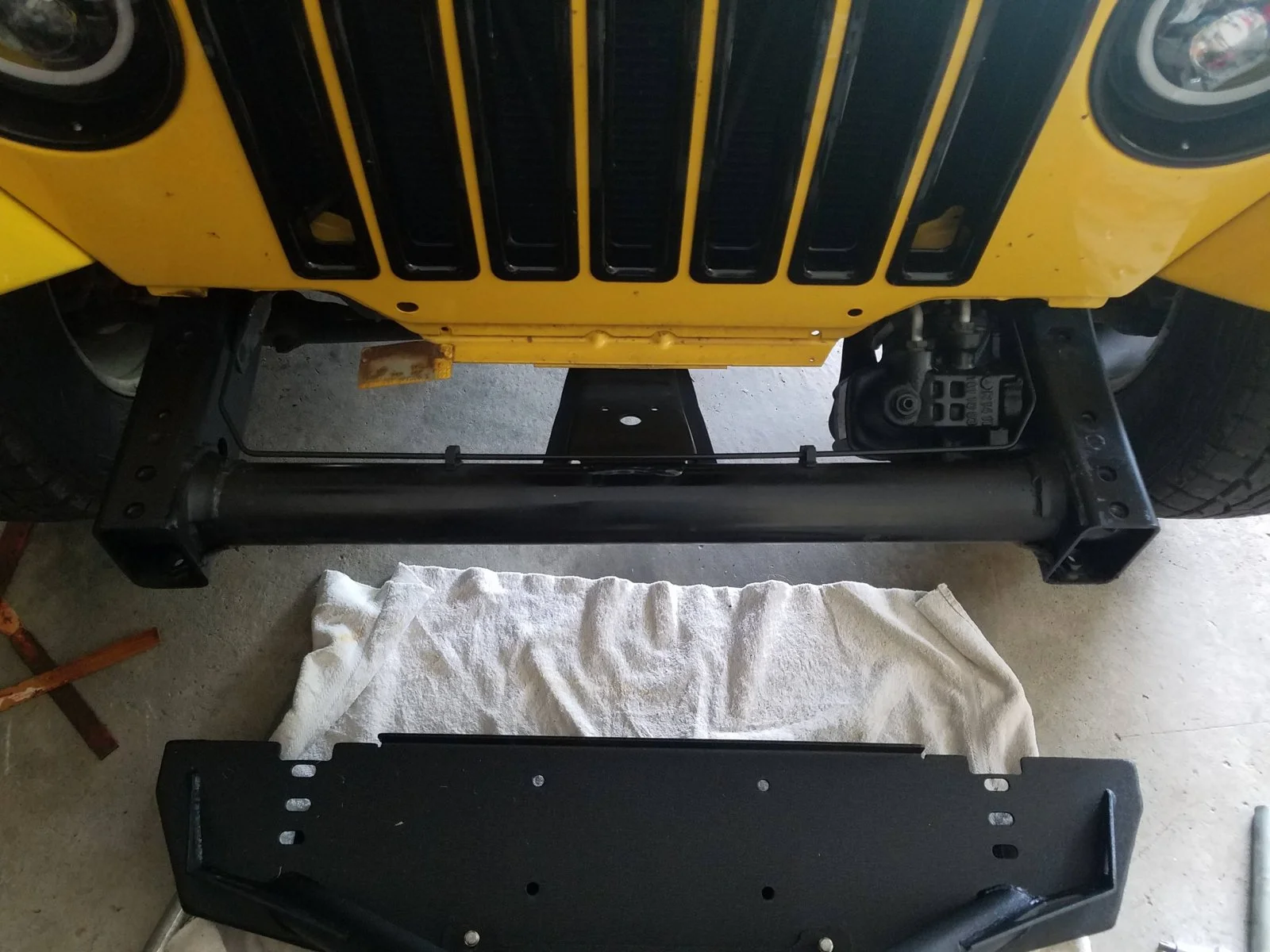

In the process of installing a new front bumper and wanting to paint the OEM rear bumper I wanted to get rid of some surface rust. The front was only a few specs around the screw holes, but the rear was obviously worse. I actually thought there might be some bad damage inside the frame. Upon inspection it seems it's all exterior and the interior is still nice and smooth. I'm stilling planning a weekend this summer to coat the inside of my frame as it's in excellent shape and I want to keep it that way. Anyway, enjoy a few photos of sanding, grinding, prepping, and painting.
You can also sort of see a few new things I put on. I'll update all of that once the installations are *fully* complete.

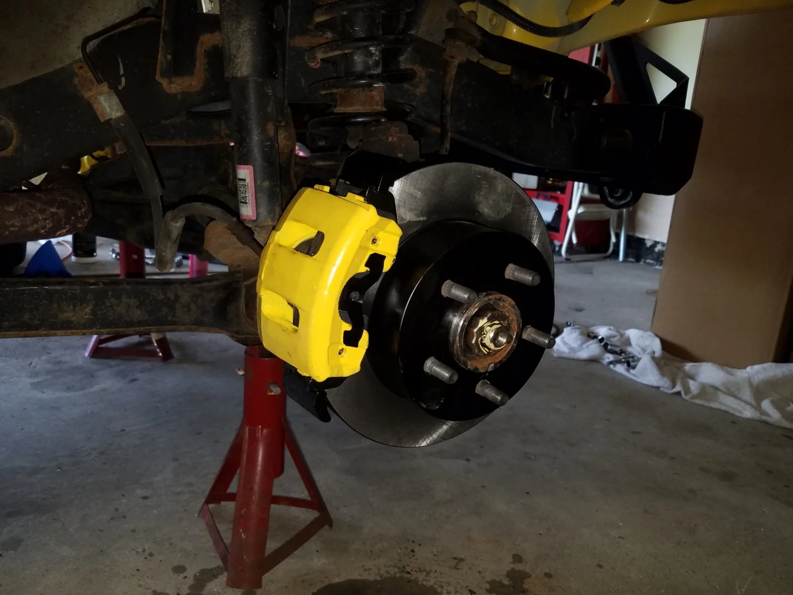

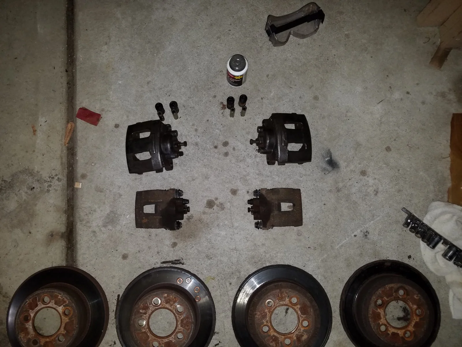

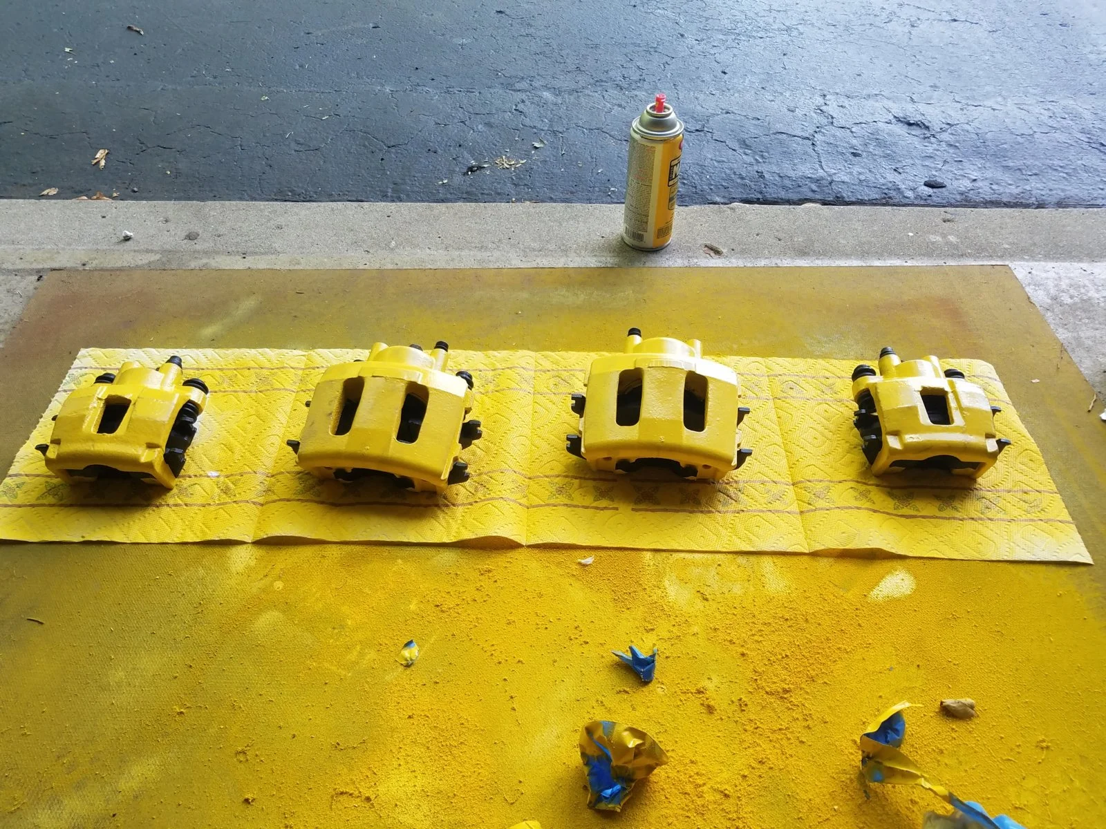

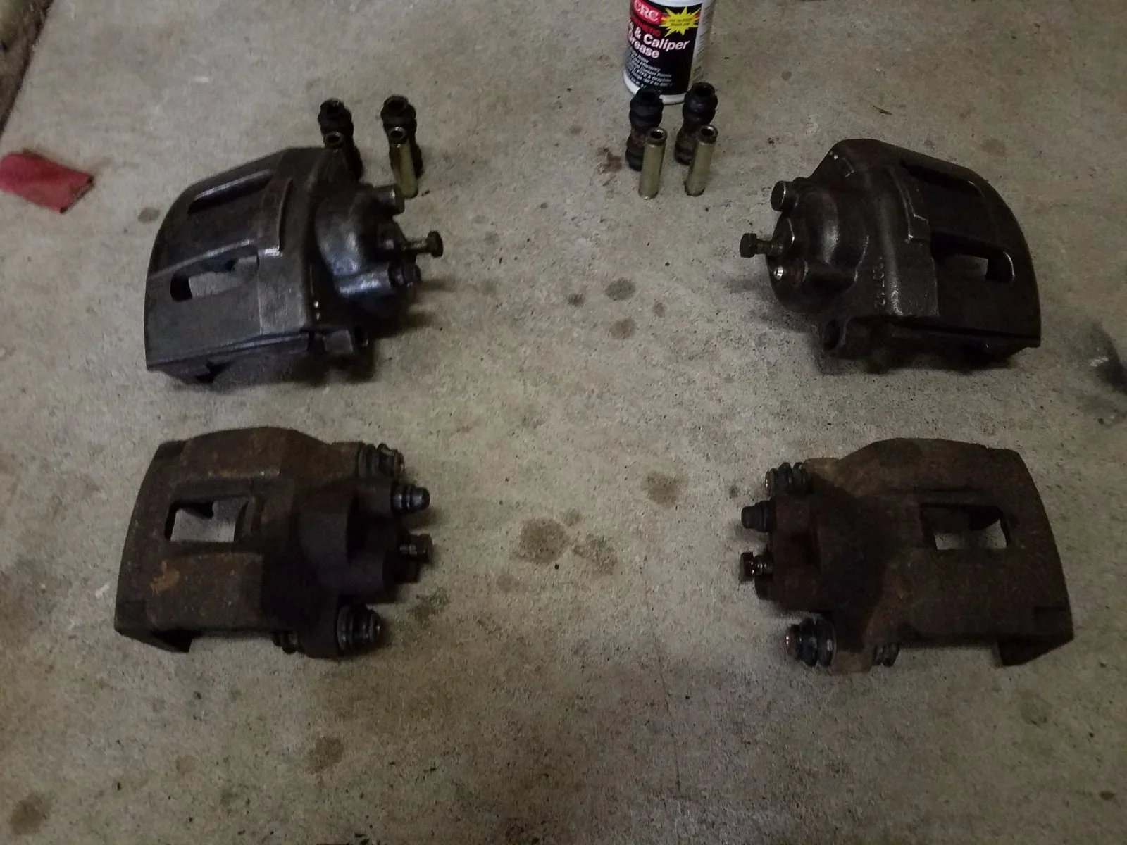

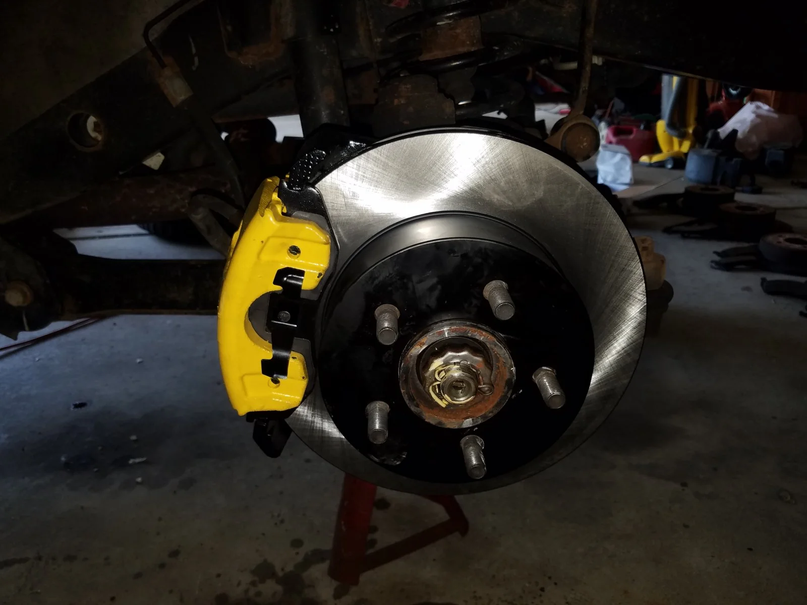

Boy oh boy was today somewhat of a mess. I've spent the last few days sanding, prepping and painting my calipers to similarly match my body color. I also installed my BM pads and Centric rotors. Well, during the break in procedure apparently my driver side front caliper was sticking and eventually heated up the caliper enough to ruin the paint. I still don't understand how I didn't feel this happening...or why it even happened. On the bright side I replaced the slide pins, bolts, and boots and everything works again. Which is odd because nothing seemed wrong with the pieces I had before. Oh well, just another reason why I don't plan on doing too many more paint jobs. Looks great but just isn't a functional mod.
Also, the stopping power is ridiculous. I have 31s and the tires lock right up when I press hard on the brakes. Very happy with these brakes.
Every oil change I clean my brakes, I pull out the two pins with the rubber boot and clean it with a 2,000 grit sand, then stroke them with grease inside the assembly until I can slide it freely with my fingers.
I'm probably going to start doing today now. The pins slid pretty easily when I first installed them, so I assumed they were still good. The only thing I can think of is there might've been too much grease on the outside of the boot and it slipped off.

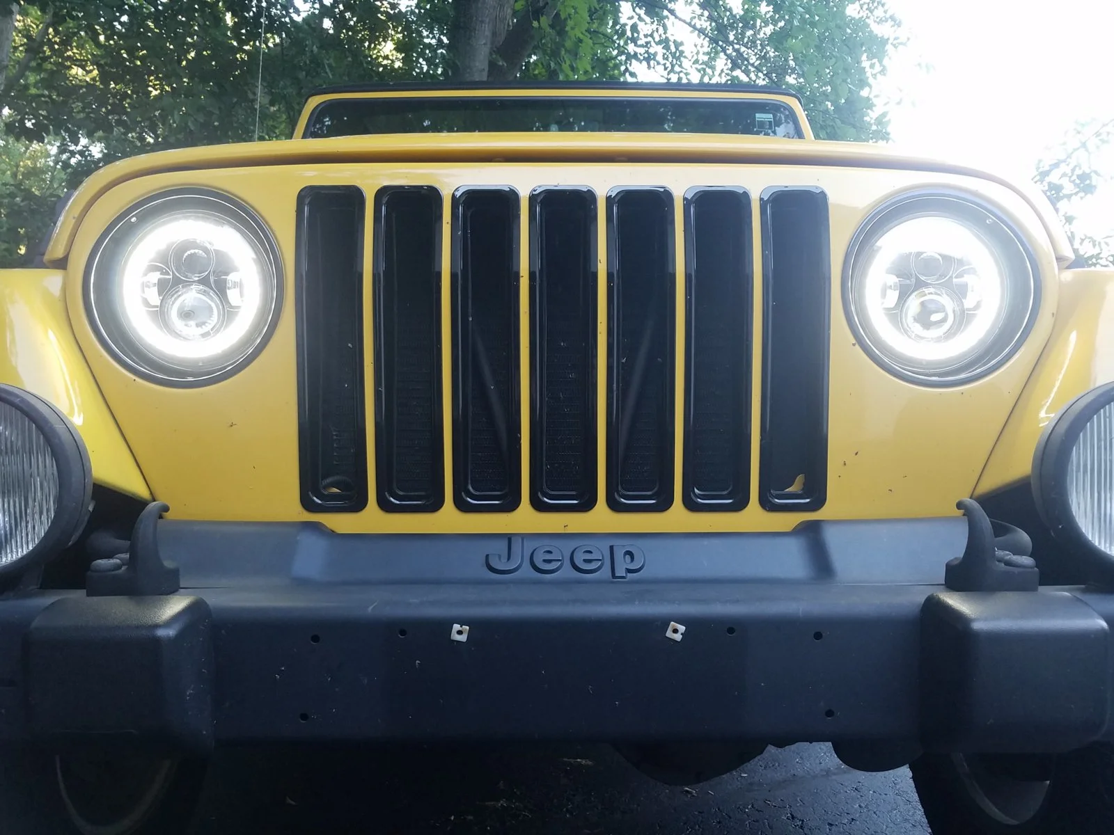

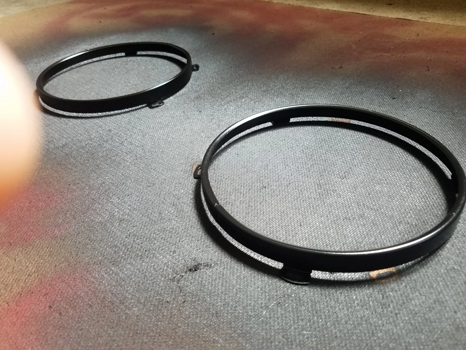

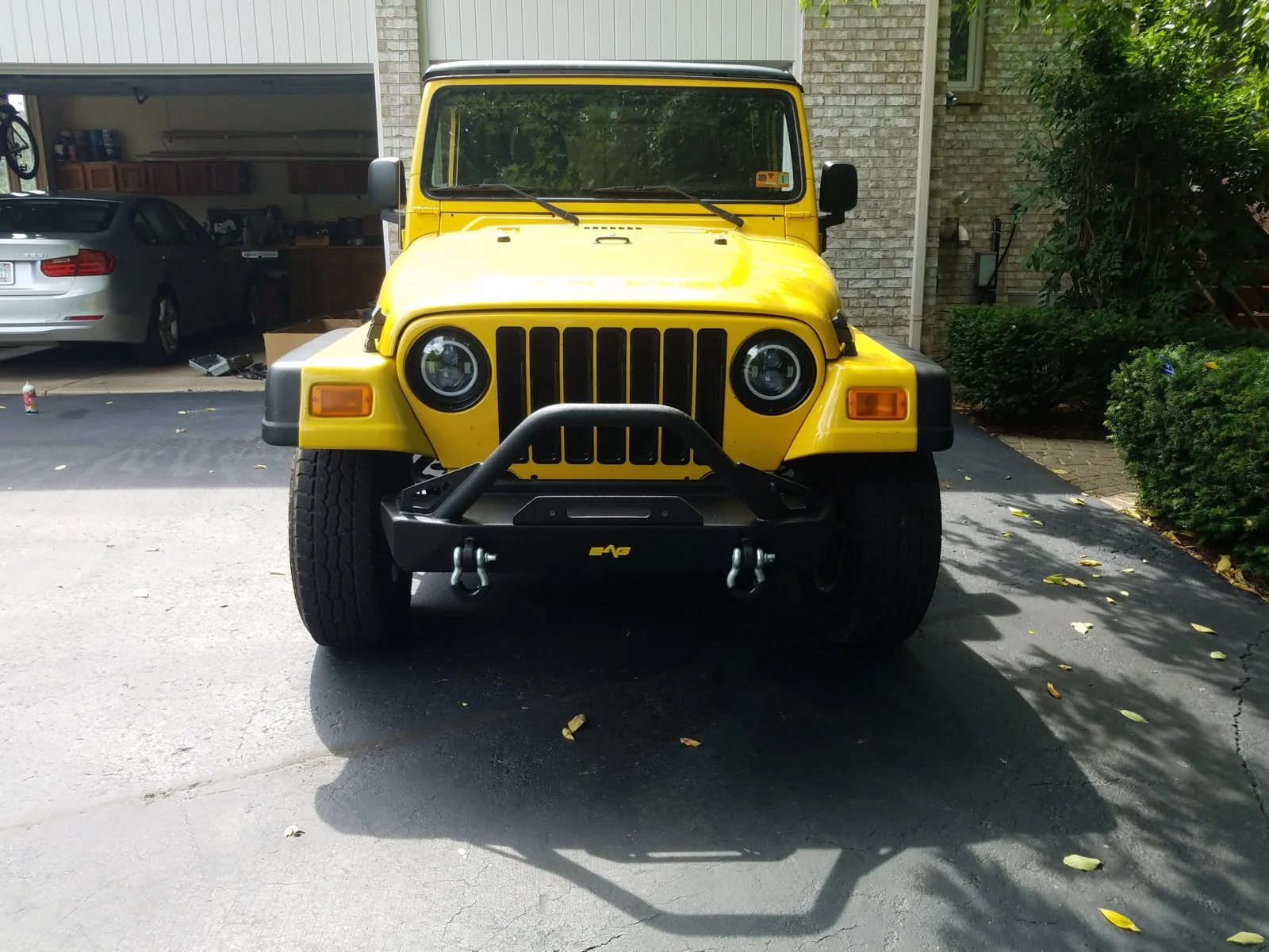

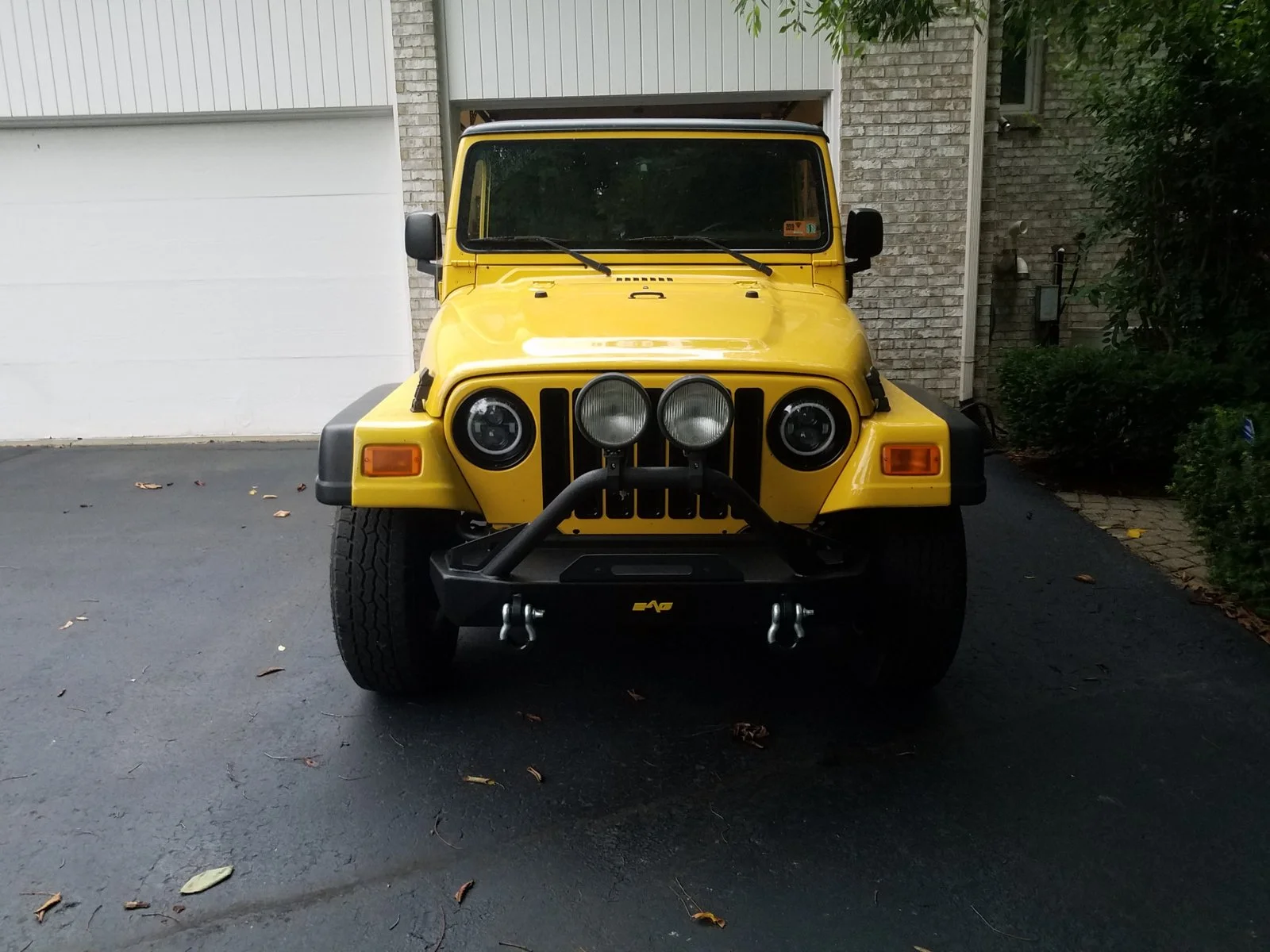

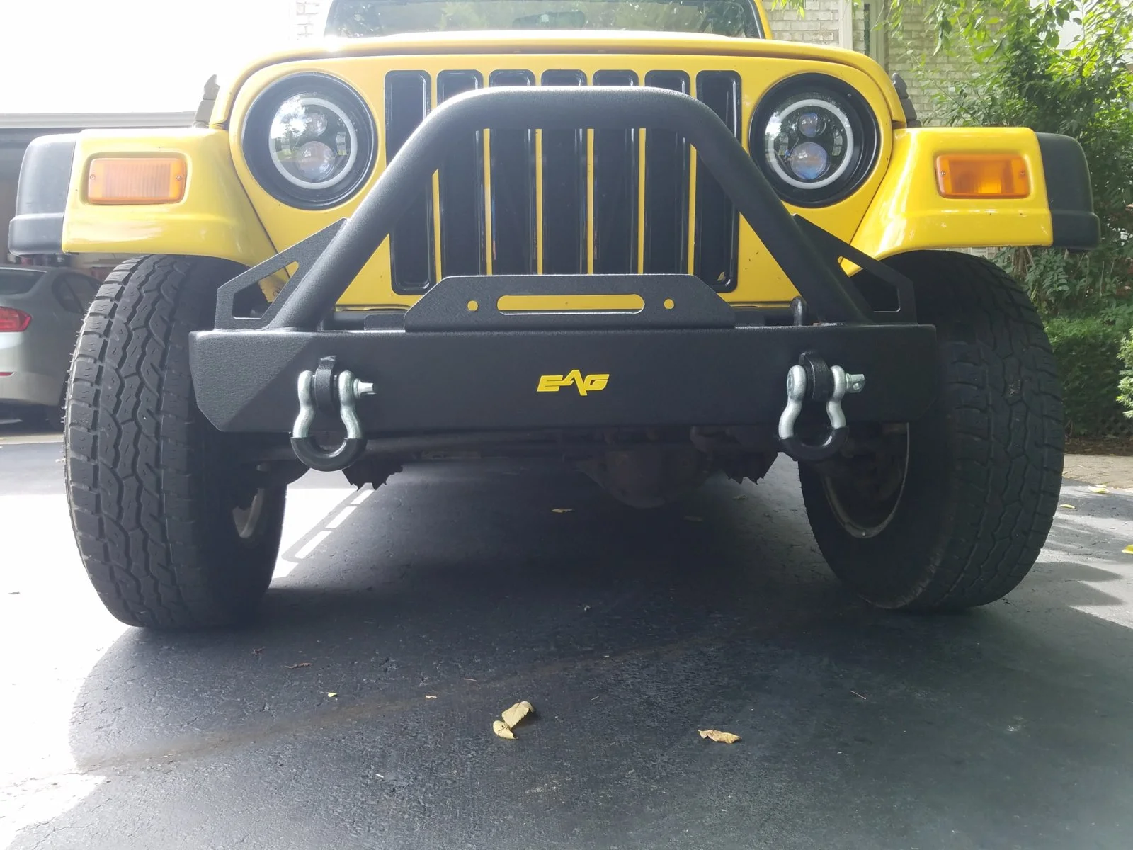

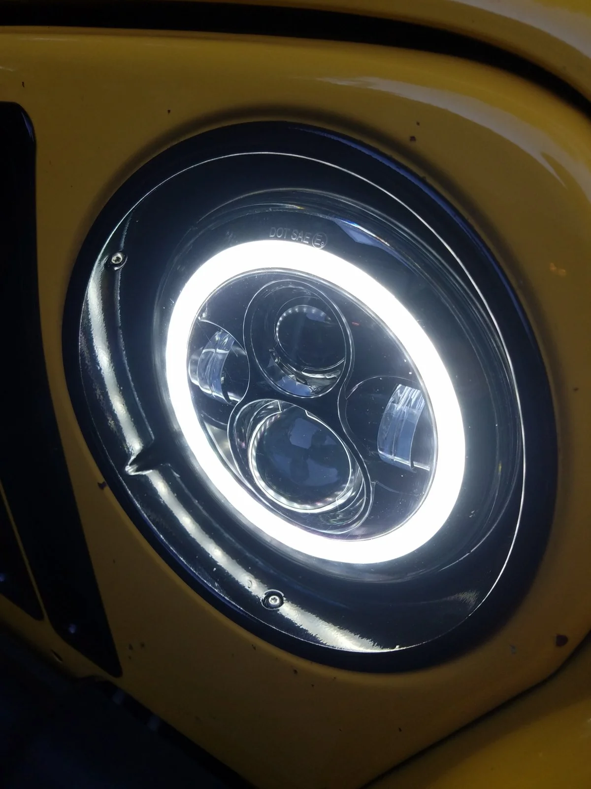

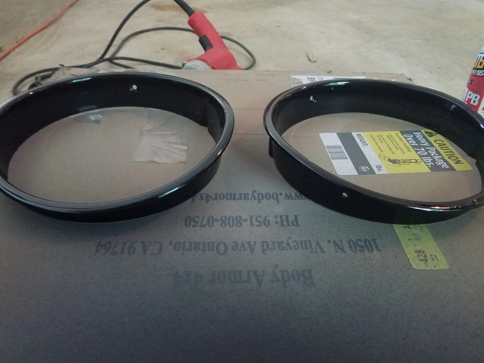

Today went a lot better. I painted the headlight bezels, headlight retaining clip, installed some new cheap LED headlights, got the front bumper installed, and put in some black grill inserts.
Jeep Wrangler Headlights 7 Inch Round... https://www.amazon.com/dp/B01DLLAJOQ/?tag=wranglerorg-20
I know, I know. It has a Halo ring. I actually really like the look of it. And what's cool is I wired up the halos to the factory parking lights switch, so no awkwardly placed switches.
EAG 97-06 Jeep Wranngler TJ Grille... https://www.amazon.com/dp/B00YRO2PWQ/?tag=wranglerorg-20
I liked the gloss finish of these, and they just pop in. No need for 3M tape.
EAG 87-06 Jeep Wrangler TJ/YJ Front Bumper With D-Rings https://www.amazon.com/dp/B0797T1XQ6/?tag=wranglerorg-20
I actually bought this off eBay for a reduced rate, but here's the link for Amazon.

Corossion resistance is a must where I live. Michigan isn't kind to normal cars, let alone TJs. I'm happy with the shape of my frames integrity. There's really only surface rust on most portions and the inside is rather clean. Probably going to buy a cheap daily driver before the winter hits and there's piles of salt at every street corner.
Put some Fluid Film on it too. Or even better, take a wire wheel to the surface rust areas, get it all off, and then re-paint it with some black paint. Good as new!
But yeah, if I lived where you live, I would NOT drive my TJ in the Winter, not a chance. That salt just destroys things in short order.
I actually spent a little time last week with the angle grinder with a wire brush and cleaned a portion of the frame to respray. Most of the rust is on the welds and machine cut holes. I'll definitely look into fluid film! I'm thinking of doing Eastwood internal frame paint in the next few weeks.
The Eastwood stuff works great as well. Paint the inside of the frame with that stuff, and the outside with Fluid Film, after you use the wire wheel of course. That should make it last as long as you live at least!

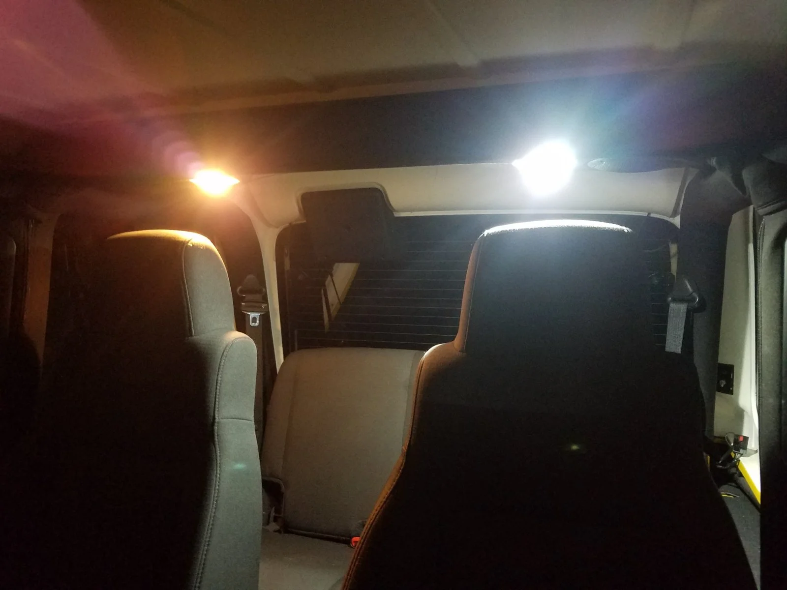

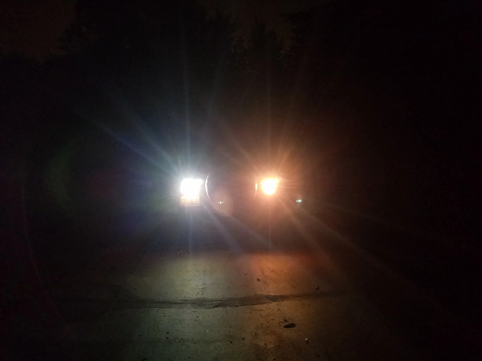

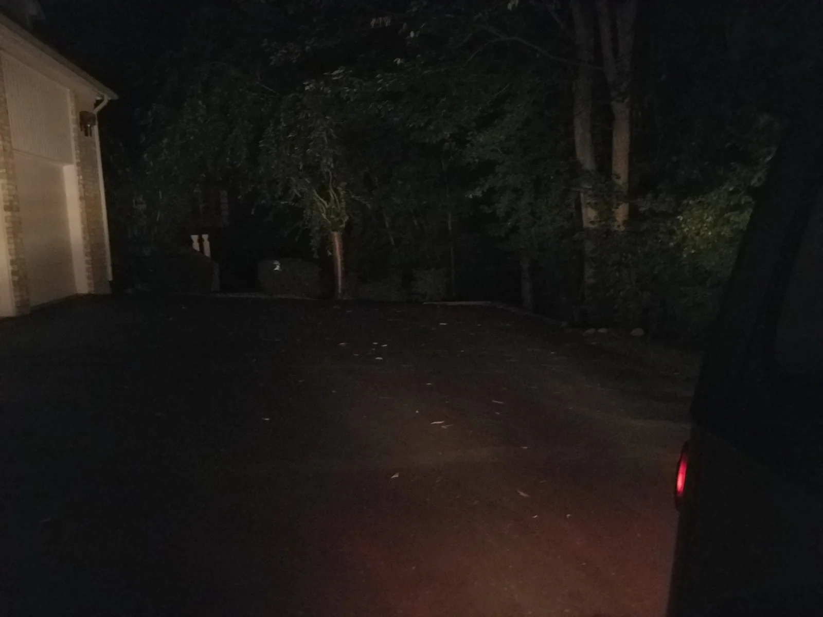

Decided that the factory reverse lights and sound bar lights were just not bright enough for me. Replaced them with some nice LEDs.
1156 Reverse Light Bulbs,AUXITO 1400... https://www.amazon.com/dp/B077PTTG18/?tag=wranglerorg-20
LUYED 2 X 570 Lumens Super Bright... https://www.amazon.com/dp/B0177DD3E2/?tag=wranglerorg-20
Happy with both. They definitely emit more light than stock.
On a side note, I don't know how I feel about the factory fog lamps mounted where they are now. The OEM fog lights just feel too large in my opinion.
Also looking to replace my parking lamp / brake light bulbs to be brighter LEDs. I'd prefer people really tell when I press on my brakes. When I'm following TJs I somewhat feel that brake light needs to be brighter, especially when someone has a slight layer of dust/mud on them.
