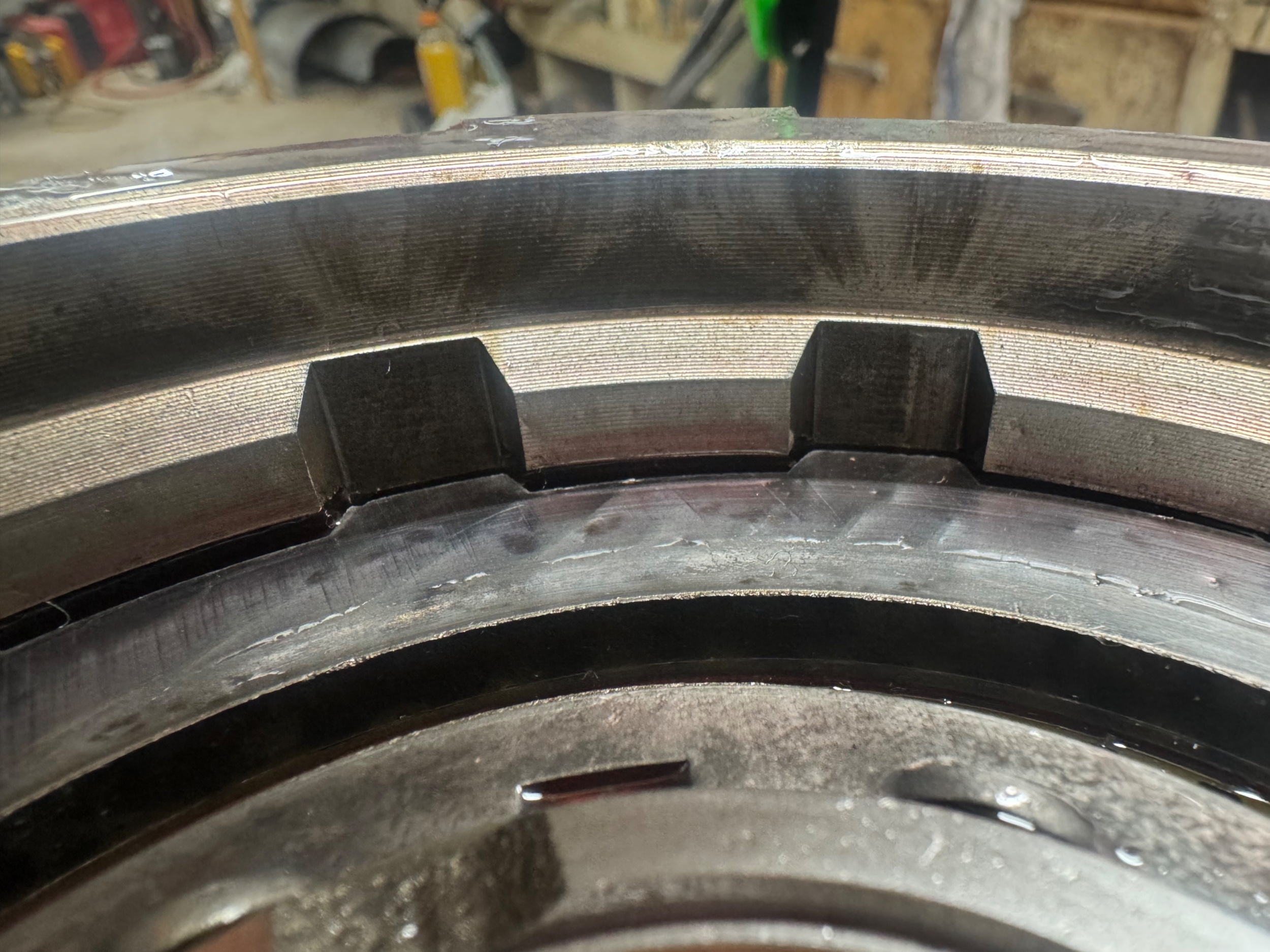

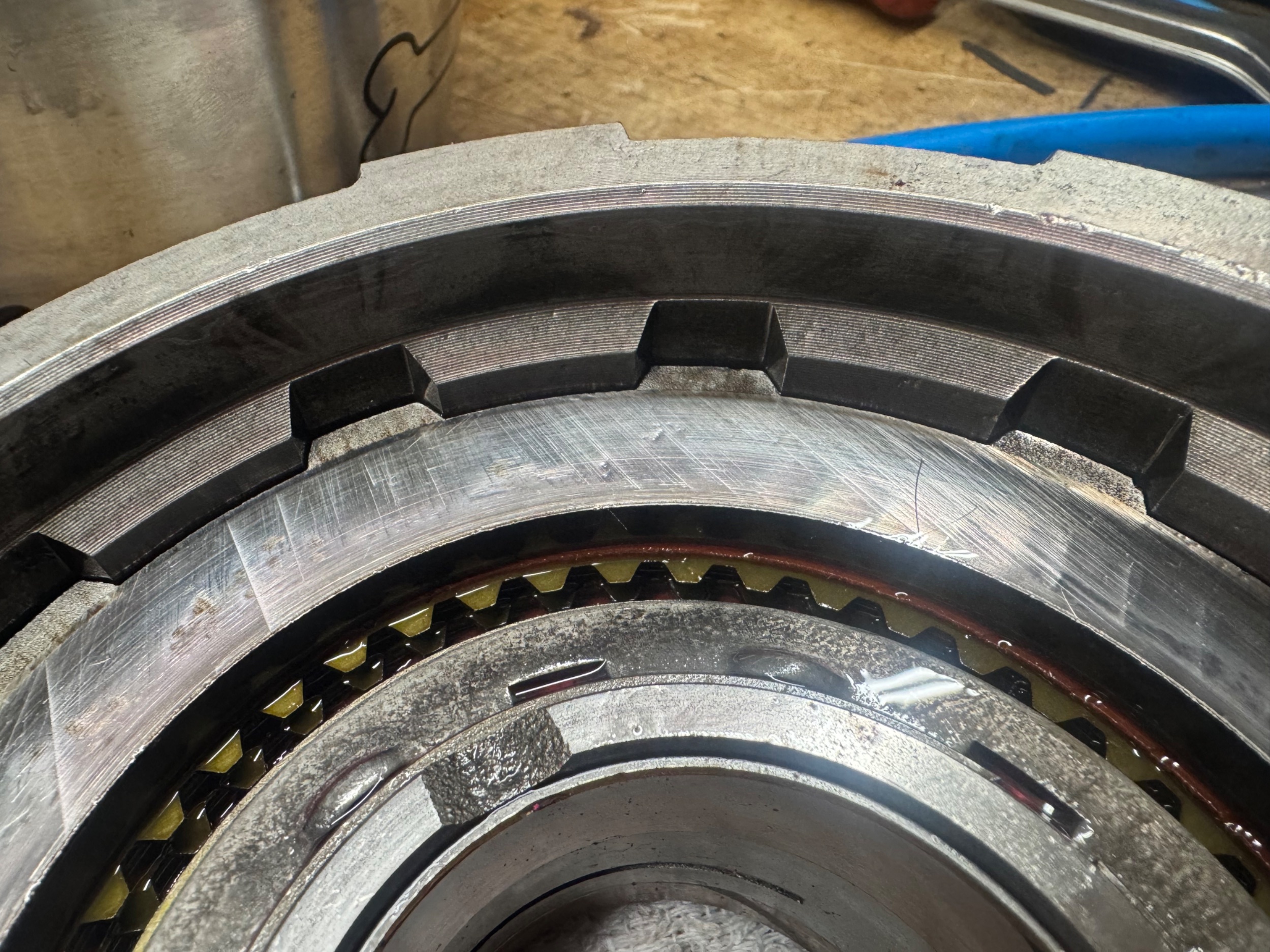

I’m looking forward to finding out my results as well but the 32rh gods insist on repeatedly kicking me in the nuts. I got the new, new steels in today, the ones that are .68 instead of .88 or whatever the first ones were and just started putting it all together and when I got the pressure plate down and started to put the wavy ring in I noticed that there was no slot for the ring to slide into on one side, so I looked at the other side and there it was. I took all the plates back out thinking I surely dropped something in the bottom that made one side rise up higher than the other but it was only metal. I laid a straight edge across the top and measured the depth on one side and then directly across and it was nearly an 1/8” difference. Now I think we know what wore the clutches down to bare metal and wore the original steels down so bad. @hear have you ever had a drum with an uneven face at the bottom like this? I’m really curious how the hell that managed to happen. Anyway, here are a couple pictures of one side compared to the other with the pressure plate in.
