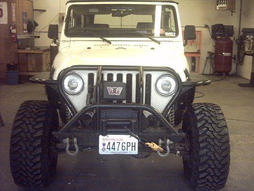

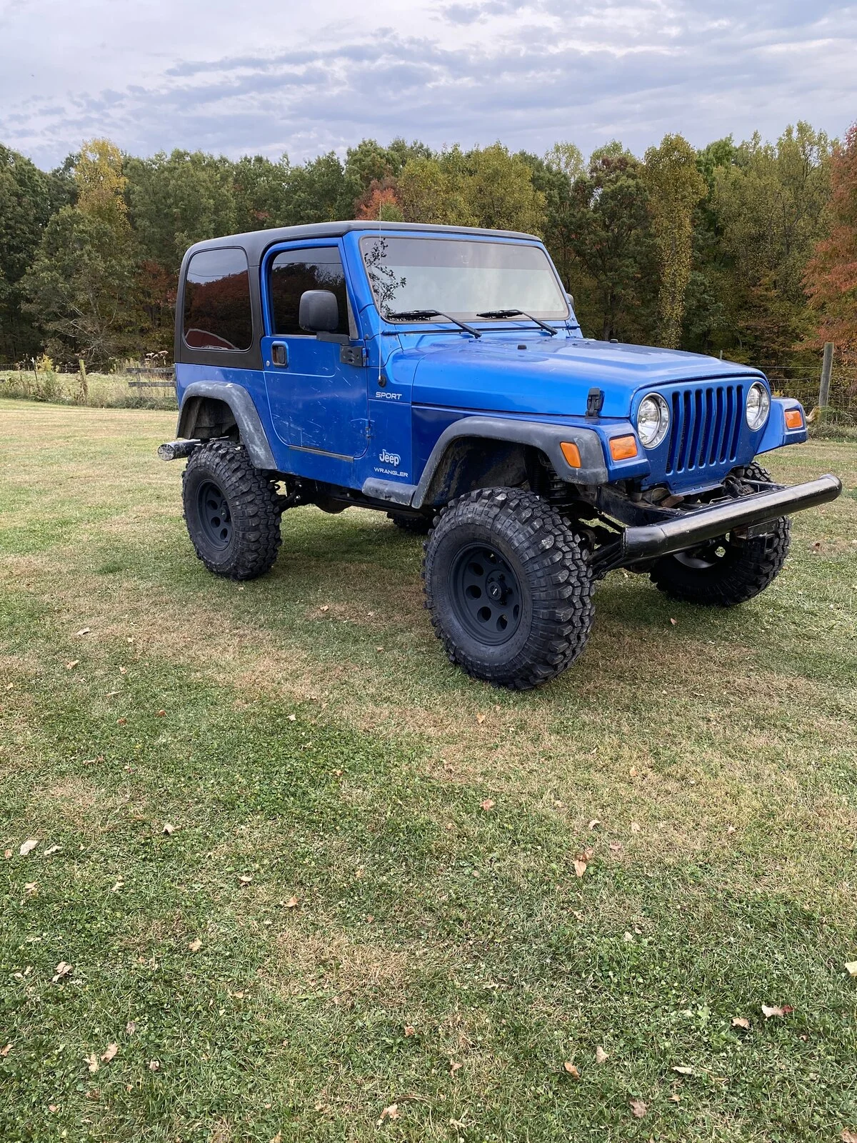

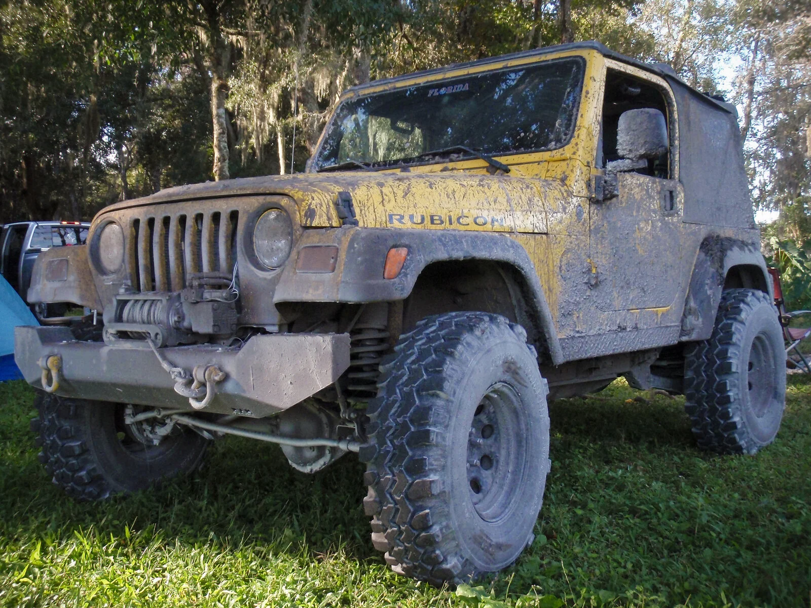

I ran 35x13.5x15 Toyo M/T's on my TJ with the 4 popper & 4.88 gears. I didn't have upgraded shafts or anything else at the time & was running a LocRite in the front. This was way before the TJ was transformed. You could get a 35X10.5 tire to cut down on weight?
And then with Tube fenders
Pro Comp 4" springs and 1.25" body lift.

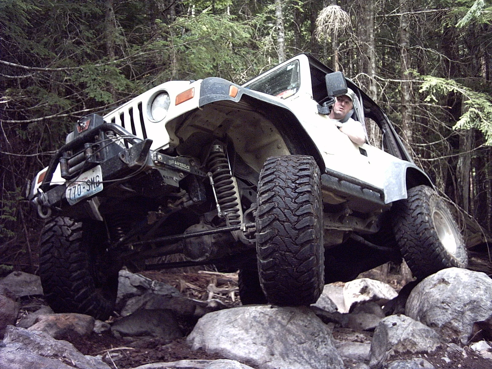

I don't know about the Spokane area but here in central WA, still on the east side away from all those loons most run 33-35" tires. When I put the 38x12.5 tires on my TJ I had the biggest tires in my club. And it has been said by a LOT of people in my club that a 33" tire is all you need to run 95% of trails in WA. I tend to agree with that and think 35" tires are all you'll ever need. I started with 35" tires and the only reason I went bigger was because of the Hummv rims I decided to run.

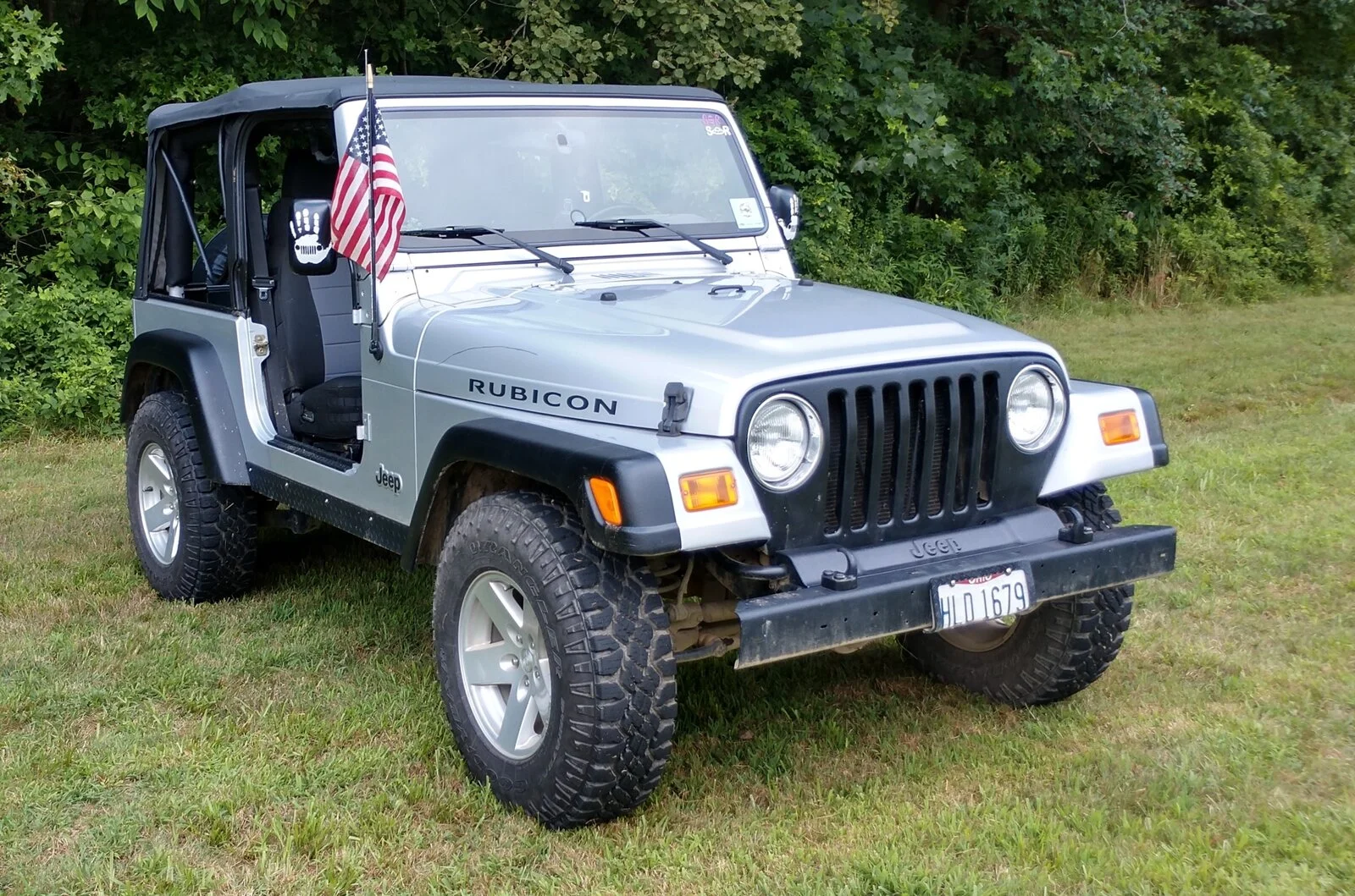

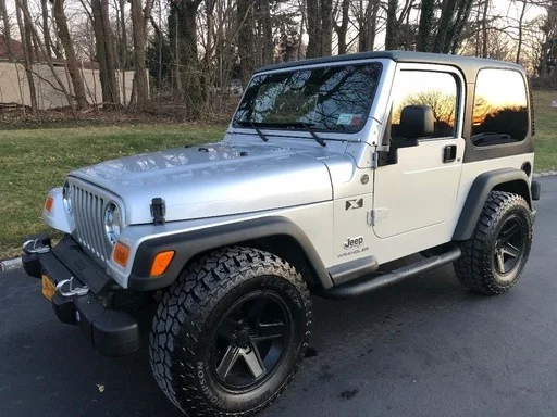

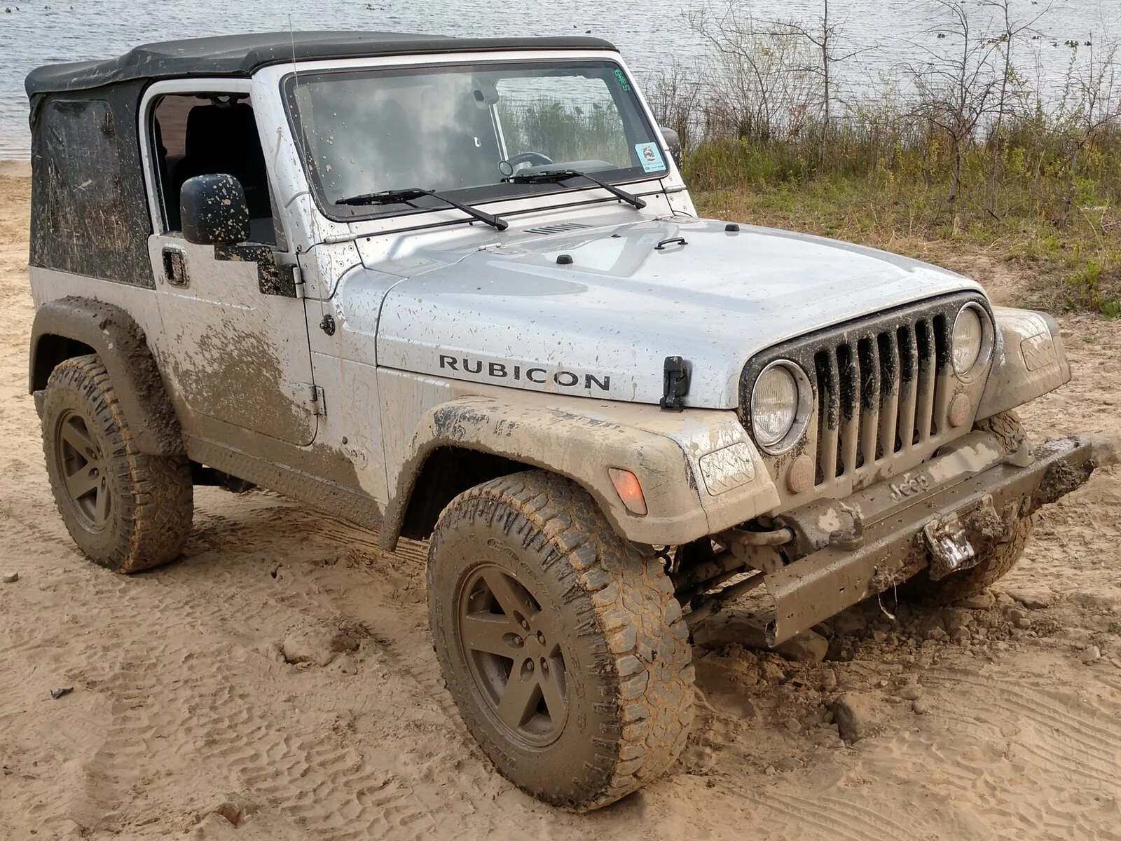

My avatar shows my almost 32" tires that are about 9-1/2" wide. I think they look fine and even off road they are doing great. The thinner they are, the more lbs per sq in they force onto whatever they are sitting on. In my experience, they dig into mud or snow and grab. It also helps on the pavement.
Here's a bigger copy of my avatar:

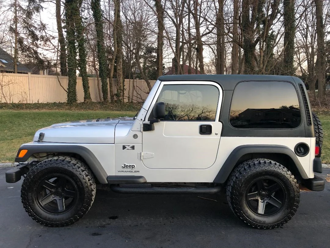

Here's a clean view:
You can see what I got rid of as soon as possible after I bought this Jeep:
235/85/R16? Looks awesome.

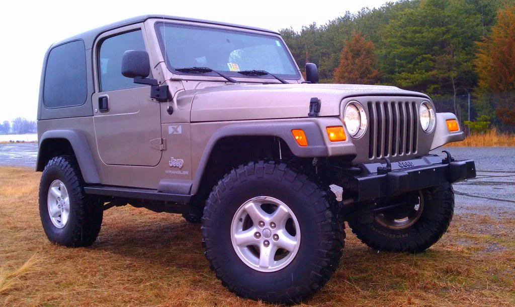

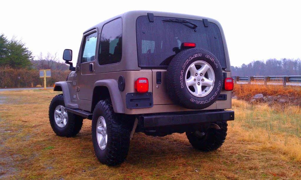

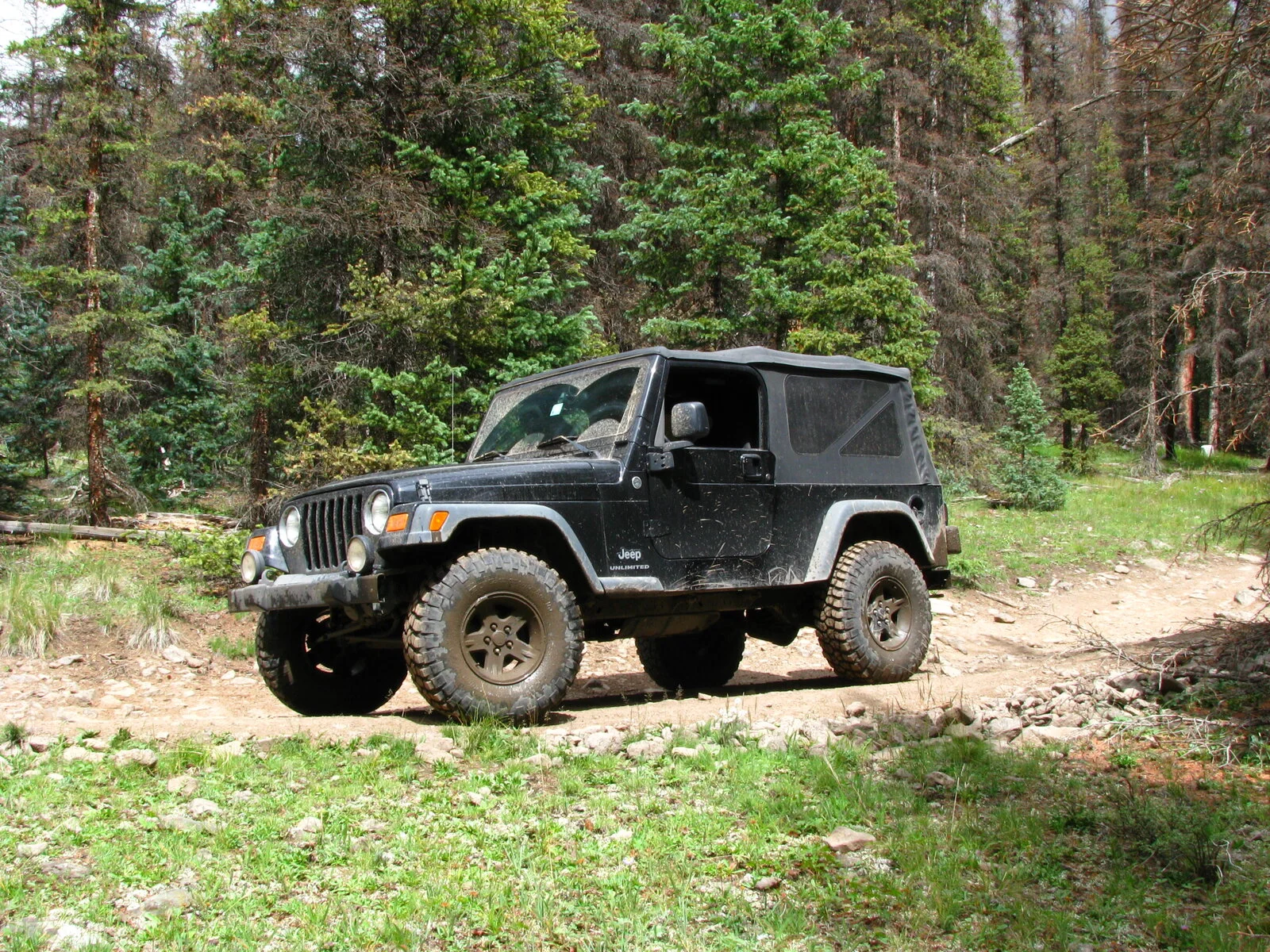

in case you haven't seen enough yet, here's my first LJ on 33x10.5 KM2s, circa 2012.
I much prefer the visuals of the narrower stance as well as the reduced mud sprayed up on the side of the tub due to better coverage.
I don't do mud, but I believe the 10.5 and 12.5 in the same diameter to be functionally equivalent on hard surfaces, and I'd want to see actual lab quality test data before buying into the idea that the 12.5 would float better. Aired down to the same pressure, they should have the same contact patch area (the 10.5 will be longer and narrower vs shorter and wider with the 12.5).
I also like the idea of reduced weight and as-stock-as-possible scrub radius, though I lack the experience to know for sure that I can tell the difference. I know what a stock Jeep drives like and I know I like it, so I don't want to spend the value of a new set of tires to find out that I hate the way it drives.

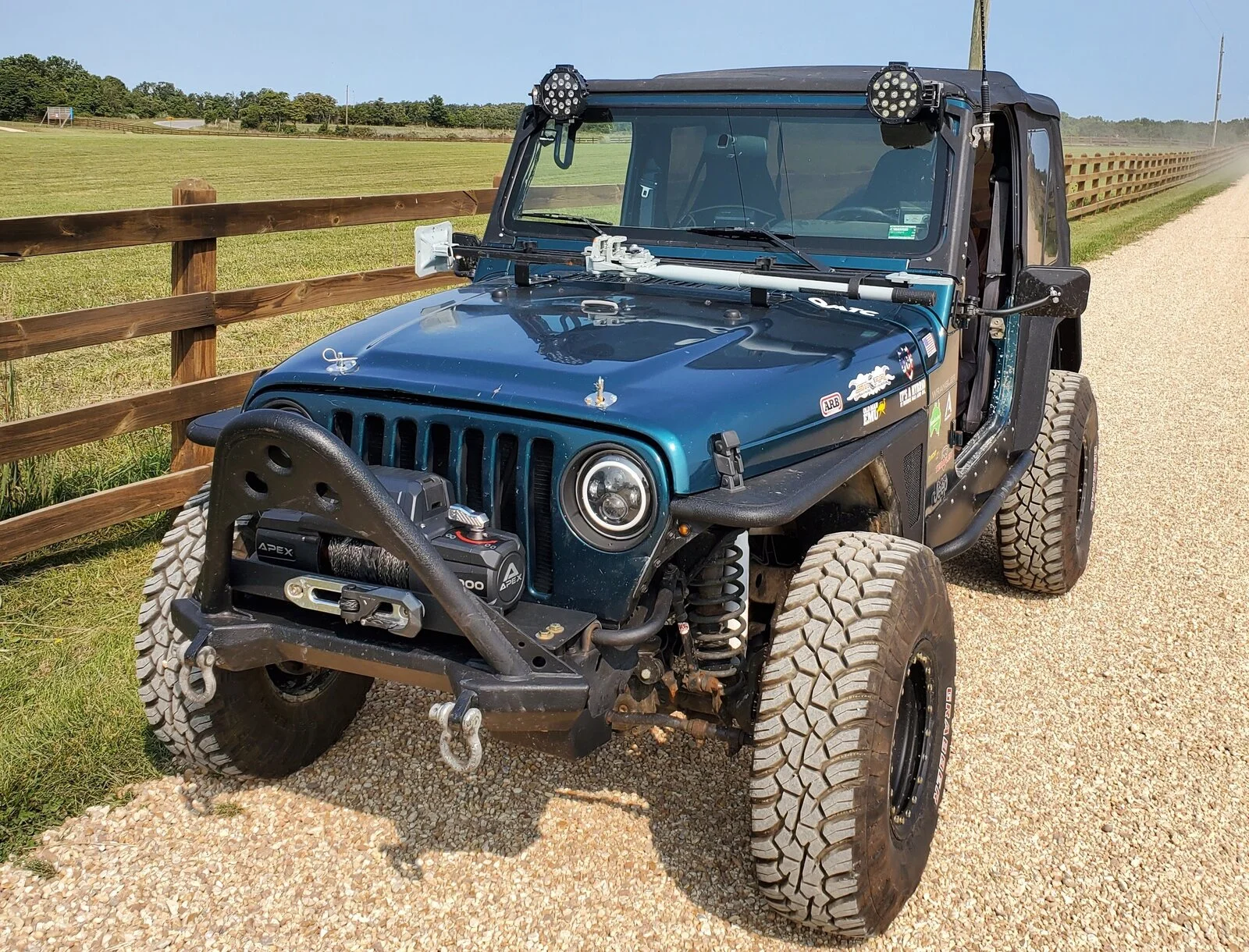

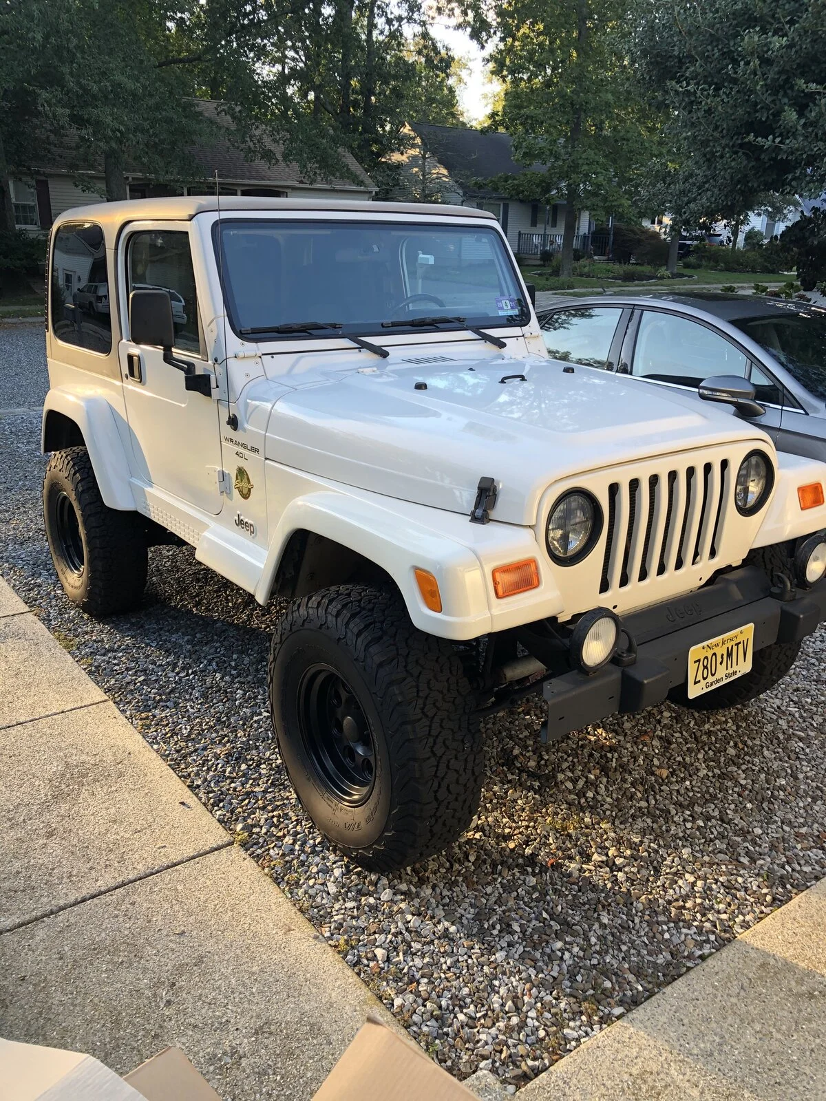

I went from 33x12.5 MT/Rs to 33x10.5 KO2s a couple years ago and I don’t regret it one bit. These tires do surprisingly well off-road also. I do my best to stay out of mud though.
here’s the best pic I have showing width. I can take more pics if you’d like tomorrow.

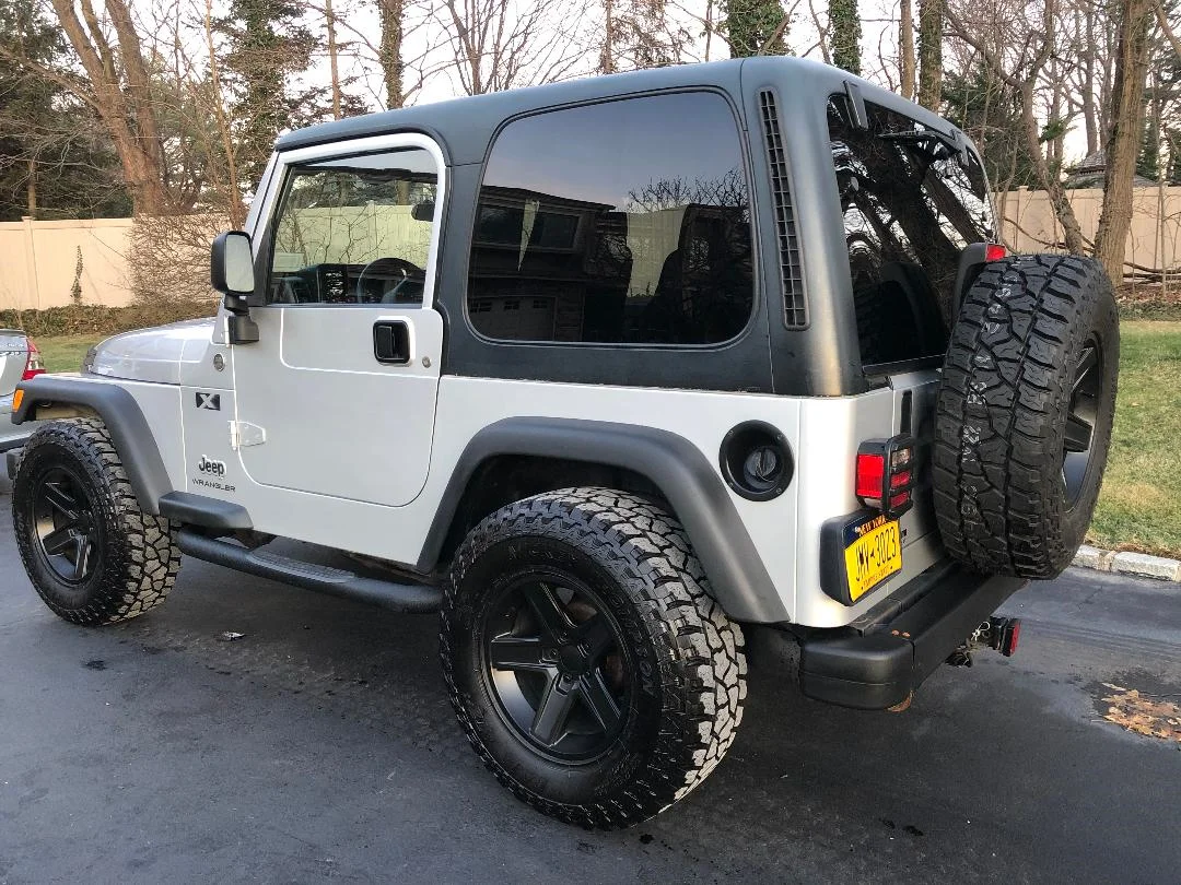

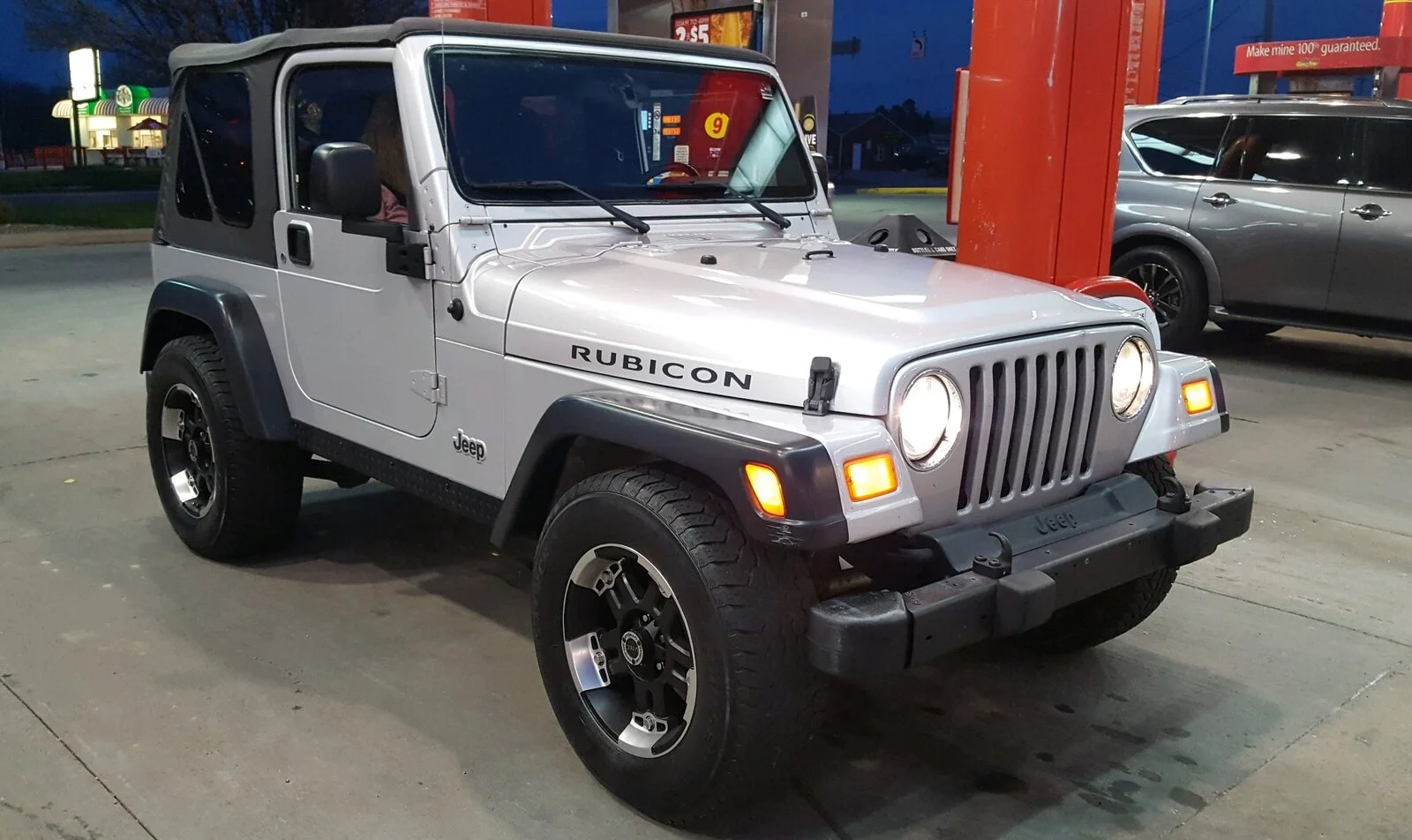

Here are Mickey T's 265/75/16 & no lift .
So ??? 31 x 10.5 x 16 ?? i'm guestimating ??
