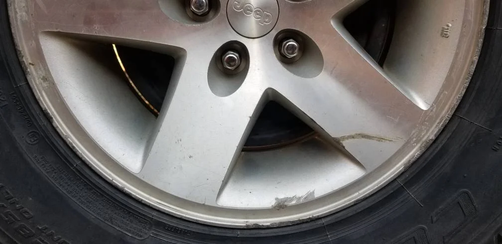

After reading their website. It says for 16inch wheels. Can anybody confirm that they will work on 15x8 wheels

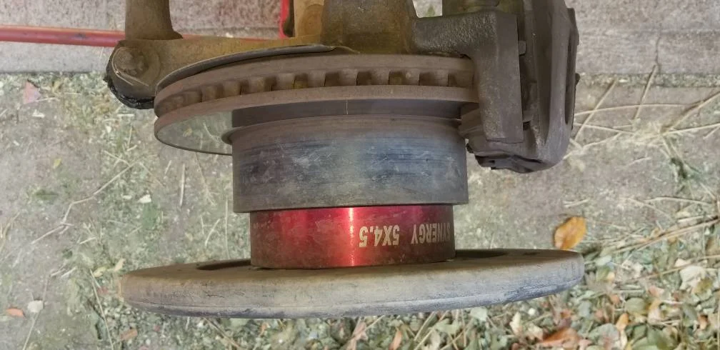

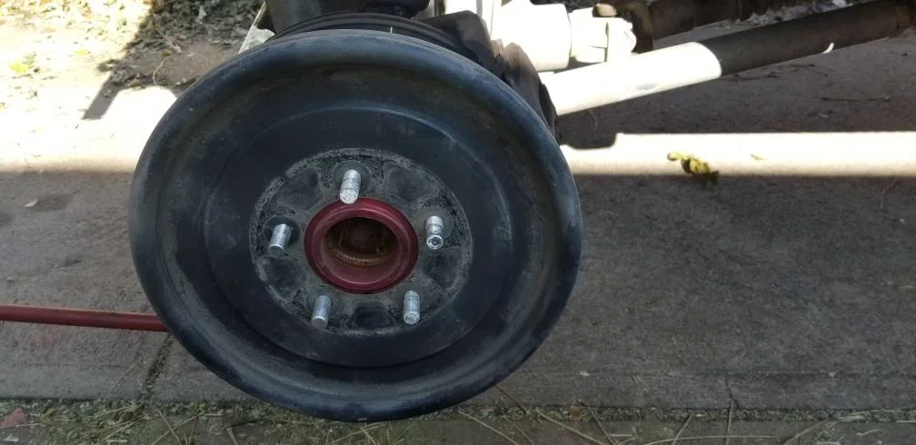

I've been running them for almost 15 years - I have the tires balanced and these smooth out any changes due to wear, mud, etc. I have wheel spacers so I mounted them between the spacer and hub - I loc-tite'd the bolts and torqued them and have never had a problem with them getting loose. It's handy having them "permanently" attached when taking the wheels on and off.
... I have wheel spacers so I mounted them between the spacer and hub - I loc-tite'd the bolts and torqued them and have never had a problem with them getting loose. It's handy having them "permanently" attached when taking the wheels on and off.
I wondered about this when I added the spacers to mine. Any issues removing a caliper?

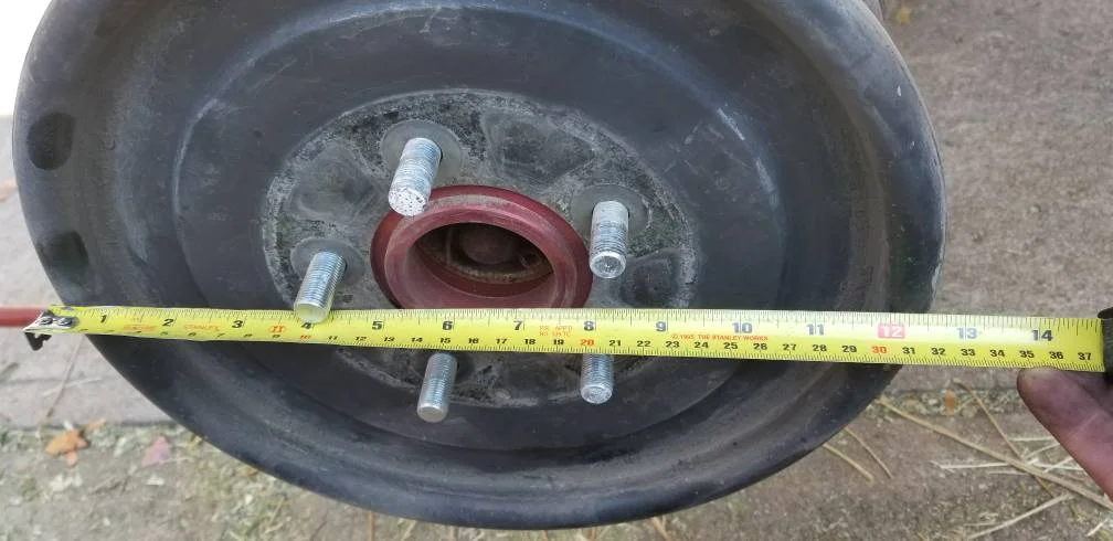

I was on their website earlier and noticed that there is a balancer for "older cars and airstreams" and another for Jeeps. The first one has the same bolt pattern as the Jeep's, but it says the rim size is for 14"-15" rims, where the Jeep's is for 16"-20" rims. Does anyone know if the Jeep ones will fit on a 15" rim by chance?
