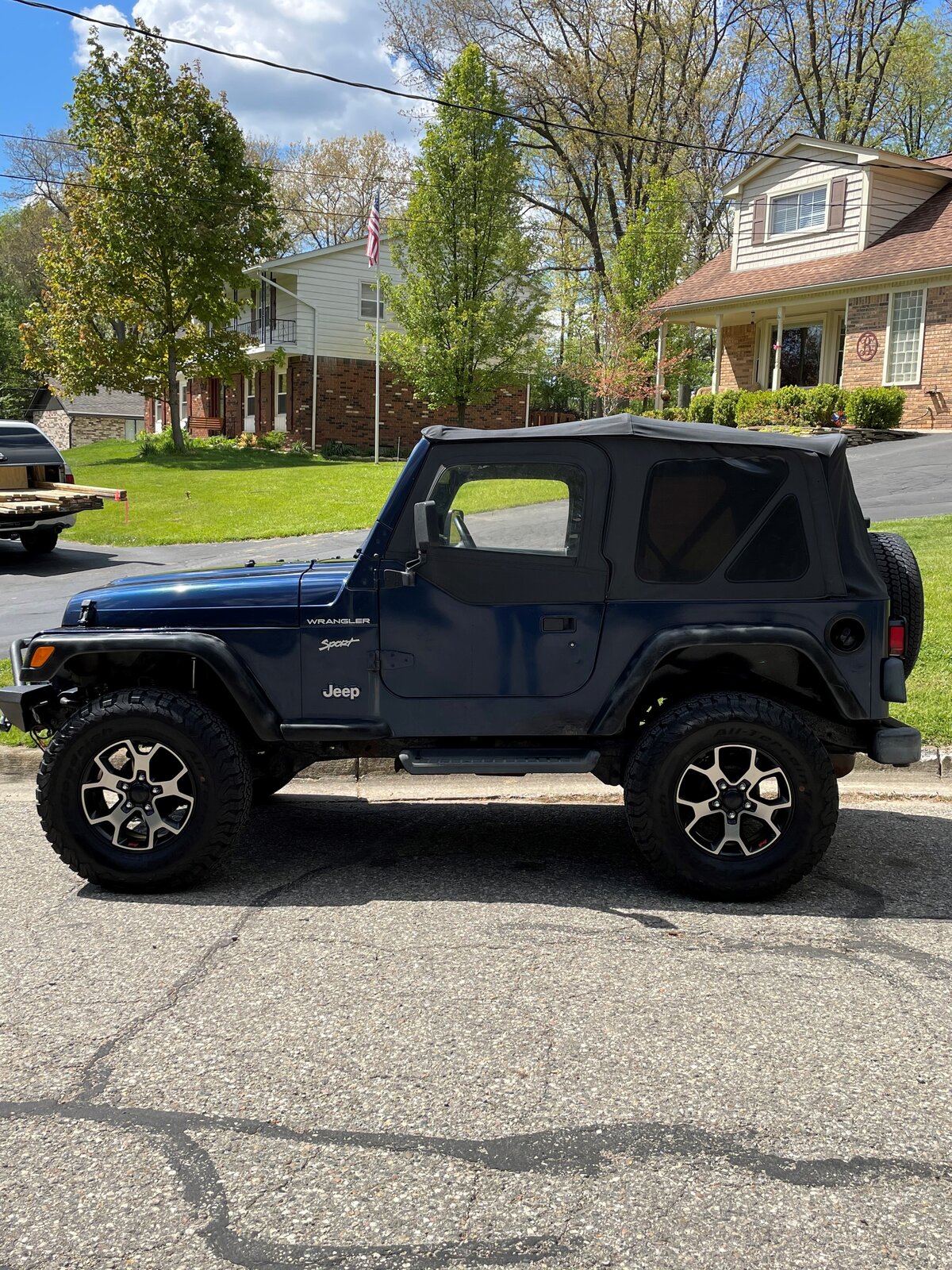

CodaMan's 2004 Jeep Wrangler Rubicon
I would like to thank this thread for the inspiration for my build.
BDS 2" lift Springs/Shocks
1.25" JKS body lift
1" MML
4.56 gears
TruTrac front
Yukon Helical rear
I had no intention of doing the exact same wheels but I was able to score five for $650 nearly new. Couldn't pass it up. Trackbar relocation bracket was not needed and I have zero vibrations.
1.25" JKS body lift
1" MML
Nice stance! Did you by any chance measure how much actual suspension lift did you get front and rear?
1.25" JKS body lift
1" MML
Looks great!
I did not. General consensus is about 2.5+ in the rear. If you search the forum for "BDS" you will get some good answers and details pertaining to these springs. I am shocked at how nice it rides with the springs/shocks.

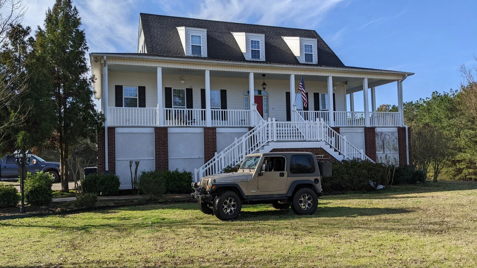

After not being on for sometime, I'm back. Moved cross country and have been really busy. I did do a couple things to the Rubicon... Replaced the clutch, all the O2 sensors, all 3 cats and added a 1.25" BL and a 1" MML in preparation for a tummy tuck.
Here's a gratuitous pic of my Rubicon and my new place.
