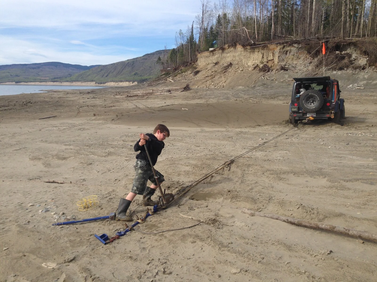

“Child labour” 😅
pic shows our son Sam hard at work with our 3000 pound trusty tirfor in combination with a snatch block and land anker
Tirfors are very handy tools , we got ours for 200.-$ at a yard sale
- we used to have it on board with recovery gear , before investing in a WARN 8274
- the landanker is still part of our recovery gear
Tirfor is definitely one of the best ever recovery tools. If you have 1000' of steel cable you can do a 998' continuous pull. No duty cycle, no regrip, and the effort to run it is pretty light. We used them often in bridge construction. I don't think you can wear one out but they are rebuildable. And for their capacity they are incredibly light.
$200 is a steal. The only reason I don't have one is cuz a Warn winch is often cheaper.
Looks like my backyard, Arrow Lakes ?
Nop
Willistonlake reservoir,(Bennett dam) Hudsons Hope, BC , 2 hours NW of Dawson Creek

Wow how many hours did it take to free ?
