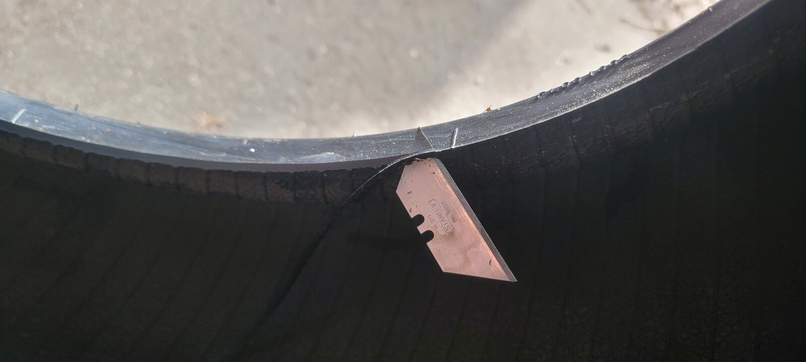

A good bit of progress happened today. I got one Coyote inner beadlock installed!
Watch the official video for more meaningful detail...
Trim the sharp edge on the inside of the tire bead to prevent damage to the beadlock.
Stuff everything inside the tire...
And you now have a secret beadlock!
Four more to go!

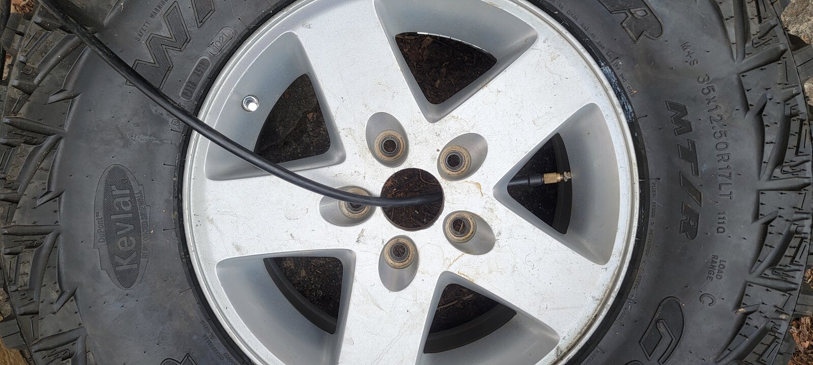

Fairly easy to get to the valve to deflate/inflate when it's mounted?
As easy as the other one with a 90° air chuck. The new valve won't get touched very often. That one inflates the beadlock and will always be inflated. The normal air up/down for the tire is accomplished through the original valve.
Four more to go!
Man, that looks like a bear. How long did it take to mount one tire with the Coyote?
Maybe I'm missing something, but it seems like the tube is a set it and forget it pressure, while deflating and inflating the tire is done via the standard valve stem?
Maybe four hours on the first. But I was being cautious to make sure the the new valve hole was in the right spot and that the inner tube wasn't twisted. I also haven't figured out how to be quick with the tire levers, yet.
