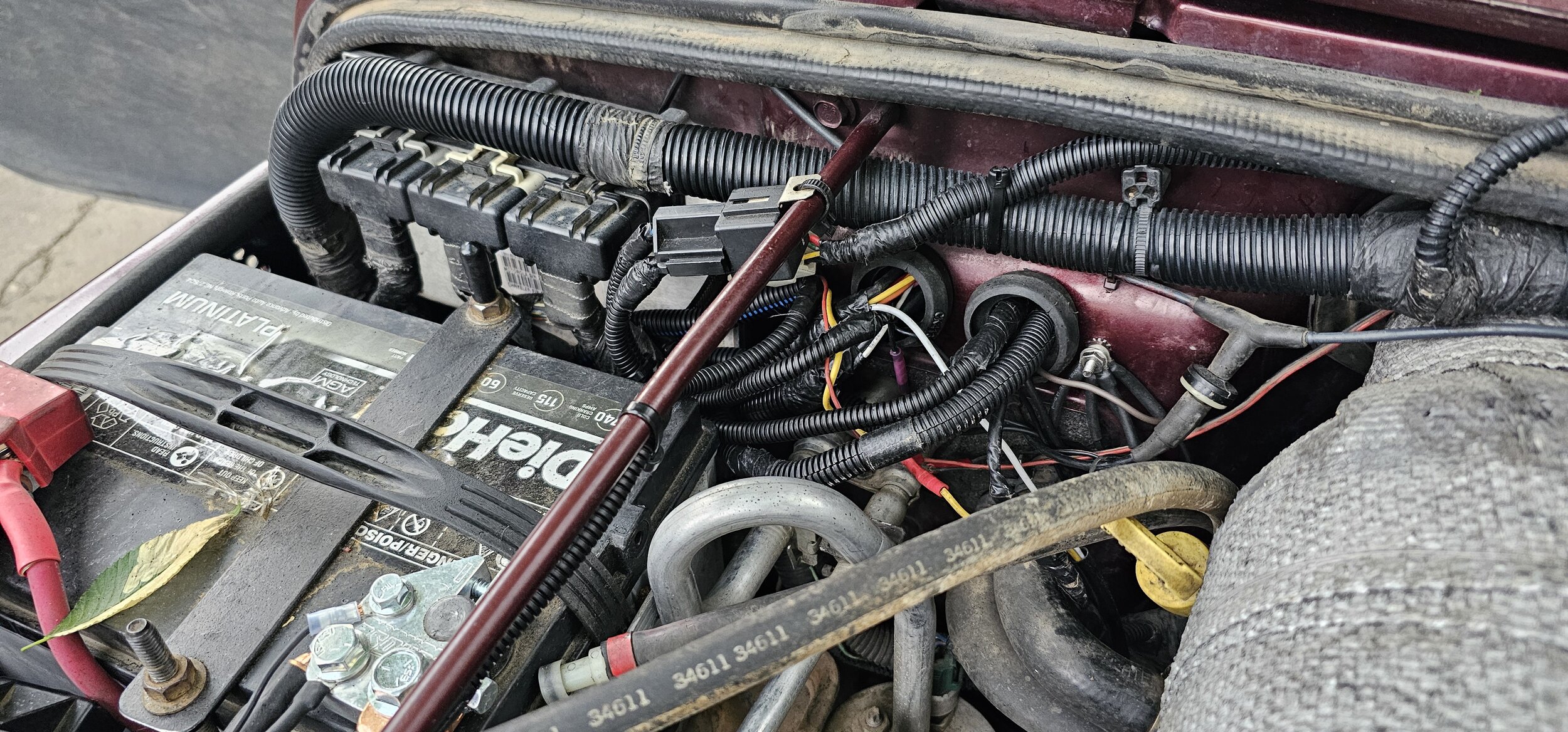

In the interest of trying to do a decent job on the highline install, I added a second wire chase into the glovebox area.
This was to reduce packing the first chase too tightly and help improve the routing once the cleanup happens.
While I was in there, I also bolted in a ground stud by tapping the sheet metal, screwing in an 8-32 bolt from behind and securing it with a keps nut.
Halfway done!

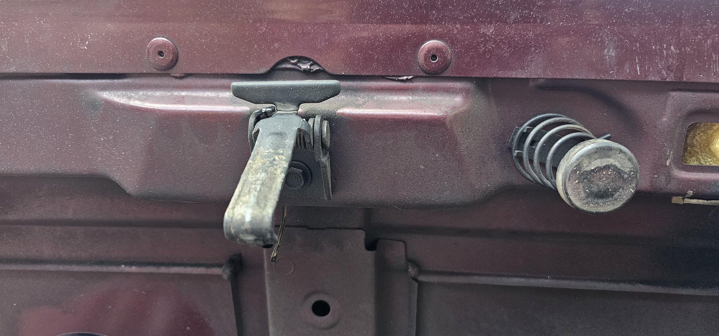

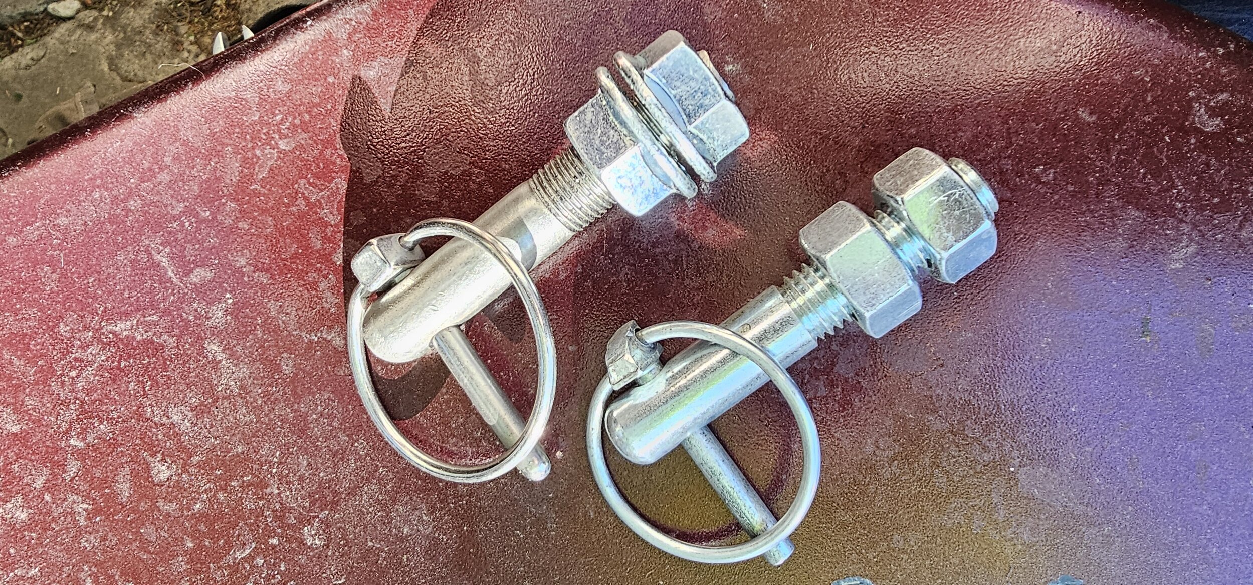

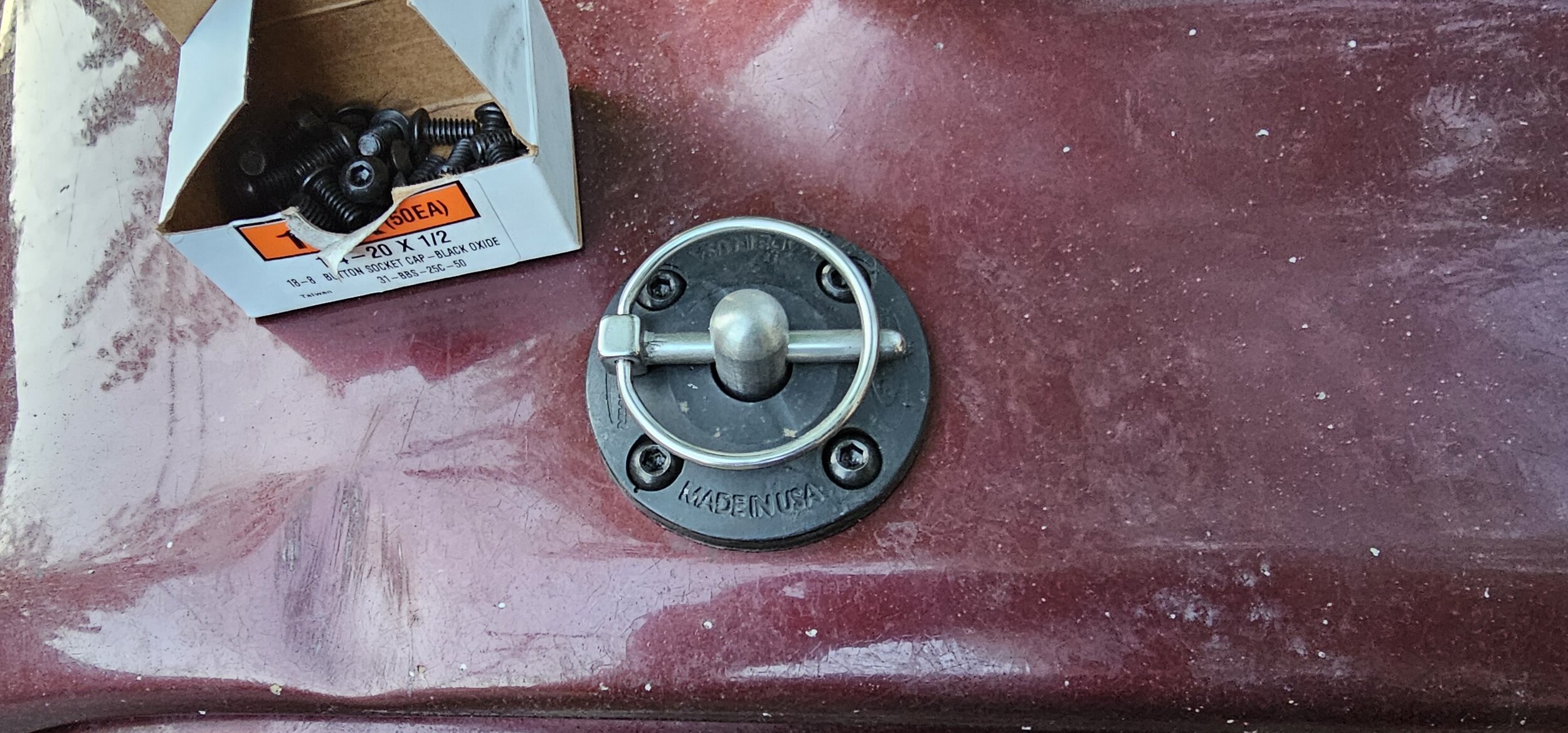

New nicer special hood pins are now installed.
These ones are full stainless steel, including the lynch pins with big serrated flange nuts. Everything about them is nicer in fit and finish.
The grommets are bolted in place for the first time. I used more of the black stainless hardware I have been using on the fenders to help keep the shiny dots down to a minimum.
I spent more time on the pin lengths and positioning. And following Blaine's suggestion, I ground out the grommets where the pins rub on their way through. And I removed the spring and safety latch.
Now the hood will drop onto the pins and fully seat against the bumpers with little to no effort from me. And the lynch pins slide in with just enough resistance to keep the hood snug.

Because if I don't do it now, it will never be done- a large part of today was spent shortening and cleaning out the ARB locker wiring harness.
Every round gets more wire wrapped up and put away.
Adding the second wire chase through the firewall helped a lot to keep things from getting too messy. One hole is for the SwitchPros and the fuse block where everything routes the same pathway and the other is for everything else that goes the opposite direction.
Halfway done!
