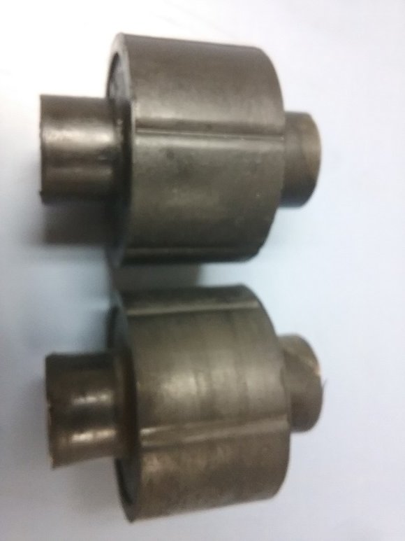

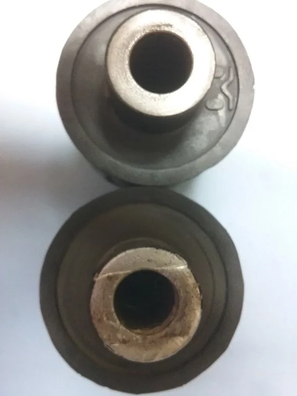

I really don't want to make this thread about Duroflex joints, but since it's what I've got to work with, I'll post some further observations.
I don't see a whole lot of wear around the circumference of the bushings where they rotate in the barrel. The grease was all gone and there was evidence of some chaffing of the rubber along the inside of the barrel.
top bushing new, bottom 32K miles.
The only real noticeable wear is on the end of the bushing where the retaining washer has worn deformed the rubber a bit.

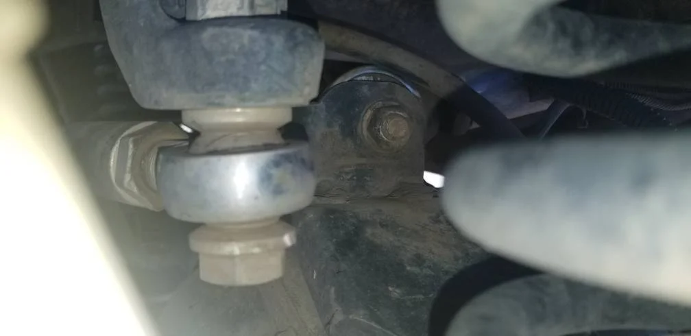

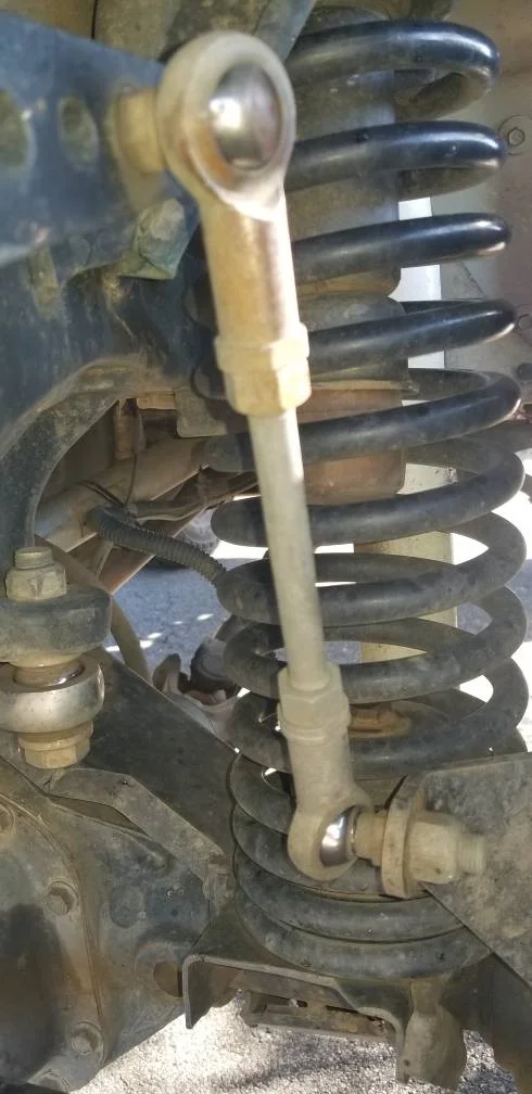

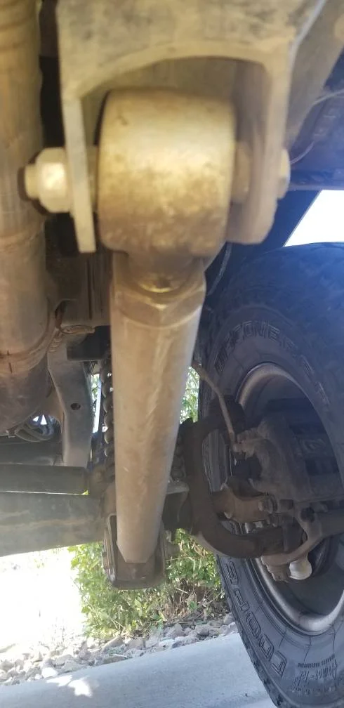

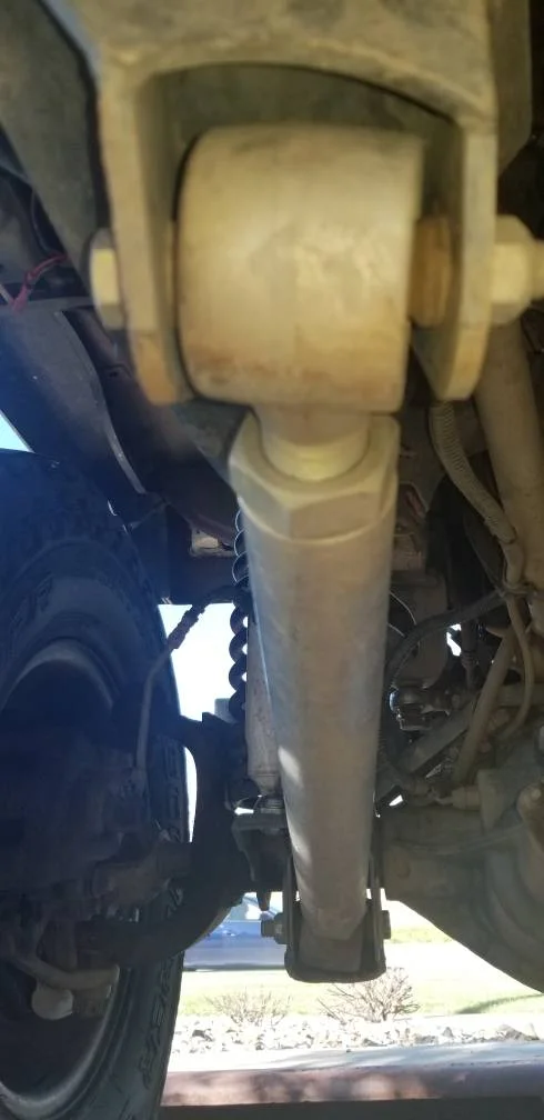

Here are a few of the heim joints and Johnny Joints on my Jeep, including a Metalcloak front track bar. None of these joints have a return to alignment, nor do they care what misalignment they were last left in. A bushing will respond very differently.
Reactions: fuse
Does a JJ or a heim lose integrity or strength if it's not returned to center at rest? How about when it's under load? Under load for prolonged periods?
Neither a JJ or a heim care about being returned to center or to any position. But like any joint or bushing, if there is a constant uneven loading, such as when a single control arm is adjusted too long or too short, the life span will be reduced.
