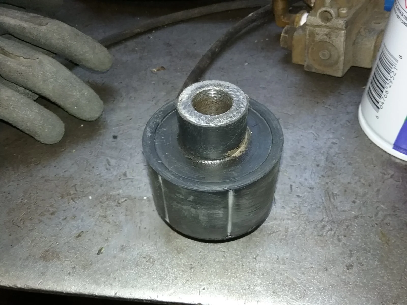

Observation: Duroflex bushing, lower arm, after 32K miles, 90% commute to work, add a few wheeling trips in the mix.
Old bushing,

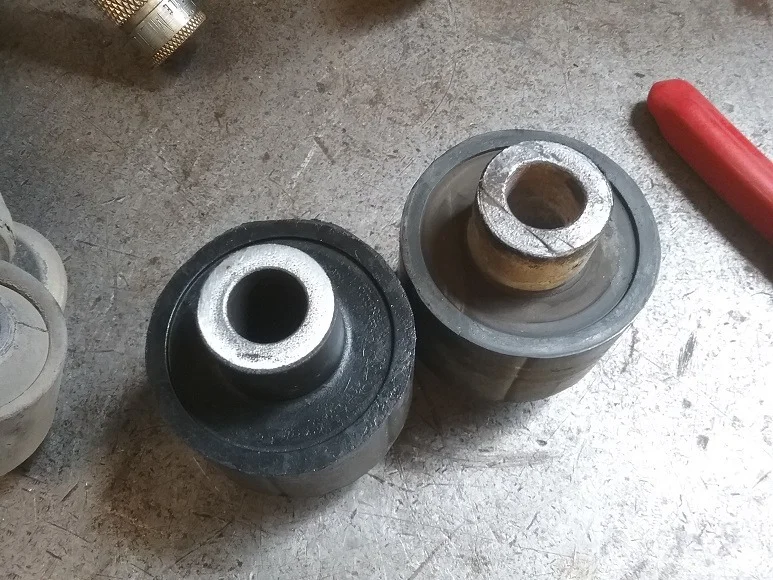

Side by side comparison of old bushing vs. new bushing,

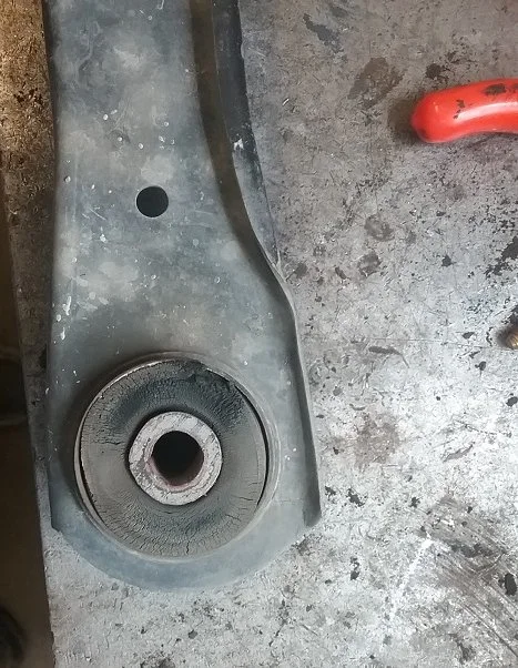

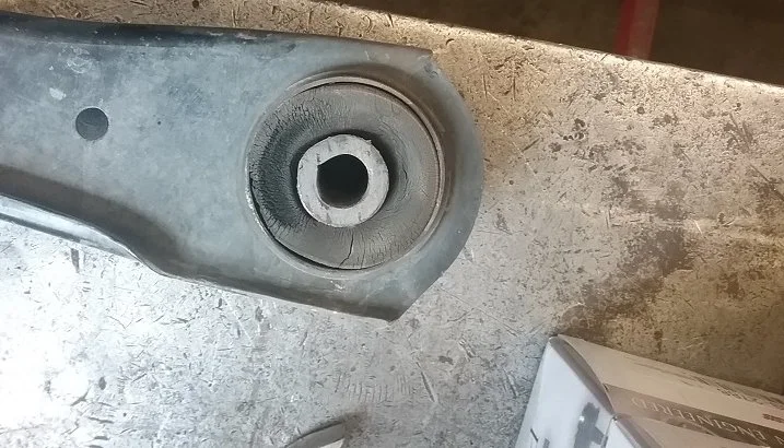

Old factory arms with 100K + miles,
Does any of this mean anything? Likely not, but I'm a picture whore, so that's my story, and I'm sticking to it.
Old bushing,

I'll make one observation. It appears to me that the majority of wear on that MC bushing is down the middle of the bushing. I'm guessing thats where they have that metal ball that is incased in the rubber. So that means its surface area for NVH is going to be very similar to the JJ. So now in regards to NVH, its just a matter of material thickness and density. Which still just really leaves us guessing.
EDIT: Is it just me or does anyone else not like that the MC bushing rotates inside the barrel of the arm. I always feel like this is a wear surface and it should be replaceable. Its one of the reasons I am between the DDB or the JJ and not the MC

You should mock up that factory arm and twist it to see how much it actually gives.
