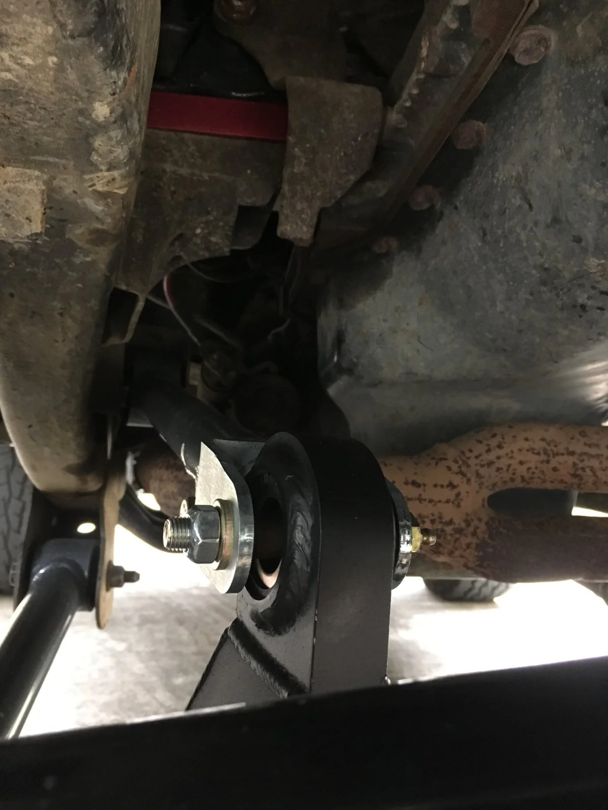

The joint ends are centered after flexing. During flex the JJ moves further first, then the DDB joint follows, when the JJ reaches its limit, the DDB moves a bit more. This image is on the previous page, and it is a bit blurry, but it shows both ends centered at ride height.

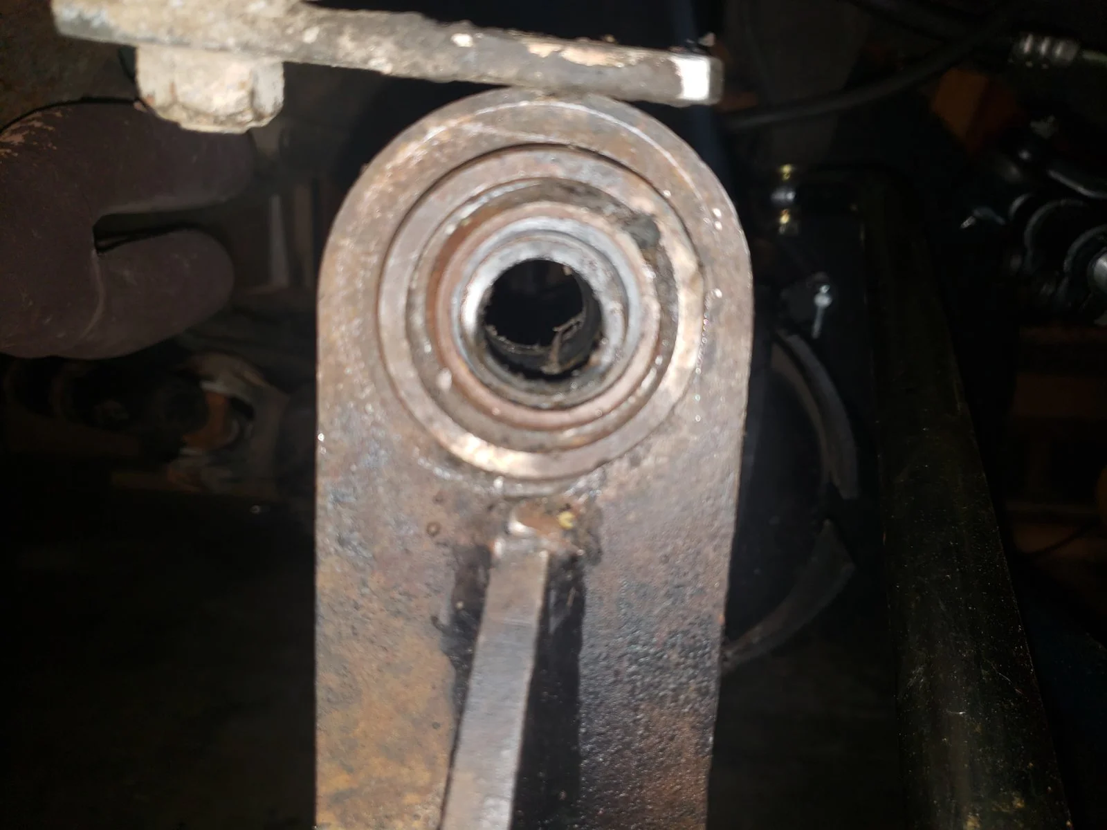

I am not a fan of any of the solid joints because of things like this, which is on a different post thread. That is why I am hoping the synergy bushings might be better than OEM with longevity. Tim
