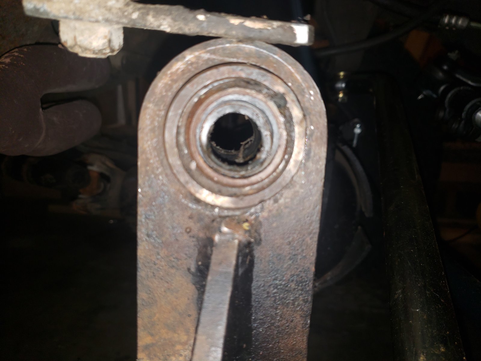

I am not a fan of any of the solid joints because of things like this, which is on a different post thread. That is why I am hoping the synergy bushings might be better than OEM with longevity. Tim
That thread is not indicative of how a JJ typically performs.
After working on helicopters in the army for 8 years, all joints that are not pure rubber can do that fairly quickly when they decide to go...that is why I am looking at the synergy bushings. They are the closest to a rubber impregnated, multi layer lord mount that I have found in the auto industry. Tim

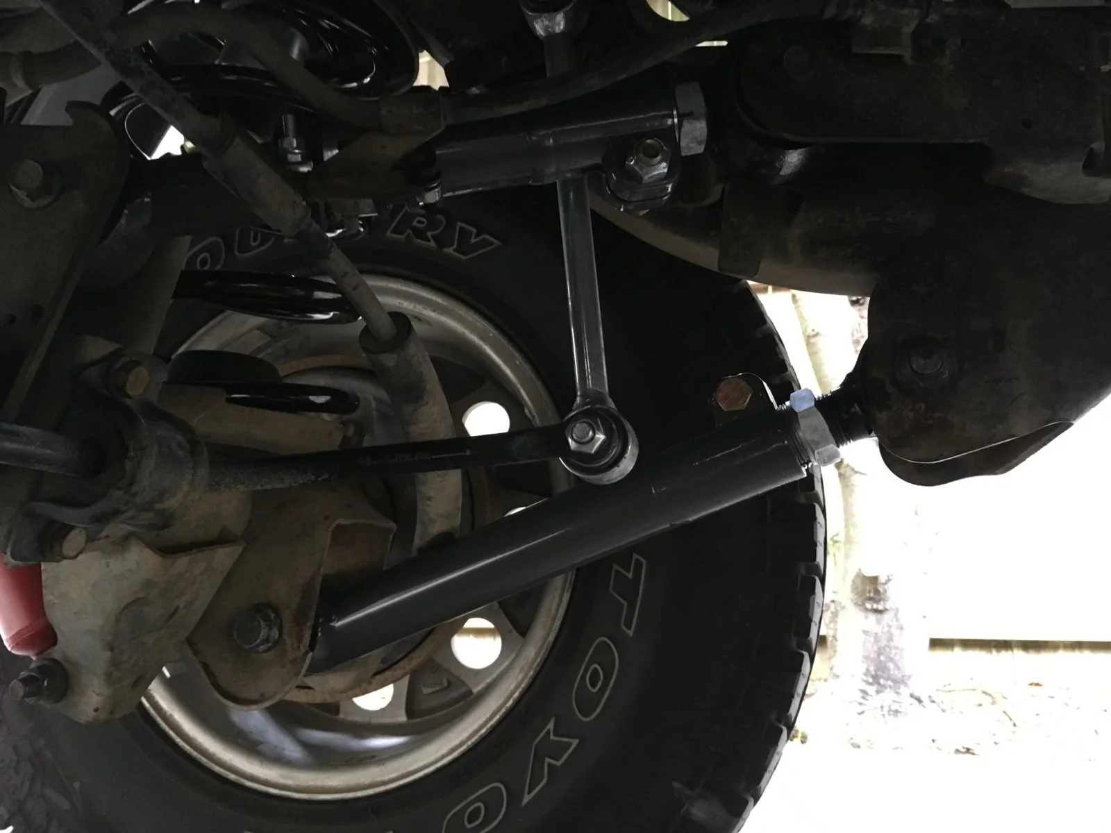

The stock passenger side UCA bracket was somewhat bent, and the sides had collapsed .2 inch inward. When it came time to attempt removing the original bushing, I could see the bracket wasn't suitable for a simple press-in option.
Enlarging the holes in the UCA yoke to 12mm was not a problem. I did it anyway to use the JJs. Synergy also offers a forged replacement yoke with 12mm bolt-holes as an alternative to drilling.
Adjusting pinion angle reached a point where adjustable LCAs were needed for the rear. I installed Synergy arms.
77069
What is your pinion angle? How much lift are you running? I like the synergy arms.. How much did you have to shorten the lower arms to? Do you have much clearnance between the gas tank and diff cover? Gawd, too many questions after taking an ambien...
8.6 degrees rear pinon angle
3" lift
rear LCA's were lengthened to 16"
The TJ has a 1" engine lift, stock skid plate with .25" drop, stock single cardan driveshaft, and TC output is at 8.2 degrees. With a slightly longer than stock Moog rear trackbar on an upright relocation bracket, and 1" body lift, there is space for everything to move without conflict. The UCAs reached their limit for rotating the pinon downward on 2" lift springs. A minor belly-up and SYE are in its future.
