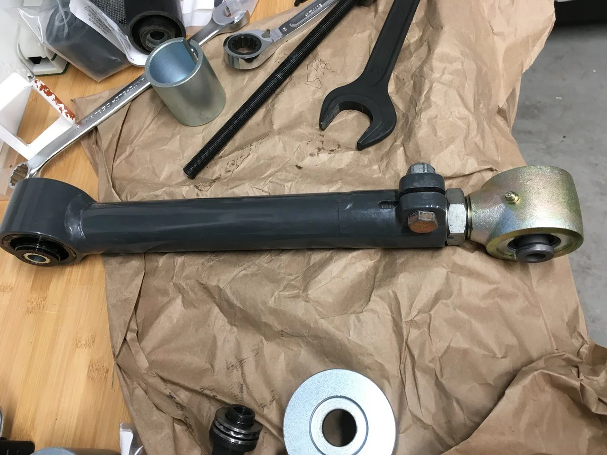

I installed new 2nd gen DDBs on the fixed side of my adjustable LCAs, and replaced the DDB rod ends with JJs. Soon there will be only two DDBs on the Jeep.

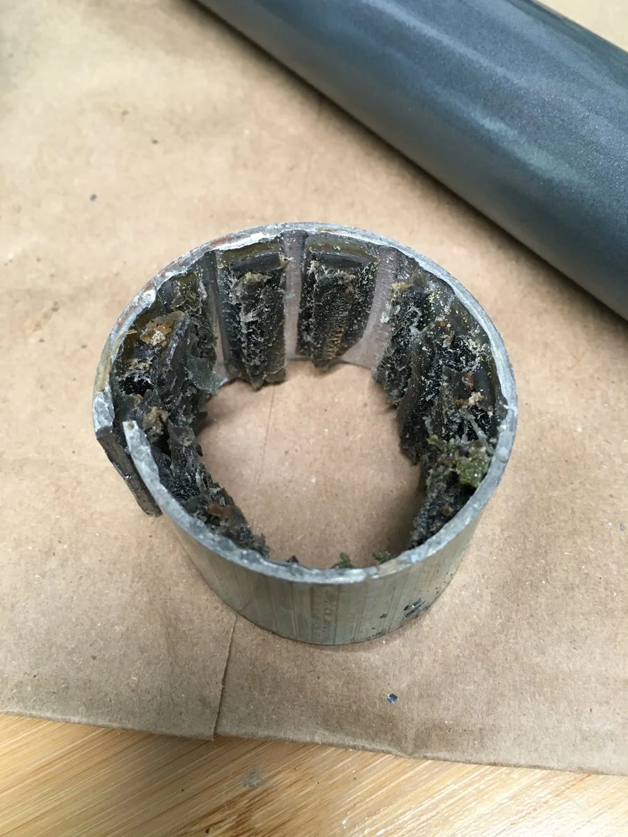

An original front UCA bushing would not budge when I tried to press it out. It was very time consuming to remove the bushing outer sleeve. Then a new 2nd gen DDB would not fit. Synergy UCAs and lower fixed control arms are off the suspension list.
