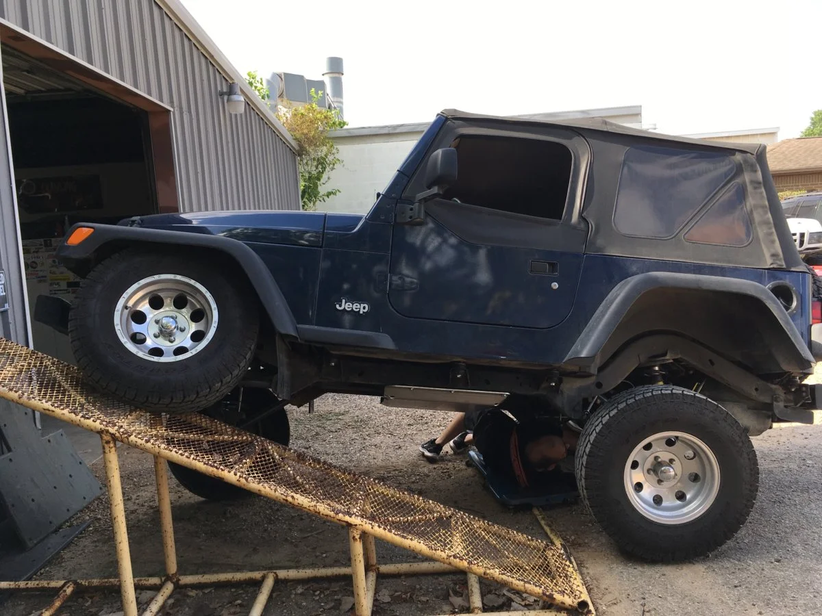

Looks like those Fox have some good travel... is that all suspension or suspension plus a BL?
Bilstein 5160 shocks up front.
It has a .5 inch body lift, 31 inch tires, 3.25 inch backspace wheels, and 7 inch fenders. The tires don't touch anything at full stuff.
