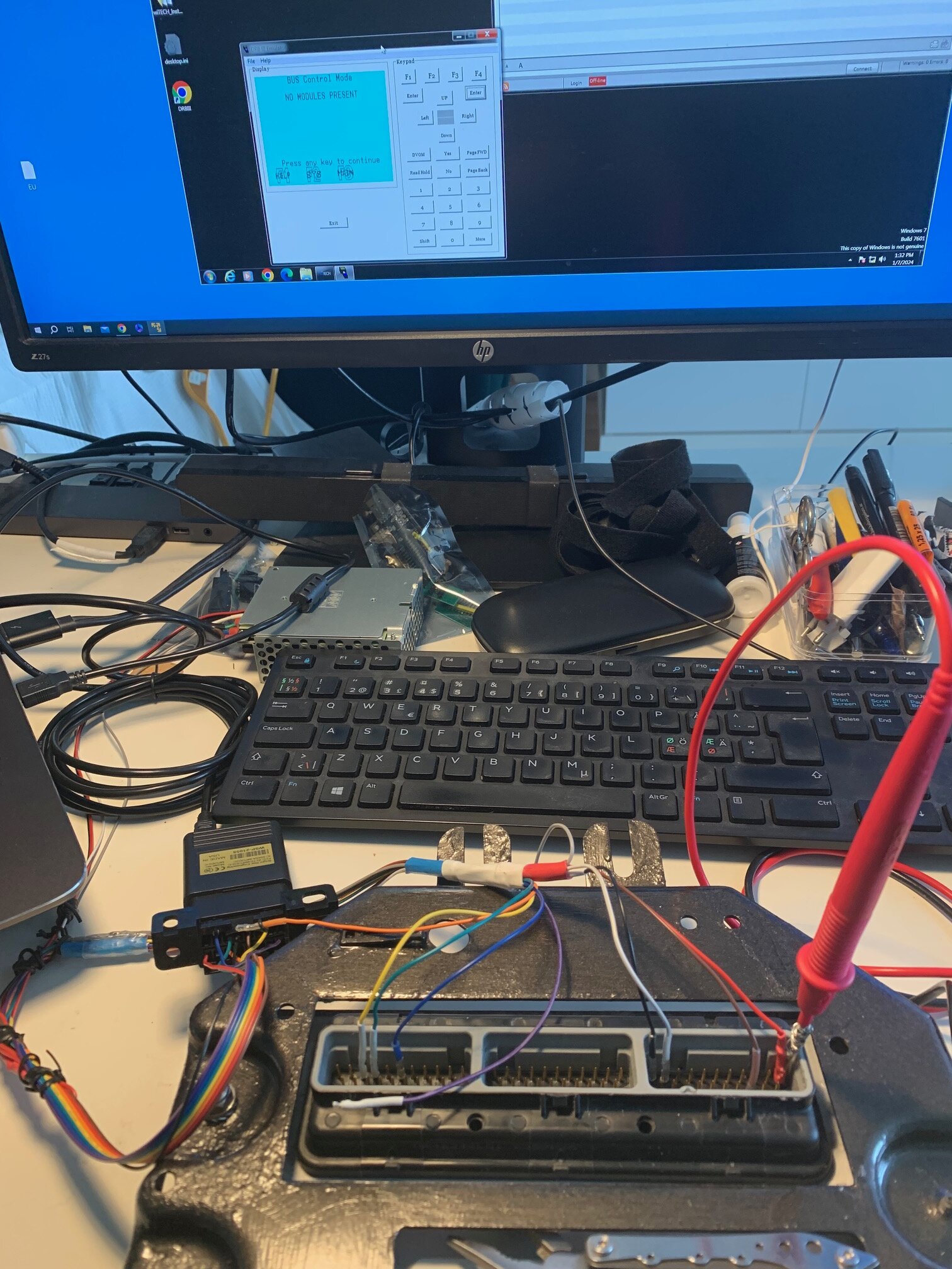

Hi, I got the DRB3 emulator running in a fashion-sorry to that it doesn’t find any modules. Alright, I have my PCM on my workbench and probably have missed some connection that is neccessary. Now this is from a 2000 Jeep WJ so I’m not familliar with the differences between TJ and WJ.
Someone hopefully is and can explain what I have missed. My diy harness is as follow.
DLC pin 2 (PCI) goes to C3 pin 30
DLC pins 4,5 (ground) goes to C1 pins 4,31,32
DLC pins 6,14 (SCI receive) goes to C3 pin 29
DLC pin 7 (SCI transmit) goes to C3 pin 27
DLC pin.9 (BMC flash enable) NC
DLC pin 16 (Fused B+) goes to C1 pin 22
So, what else is needed? I reckon that connectin B+ is the same as power on (ignition on?) - or maybe I missunderstod that. Well, I might have understod wrongly how to interpret the connector pin drawings and have connected it all backwards! So please feel free to correct me…
