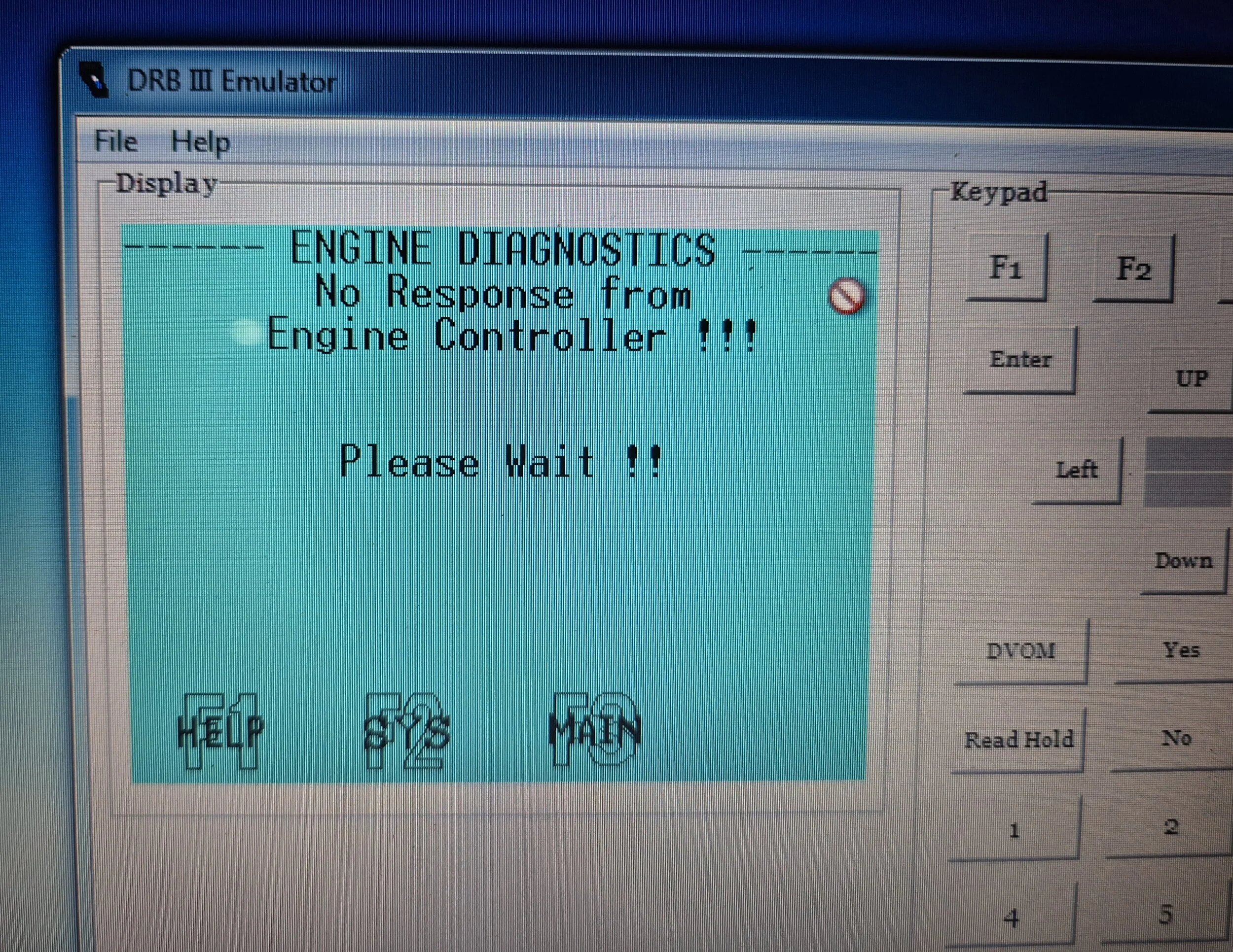

Hello from sweden ! Long story short... I have a jeep zj 1997 that has been in the family for years and i wanted to start it up and restore it.. There has allways been an issue with immobilizer not working so my dads solution was to turn key to radio mode then remove battery... But i wanted to fix everything so i found out that PDM (Passenger door module) had a broken capicitor. Even though i bought a used PDM and now i i trying to program a new key fob so i bought a micropod 2 and followed all these steps... After 8 hours i finally got everything to work... I got contact with the PCM and could read error codes. But after abit i could not get any comminucation... so i did the solder as described in the instructions. Somehow i could see more settings but still i cant get any comminucation... I re checked my solder and i had contact on the correct places so that should not be any issues... Could it be that immobilizer is refusing the comminucation between modules? Im soon out of ideas so if anyone have any suggestions i am happy to read them! Tomorrow i will check power supply to each unit. Andy A if you see this i would like to get in contact with you to exchange ideas.

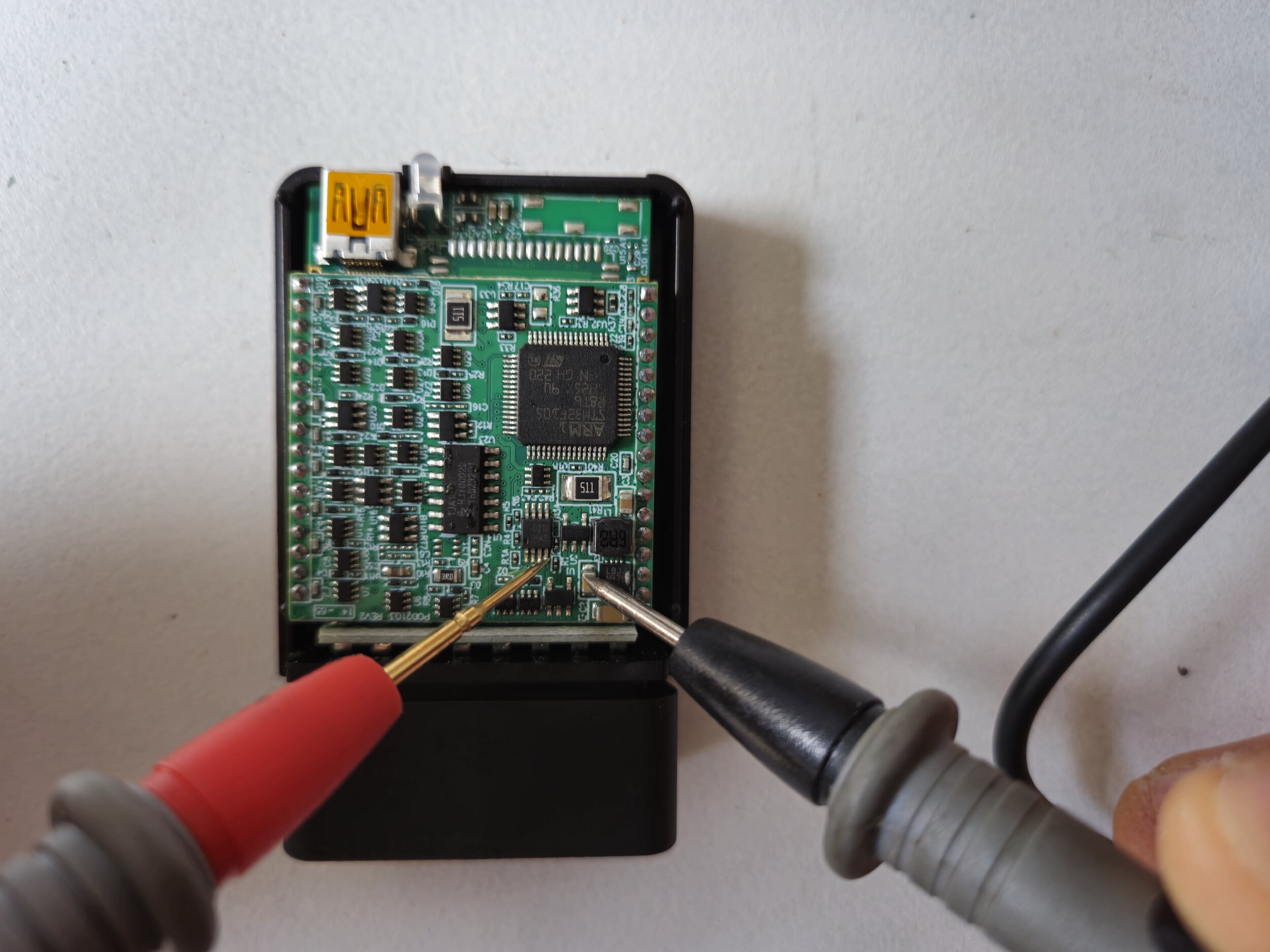

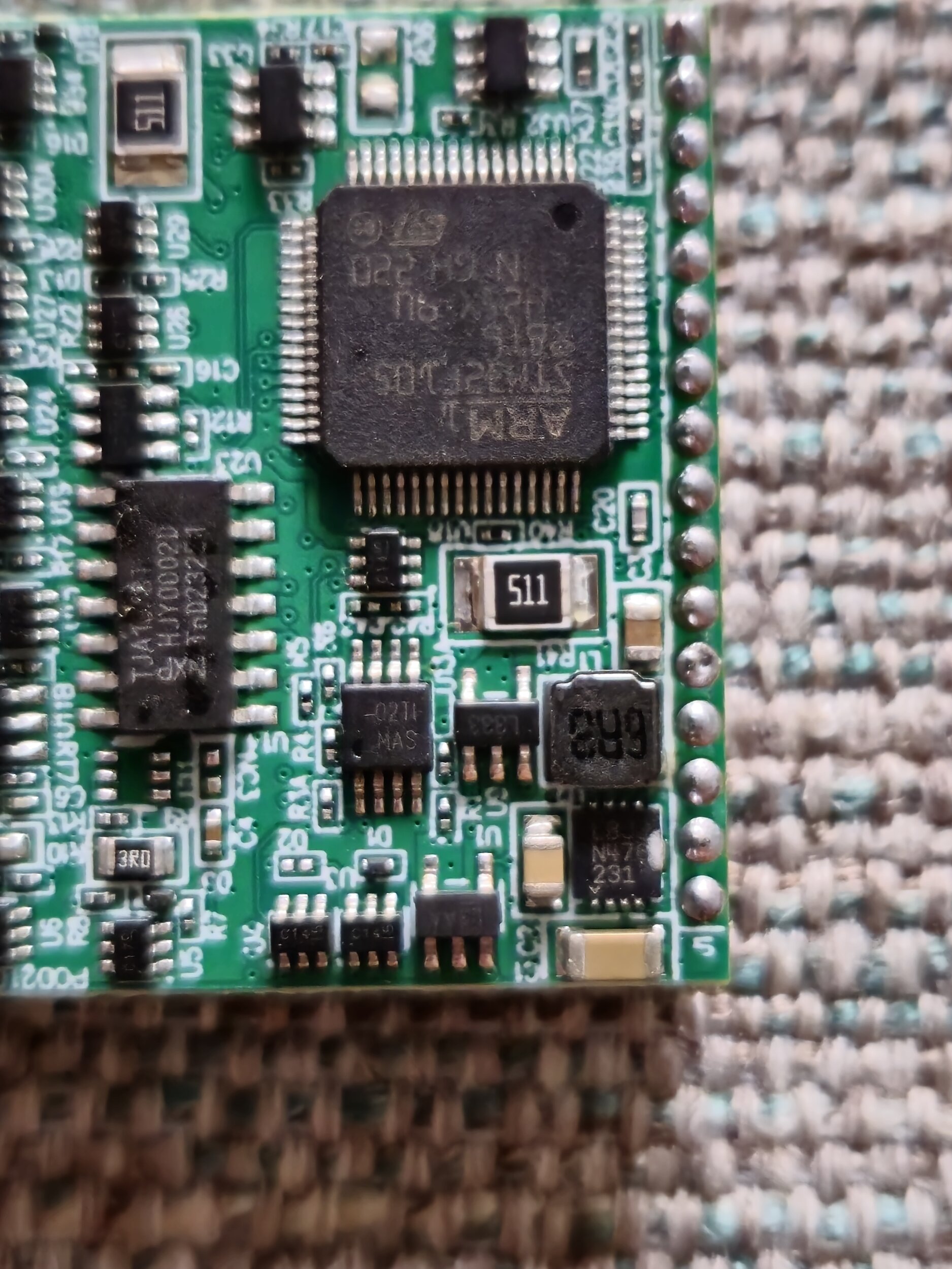

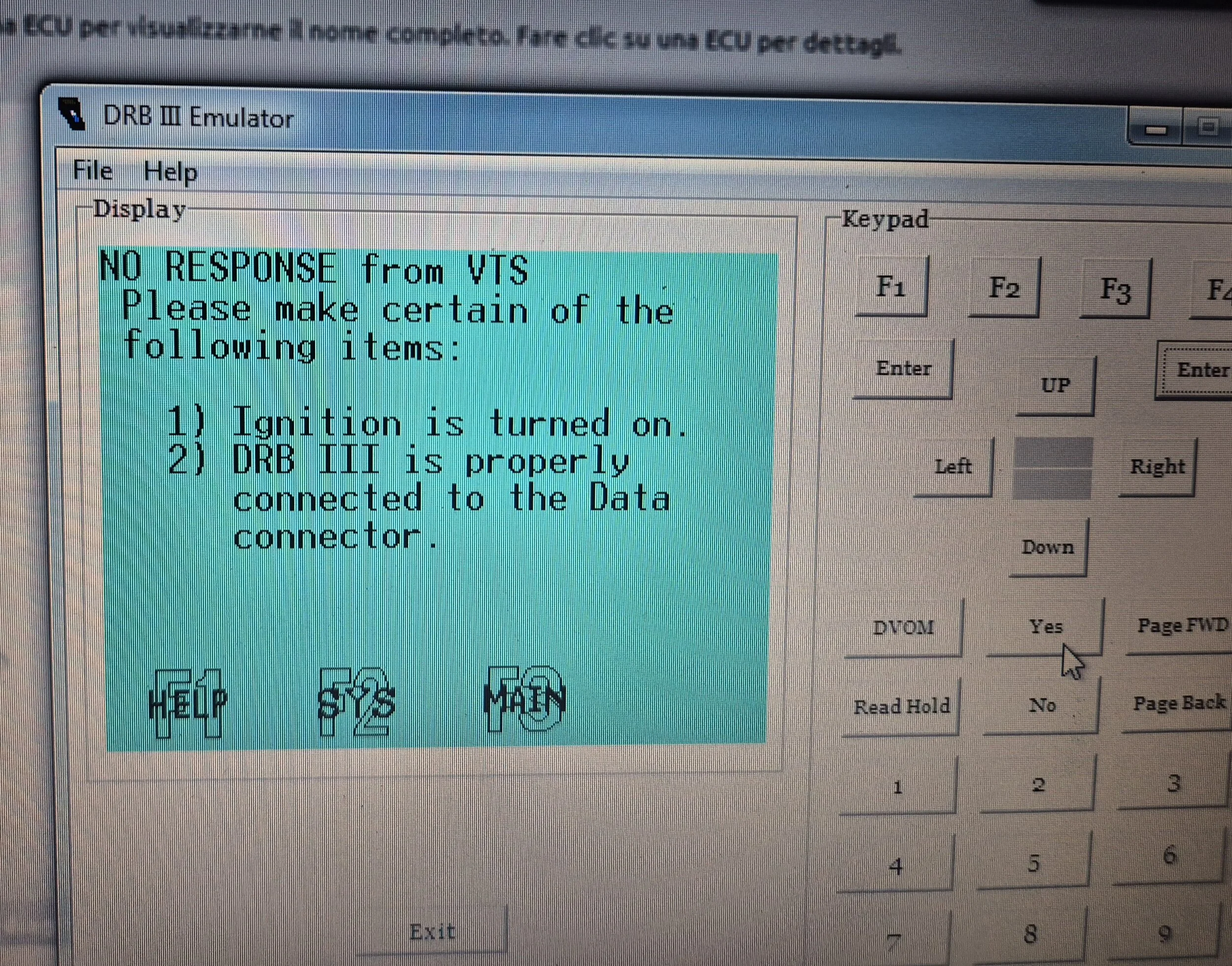

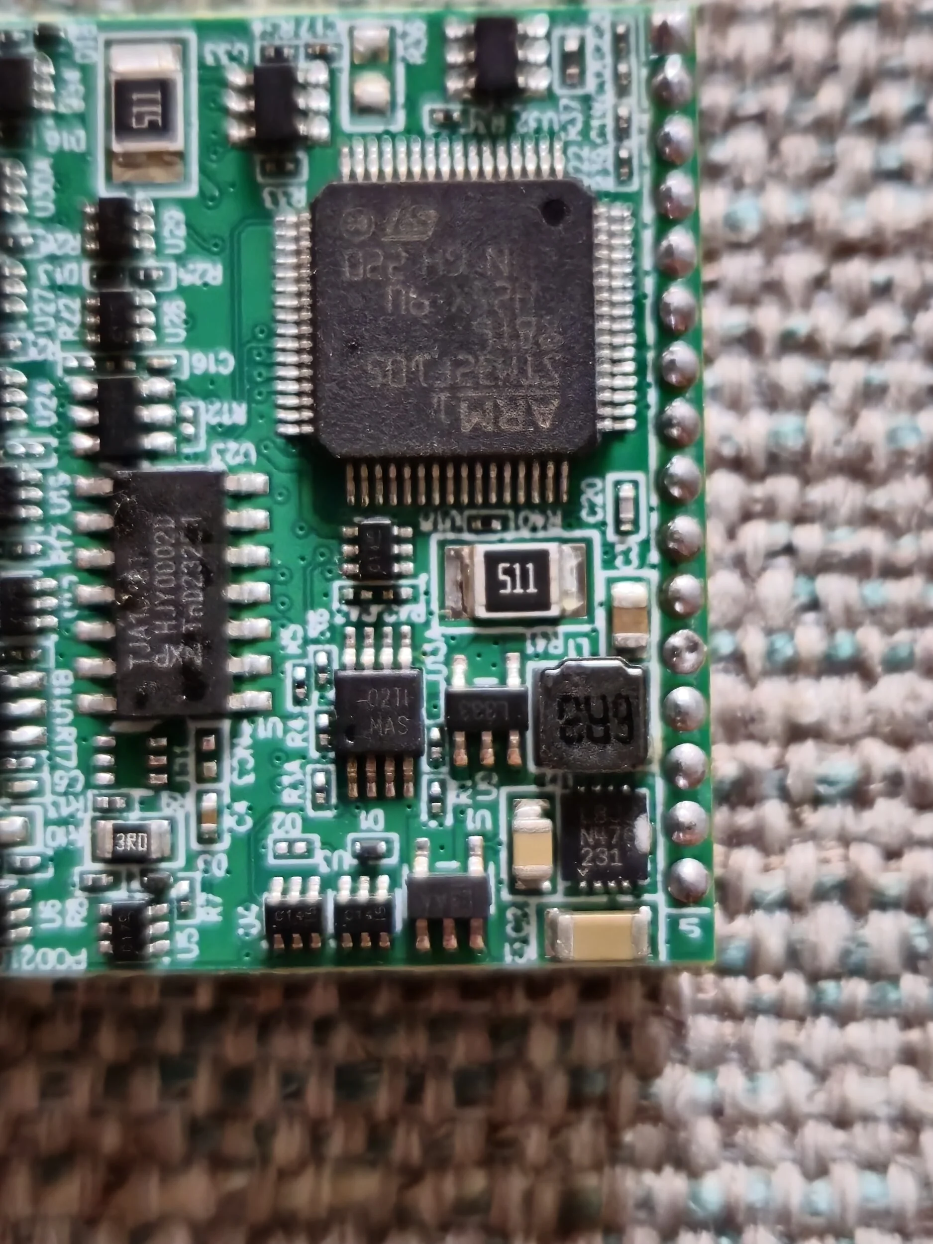

Hello my name is Angelo, I'm italian. Now I have a xj 2.5td of the 2001. I had a wrangler but it was stolen. I need to program a new remote control (which I bought used). I have a problem with micropod2 that i buy on aliexpress. The device does not communicate with the control unit.I installed everything on an old PC with windows 7 with 1 GB of Ram, the program starts perfectly.
Do you think it could be a defective micropod? Or do you have to make the edit posted by Andy? My micropod mounts this integrated device:
Thank you in advance for any clarification and help

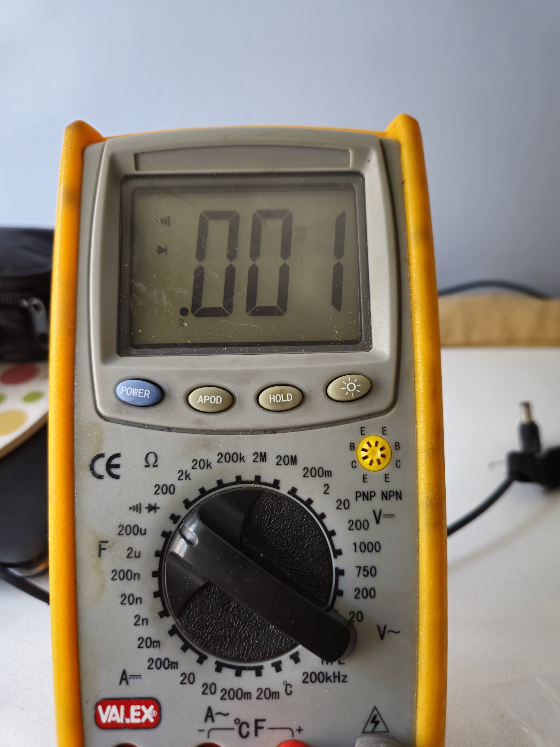

Small update I did the test with a digital multimeter.... There is continuity between pin 4 and ground. So the welding of Andy's case should not be done. I try to install the witech again and try otherwise I don't know what to do anymore. Anyone with any ideas

It sounds like your micro pod could be defective. I have had nothing but issues with purchases on Aliexpress.

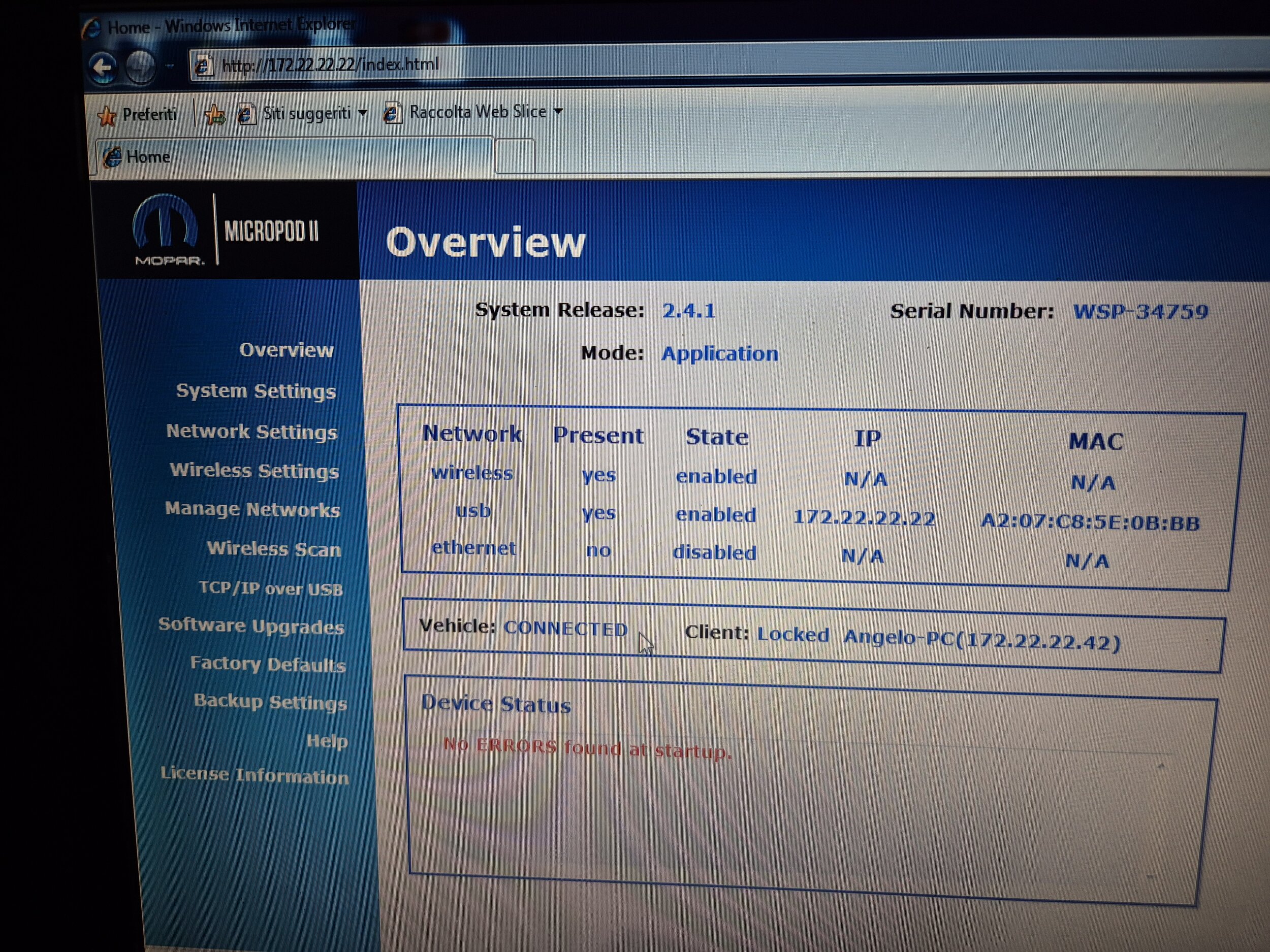

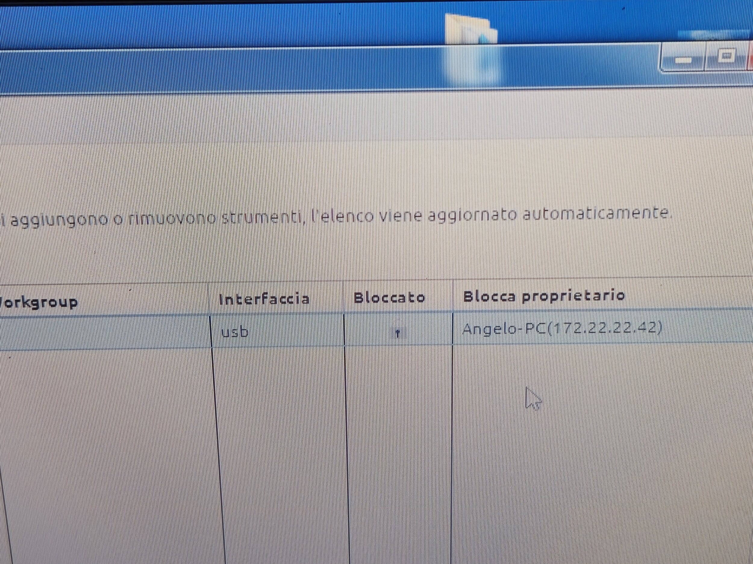

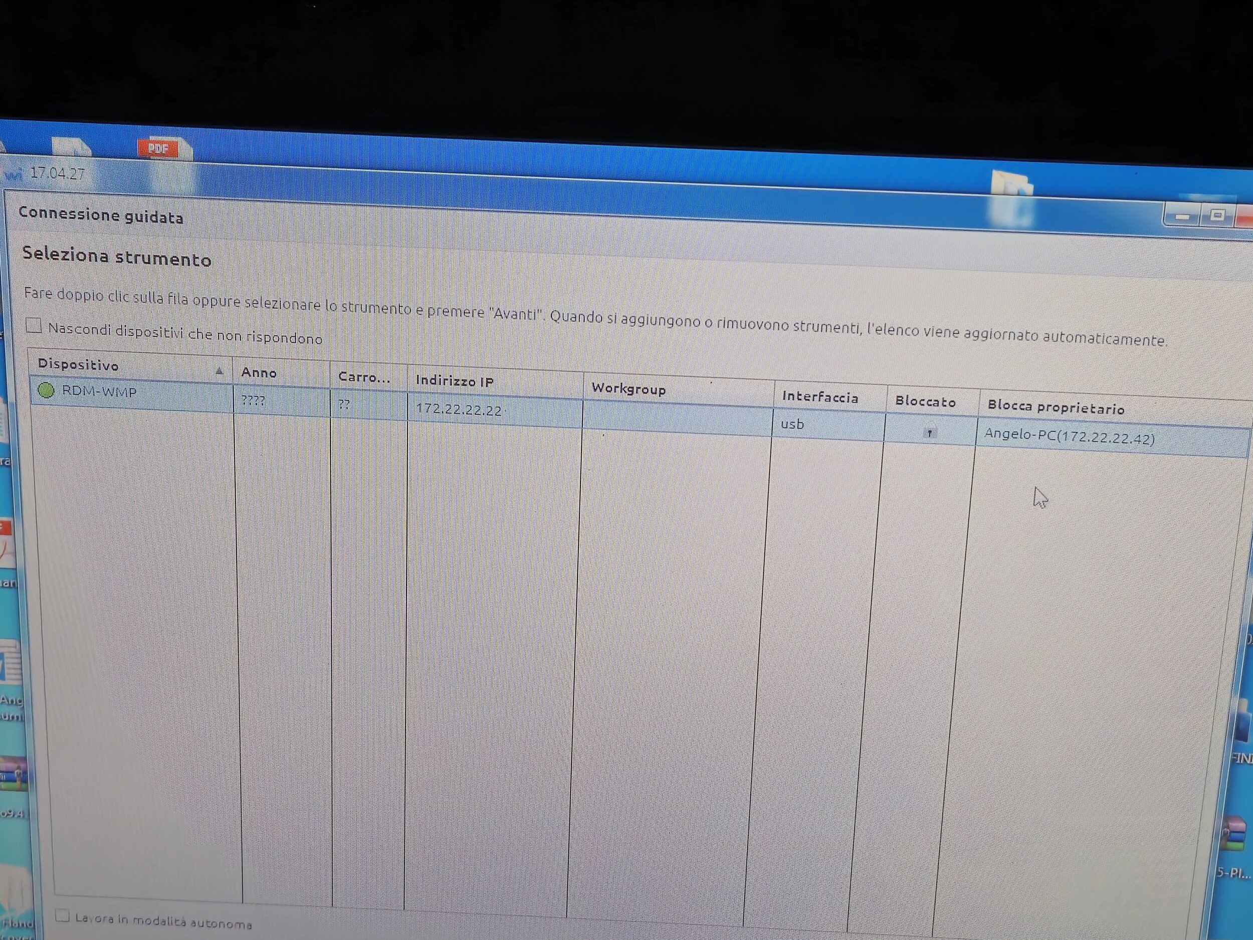

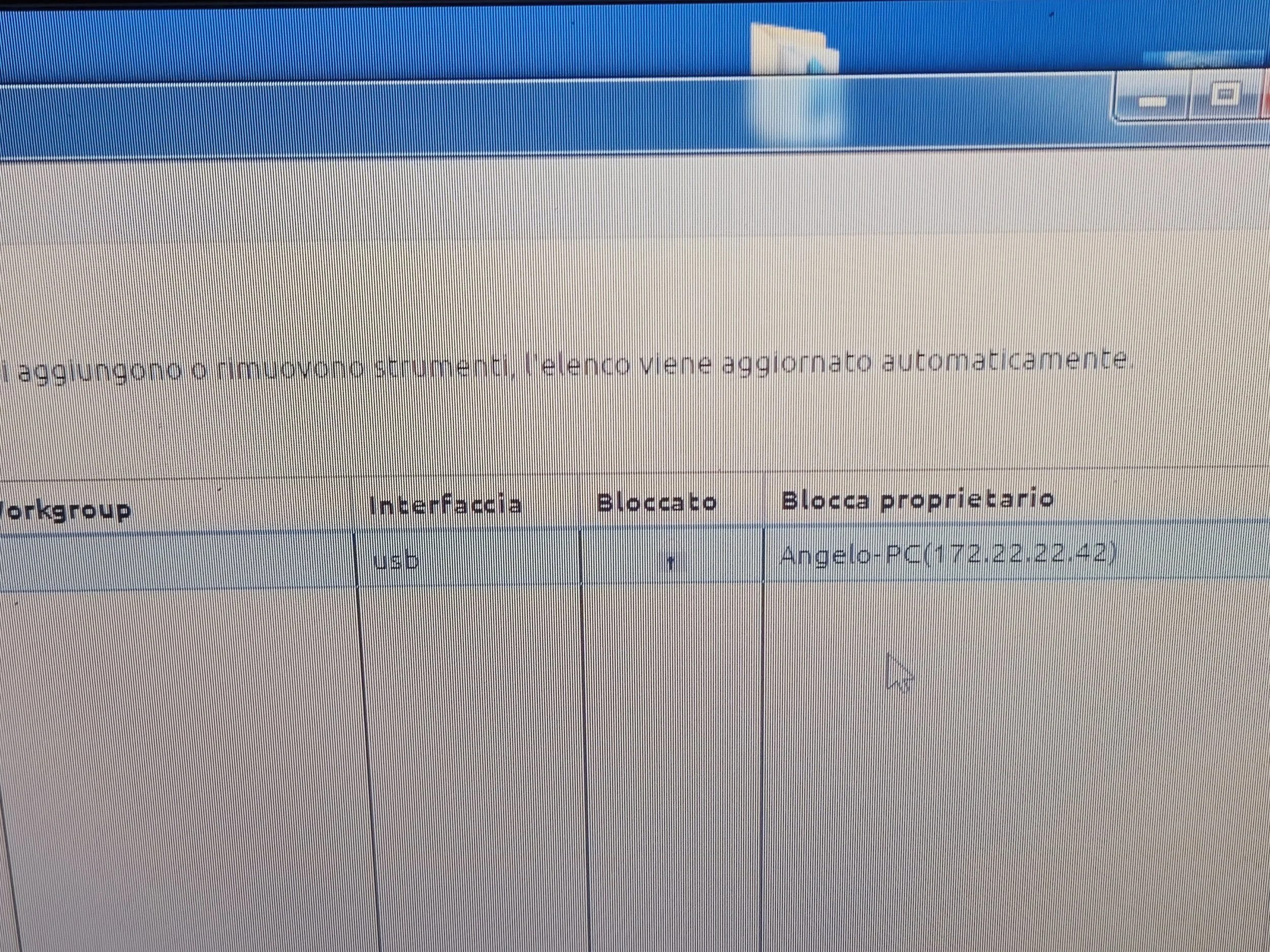

I reinstalled witech with the previous ones written above..... In the end I got the same results as before: the system does not communicate with the control unit. I also wanted to point out that once I start the drb emulator (while the drb is running) if I go to open the witech again the device is locked indeed my account is blocked for the device (you can see the photos above).
