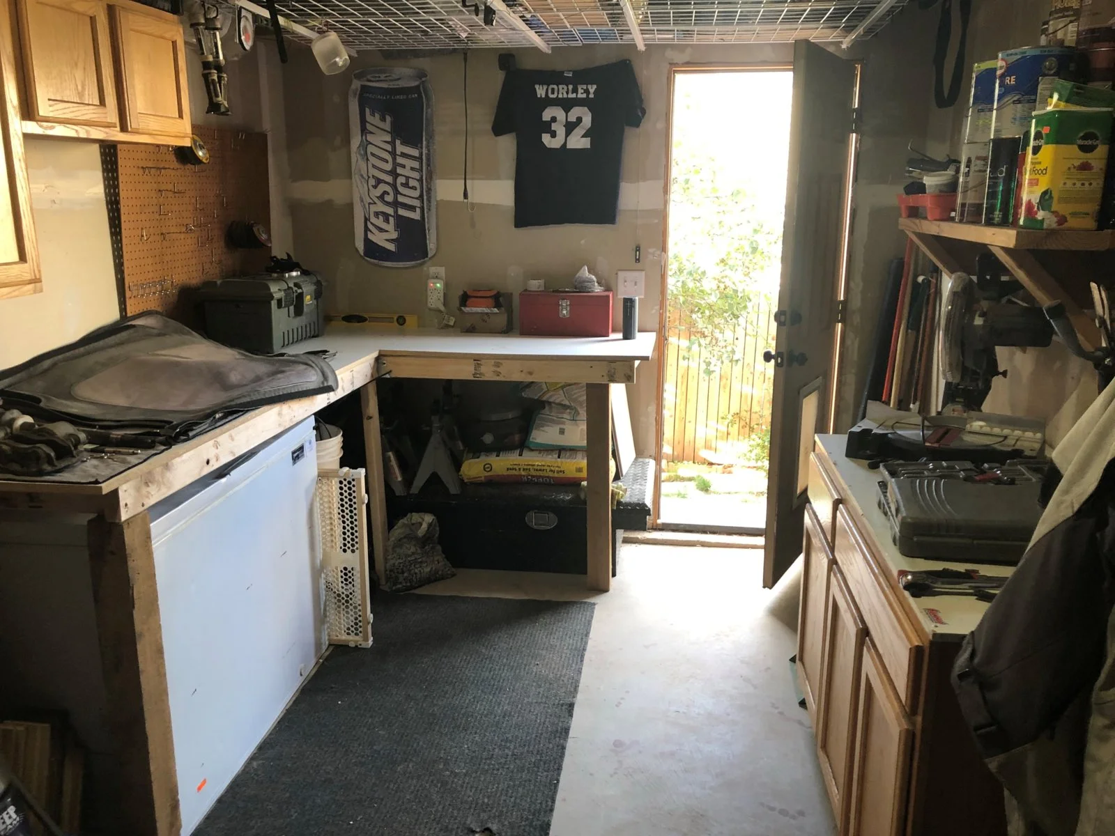

Space is limited as the garage is only 10'. Should they be 1' away from either wall vs 2'?
I may be way out there but now that you mentioned your 10' wide ceiling, I'll add some random options. My main goal is reducing shadows.
Your ceiling looks about 9 feet high, while 1 foot away from the walls you could hang them a foot or so below the ceiling.
You could put the lights about 6" below the ceiling on the walls. Of course any type of "shades" built into the lights could or any plans on adding shelving would reduce the light.
If there's a plan for built in shelves up high, the lights could be mounted underneath them.
Mounting the lights at a 45 degree angle where the ceiling meets the wall.

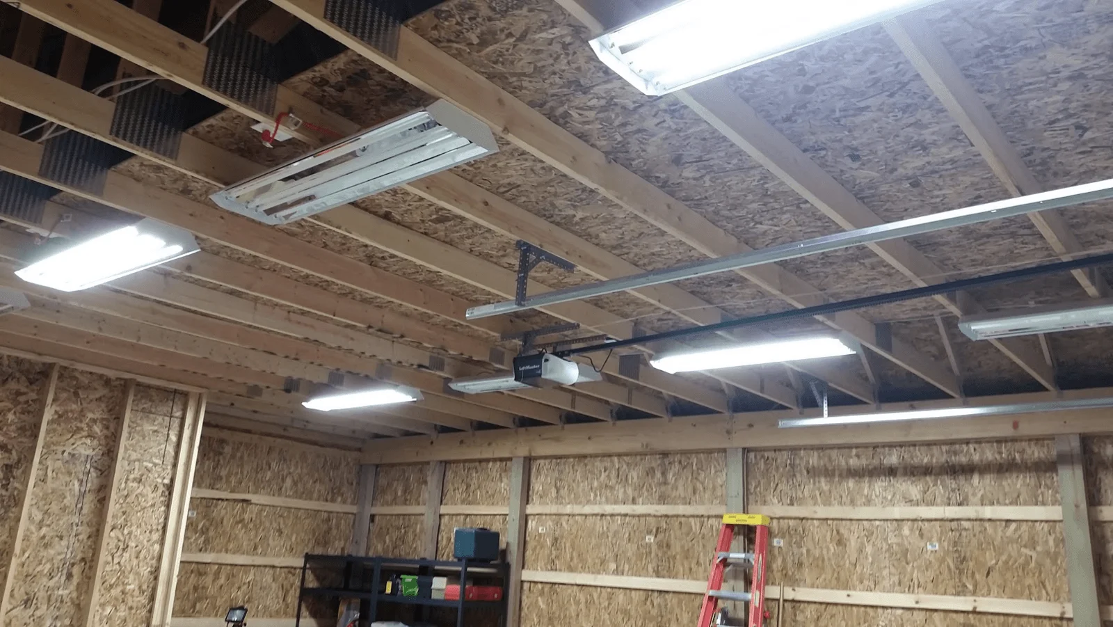

Found a picture of my lighting solution. This is half on, half off. Barn was still under construction at this point. One of the reasons you get more light out of a florescent tube vs LED is that Florescents illuminate around the whole tube, while LED's are very directional. So, you can use reflectors in a Florescent tube to reflect that light going upward back down to the ground. That was also a factor in my decision...But, like I said, I installed these 3 years ago and the LED technology has come a LONG way in that time. Costs have decreased dramatically as well.

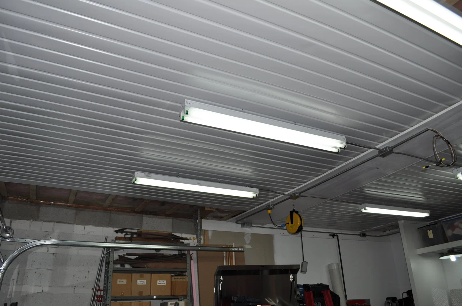

I used T8 32 Watt Daylight bulbs when I redid my garage lights. I don't know if LED's were available then. I sure would have considered them. I definitely agree with the comments above about having a white ceiling. I did NOT want to drywall mine. I drywalled the walls (not complete in the pic below) and painted them white but because I couldn't empty the garage when I did the work, lifting drywall to the ceiling would have been tough.
I used aluminum soffit panels (16"x10' each). They are light, white and easy for one person to install. There was no taping, seam filling/sanding or painting. It makes for a nice industrial/commercial look and the cost was about the same as it would have been for drywall.
Where did you get the panels? I really like that look

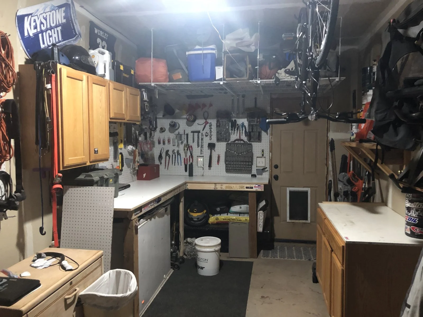

This is what I have to deal with over my bench. Next house we move into is going to have nothing smaller than a two car garage. Getting this space into a workable area and still being able to park inside has been a battle.

I bought them at Home Depot. I might have got a better deal at a wholesaler but they weren't that expensive. They're sold in individual panels and I picked them up as I needed them. They fit together like tongue & groove lumber and I used white aluminum soffit screws (#6 x 5/8"?) to secure them to the strapping. As I mentioned, it was quite easy for me to put them up 1 panel at a time. I spent more time moving things around on the floor (cars, tools, equipment, etc.) than I did installing the panels!
Here's a link. It turns out that they 16"x12' (not 10'). They've gone up a bit in price. I think I paid about $14.50 CDN / panel but that was about 10 yrs. ago. btw - they look the same (clean & bright) as they did when I installed them.

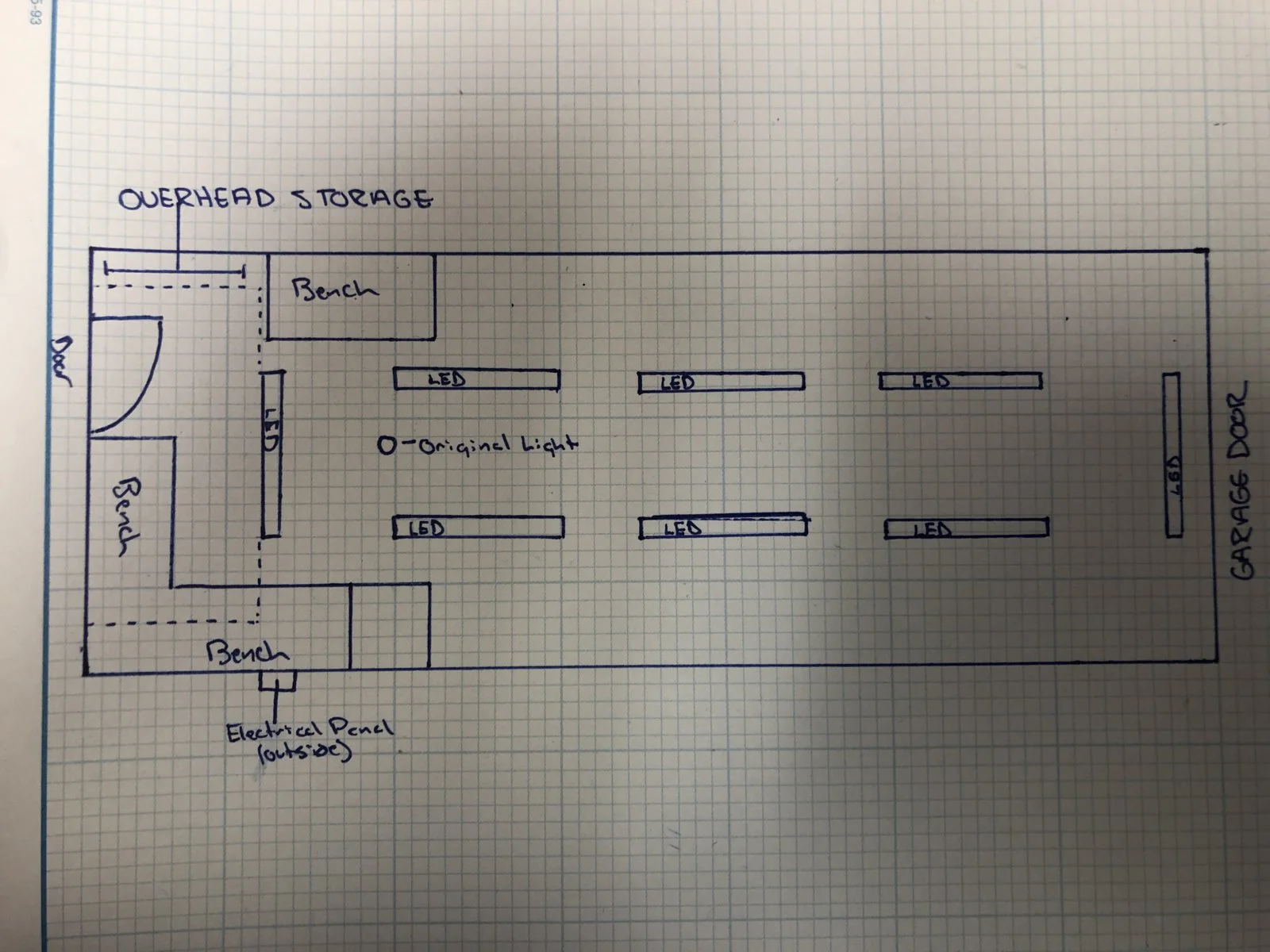

Here is an updated plan that is actually drawn to scale (work is a bit slow today)

Put some of your lights above the benches, if you are standing over your bench, your body will create a shadow. I have the problem in my workshop now, 24x48, it has 9 pairs of 4' florescnets and it is ok for light but the benches are not lit enough so I had to add separate lights over each bench. Also LED's come in 2 configurations, one is omnidirectional light, the other is focused. The Focused do not have any frosting on the light tubes, they are like a spot light, the omnidirectional are a frosted light like a florescent. The omnidirectional will reflect light off of your ceiling if your fixtures do not have reflectors. Good lighting is not just thowing fixtures up, it take someone to look at everything you will do or may do in your garage and light placement is part of that equasion. Tim
Another thing to consider is putting your lights wider than your vehicle, if they are over the top, it will shadow underneath the vehicle, if it is more along the wall, it will help shine under it. I need to play with putting a light in the corner between the wall and ceiling, pointing generally down but also towards the center of the floor.

Thanks. I Like the look too and it's great to work in ... very bright!
I'm sure there are similar products. It's basically soffit aluminum that is cut to length on site and screwed in place so no doubt someone carries it.
In my application, I installed joists on 16" centres and jammed 8" strips of pink fibreglass insulation between them. I then applied a 6mm vapour barrier and 1"x3" strapping on 16" centres. The soffit aluminum is screwed to the strapping. I would think that the aluminum and strapping would plenty strong enough to hold up blown in insulation.
