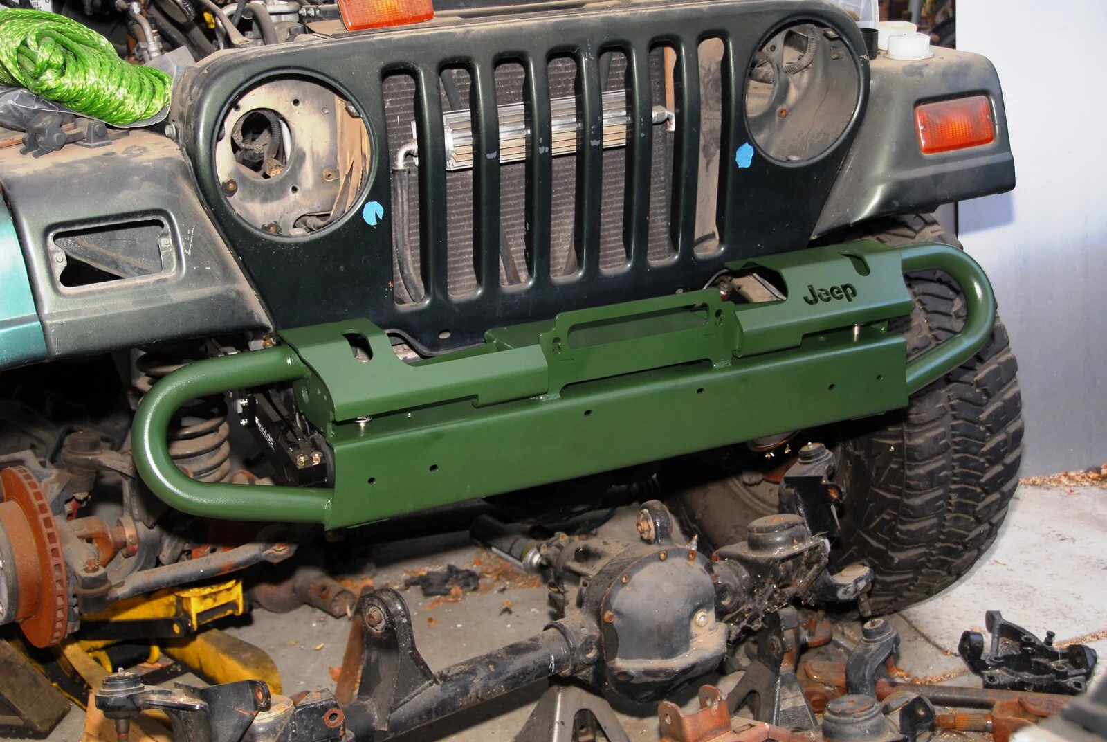

If I stick with the Mopar Rock Crawler bumper,
It is an astonishing amount of work to make that all compatible. You start by cutting off the end tubes, creating a new location for them, modifying them to clear the bolt heads and then completely reworking the end plates. If you have a rig that the frame width is a tad more than some, then you are dealing with an even higher level of tedious. The challenge is to make it all look like it came that way and it is not easy.
Based on your thread, this was my take on it. I'm confident I could do the former, with less confidence on the latter. Then, there is the issue of cutting up a part that is difficult to come by. I've grown to like the bumpers oddity, so I'm highly resistant to cutting it up!
You have to have another unmodified bumper in front of you to compare it to mine to tell that it has been modified.
