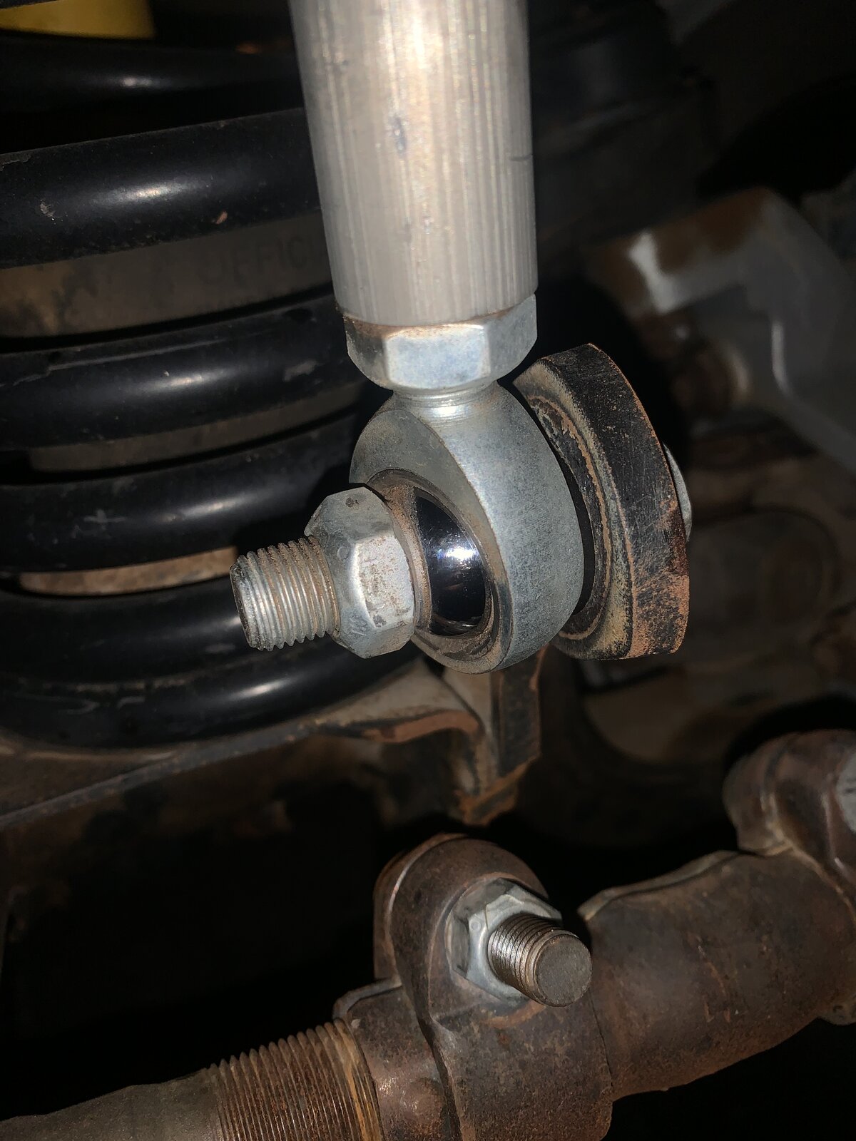

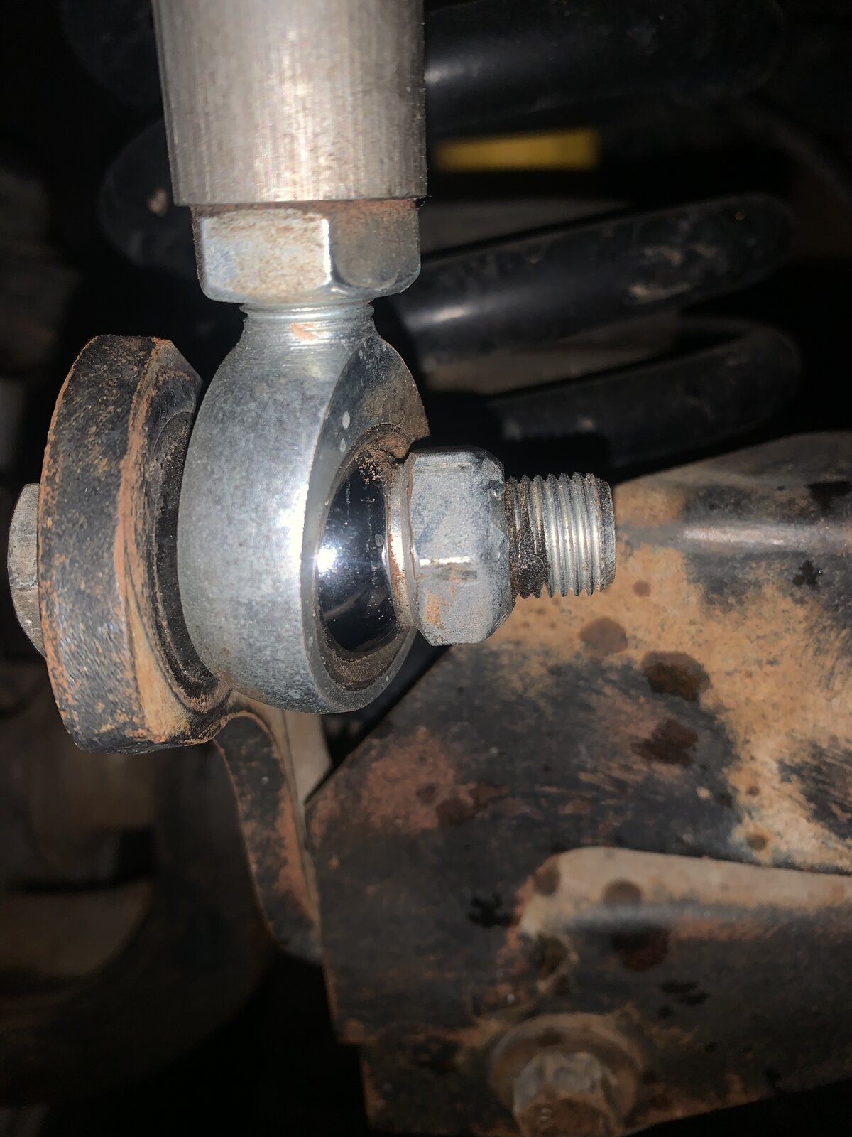

The linings have begun falling out of 2 of the heims and one has completely fallen out. I have this installed for 5 months with less than 2k miles put on it if that. Noticed clicking recently last weekend. Found the liner issue today when I was cleaning it. Pics below one liner completely out and 2 more on their way.
Still a good product but they need better heims unless I did something wrong with my install.
I found @jjvw info on his replacement and similar symptoms. May give these a try but they are about $50 a piece.

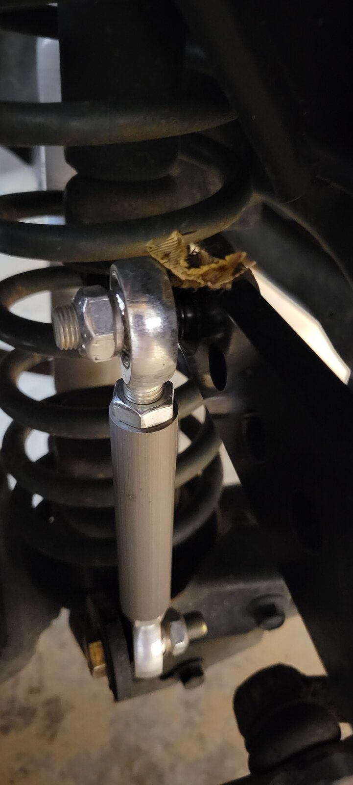

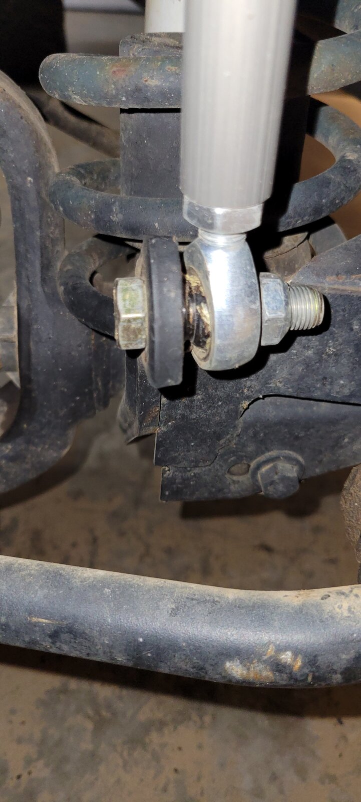

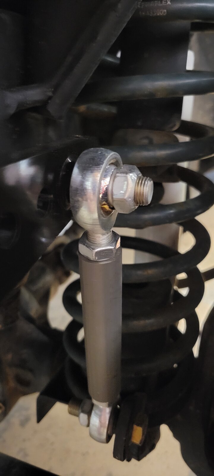

Hey I’m having a similar experience. I’ve only had my swayloc for less than 2k miles and it seems the body roll is back. I’ve done only two rock crawling trips
But I’m having trouble identifying the issue with these heim joints. I attached some pics if anyone has any feedback?

One would think to get the body roll back,that one of the end links would have to be completely disconnected ?

Have you made sure the lock is fully engaged? Mine will get “stuck” occasionally and I need to spray some water in to get dirt and crud out.

My liner was completely gone on one of them. It would allow
one of them to move and jingle at idle as well as click when in operation.
