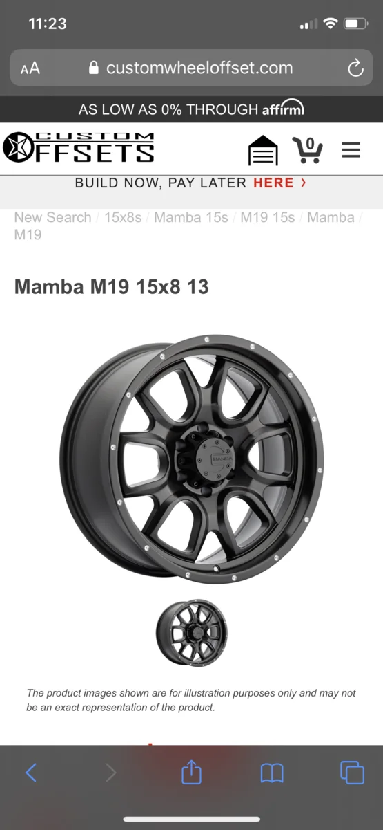

Ford ranger Alcoa wheels from 2001-2007 are 15x7 and 4.5" backspacing. Mamba MR1X is 15x8 and 4.5" backspacing. But agree that it is hard to find.
Found out mamba makes more than just the mr1x with lots of backspace. They have this 15x8 wheel with 5” backspace. That would go perfectly with hub kit resulting in 4 1/8” backspace in front and then I could just run a 1” spacer in the rear.View attachment 181207
Just wanted to add this comment in case anyone in the future finds this discussion.
I have the Mamba MR1X. All of the info I saw online said the centerbore is 71.5mm. I just went out and measured and it’s actually 54mm, way too small for the locking hub to fit through.
Reactions: starkey480
Wow thanks for the info! That would be a disappointment
