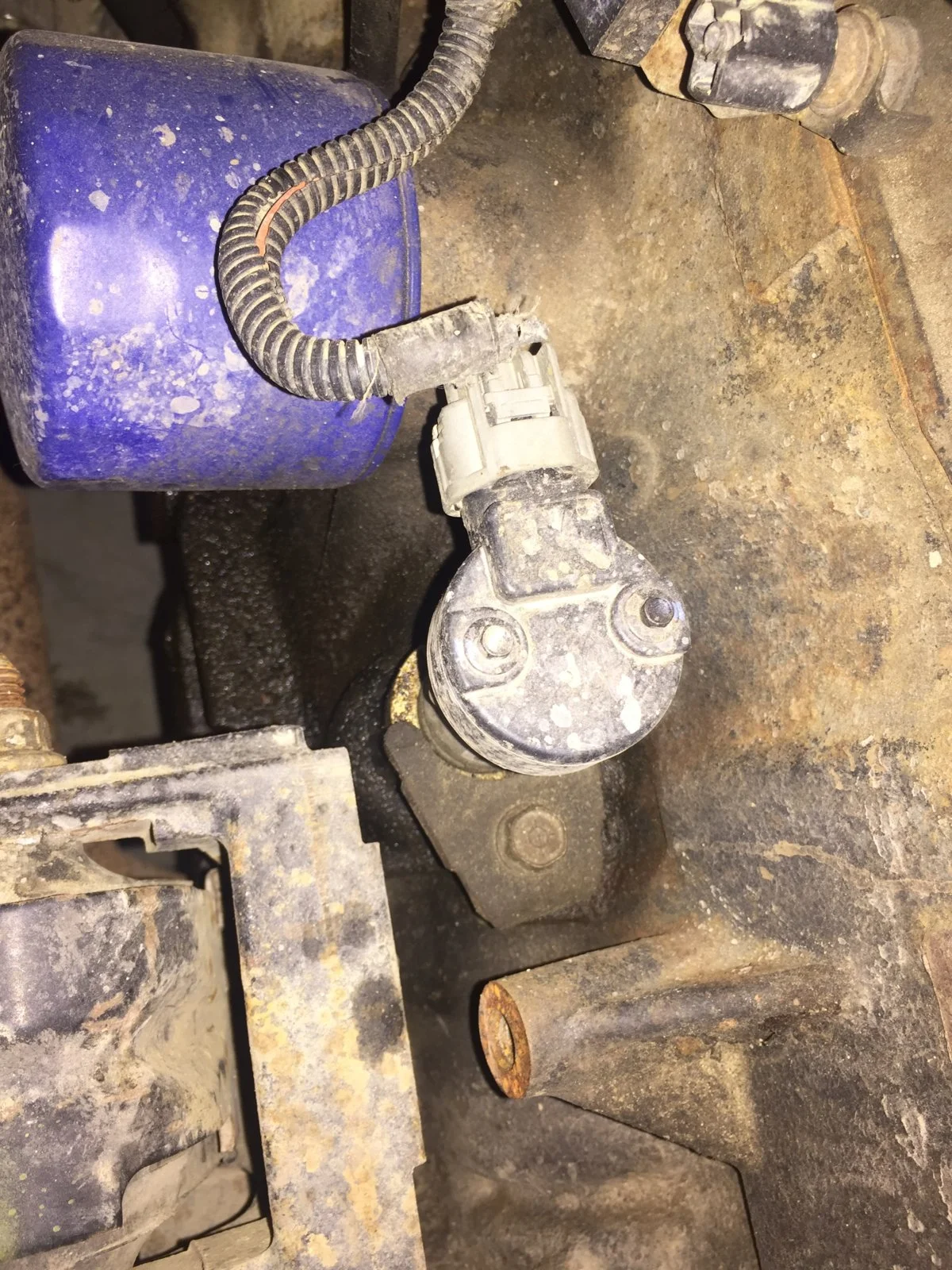

Interesting, so it may be the cold after all? I’m not sure if the sensor I have is OEM or not. Is there a way to tell?
The sensor in your picture looks a lot newer than the OPDA. Can't tell for sure but throwing codes when cold is the main symptom of all the new sensors I tried. An original, OEM (old) sensor fixed my problem and countless others with the same issue.
Reactions: Carter6
Carter6
Jan 27, 2019
50
Whitsett, North Carolina
I think you’re right seeing as it didn’t throw a code today. At least I’ve got an OPDA now for when mine does start to fail. I take it the best place to look for an OEM sensor is eBay? Do the new Mopar ones work ok?
g.hayduke
Feb 19, 2019
792
New Mexico
I tried a new Mopar sensor and it threw codes when cold. I have heard some say that the newer Crown sensors are good but I can't confirm or deny that.
The only old sensors I have found are on eBay when I search on the original OPDA part number. I bought 2 old OPDAs just to get the sensors (now I have a spare). There are not many on eBay and the 2 I bought both came from Israel, even though the ad said they were in Italy.
You might also try daveysjeeps.com or jeepsunlimited.net. They both part out Jeeps and should have some old sensors. One of those 2 sites told me they have good luck with new Crown sensors but YMMV.
If you get an old sensor, I think you'll be good to go as long as your cam is still good. Replace that OPDA ASAP.

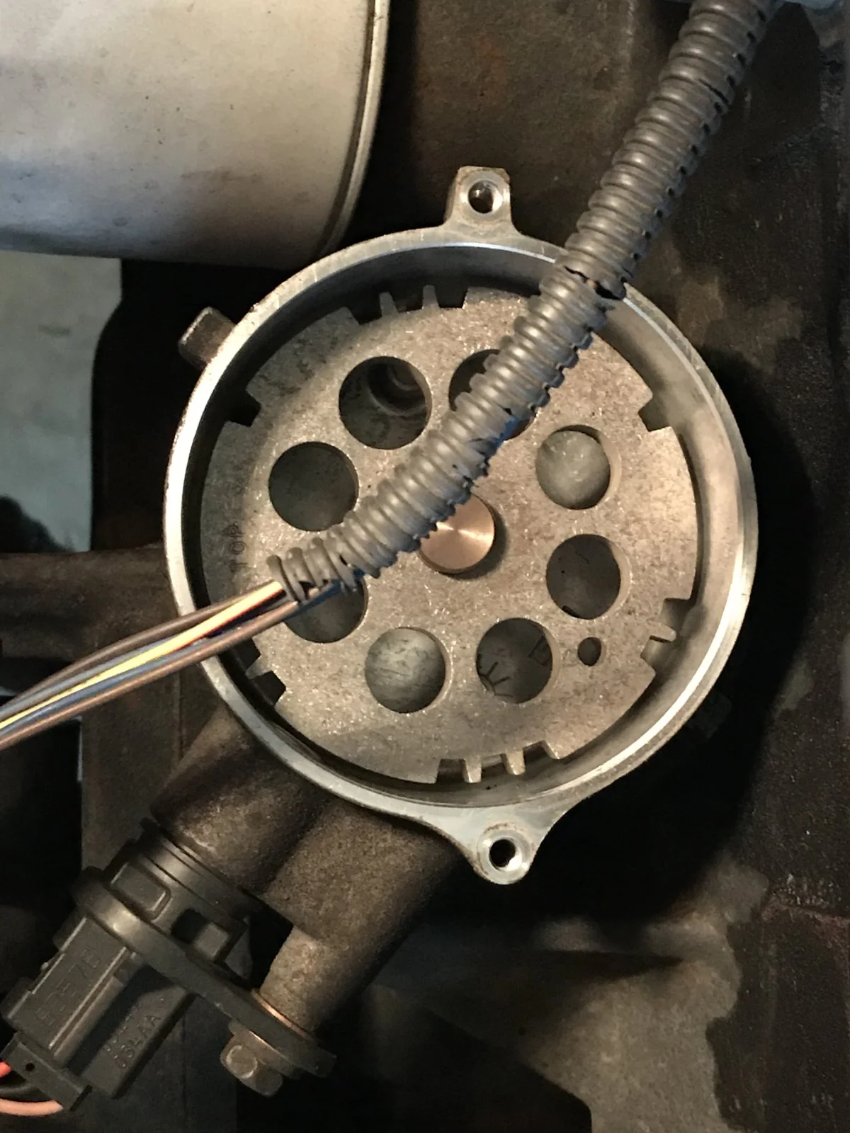

Here is what you need to do:
1.) Remove the top cover on the OPDA and observe the hole in the disk. There is a hole in the housing that this hole will get aligned with. Find a drill bit or something that is a good fit in the hole and have it available for step 3.
2.) With a socket and large ratchet or breaker bar, turn the crank by hand until the timing mark on your harmonic balancer is aligned with the TDC pointer on the motor. If the hole in the OPDA is 180 dgrees from the housing hole, turn the crank another revolution and align the marks again. This brings your #1 piston to TDC on compression.
3.) loosen the bolt on the OPDA and rotate it until the hole in the disc and the hole in the housing are in perfect alignment. Use the drill bit to make sure they are aligned.
4.) Tighten the bolt on the OPDA being careful not to turn the OPDA and put the cover back on. You're done but make sure you did NOT leave the socket on the crank.

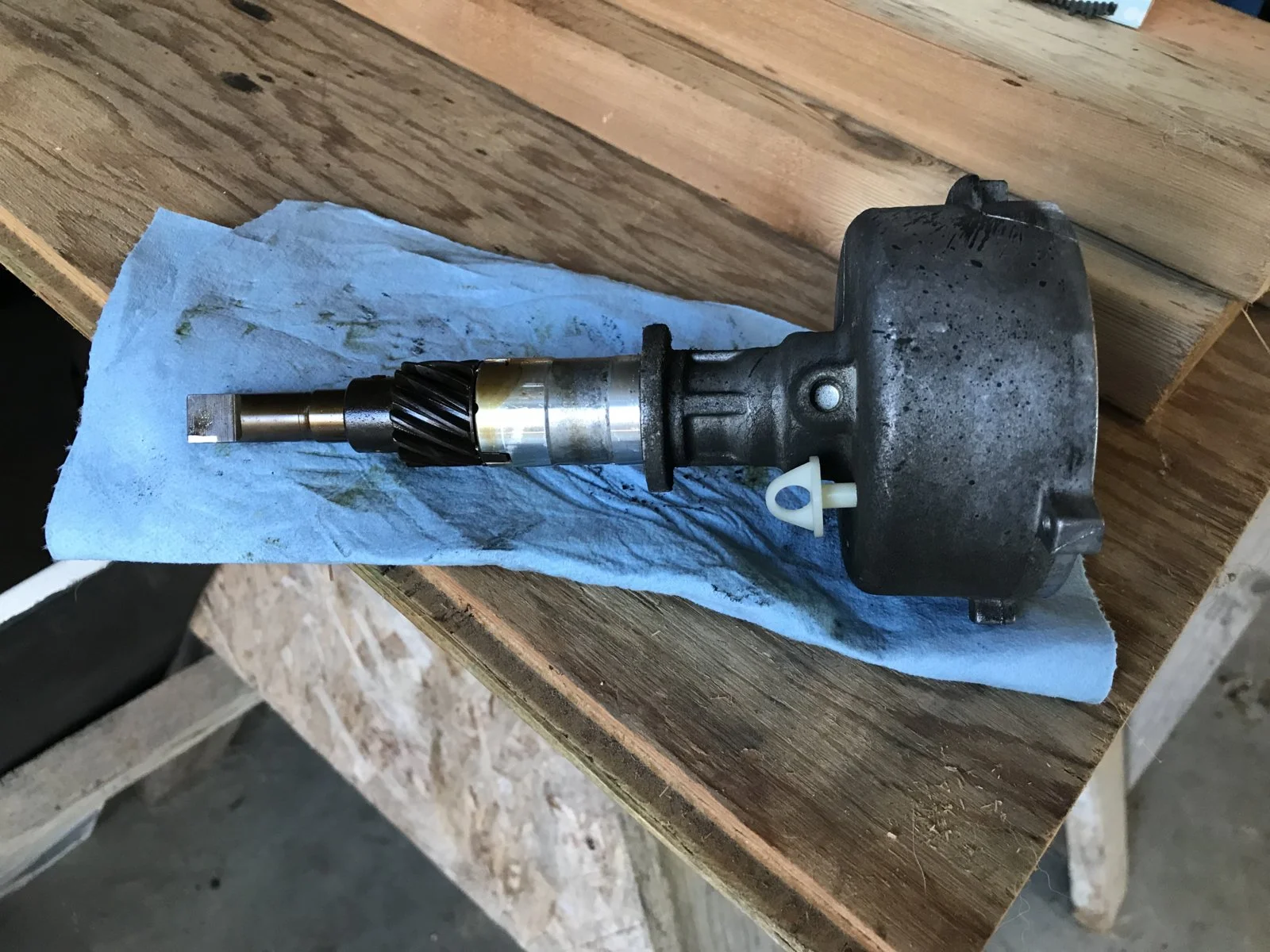

Started to hear the laughing monkeys last week. Replaced my OPDA today and followed the video. Fired it up and so far so good.
81323
81324
A little wear on the gears, hopefully I caught it before it got to bad.
