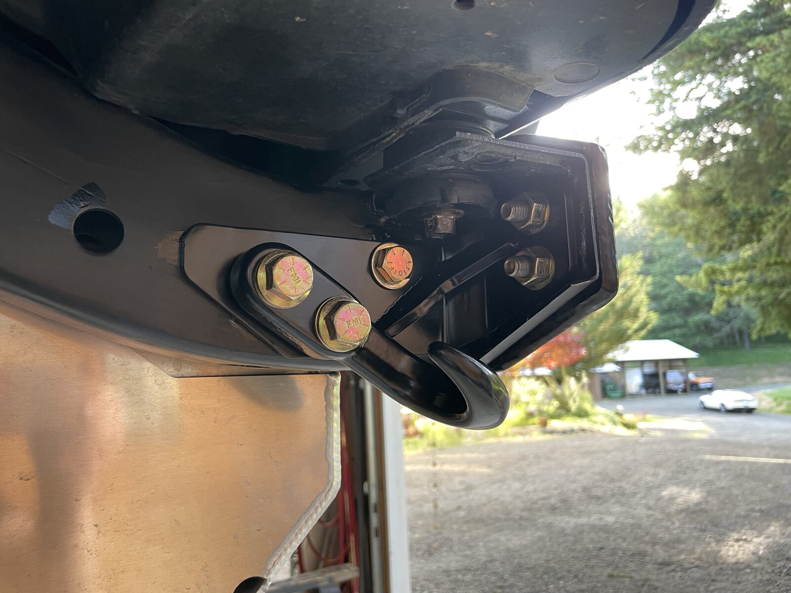

I have their frame tie-in brackets. They fit perfectly and there are a bunch of little details that make them so much better than the other 2 sets of tie-in brackets I bought and ultimately discarded...
Such as?
Reactions: Irun
They need to make money if they are going to be around in the future...
I get it. Just lamenting. But, even though they are apparently no longer making the tie-in brackets, when I called them, they were willing to dig out the CAD file and build a set for me(y)
3 frame holes, not 2
The drill holes line up with the frame holes and bumper bolts perfectly
They are square so they fit well (the other 2 I tried both had less than a 90 degree corner angle bend (presumably from the heat of welding in the brace?)
The corner brace design is strong but still leaves room to tighten bolts
Thicker steel than some
Hardware included: Backing plates, NOT through bolts, which will crush your frame
Here they are (I modified one side to work with a tow hook):

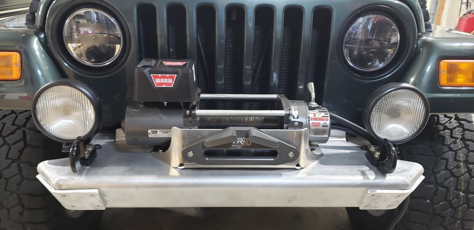

Front bumper is on. I had two sets of aluminum bumper corner guards, so a set of those went on. It took a while to get them to fit correctly, and install the time-serts on the rear bottom corners. Still need to wire the winch and spool the winch line. Also, I have the bumper grill guard, but am unsure if I'll install it.
