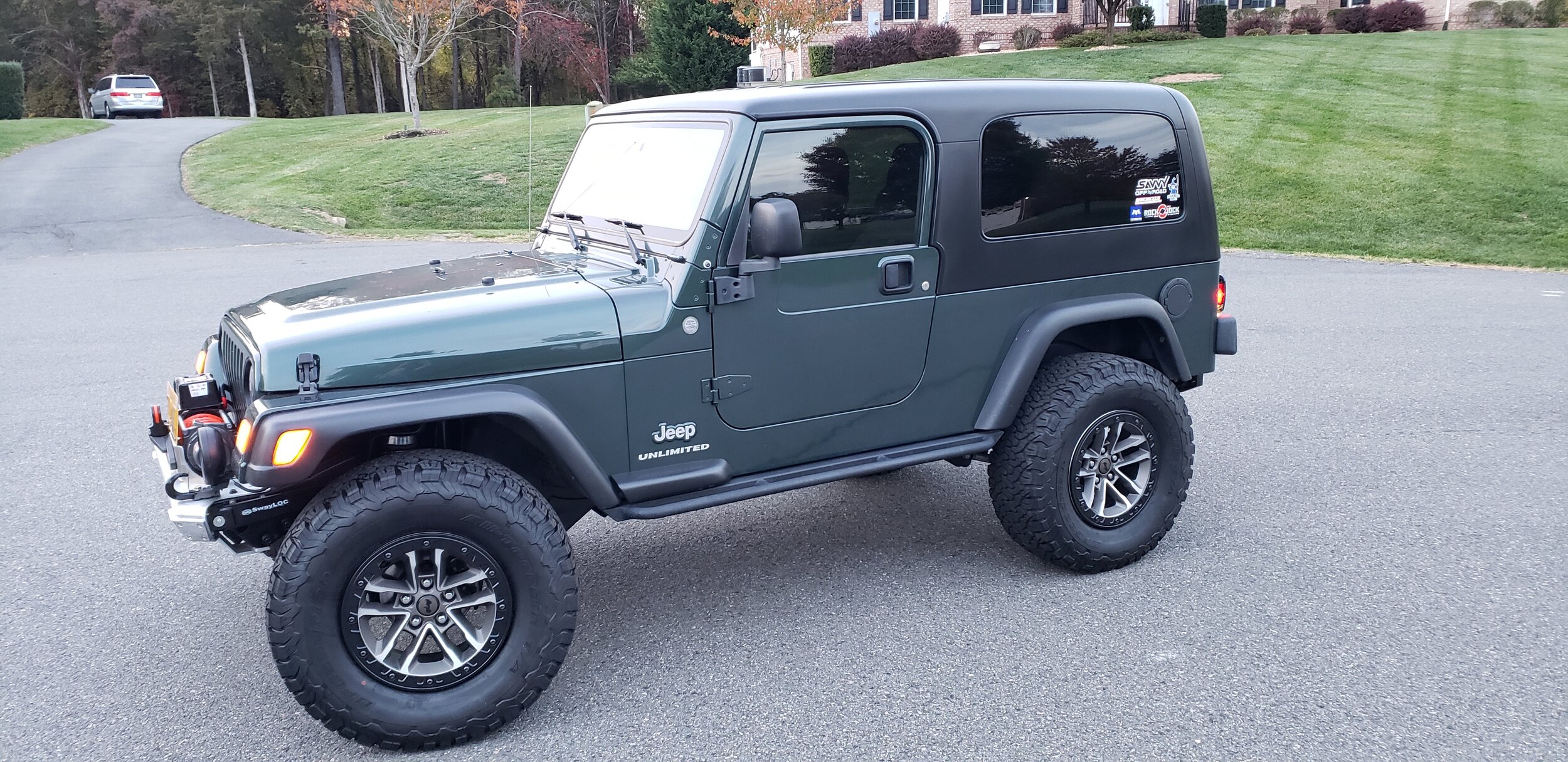

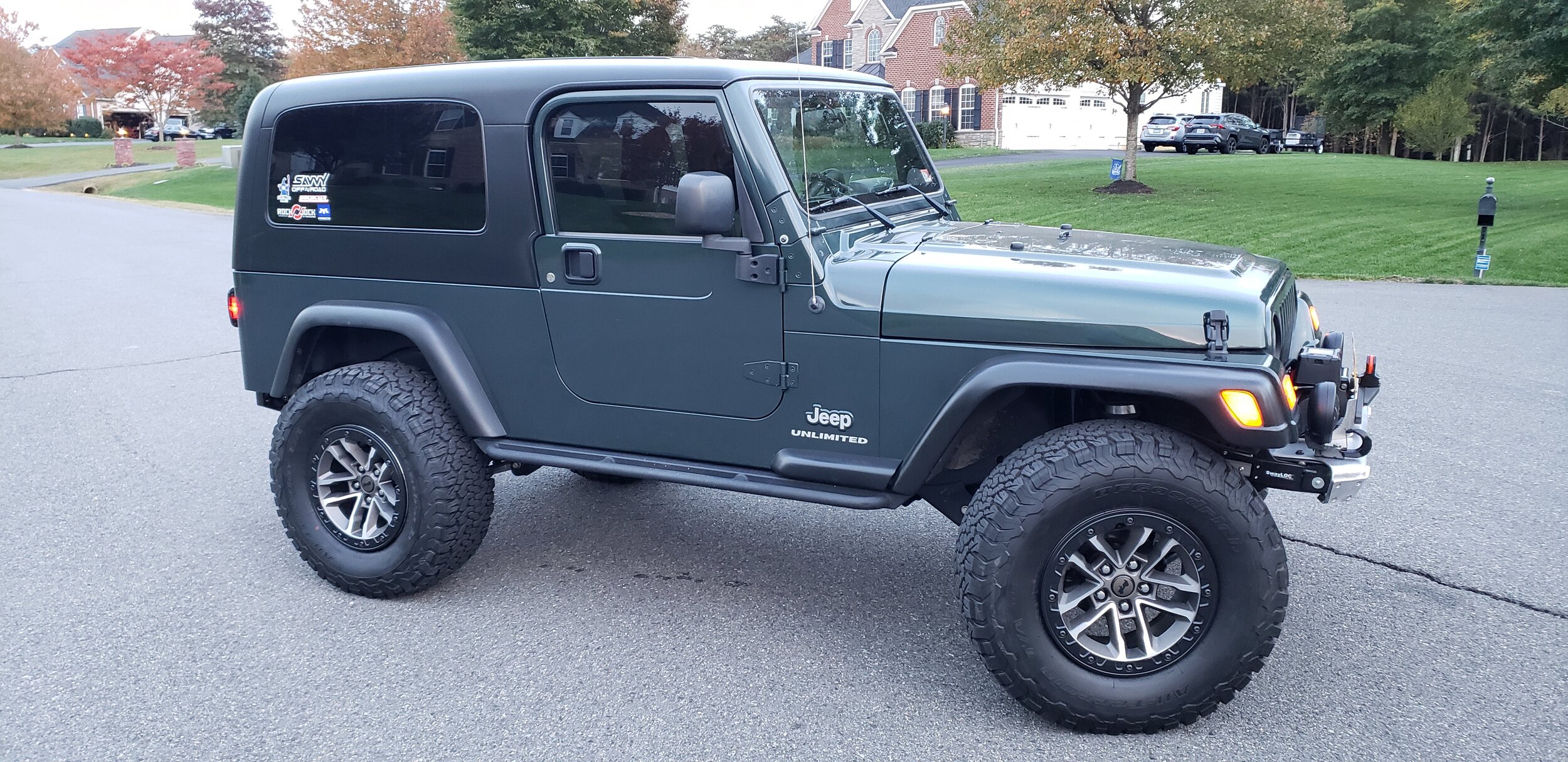

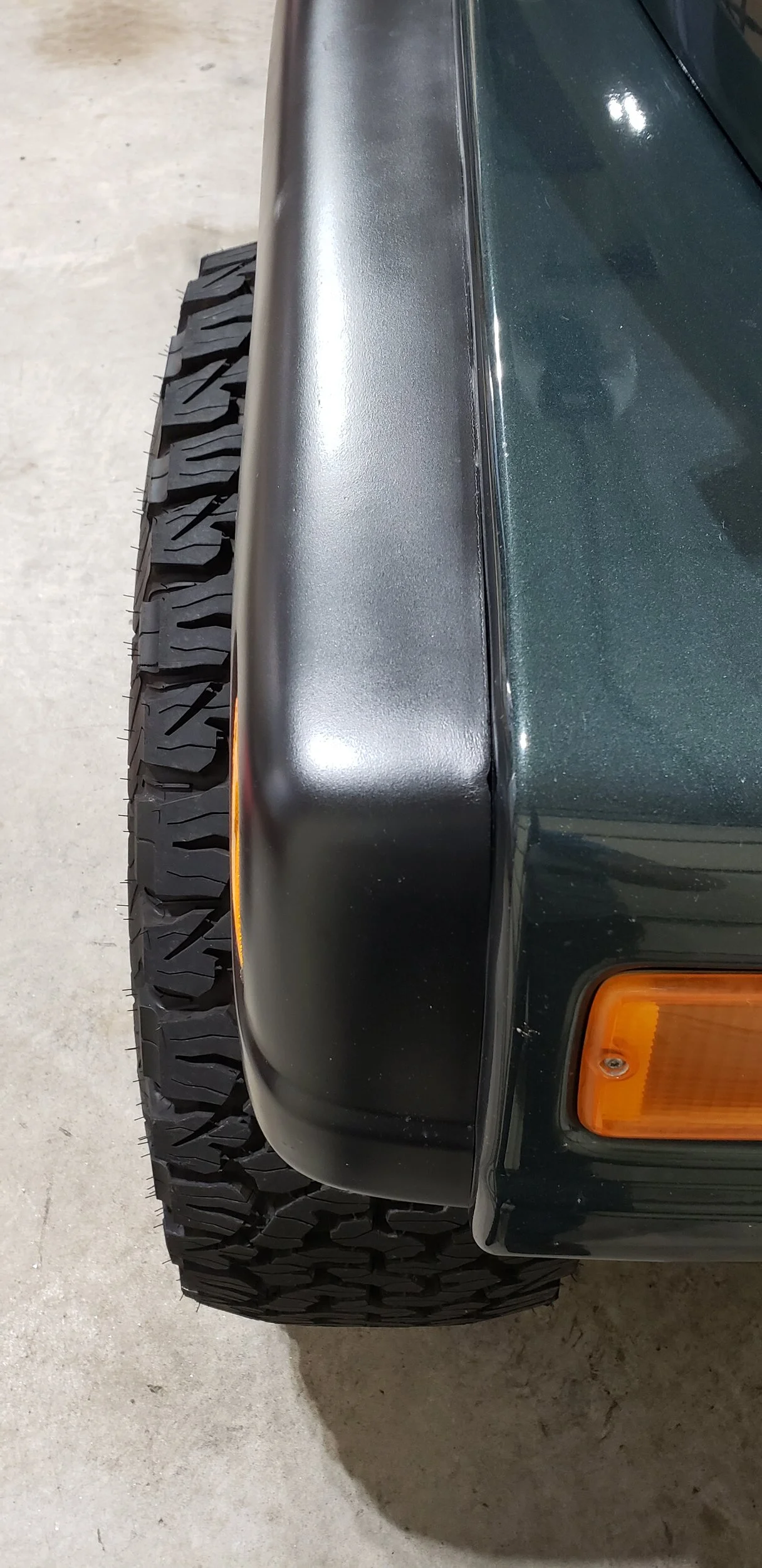

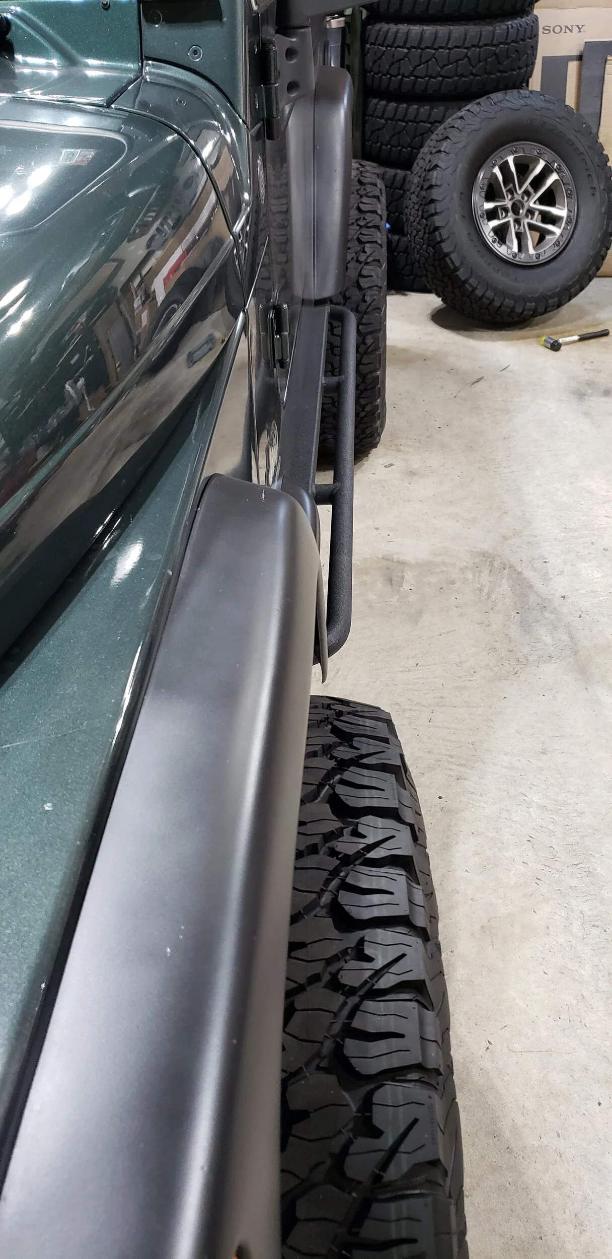

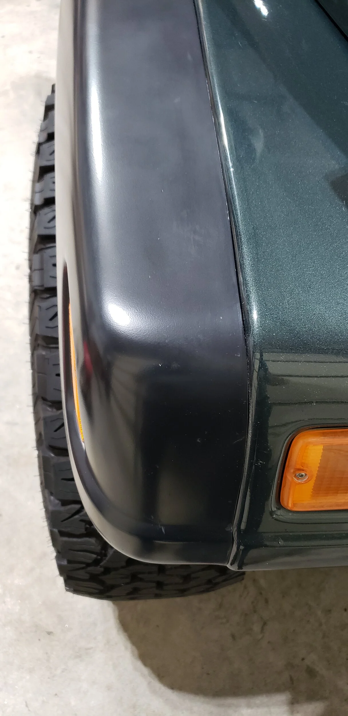

With the inch and a quarter adapter, the back spacing works out to be about 4.5". Once the Rubicon flares are installed, I'll have about 2 and a half inches of tire sticking out past the flare.

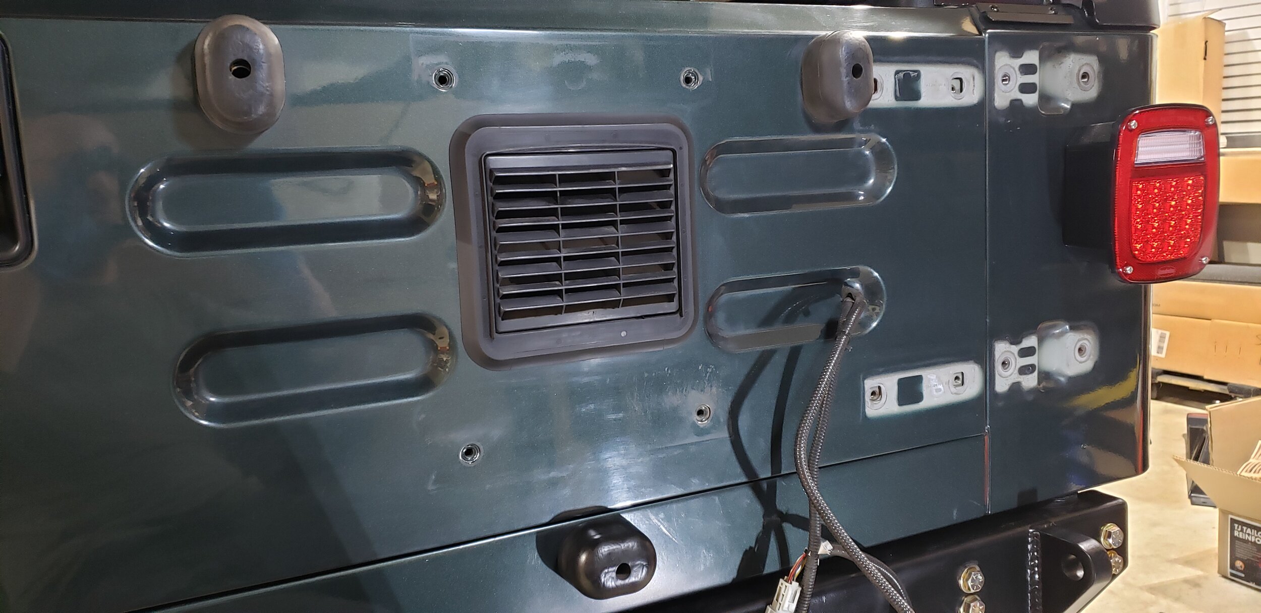

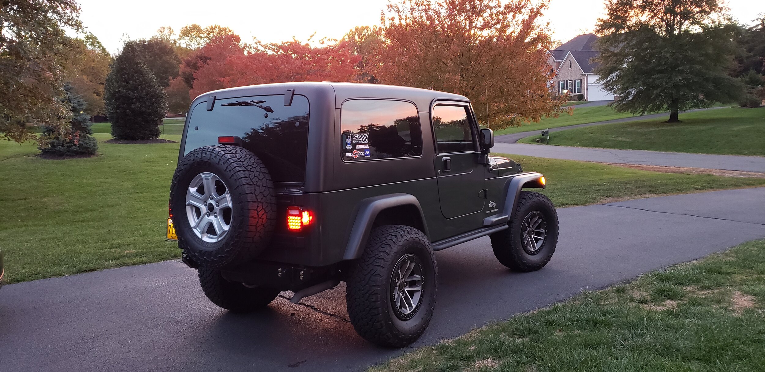

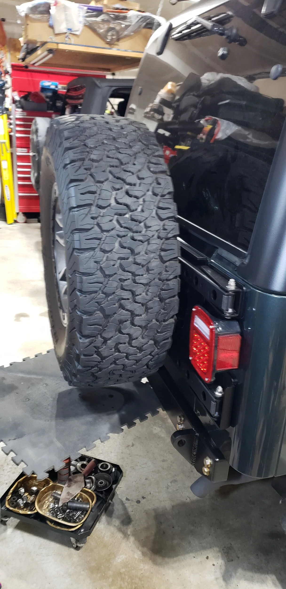

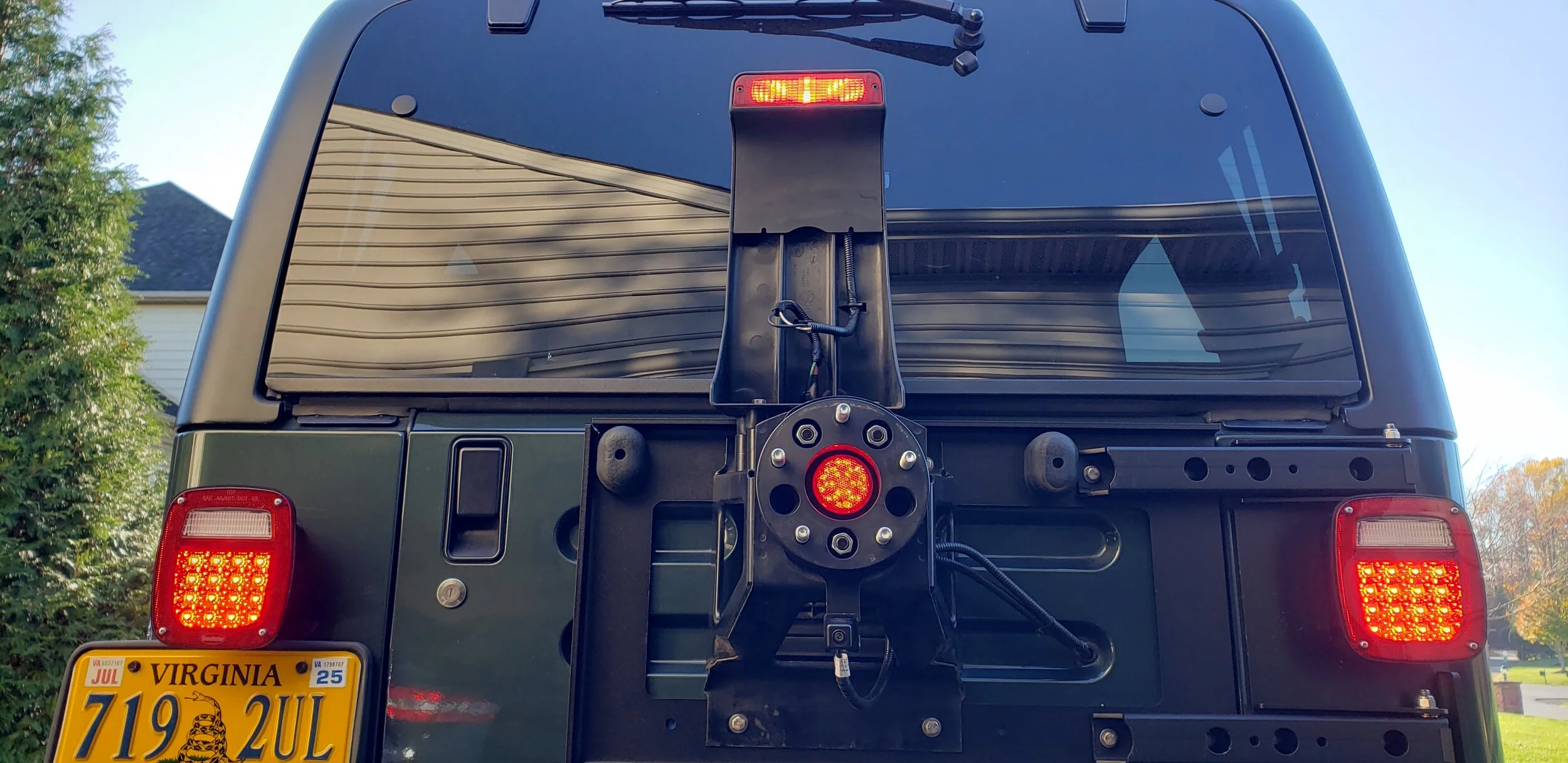

Finished up the spare tire carrier for the 35" tire. Had to raise the stock 3rd brake light again, from the 33s, and added another brake light inside the wheel center hole.
