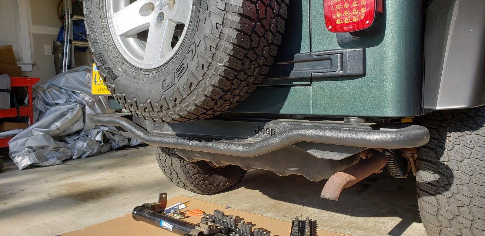

I was happy with my Jeep until I saw this. Sell me your bumpers and I'll be a little less jealous.
I've really never understood the fascination with these bumpers. That said, the uniqueness is growing on me and I plan to stick with them for this build. The one negative thing I see about them, in their current state, is that you can't run a dual rate stabilizer, like a Swayloc. Fortunately, like many other things here, @mrblaine has created a modified version that addresses this issue. If it comes down to a need for a dual rate stabilizer, I'd attempt to follow what he has already done.
Not having a need to go there now, my first step will be to remove the rear tow hitch, so it doesn't distract from the lines of the bumper. I'm also looking at a way to add small backup lights to the rear bumper, but haven't figured out a clean way to do that yet. Small steps forward!
No, there is actually no uniqueness to grow on you. You're right that they are ugly and overrated. I feel badly for you, and I'm willing to take them off your hands as a favor. You know, because I'm a nice guy. I'll even drive to from SC to VA so you don't have to ship. Ok? Ok, good deal.
Almost convincing! :ROFLMAO::ROFLMAO::ROFLMAO:

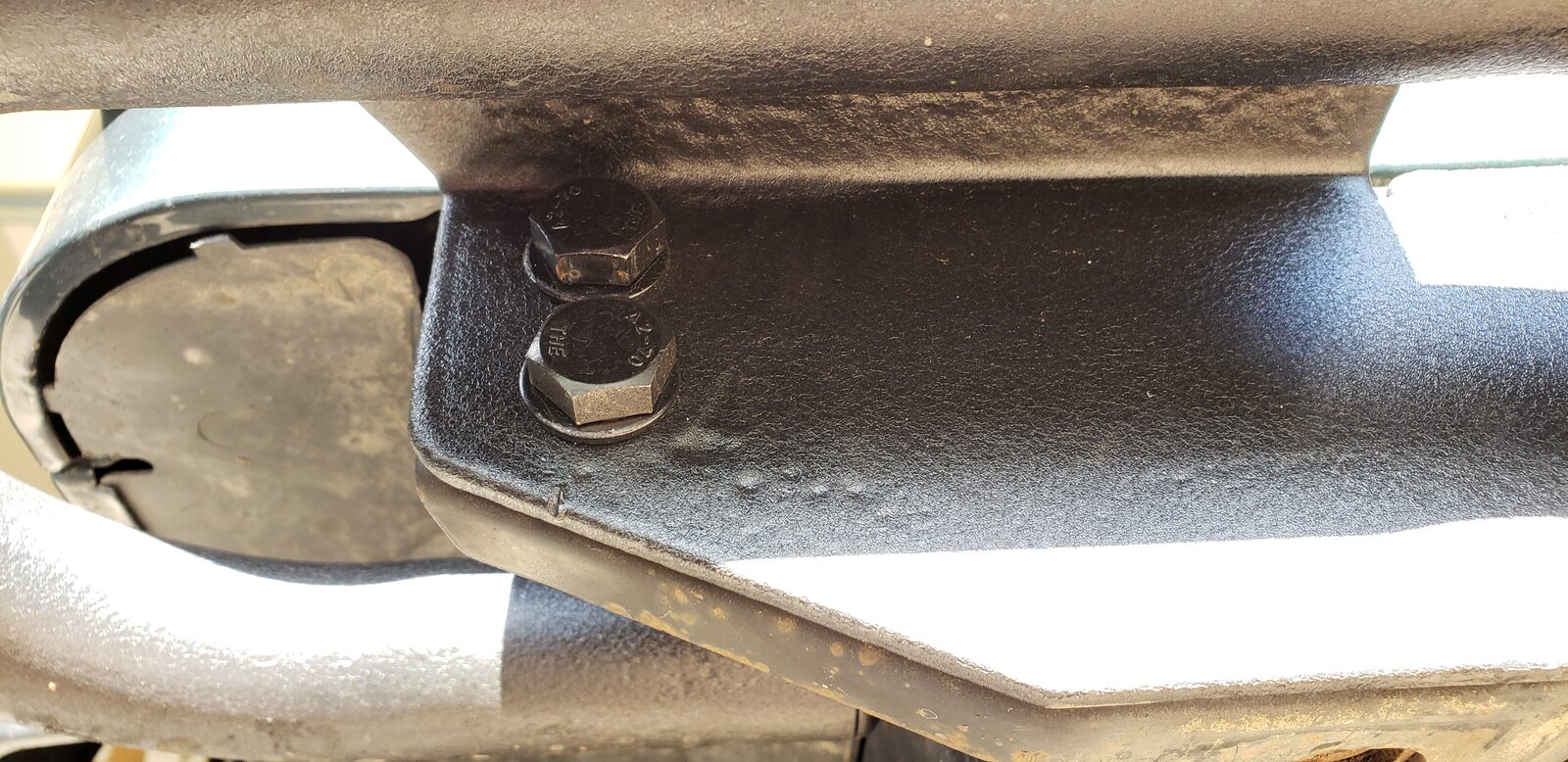

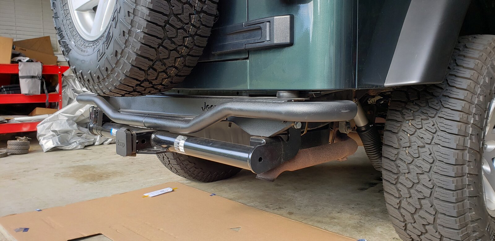

Removed the tow hitch today and was surprised with what I found. The Mopar Rock Crawler bumper is only secured by two (2) bolts on each side, meaning there are just four (4) bolts total. Also, there are no extraction points at all, not that I would want to pull on it with only the existing bolts. :(
Removed the tow hitch today and was surprised with what I found. The Mopar Rock Crawler bumper is only secured by two (2) bolts on each side, meaning there are just four (4) bolts total. Also, there are no extraction points at all, not that I would want to pull on it with only existing bolts. :(
Rich, I think in their plans you would run the OEM/Mopar rear tow hook, so that would be your recovery point as well as getting mounted to the frame. I never had the rear hook (was gone when I got it) or I'd offer it back to you.
Reactions: Wildman and Irun
I figured something must be missing. I can see where you could also drill some additional holes, but given the scarcity of these, I'd hate to butcher it!
On the plus side, I'm not seeing much rust. What I do see is surface rust and can be easily dealt with!
Reactions: Wildman

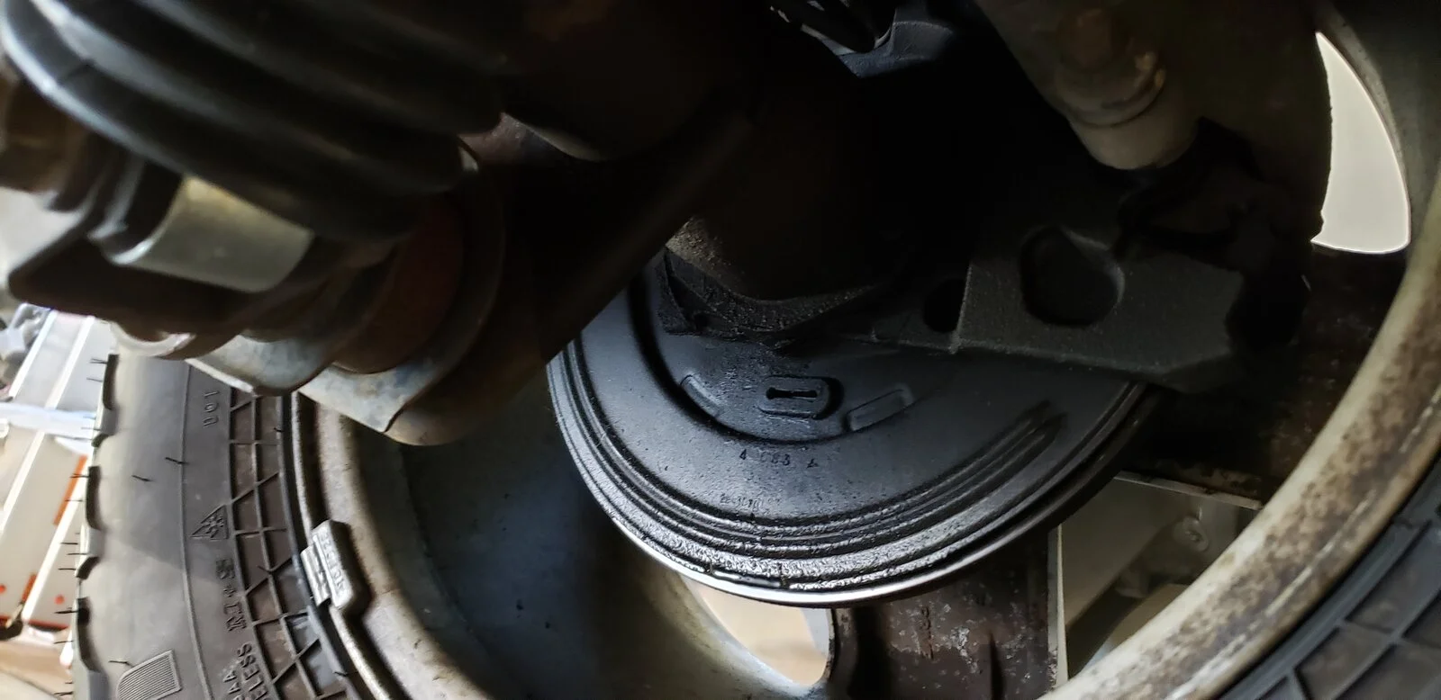

Plans aside, I know what's next on the list. The rear passenger axle seal is leaking worse than when I first saw it. At the time of sale, Jeff included a set of ECGS 4340 rear axle shafts. I'll either be installing those or a brand new pair of Superior shafts I bought years ago and never used. For the Superior shafts, I have both front and rear.
