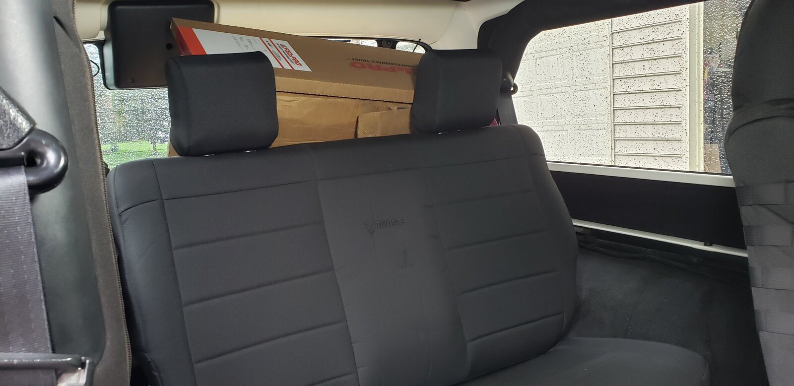

Finally removed the 1/2 doors from the backseat. This is nice to see in a TJ/LJ.
Is that a JK seat as you suspected? I assumed those were too wide to fit in a TJ/ LJ?
It’s a JK/LJ hybrid seat that installed before selling it to Rich. There’s write ups here and some other forums, you basically have to move the mounts for the JK backrest inboard and then it will bolt right up to the TJ bottom. It was quite interesting ordering the Bartact cover it. Had to explain it to them a couple times to get them to understand what I needed lol
This got me curious. Here is what I found. Isn’t a direct bolt in but doesn’t seem to bad for someone with fab skills. Maybe another project I can ask my brother to take on for me.
https://www.cj-8.com/threads/jk-high-back-rear-seat-in-a-tj-lj.40862/
