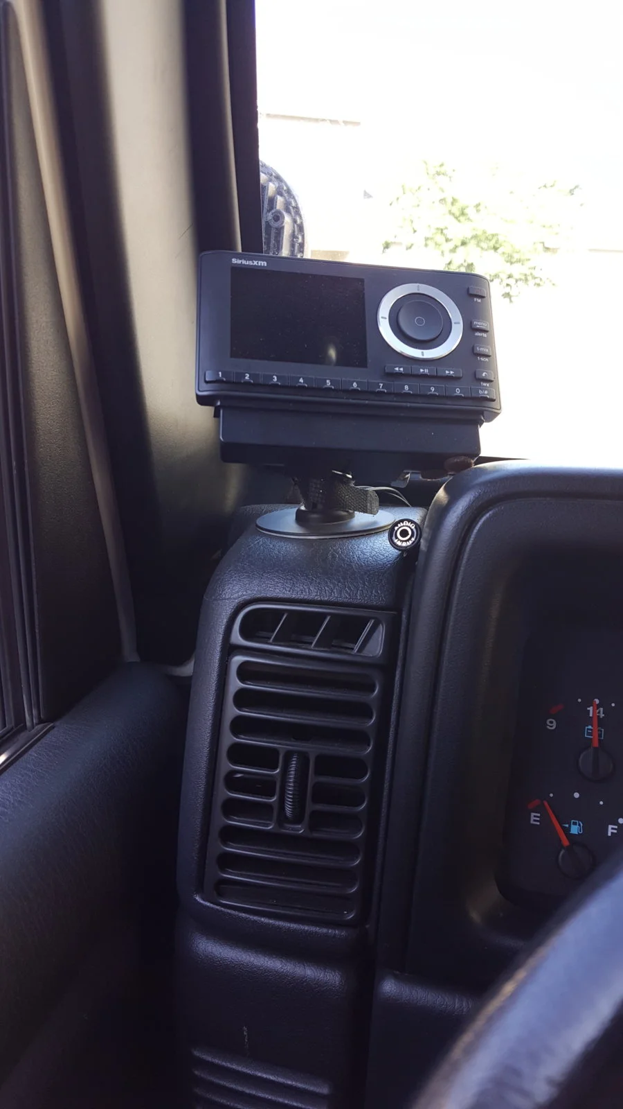

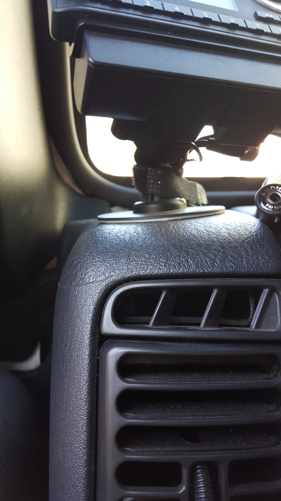

Glad you are happy with 1Factory Radio. They did mine, and it works great, no regrets. On the XM radio, I have the Onyx, and mounted it on the drivers side dash top, between the pillar post and the instruments. Gave up on the window cup mounts, and bought a short adjustable with a circular base, that sticks right to the dash-top. I've seen a lot of cb's mounted there, so not sure if this helps or not.
Ray
I appreciate that! I have the same one and will be considering that location now lol.

Here are a few pics. I bought the mount from either Satellite Super Store, or the Sirius site. Have one in my truck also, holds up great, even in triple digit heat.
Ray
Ray
View attachment 21990 View attachment 21989
Thats a great mounting location! I got my satellite radio used so mine didn't come with a mount like that, just the vent mount. I did manage to find a location for it today though! Right above my newly mounted CB :).
