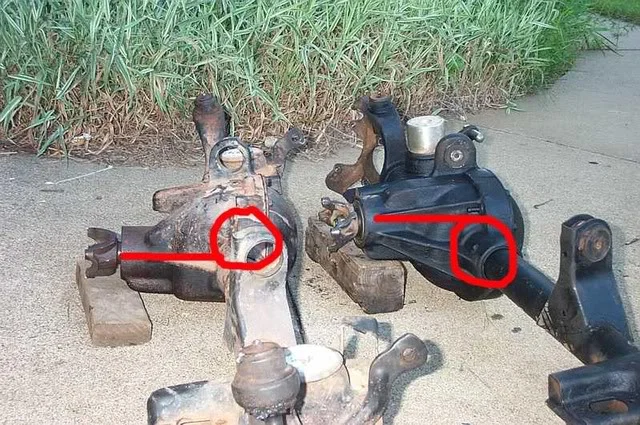

Well another update: drove 3 hours one way to check out the hp30. first thing I noticed was it was a lp30, upon further inspection it was tweaked and gear ratio was 3.55. God dang it he had no clue what he had. Still on the hunt.
Wow... This guy must have been a moron. Sorry, but it's true. Pretty easy to tell a LP Dana 30 apart from a HP Dana 30.
I had to show him this lol:
Of everything but the rear of the housing. Should have known lol...
Ahhh! Live and learn, right?
