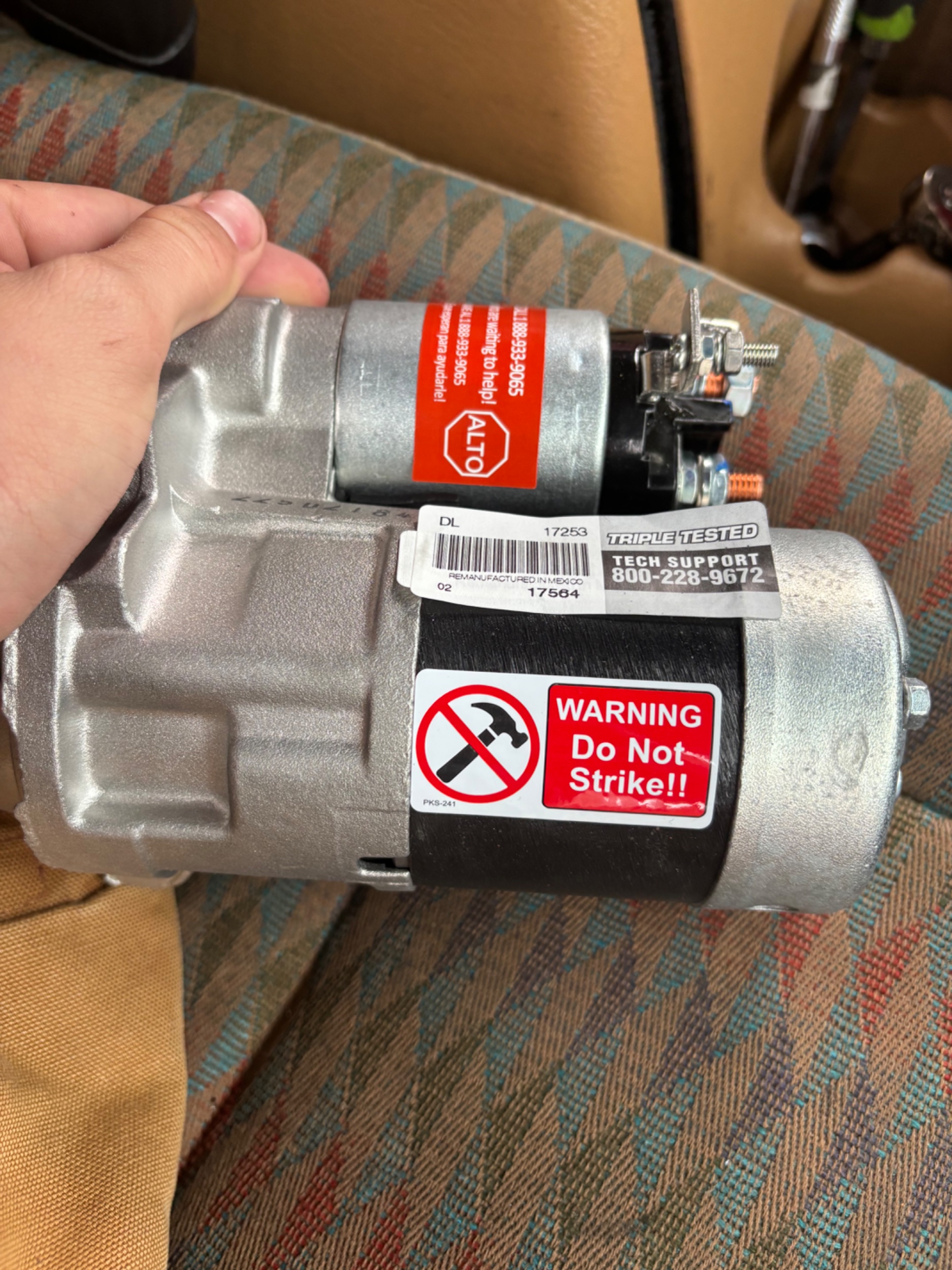

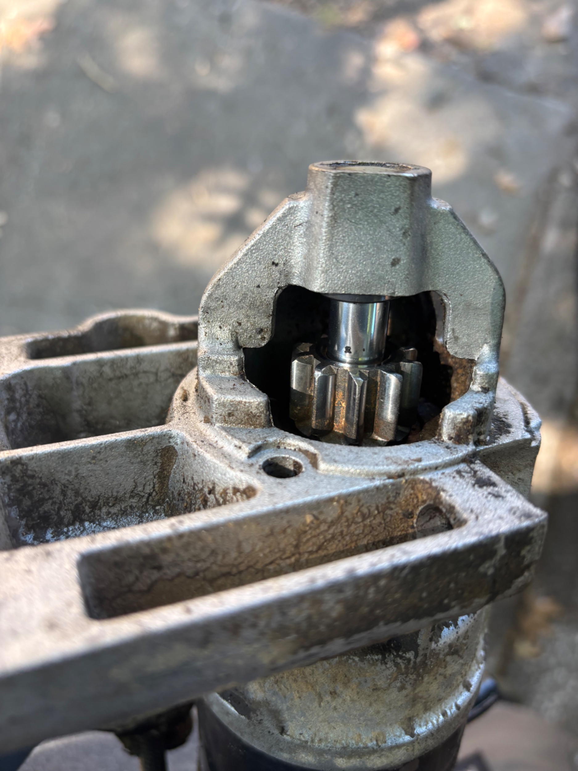

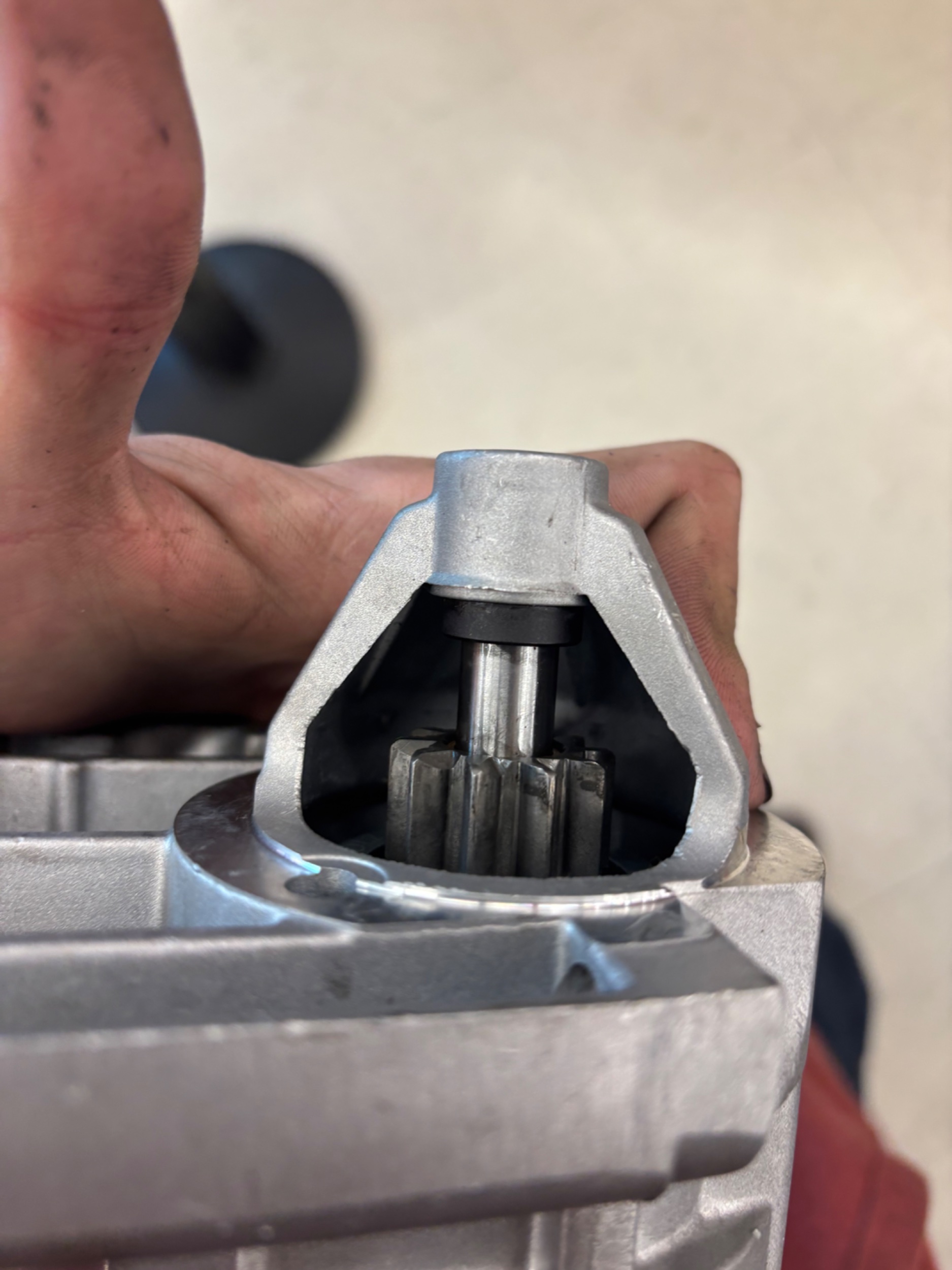

Had a starter issue with my Mopar starter so I made a trip to Autozone. I got a new starter which fit perfectly but upon every start I was getting a chirp and squealing noise. I bought some shims for a GM (I couldn’t find any for my application and I fully intended to alter them however I needed) from Advanced Auto but ultimately decided to not even try to make this starter work after I realized they sold a remanufactured option. If I’m spending the money for a new (or new to me) starter then I want it to fit properly the first time I put it in there. Got the starter tested a few times and every time it passed as no issues. Fast forward 1 week and I take the starter back and buy this one which is in fact remanufactured so it will fit properly. Bolted it up and it starts up perfectly fine, exactly what you want from a nice healthy starter.

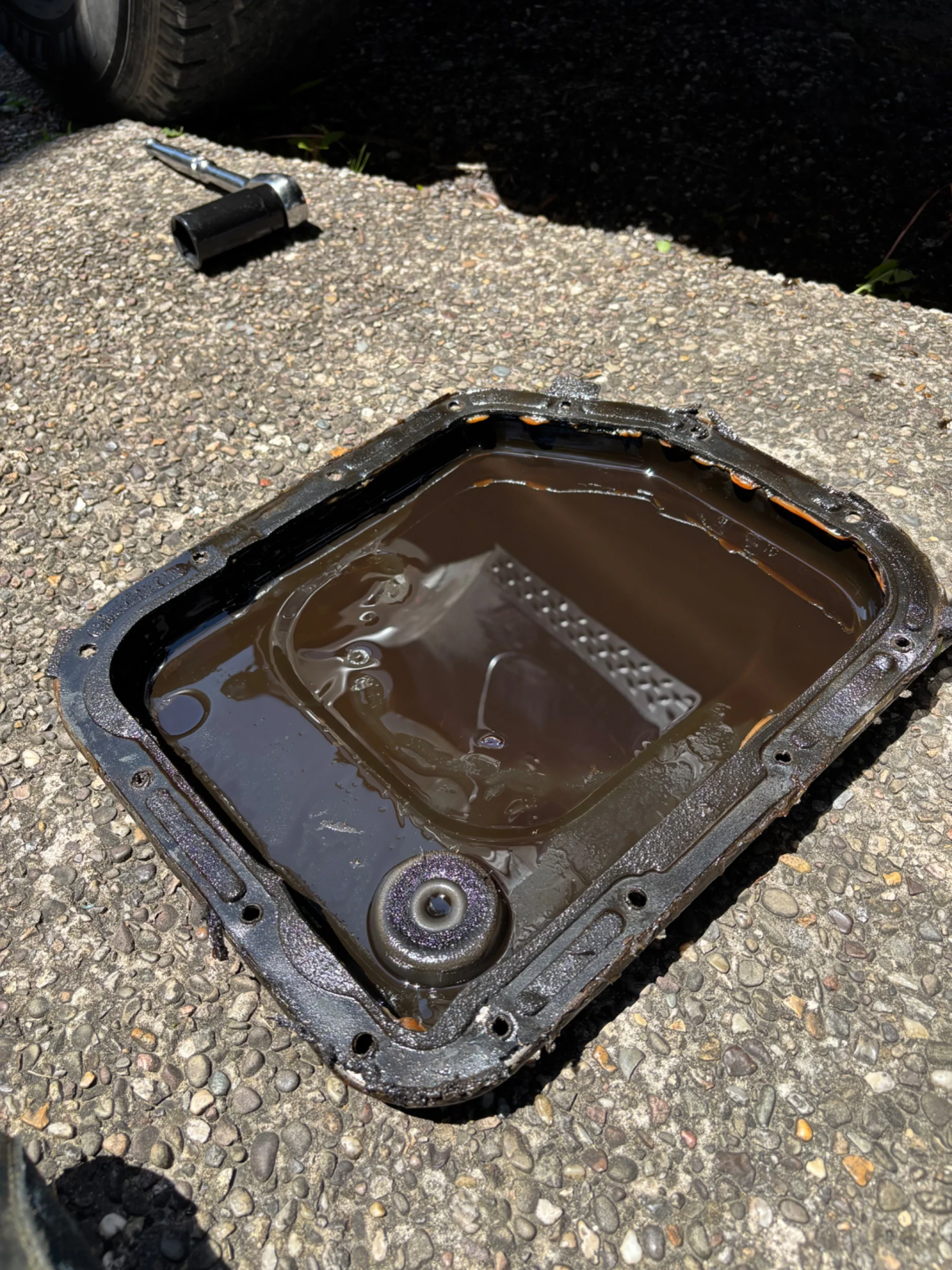

I’ve been having issues with my trans for some time and it’s definitely due for a rebuild.

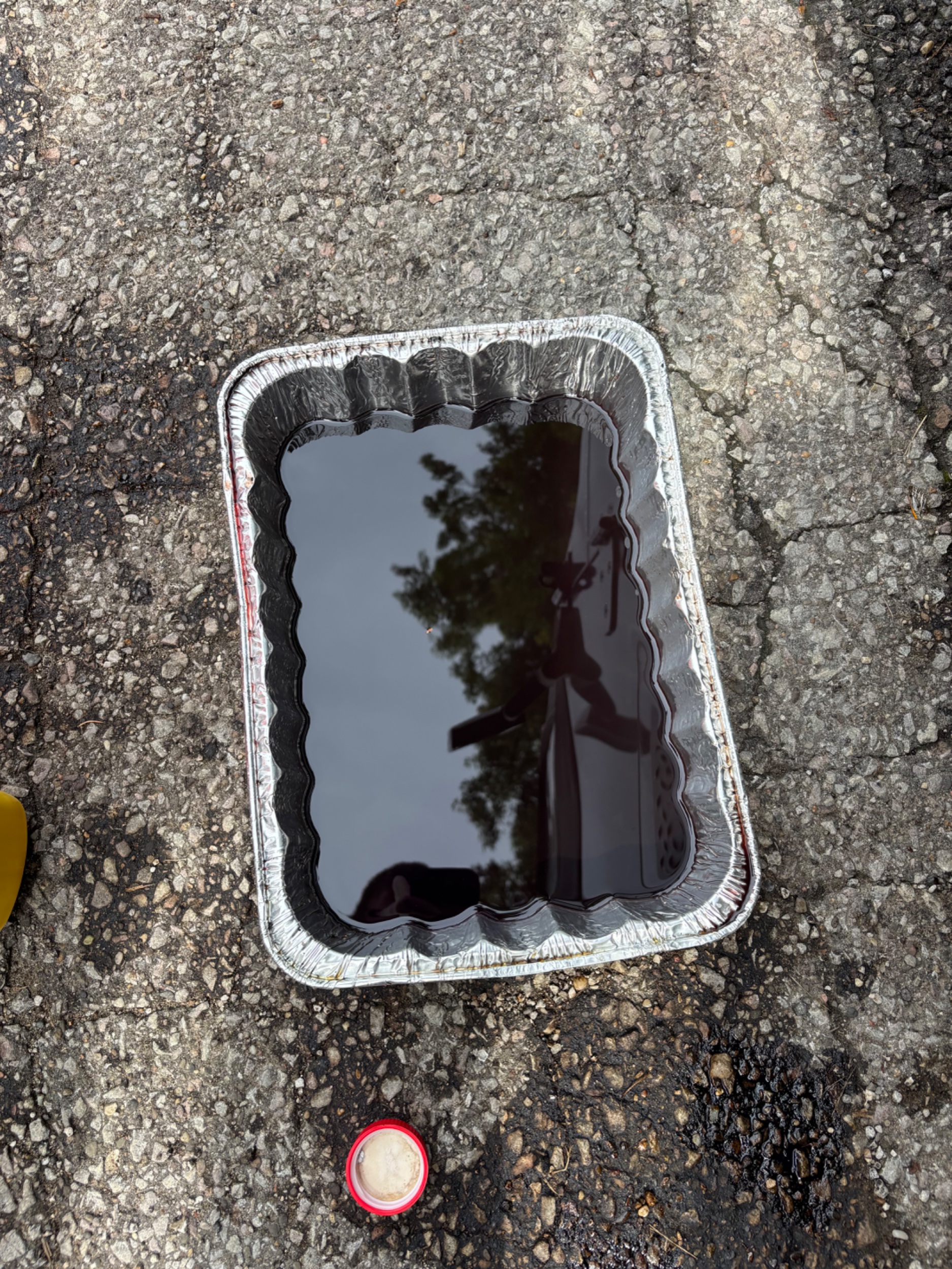

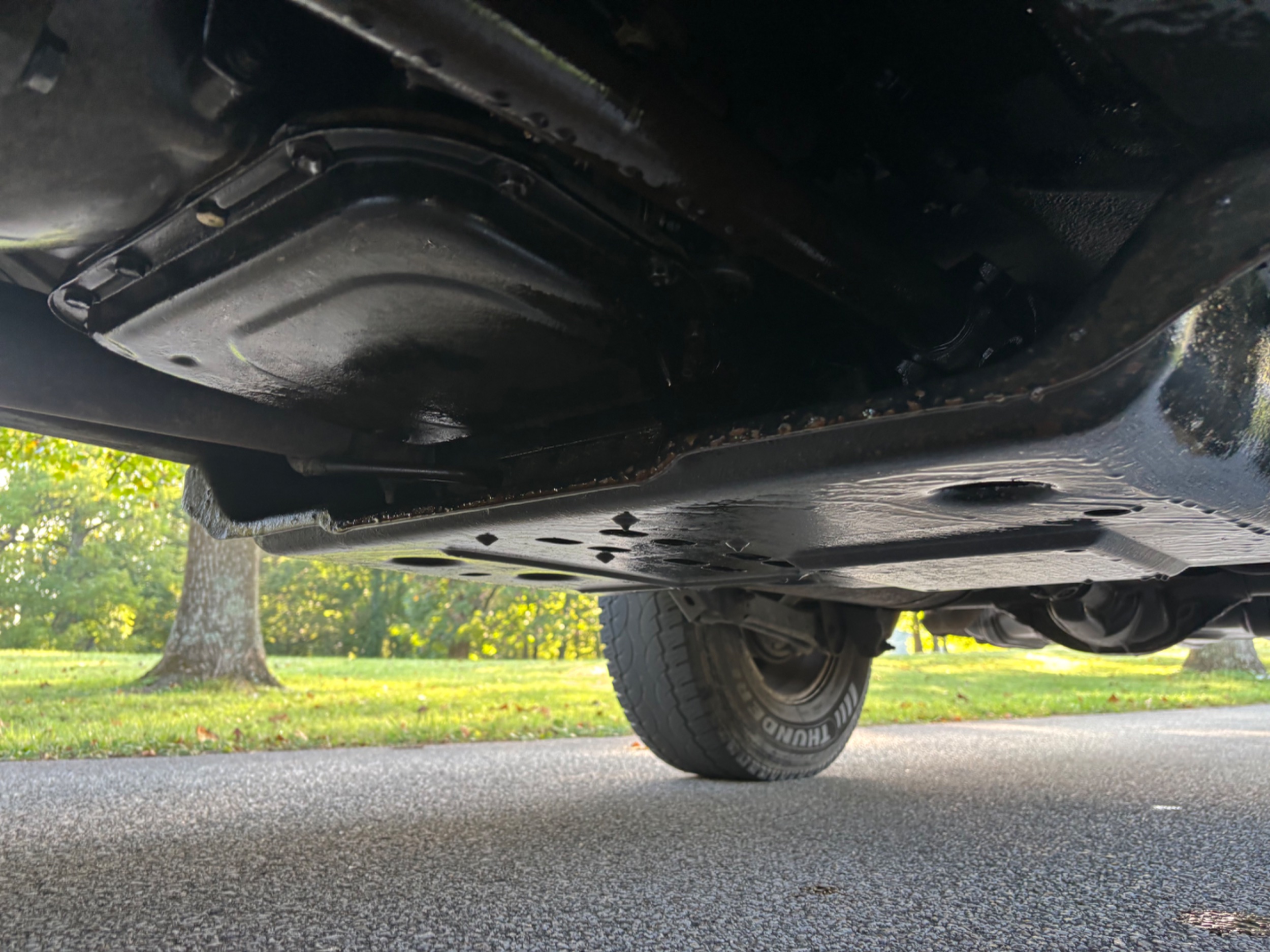

What sorts of issues? I mean, you're in the right place for that job, but it needs to be necessary. (btw your oil looks pretty rough).

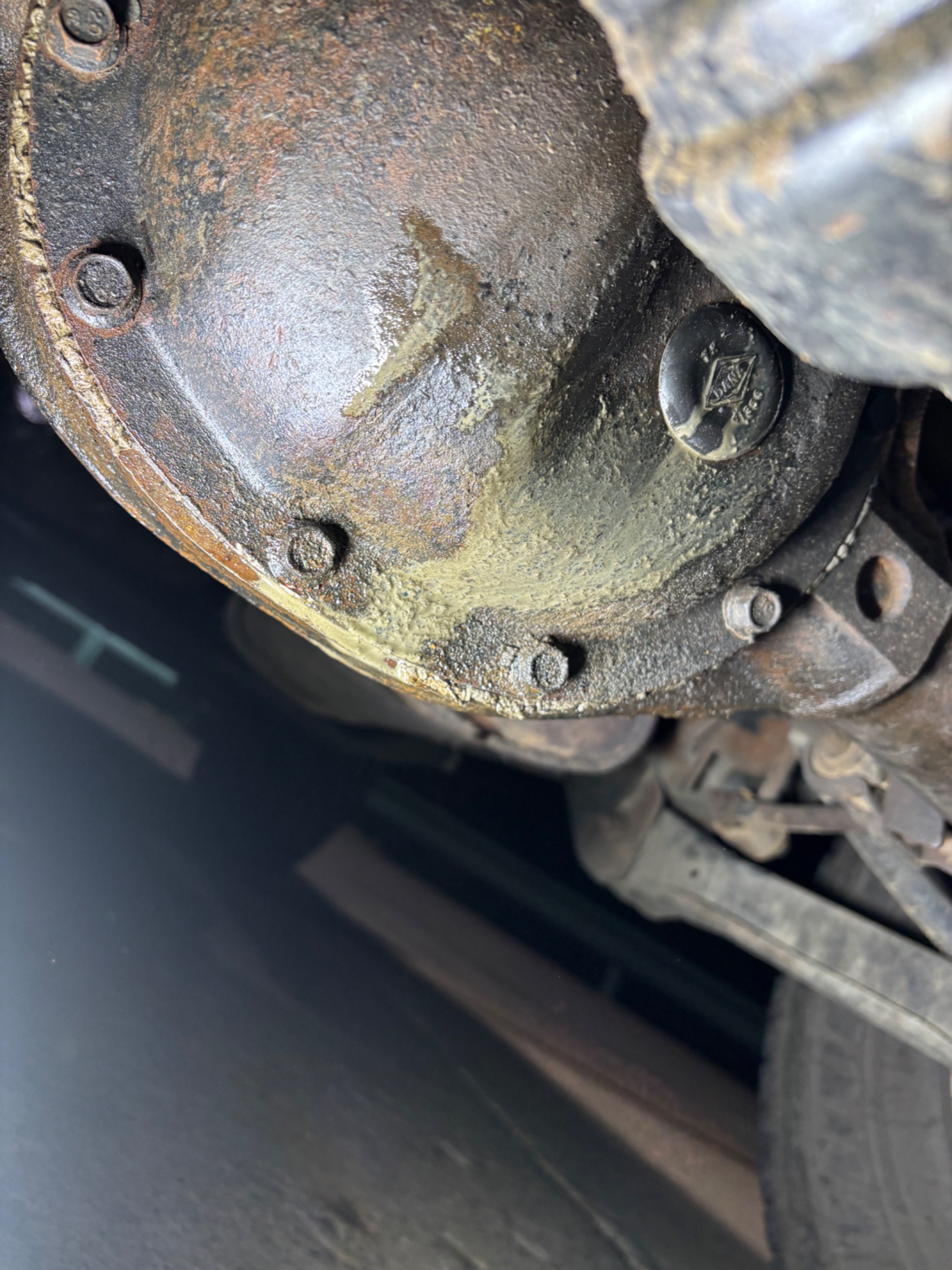

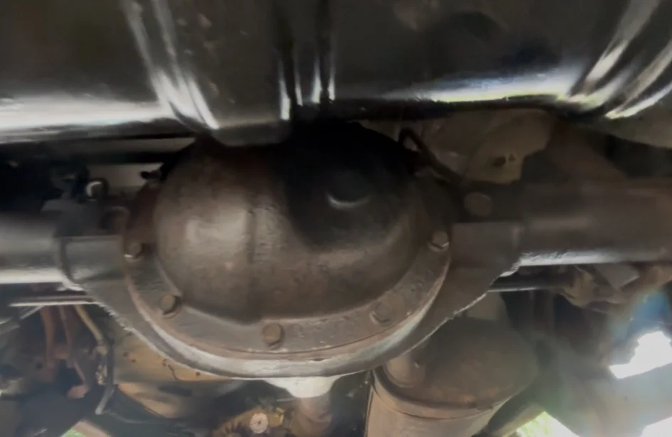

Also had to change my gear oil for my Dana 35. We’ve had some storms lately and it’s been raining a lot. The only thing I can think of is my Breather was not secured properly high enough and water splashed up and got into my diff. I ordered a lube locker gasket for my Front and rear diff but for the meantime I put some 80W-90 in there until my gaskets come in and then I’ll be doing front and rear with 75W-140. Might be overkill because I daily this thing but I’m tired of crap falling apart on me and if I spend a couple extra bucks and stay on top of maintenance it should last?
It took about an hour and I used a Mahle gasket because I couldn’t get felpro. I’ve never used any other gasket than Fel-Pro, should be good till my lubelocker comes in. New plug too, just because
I'd be much more suspect of my seals than I would be of the breather sucking in splashed water.

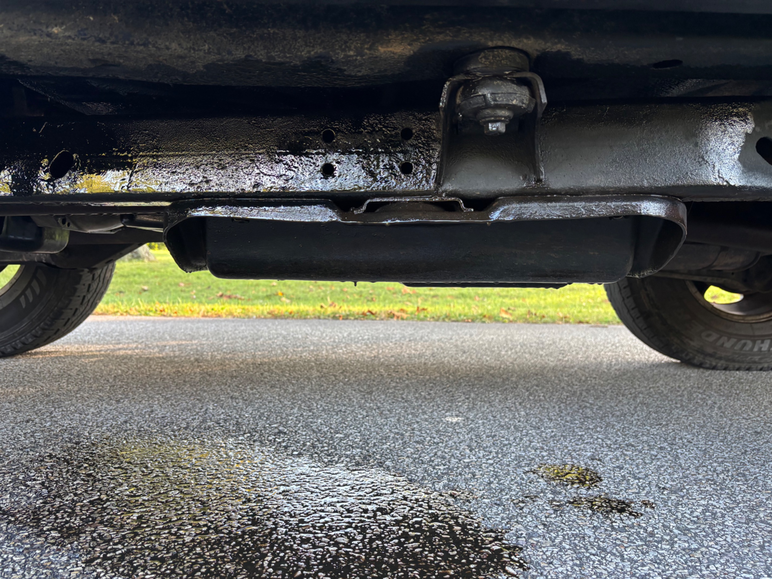

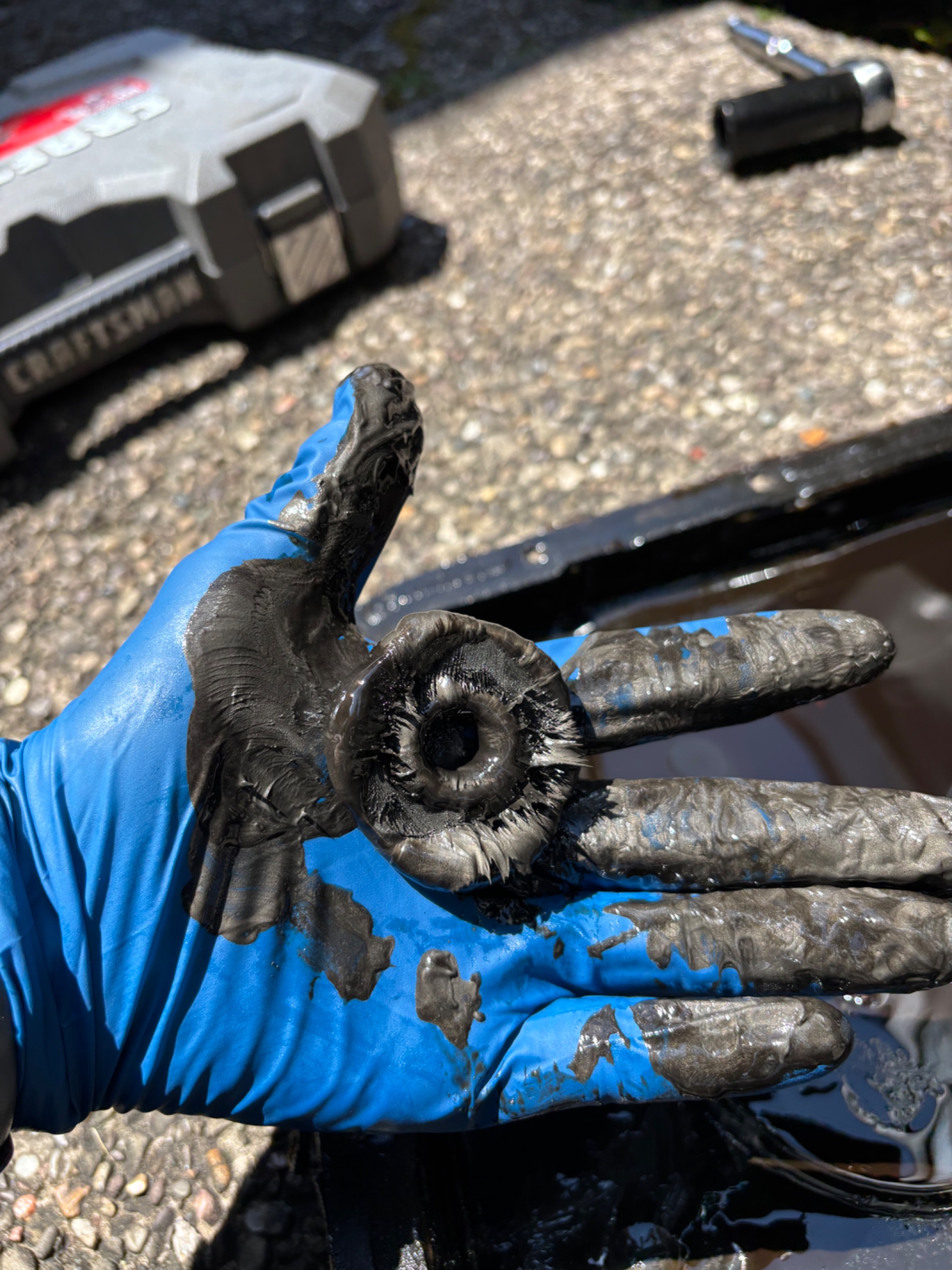

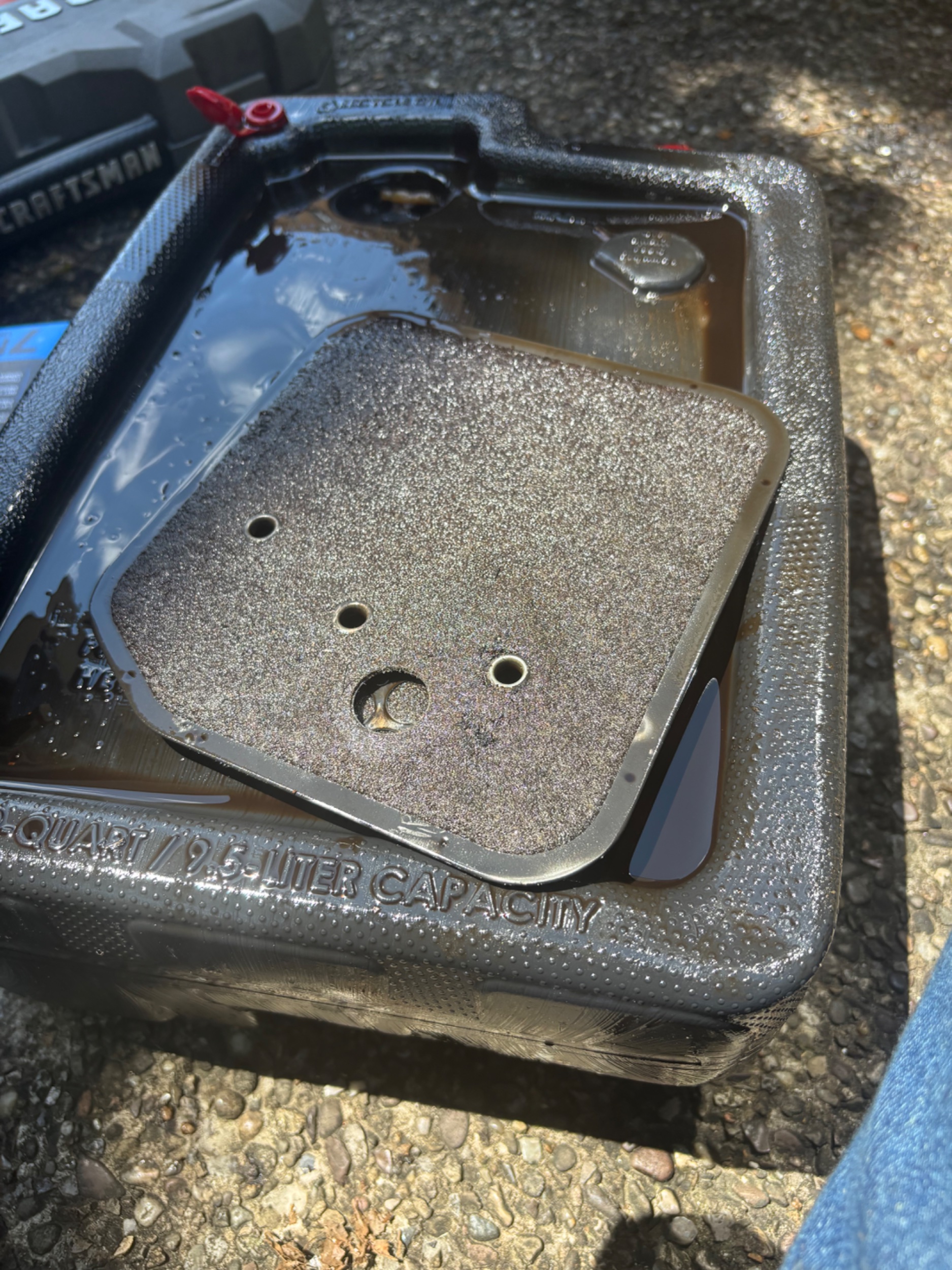

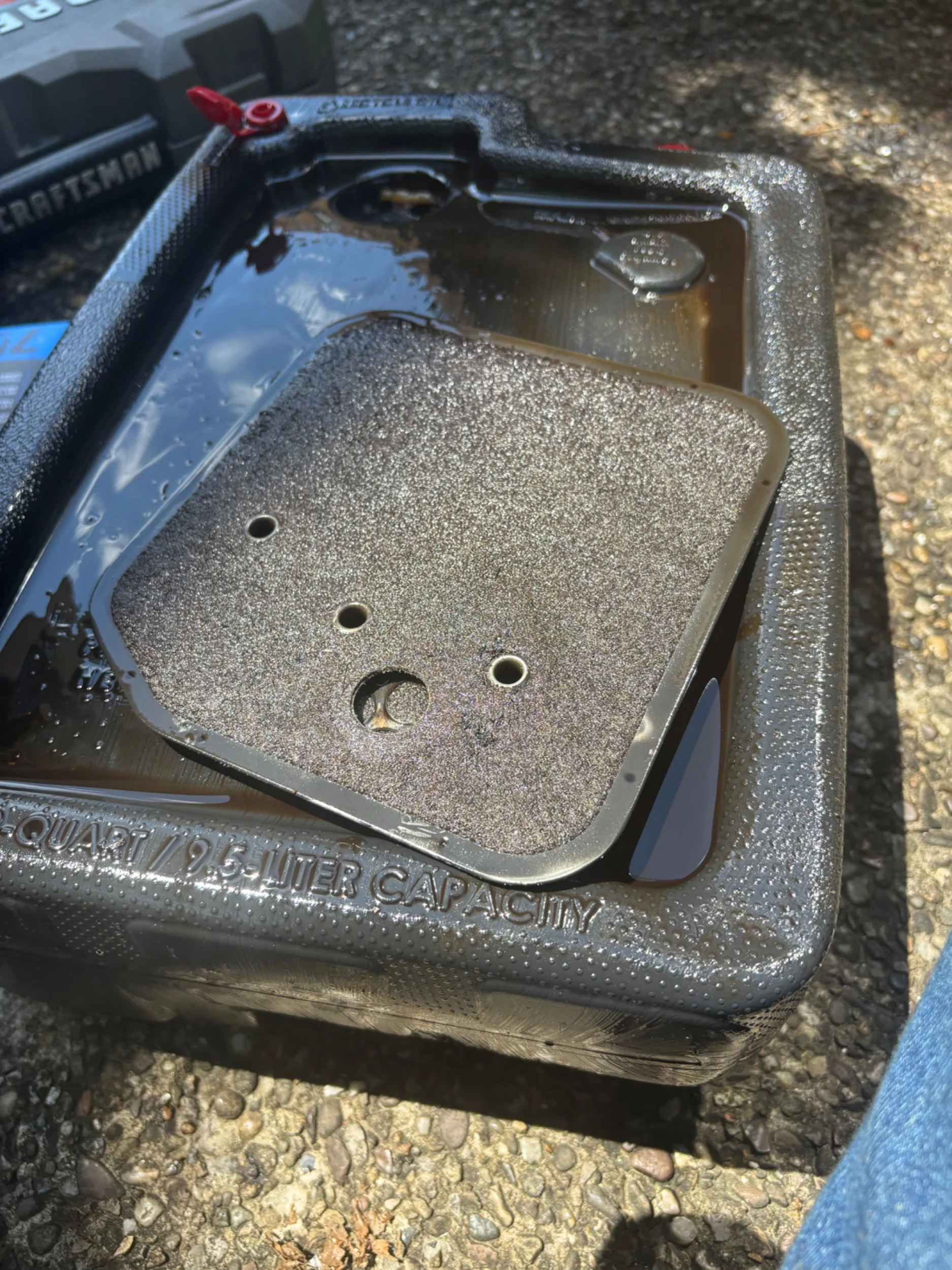

My oil is my main reason. This pictures is on my first transmission fluid change since I got the jeep. I dropped it and it looked awful so I replaced the gasket and filter and cleaned it spotless, absolutely nothing on the gasket mating surfaces. 2 weeks later my transmission fluid ran low, it threw a tcc solenoid code, I check fluid and there was almost none on the dipstick. Turns out there was a leak at the rear of the pan and it had been dripping into the skid and just collecting in there and it was raining a lot so I thought “hey, that puddle under my jeep is transmission or oil, it’s just rain”
Turns out it wasn’t rain and I over tightened the pan bolts past 13 ft-l s. A costly mistake for certain. The fluid was leaking out between the bolt holes because the pan bolt holes were bent inwards towards the transmission. I didn’t notice the pan was bent and bought a fel pro gasket and refilled it to the top of the max line. I thought surely I smacked the gasket or didn’t seat it properly, it was just the pan bent. My pan is still bent so when my LubeLocker transmission gasket comes in I’ll be setting a piece of wood under the pan bolt holes and tapping them back down from above and then checking them with a straight edge and a feeler gauge. I’m tired of fooling around with it.
On top of the bad fluid and leaks which are both my fault, I bought it with the TV too tight and I had been driving this whole time pumping the wrong hydraulic pressure in. My shift to reverse takes about 5 seconds to engage (I attributed to bad U-Joints because I have slop in the drive shaft), manually shifting to 1 allows me to move forward 5 feet then abruptly stops like I slammed on my brakes. I still have to get up to 2-2.5k rpm to really move around.

Attached is a few pictures of my 2nd fluid change and attempt to fix the leak which was 2 weeks after the first picture above

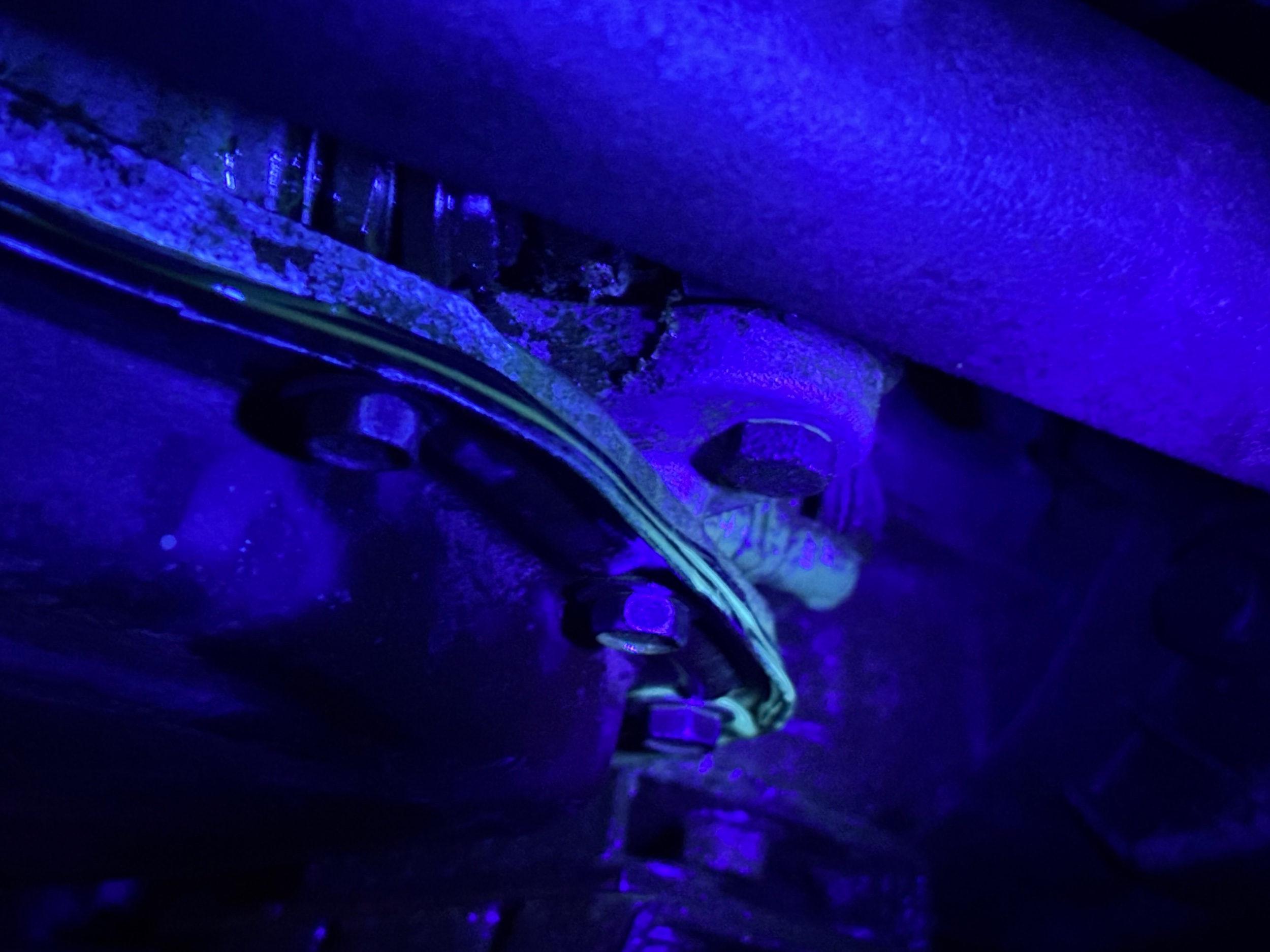

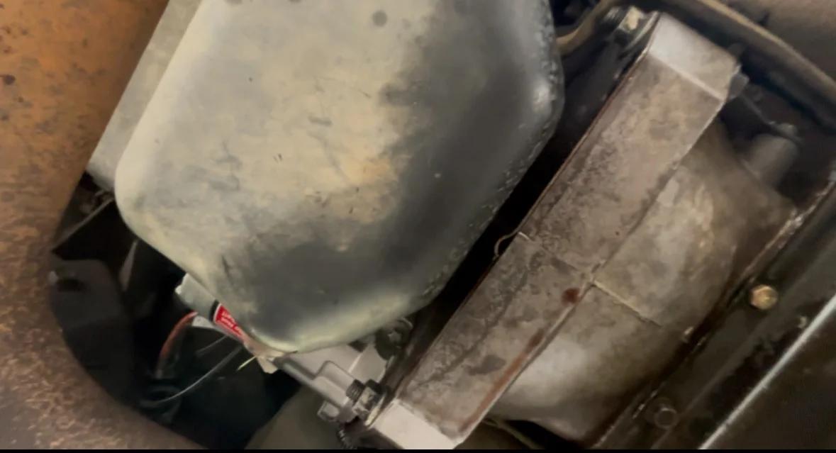

I’m also leaking here and it’s most definitely transmission fluid. I’ve been looking around and I’m thinking It’s something to do with my pump and seals but I’m still Very uneducated when it comes to transmissions
Also have my brand new (January 1st) oil pan Gasket leaking.

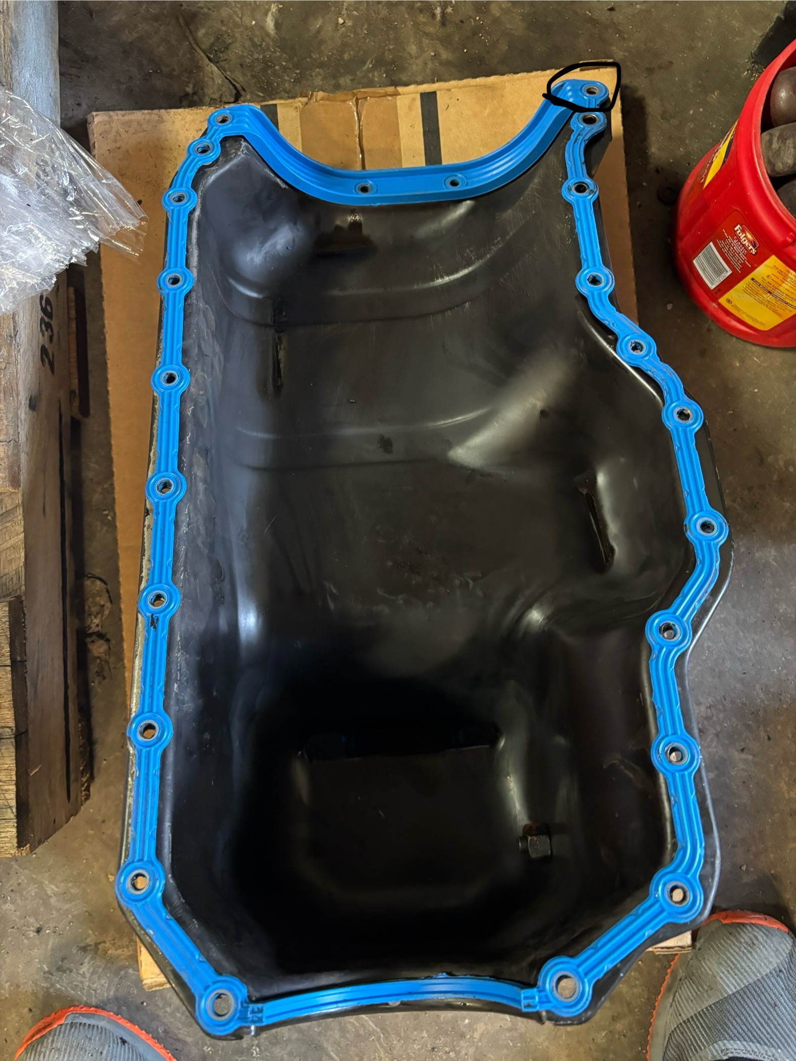

I attribute this to a stripped thread. In this picture you see where the bolt goes into the engine block. I would’ve heli coiled this while the engine was out but this bolt goes in behind the timing cover and I have absolutely no experience with timing and didn’t want to mess anything up. My oil pan is leaking up by my harmonic balancer as well as in the rear. Not on the sides though. These are the typical leak spots but I didn’t know that when I replaced this gasket. I’ve learned a lot since then.
Any thoughts on how to repair this? Should I pop the timing cover and replace all my timing components and try to retap and heli coil?

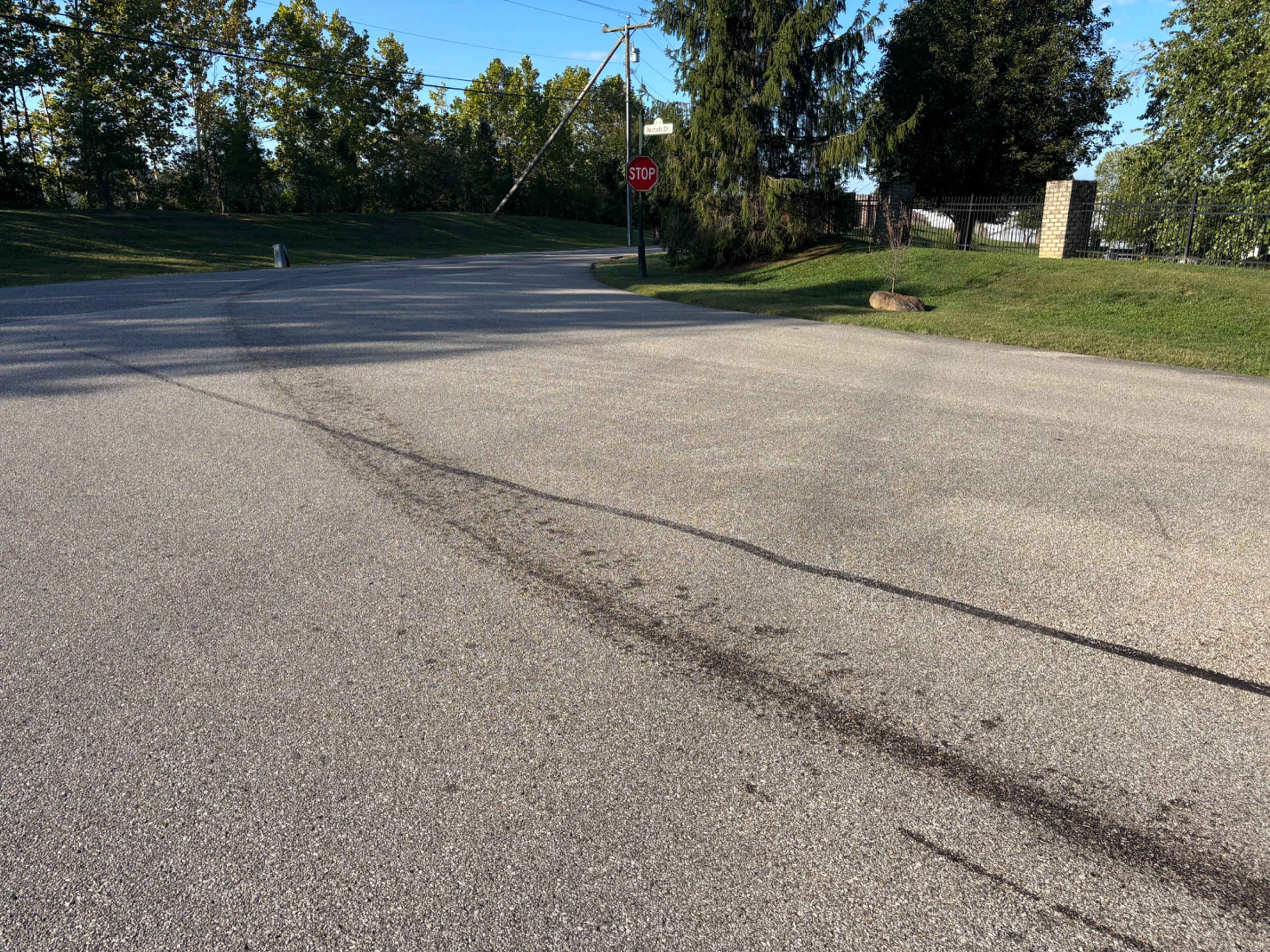

It finally kicked the bucket @hear
I was driving down the road and the gears seemed to be moving a lot faster than or Al but the jeep was accelerating about 1/2 what it normally does, I slow down and stop and I start smoking a little bit. It’s definetly transmission fluid. I stop and I can move at all, no amount of gas picks up or engages the gears. I notice a lot of smoke starts coming out so I turn it off and put it in neutral and pull out of the way. It’s dead.
