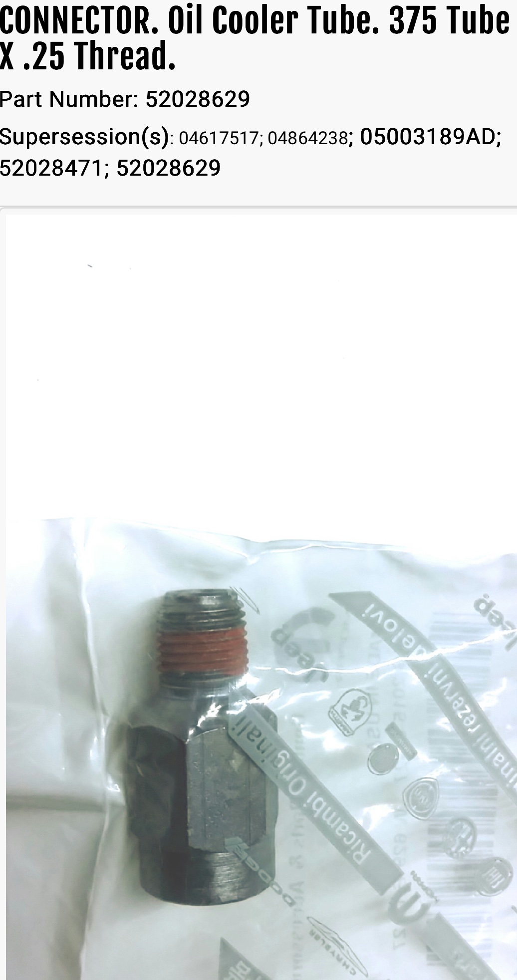

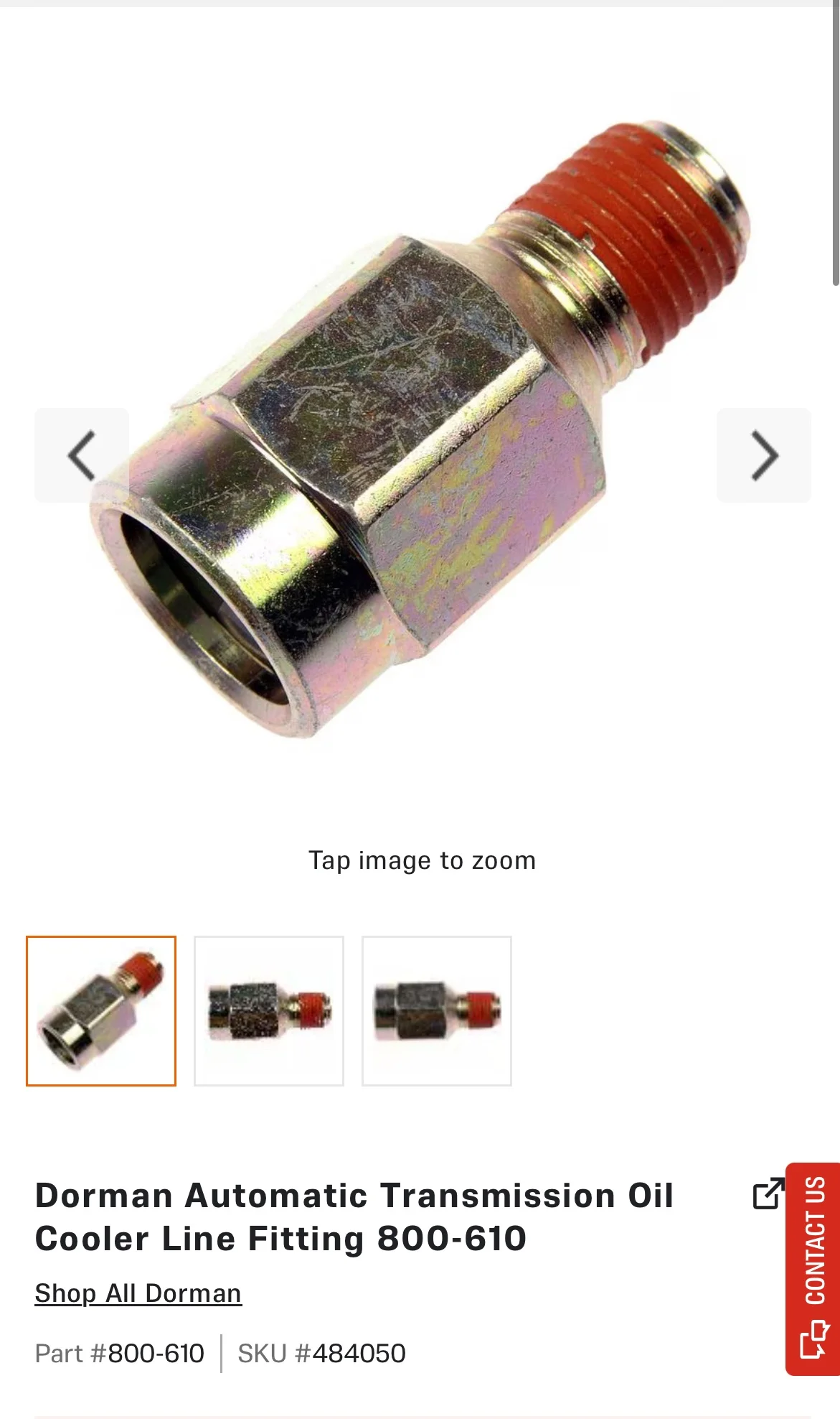

Just source a new quick disconnect. I think there is an o-ring that goes in there or something.... I only open up transmissions, I do my level best to not remove or install them.
Found it, my 30RH uses this fitting for both inport and outport to my trans cooler.
Dorman sells one too “Dorman 800-610”
I’m pretty sure it is quick disconnect. The issue is for sure the fitting and not the line or threads. Any idea where I can source a new fitting or how I disconnect it? Will a normal fuel line disconnect or work?

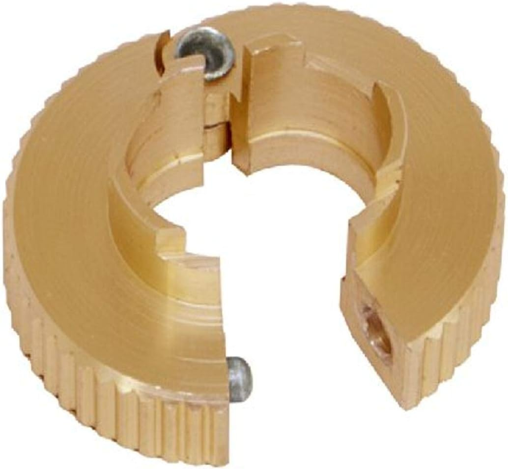

You need a transmission cooler line disconnect tool... They're similar to the fuel line disconnect... And not that expensive.
If the lines are 3/8" this is the one I bought.

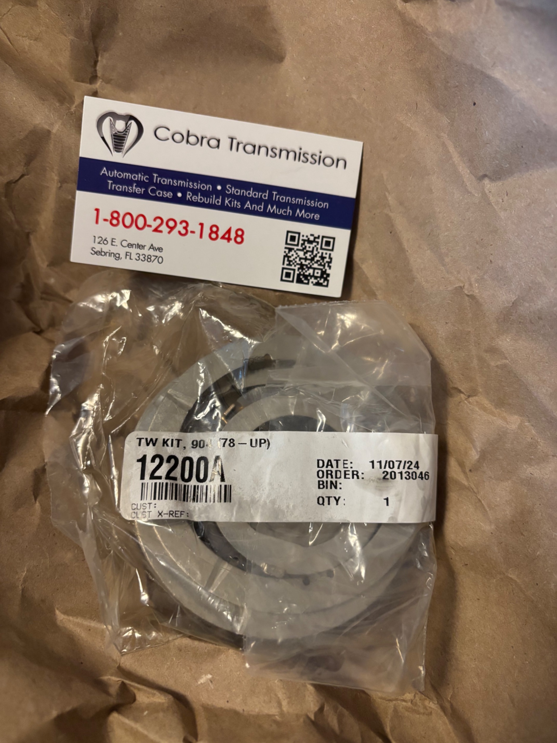

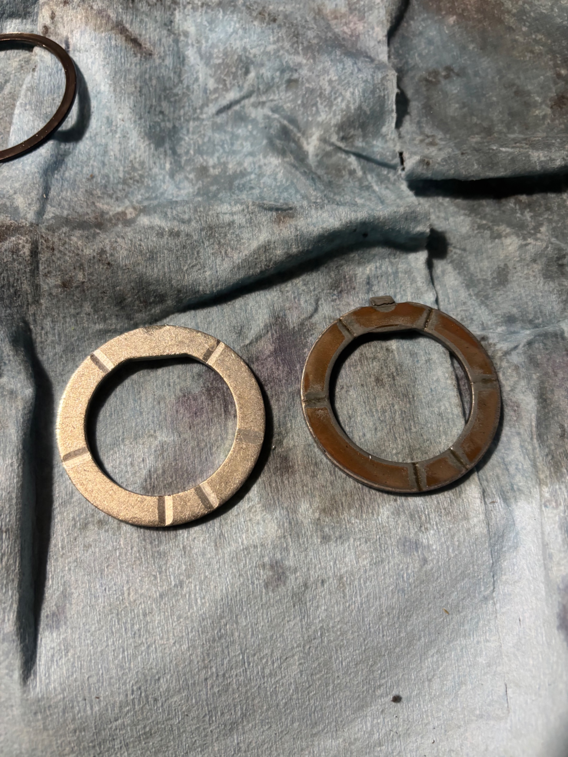

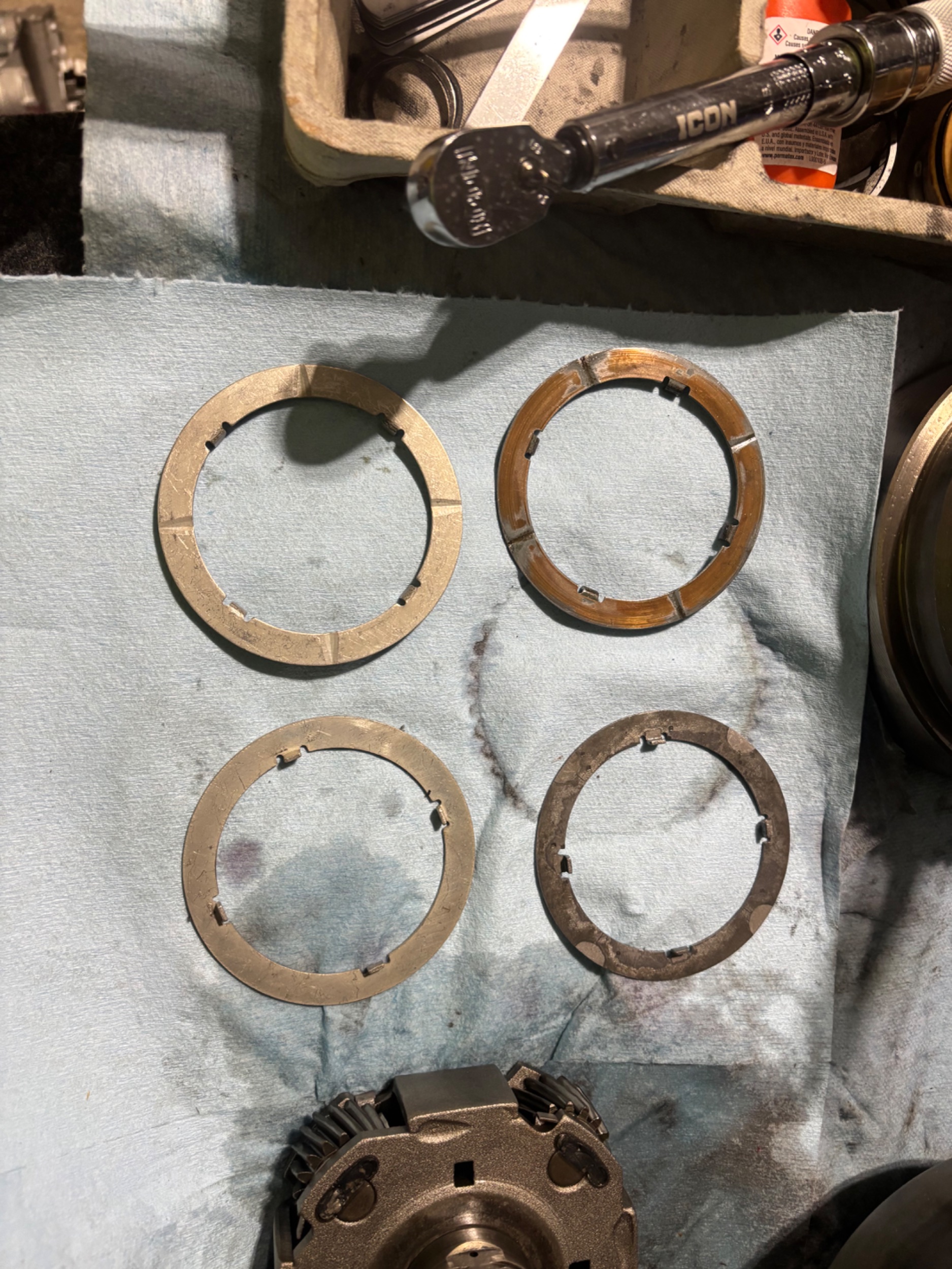

Thrust washers worn (I’d recommend just spending the $50 from Cobra even if you don’t think you’ll need it.

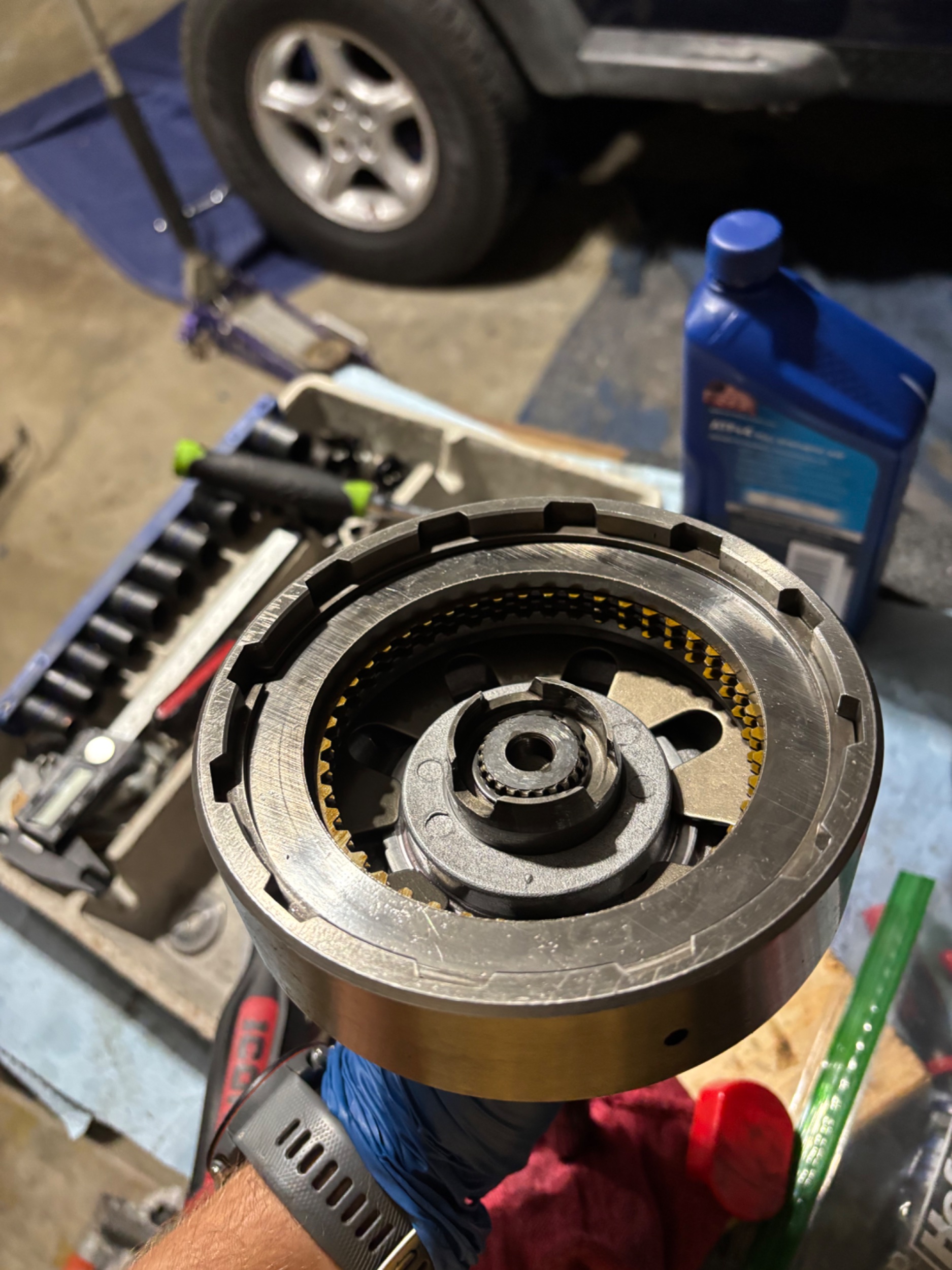

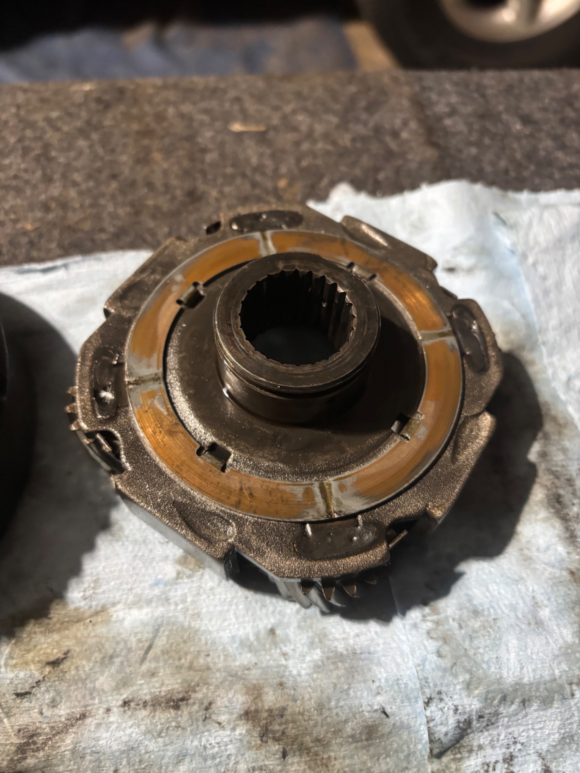

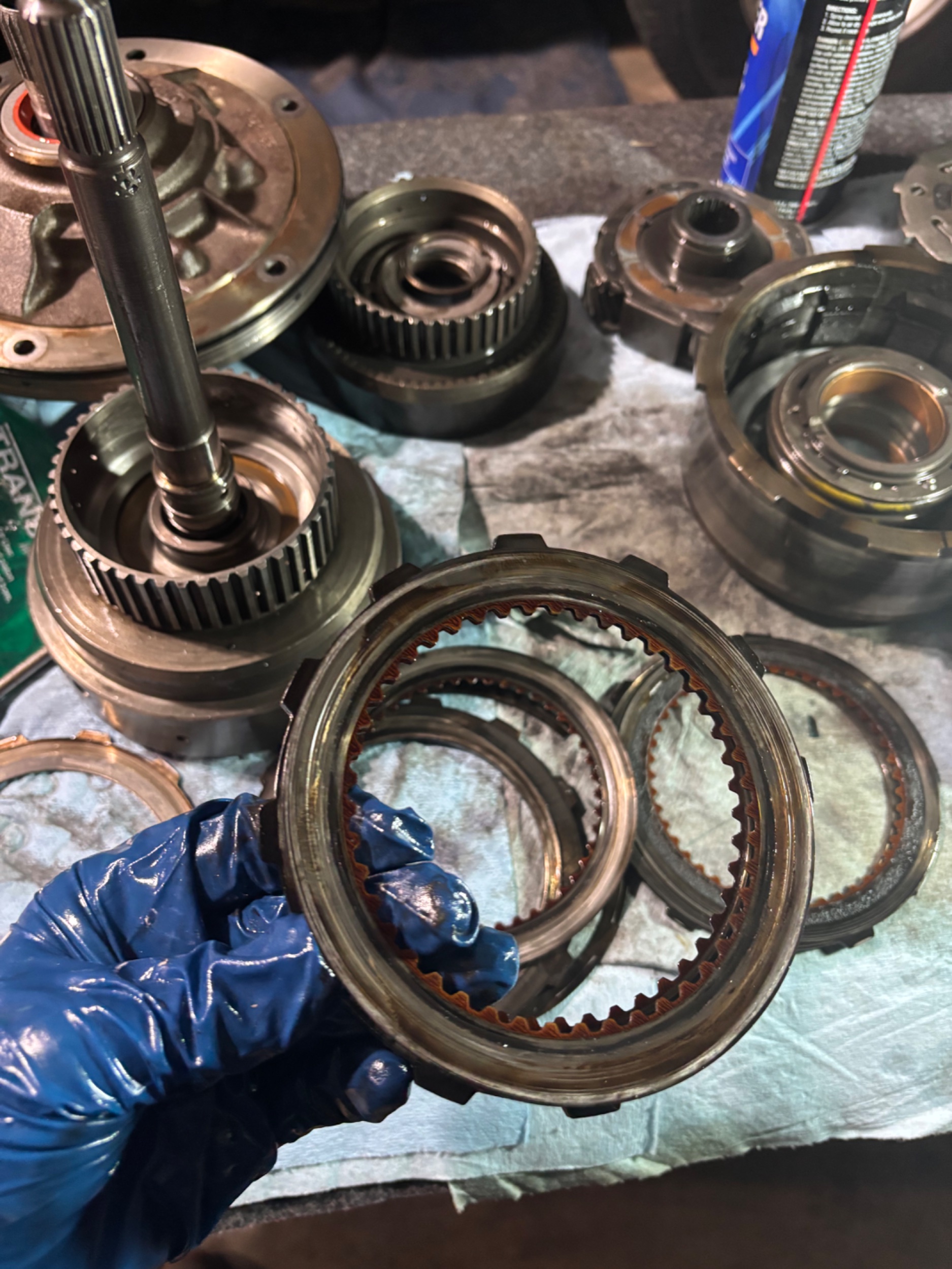

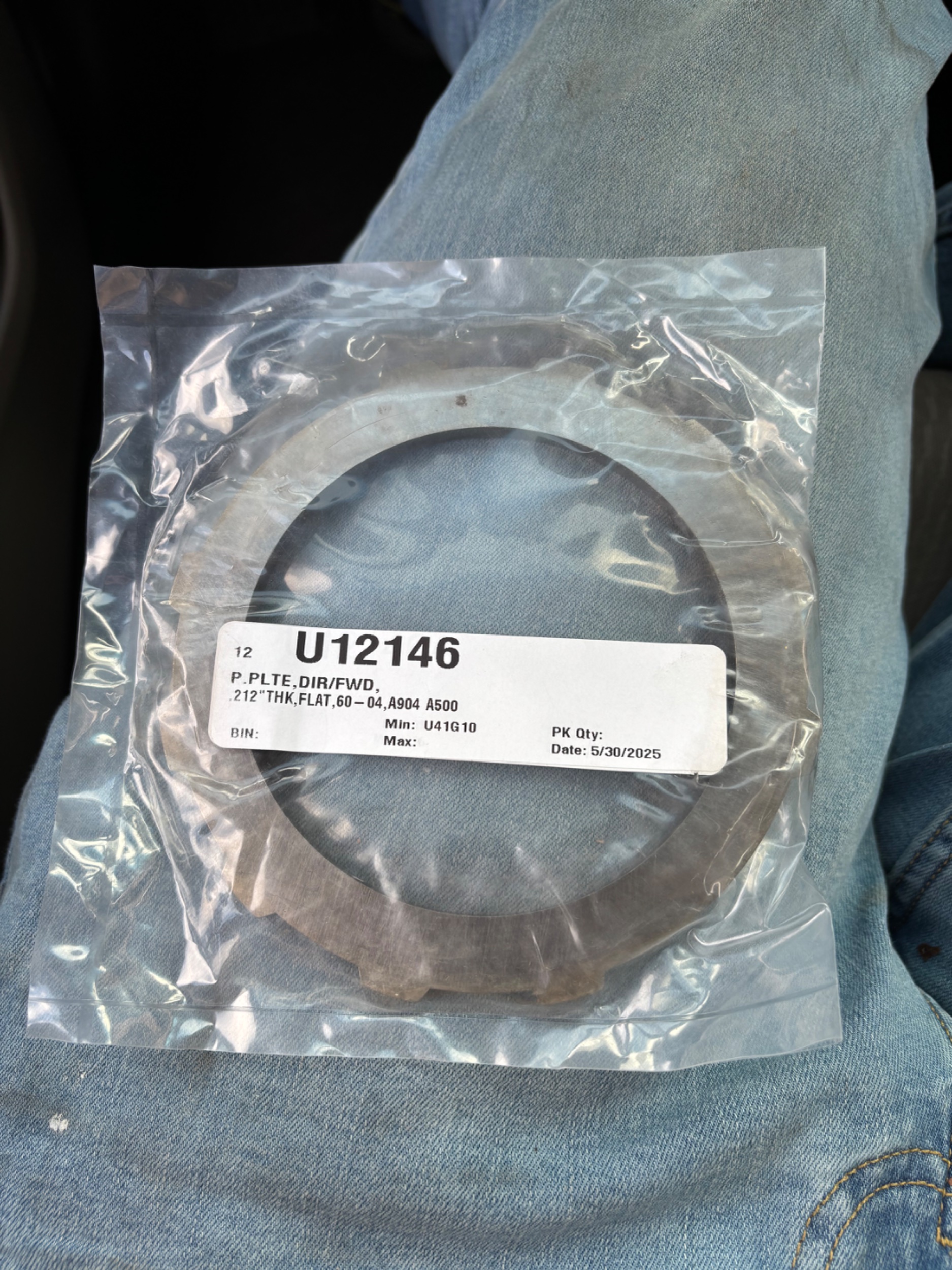

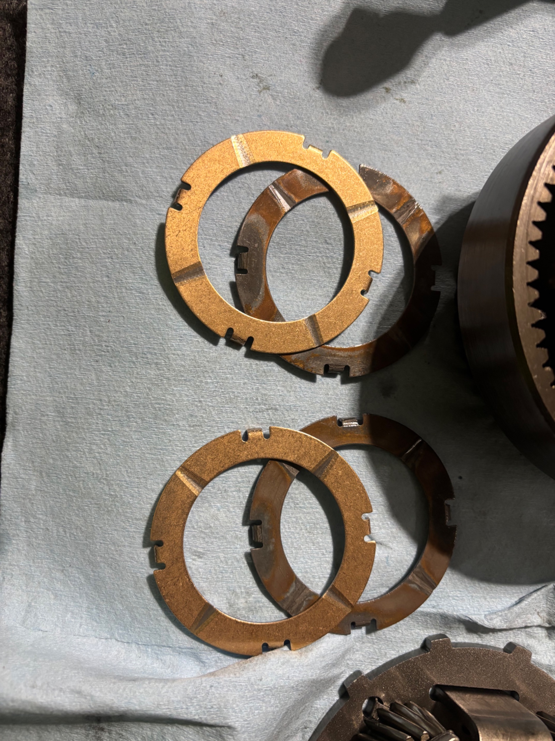

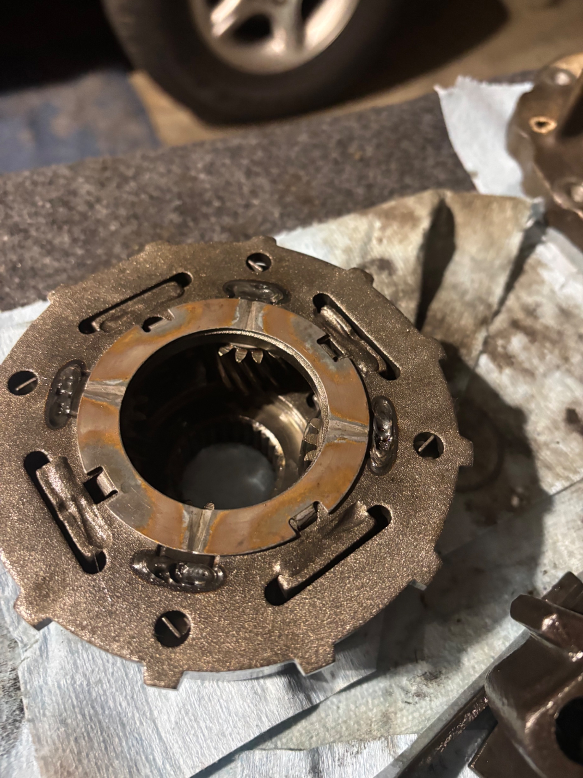

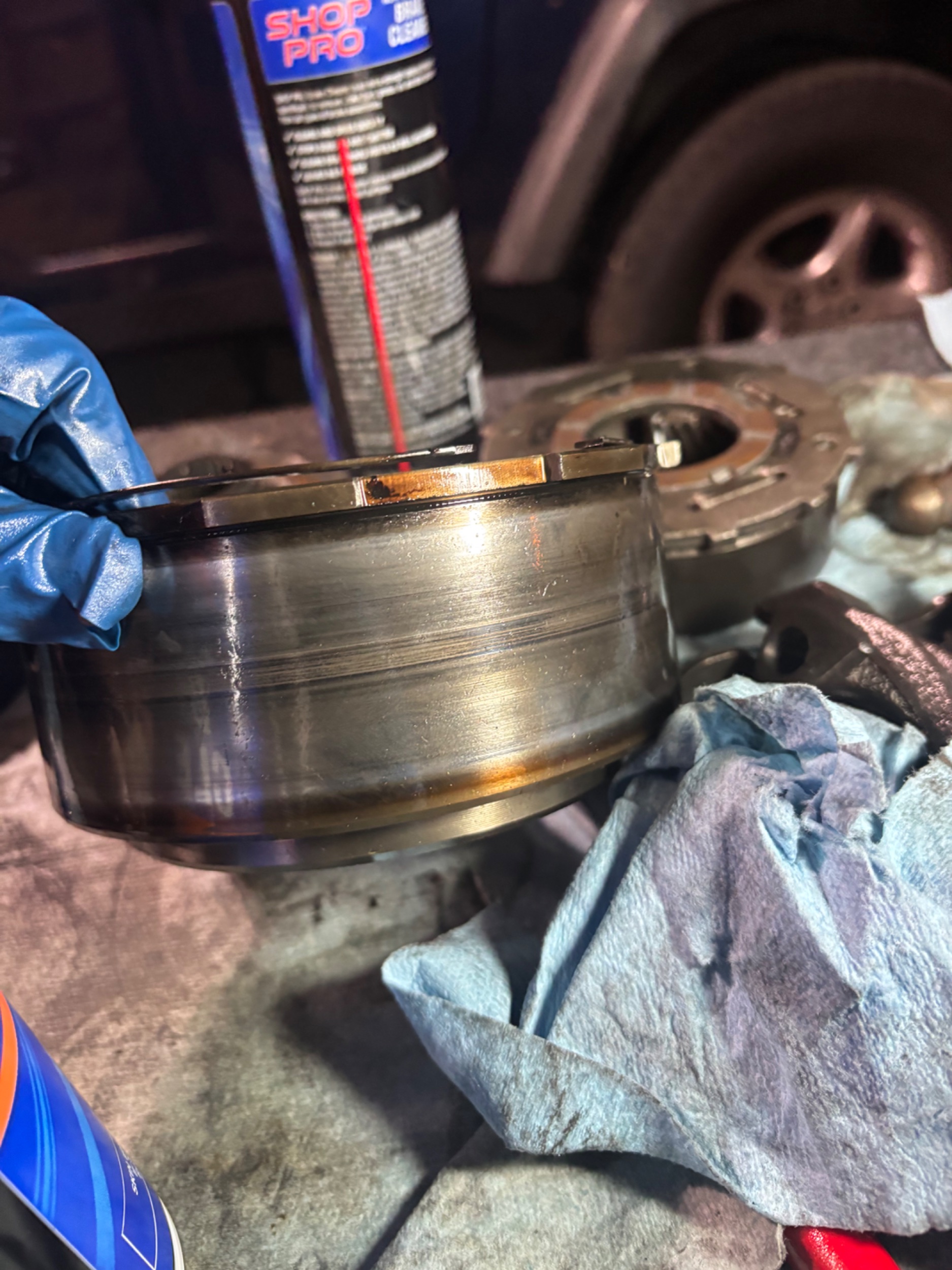

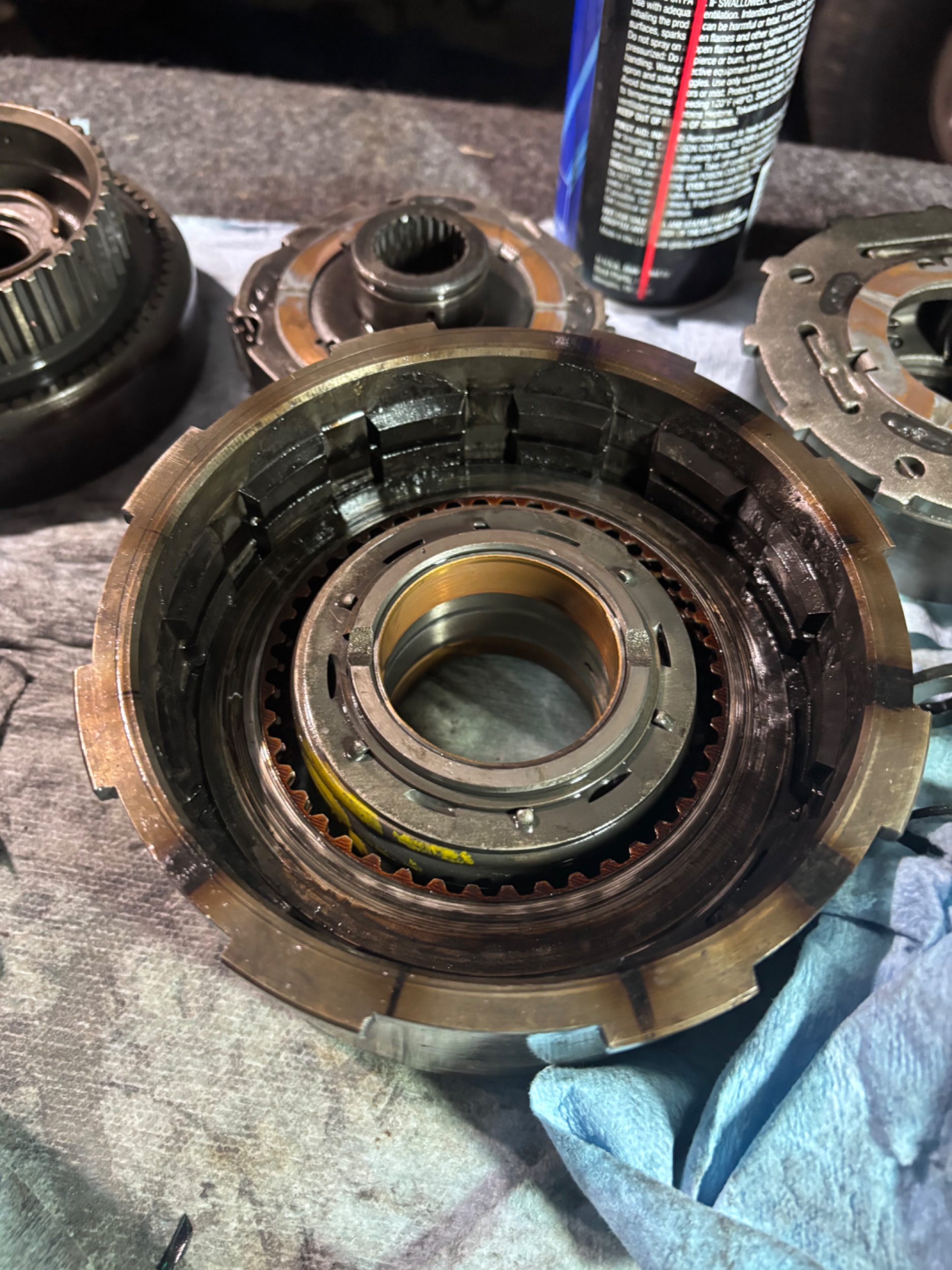

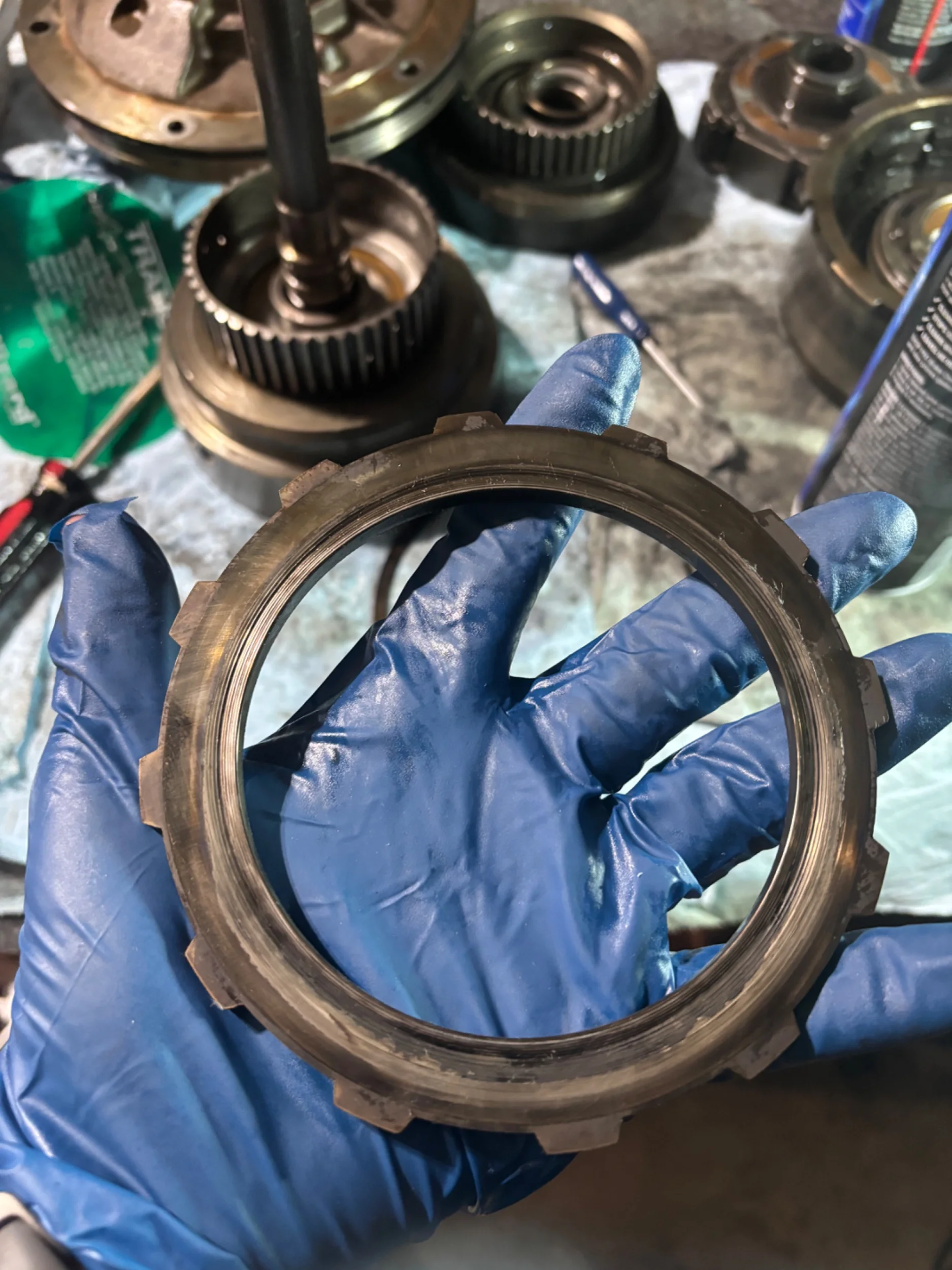

My Front Clutch drum has external scoring where the kickdown band makes contact and the frictions and steels were friction welded together and the pressure had a groove worn into it so I replaced that as well. I could salvage the drum because I was using a new band and I cleaned it all up a lot better (no substantial damage to exterior of the drum)
So far rear clutch is reassembled and I need to wait for the torque converter from A&A and get a spring compressor for my front clutch. I also need to research the output shaft more because I took the extension housing off and the output shaft came with it, I’m sure I’m just overthinking it

I fully assembled the rear clutch and I was on the tighter end of spec at 0.027. Spec is 0.025 - 0.045. I’m happily going with what I have. I put my outer most pressure plate on and kept getting a tighter clearance and I couldn’t figure out what I was doing wrong so I disassembled the whole thing and pulled the clutch piston out and then reassembled it and made a point to notice if I was putting the flat pressure plate on in the right orientation and it made all the difference. I didn’t have to replace it in the rear clutch so I could see where the clutches made contact and where the snap ring made contact and that’s how I figured it out.
For putting the rear clutch piston In, I had a Lip Wizard and it did me no good, maybe I was using it wrong. I used a .005 feeler gauge and I pushed even pressure from the top of the clutch piston as I took the feeler gauge and made it a point to ensure the seals was pushed down in the proper orientation and I made sure I used an ungodly amount of ATF so I didn’t roll and seals.
I now need to rent a spring compressor for the front clutch and re/disassemble.

Planetary Geartrain is installed. I had to take the output shaft out because I kept making a simple mistake of not ensuring proper seating of my thrust washer on the rear planet gear.

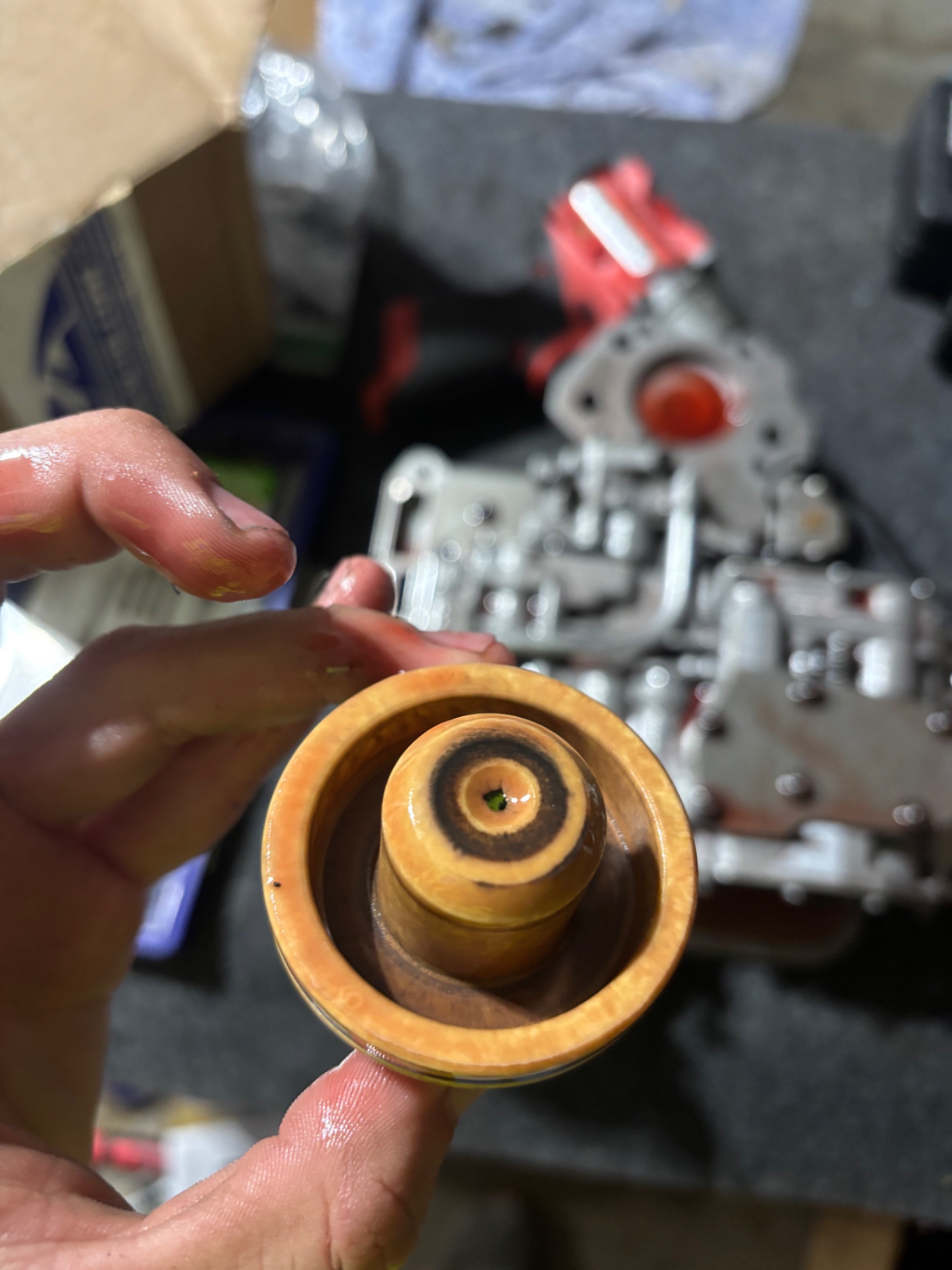

So, I ordered a new accumulator piston.
That’s not the main issue but it is adding to the issue.
So my testing procedure for my 2-3 flare was to check TV boost. I put the jeep in D and hooked up a gauge to the Line Pressure/accumulator port and set the jeep to 1,000 rpm just so it’s not idling. I then took the TV cable (runs from the Throttle Body to the transmission) and removed the spring that goes on the TV lever on the transmission.
I pushed it all the way to the front of the jeep (minimum tv) and then all the way to the rear (maximum tv). The minimum for my jeep should be 80-90PSI. Maximum should be 36-42psi higher
My psi was Min 88 and Max 90
I went to 1,500rpm and results were the same.

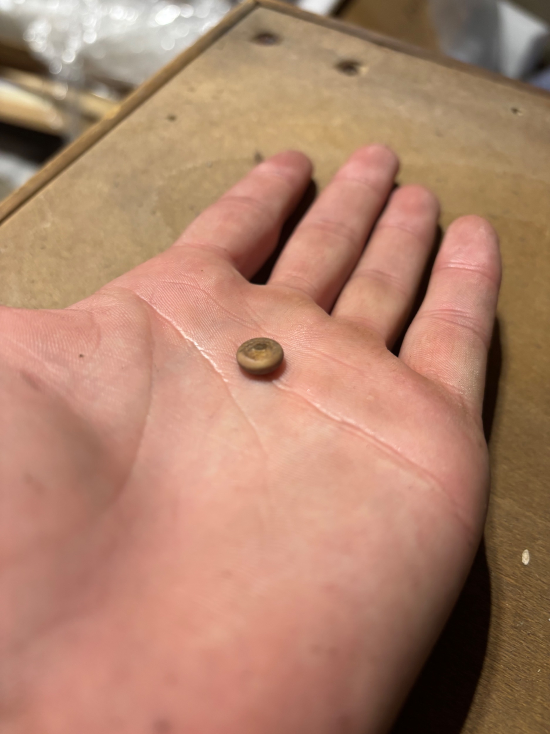

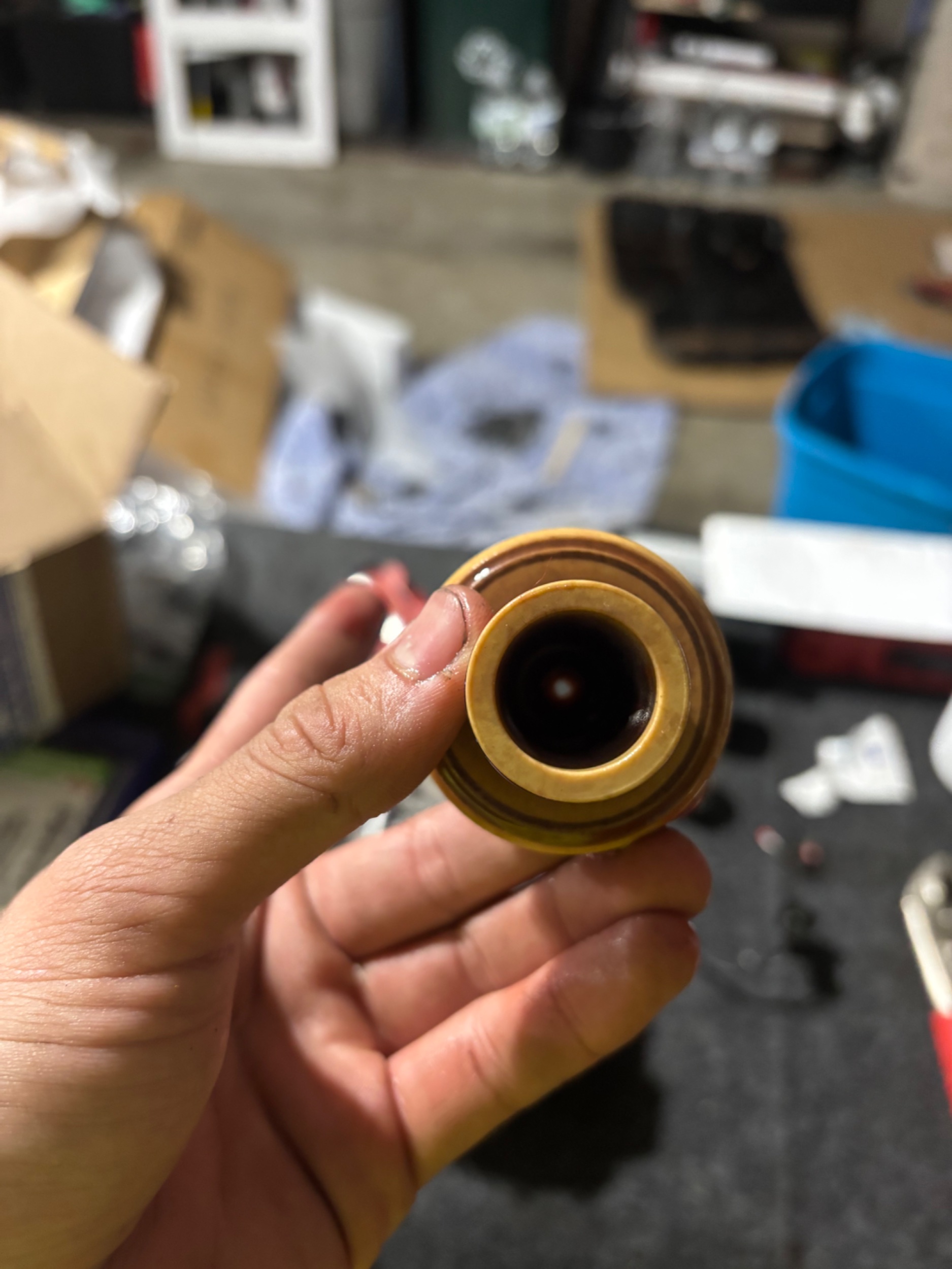

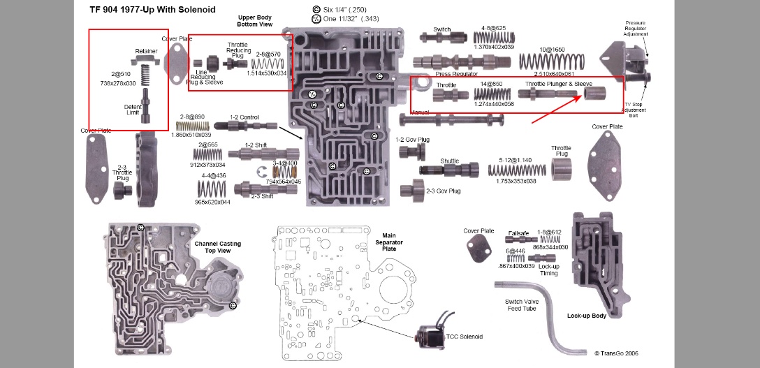

This combined with my TF-1 shows I had no TV boost at any level. The 3rd picture is my problems areas, now to diagnose further. VB is on the workbench and I’ll be disassembling the valves and problem areas
protip: video you disassembling the valve body. Those springs have a way of coming out before you're ready to take a pic and then you're left wondering how you had it.
The valve orientations is a tricky thing... the FSM has some mistakes, especially the throttle plunger & sleeve which resulted in me having the reverse problem as you; I was always at min throttle pressure where as you are always at max throttle pressure. Now the fact that part of that shift kit involves fully tightening down the pressure screw is something I didn't have to contend with, but it would seem like whatever the shift kit does to counteract that isn't doing it's job.
I also find it amusing that the valve body relies on different pressures in different areas, but not one bit of it is actually sealed. It's all just cover plates held on by screws torqued to like 35 inch-lbs. Those areas have to bleed pressure like crazy. But I guess it's not enough to matter. Even the transfer plate, which is the only thing that keeps the passages distinct, is only held down by a couple of screws. It could easily flex slightly and allow crosstalk among the passages. ¯\_(ツ)_/¯
