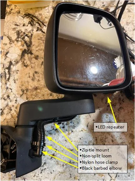

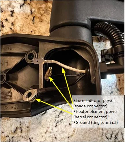

I've been working on heated mirrors with a turn signal repeater integrated also. Waiting on a few parts to arrive to be able to finish them up. I've been trying to document things as I go to post a write up when I'm done. I'll be using a timer circuit with relay to have it shut off after a determined time frame.
It's actually been a background project for me for about two years. One of the mirrors I was using had the mounting screws snap off, and I was waiting for a buddy to bore them out on a mill, as his screw extractors didn't work. I finally just ended up ordering an extra mirror from eBay.
Here's a preview (and I know you can't really see the heating element):
