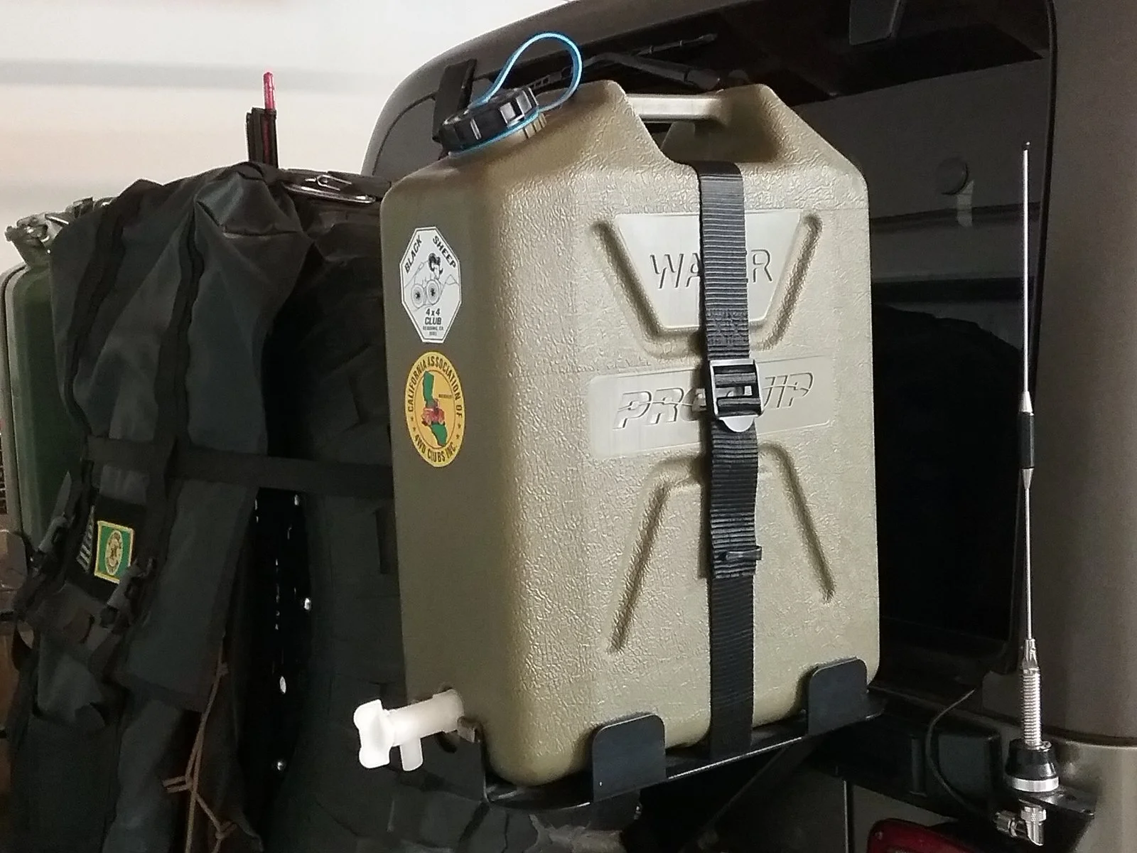

The water can on the passenger side has a bung for a spigot, shown below, which is handy in camp.

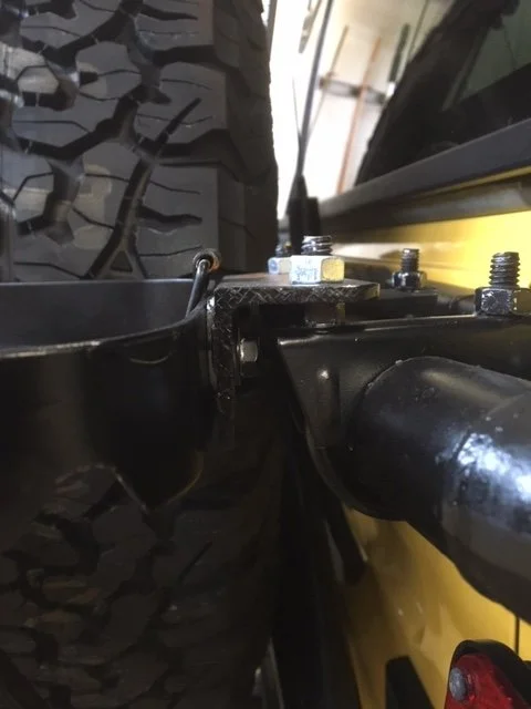

How does the can holder actually mount to the carrier?I’ve been on a couple of Winter runs where we used at least twice if not three times the normal fuel amount due to deep snow. A few times when I finally arrived at the closest fuel station at 3-4:00am the fuel gauge was on empty. After that experience I started carrying extra fuel during most Winter runs.

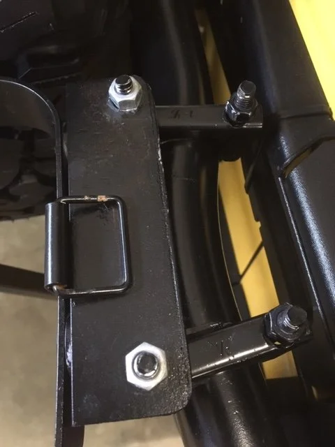

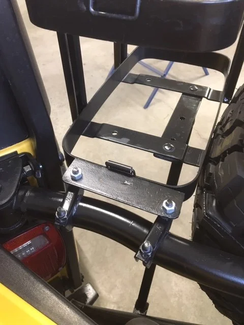

Here is my Smittybilt fuel can holder mounted to a Bestop tire carrier, the MFC fits perfectly in the carrier.

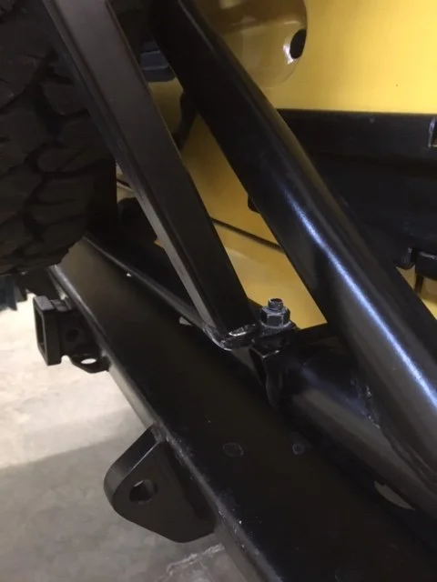

1-1/4” exhaust clamps on the carrier, a piece of 1-1/2” x 1-1/2” angle bolted to the clamps and bolted to the carrier then I added a brace going to the lower tire carrier horizontal bar. I can get more pics tomorrow if you’d likeHow does the can holder actually mount to the carrier?

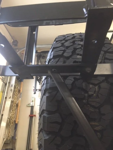

Would really appreciate a closeup pick. I would love to hang a water can from my 45 degree carrier, if it can be done cheaply. You seem to have done it!1-1/4” exhaust clamps on the carrier, a piece of 1-1/2” x 1-1/2” angle bolted to the clamps and bolted to the carrier then I added a brace going to the lower tire carrier horizontal bar. I can get more pics tomorrow if you’d like

Here you goWould really appreciate a closeup pick. I would love to hang a water can from my 45 degree carrier, if it can be done cheaply. You seem to have done it!
