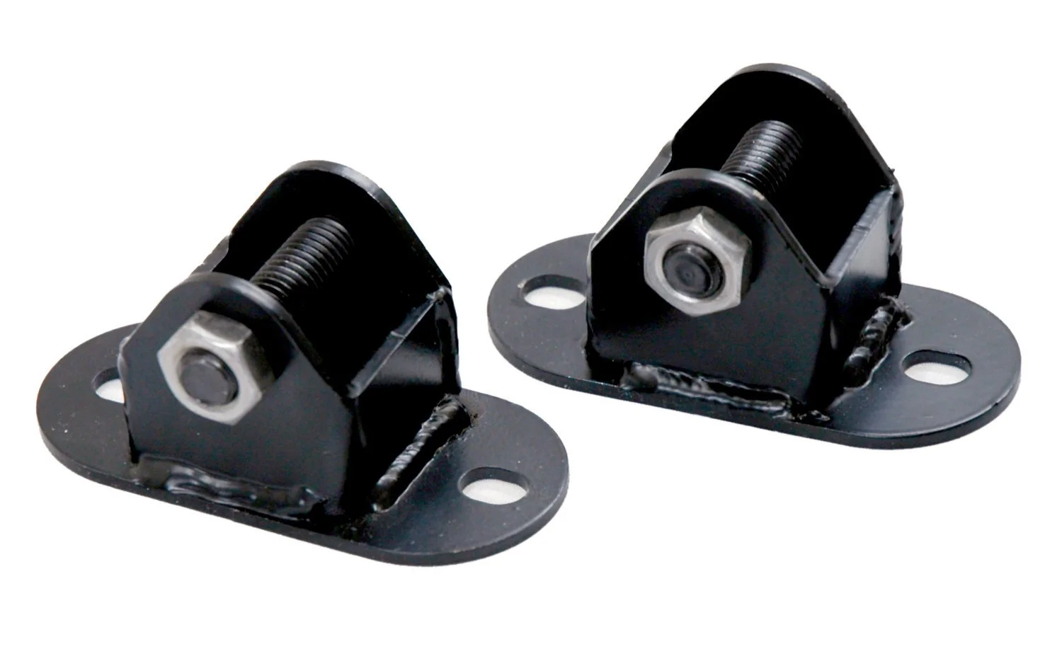

Today I finished up the rear half of my lift! All bolts are tightened up, bumpstops were made and installed, shocks mounted, etc. I'm not super happy with the rear shock set-up on a TJ. After cycling the suspension, the shocks do not appear to be in the correct position. I mean, they are installed in the factory location, but that doesn't work well. My track bar (on a relocation bracket) hits the crossmember before the shocks bottom out on compression. So..I installed 2" lift springs and had to add a 1.5" bumpstop extension to stop the contact. I still have about an inch of compression on the shock. Since the shock is biased higher than it should be, they are also limiting droop FAR before the springs come unseated. I'm going to buy some bar pin eliminators, which should shift the shocks to be more balanced in their travel. That is the Theory anyway. With the shock more in the middle of its travel at ride height, I should pick up some more droop and be closer to bottoming the travel of the shock out at the same time my track bar starts to contact the cross member. @jjvw or @mrblaine I'd appreciate either of your thoughts here.

The BPE will shift the up travel into down travel, but they will also require more bumpstop extension if the bumps are set for the shocks.
