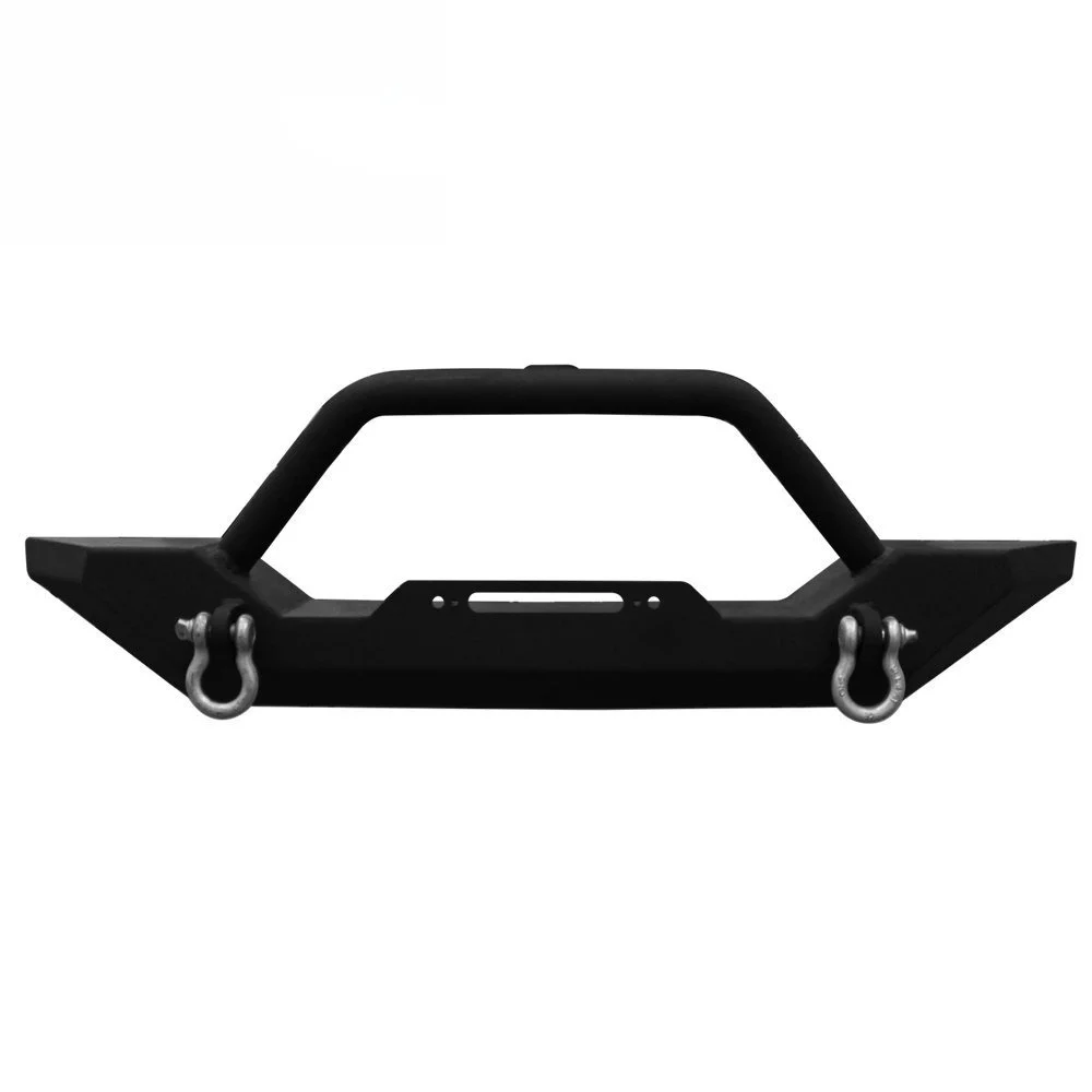

So...I know I said I was going to build my own bumper...but I found this on amazon a couple days ago...
It was 184 dollars, and free prime shipping. I can't say no to that. My time is worth something...and I'd have 150 into material for the bumper I designed. So, its now on its way...3/16" steel, and comes with D- rings. Unbelieveable. I bought it, half thinking that its a mistake. The E-autogrills one of the same design is 50 dollars more, and thinner steel.
I had that same bumper on my old TJ. It held up nicely and looked great too!

UPDATE: I finally felt like me again! Got out in the shop tonight and started tinkering on the ol girl. She's excited to be getting shiny new parts. First order of business was play around with that new bumper. I'm pretty impressed with the finish on it. It was damaged in shipping...the fairlead mount was bent. Not surprising, considering how its packed. They had that plastic wrapped spray foam on one side, and nothing on the other. The bumper itself was wrapped in plastic cushion wrap. Anyway, not big yank for me. I have already straightened the metal. You can see it in this picture.

I offered it up to the Jeep to see how it fit...and it fits OK. Not great. I'll have to open up a couple bolt holes a tad and the spacing is off. I'll have to put a spacer in to fill the gap on the bottom as shown below.

Overall, It looks pretty good on there. It appears hand welded and well reinforced. I'm pretty happy with it for the price. My expectations were honestly pretty low...and I think it exceeded them.

I've had that bumper on my previous TJ. I was happy with it as well and didn't have any issues.
Great start. Glad you’re feeling better. Nice to get back in the garage! Bumper looks nice and very functional as well. Sounds like you’ll be busy with some rust underneath. Gonna look great with all the new parts coming!
