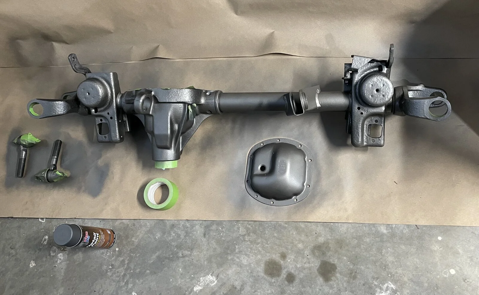

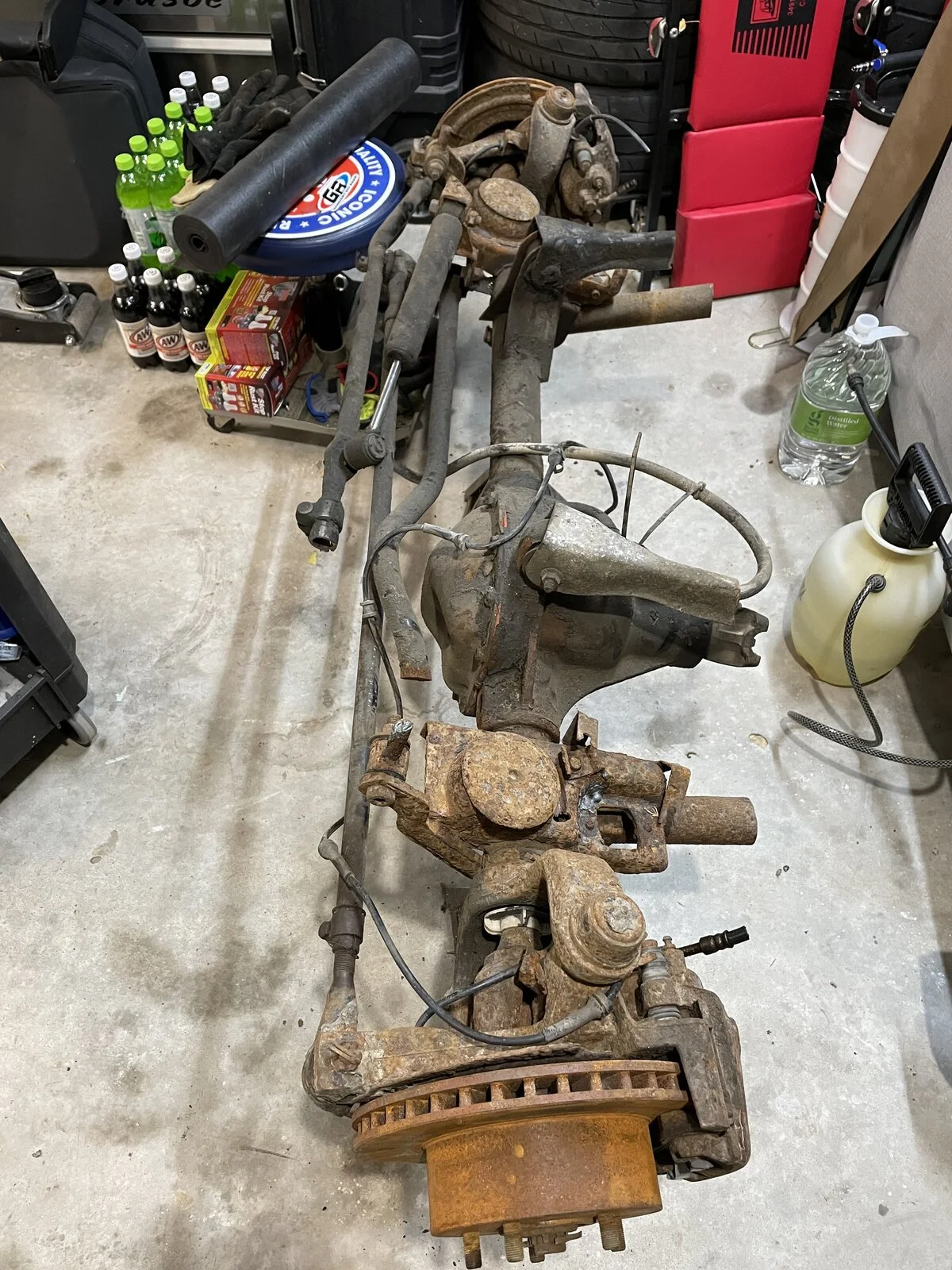

Hey guys thanks for your input on this. Sounds like the overall best answer is just to keep the axles I have and build them stronger. What about lockers or LSD int Dana 30 and 35?
And someone correct me if I'm wrong, but I'm pretty sure you could avoid the Super35 using an LSD for 35s.
