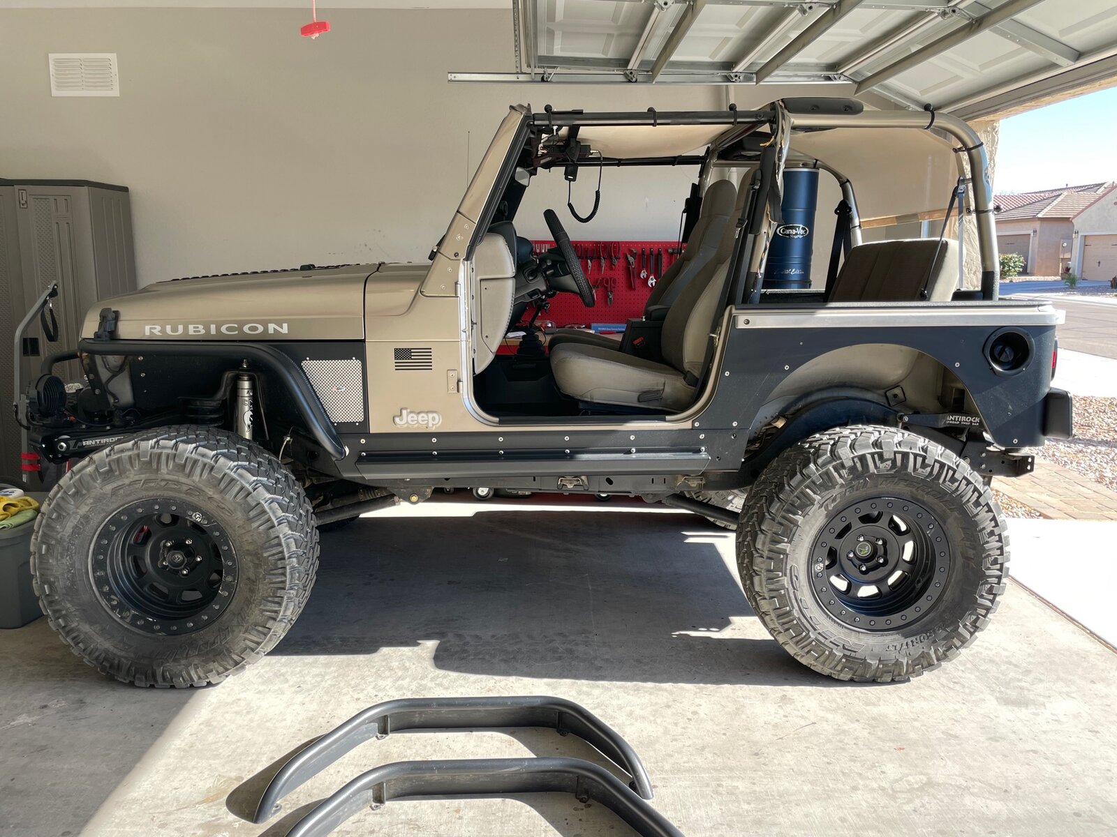

Got the rear fender flares off this afternoon, now I'm just waiting on the GenRight Boulder 0" front fenders to complete the no fender flare look. I think this will fair better in the rocks, as I have been pretty close to smacking the flares themselves on rocks and I know they aren't going to bend nicely like plastic will.

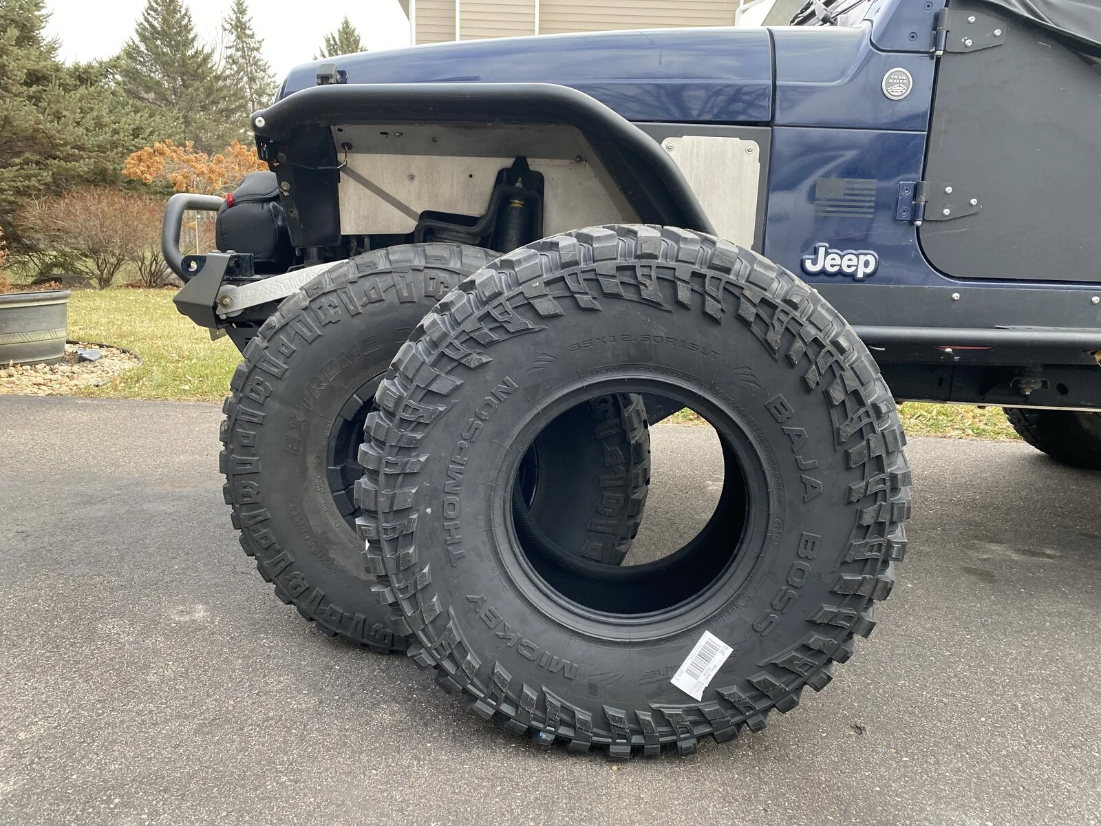

Do those GR fenders give any extra clearance over stock fenders? Even 0.5" Those look good. Both my fenders are a little messed up, so I'm thinking of doing the GR's.
I think Blaine meant that the flare needs to be 0" in the front for playing in the rocks, so they are flush with the tub.
I can’t say for sure as the vehicle came with them. I don’t think they provide anymore clearance though.

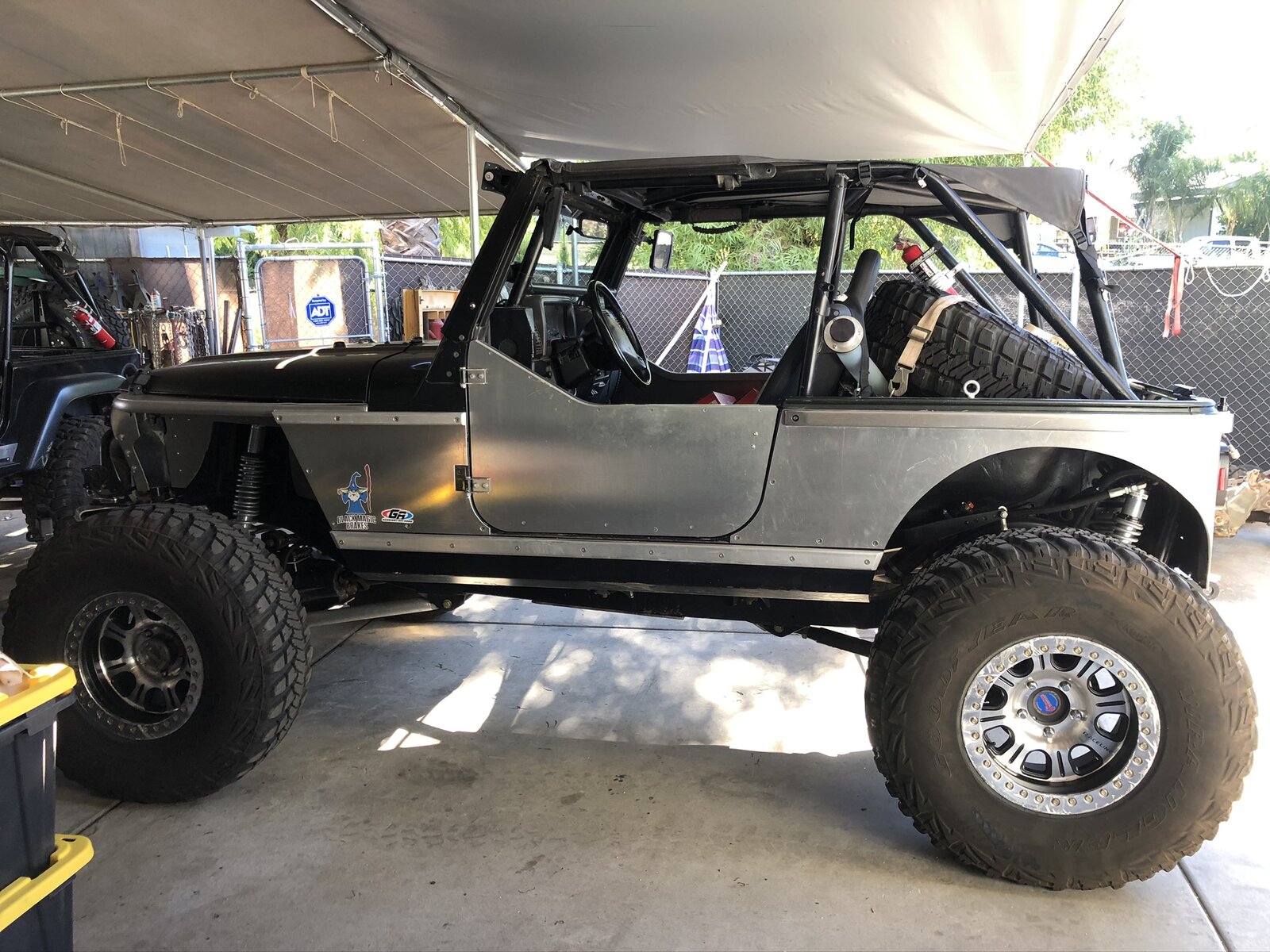

How do you modify the TJ slider to reach wheel well to wheel well?
They have to come ww2ww, then trim at 45* at the long point in each wheel well. I think that's what he's saying.
This was a rig at Blaine’s house that he built. I believe this shows what Blaine was was talking about with building the slider all the way to the wheel wells but correct me if I’m wrong.

The front rub rail slider is also a cool detail.
