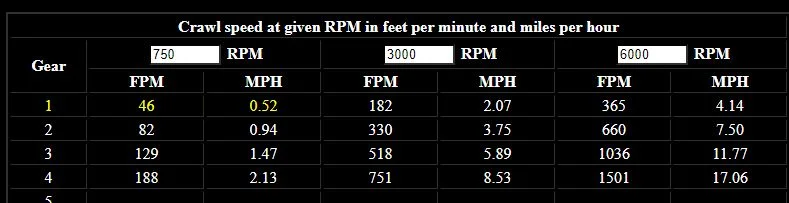

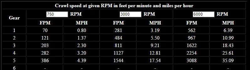

I'm at roughly 97. You're going to be closer to 150
MPH in gears.
Mine:
Your's:
I'm more shocked about the 6,000rpm 17mph in 4th. Looks like the days of flipping the OD switch are behind you 🤣
