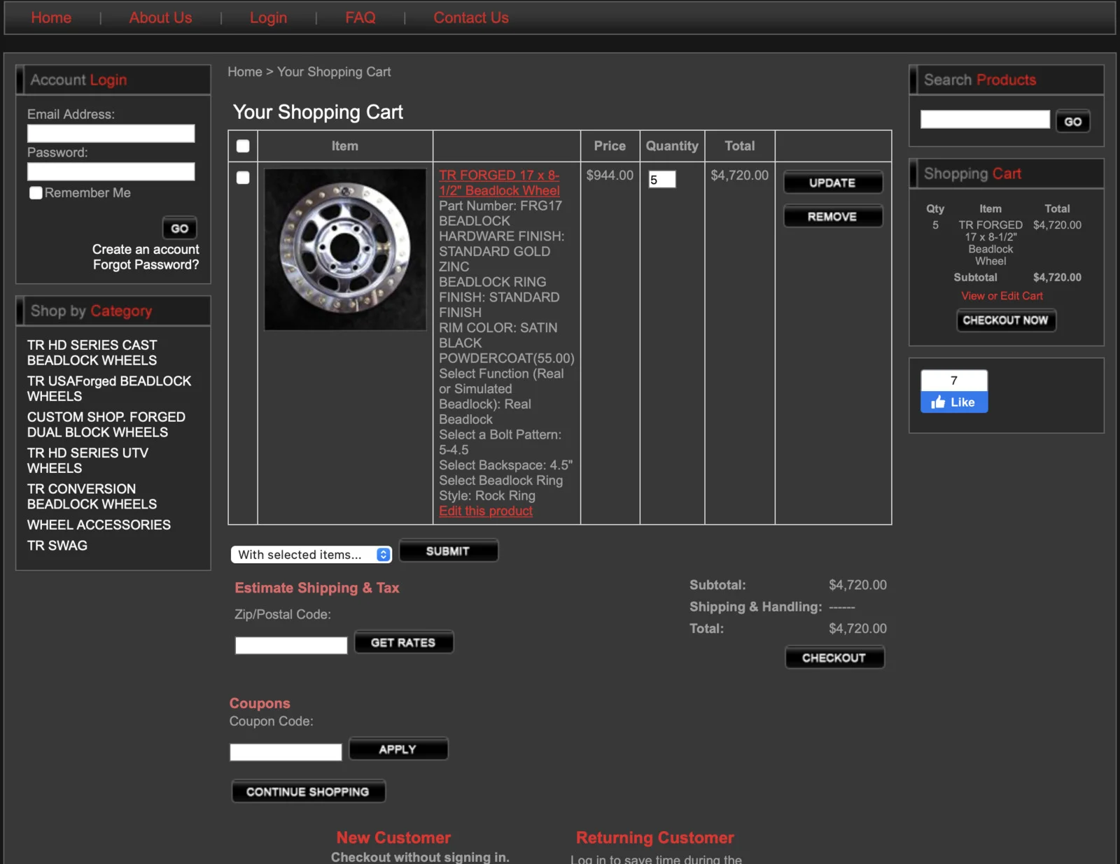

What's the reason you'll need new wheels again? Hub won't fit through the center hole? Or too wide?
The new hubs will stick out further. With my current backspacing (3.75") it's going to push the front wheels out even further, thus causing issues when the suspension cycles. The center bore on these current wheels will fit the hub just fine, it's the backspacing that's an issue.
Got it. I am running 3.75" backspace with the hubs kit. So, I was wondering what it was. My bumpstop stops the tire for my old stock fenders, so I'm golden for now until I rip it apart and re adjust for the little extra the MCE offered.
Here's what a set of 5 new wheels would cost me with the correct backspacing:
Did Blaine say the decrease in backspace from the hub kit would create interference issues? I could be wrong, but I was under the impression that the reason you can’t use these wheels is because the scrub radius would be poor. Maybe because he’s fighting for every fraction of an inch under there fitting those 12” shocks.
I’m running 4” backspace wheels and the hub kit with no interference issues and I never noticed the bad scrub radius. For me I think being able to add in a bunch of caster improved the handling so much that everything much better with the hubs. This is all with .25” more backspace than you would have.
Reactions: taylormade73
Yep, and my issue is that my wheels are currently 3.75" backspacing. So that leaves me having to order new wheels which would be around $3000. I could sell my wheels and offset the cost, but I'm still left having to swap tires (not much fun on beadlock wheels).
Then there is the cost of the hub kit and probably some other stuff I am leaving out.
It may end up that I go down this path eventually anyways. If I could find someone to pay top dollar for my wheels I might be tempted to do it. These wheels are $600 a piece, so $3000 for a set. Maybe if someone paid me $2500 or so I might do it.
I'll give you $2500 for the wheels if you leave your tires on them ;)
Reactions: Wildman and Chris

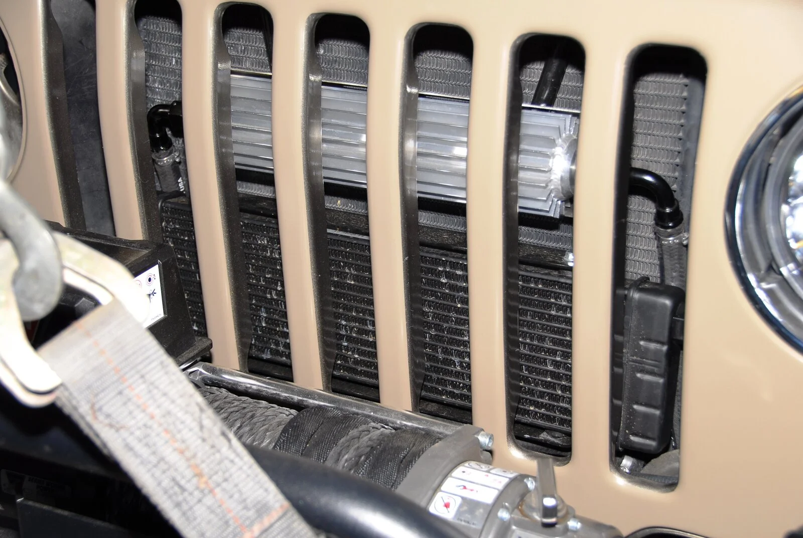

The Setrab cooler is mounted right below the PSC cooler:

I've had my eye on the Setrab cooler since I saw Blaine mention it. Which model did he install?

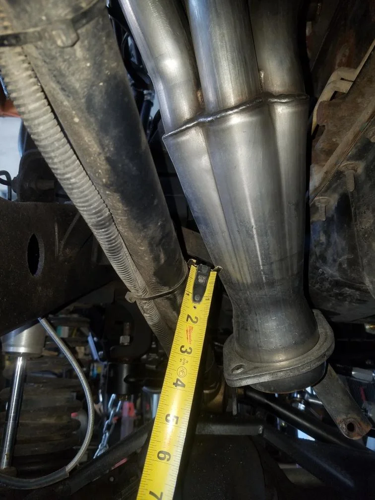

Bad news for the header install:
https://wranglertjforum.com/threads...e-header-system-without-cats-brand-new.48574/
This photo was taken at ride height. This wouldn't have been an issue if it wasn't for the mid-arm. The upper control arm on the mid-arm is much longer than a short arm and at a different angle. This causes the arm to crash into the headers with anymore than an inch of up-travel.
I was the test dummy for finding out if this would work on a mid-arm setup so at least we now have an answer. If it was a short arm setup I wouldn't have an issue.
Bummer!
