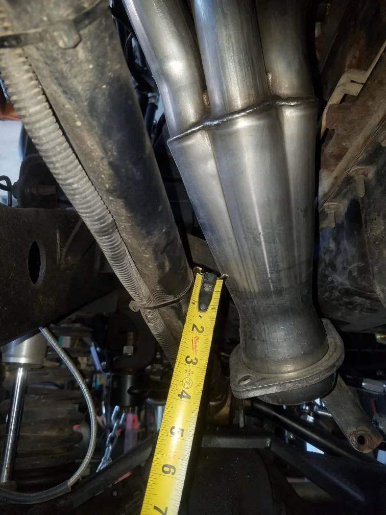

Bad news for the header install:
https://wranglertjforum.com/threads...e-header-system-without-cats-brand-new.48574/
This photo was taken at ride height. This wouldn't have been an issue if it wasn't for the mid-arm. The upper control arm on the mid-arm is much longer than a short arm and at a different angle. This causes the arm to crash into the headers with anymore than an inch of up-travel.
I was the test dummy for finding out if this would work on a mid-arm setup so at least we now have an answer. If it was a short arm setup I wouldn't have an issue.

Not to crap on anyone's parade but they hang down below the oil pan where they go around the front of it. Even if I could have cut the mount loose on the truss and moved the arm over to the outside enough (big maybe), I would have had to drop the engine skid down 3-4" at the front. Fuck those pieces of shit and the goddamn horse they rode in on. All they had to do was flatten the collector front to back and tuck it in close to the block and they would have been almost fine. Instead, they offset them almost 2" away from the block and made a collector the size of 7 primary tubes in a circle.
