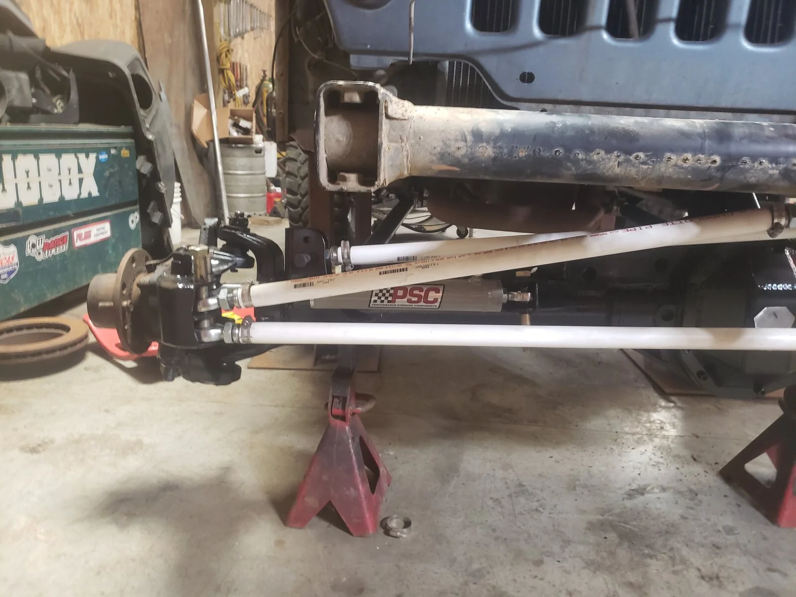

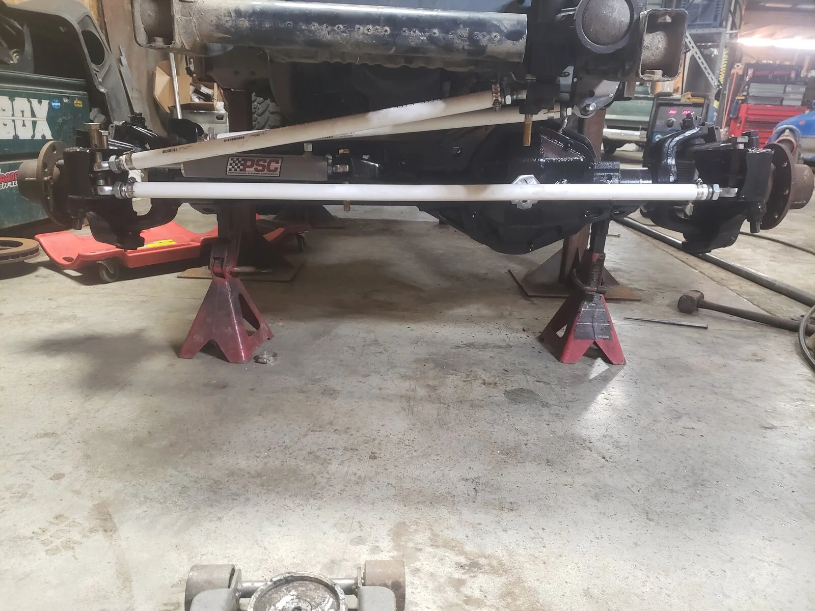

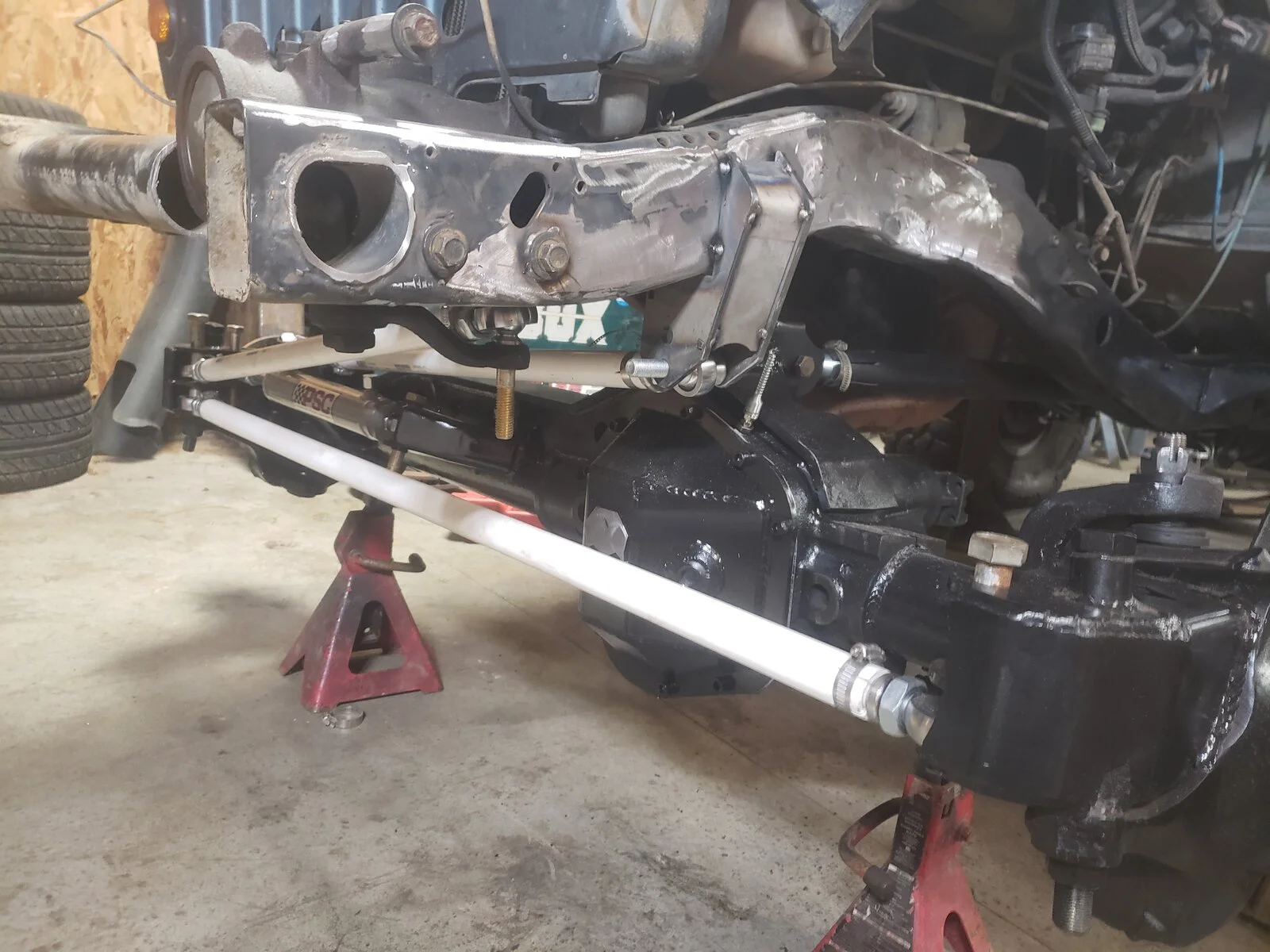

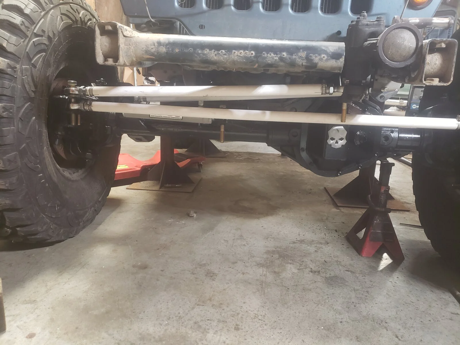

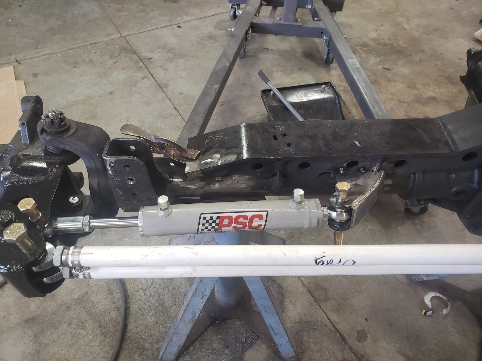

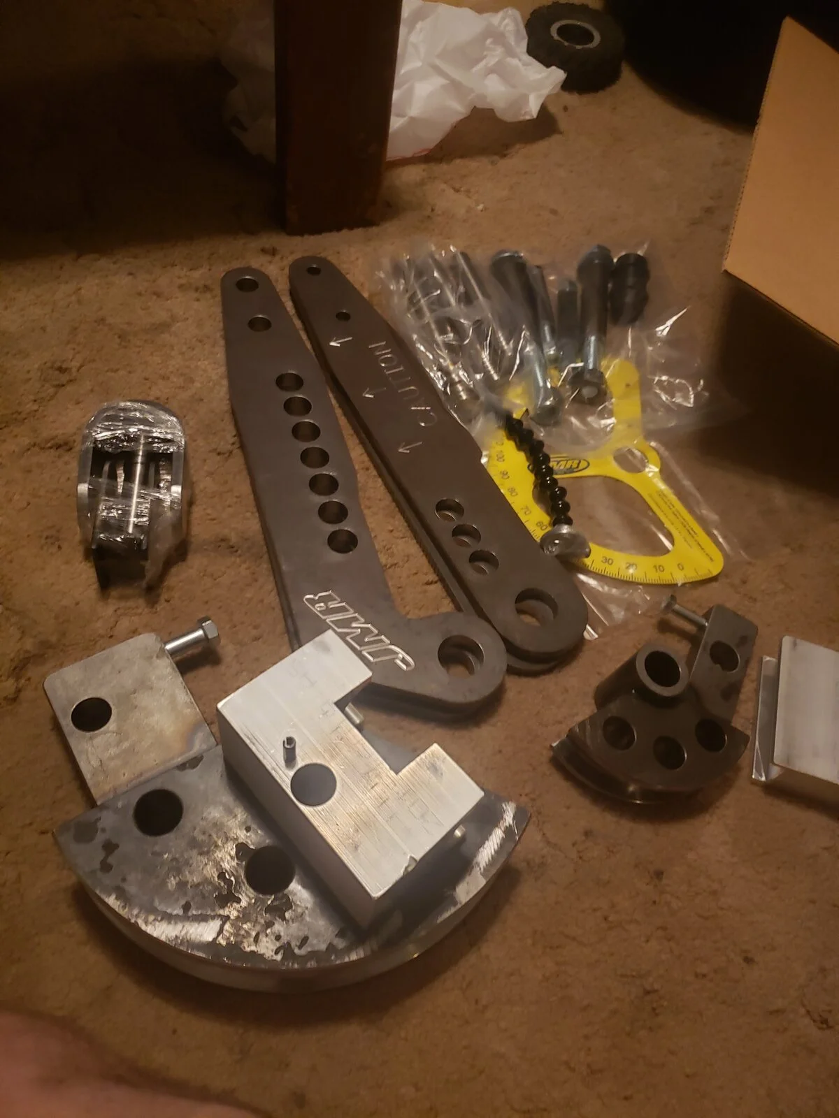

Got a new toy. I plan on building a rack like this for it
That track bar / drag link setup is going to result in some nasty bump steer. Can you mount the pitman arm heim under the pitman arm? That would get your drag link much closer to parallel with the track bar.
I am planning on moving drag to bottom of pitman l just didn't have a nut for my bolt so l put it above for mock up and l dont have my spacers for my joints so it will flatten out drag a lot
