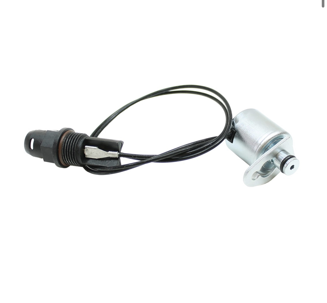

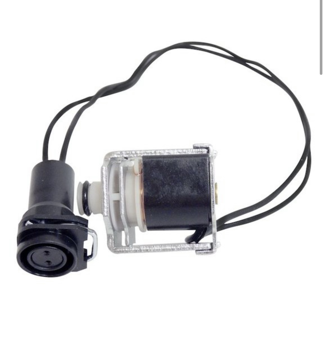

Mine was the same. We had the 3 pin pop on rubber cap that dries out and gets hard and won't stay on. I swapped to the later style connector with a repair connector and the later NSS. (it isn't the TCC connector and you're slightly confused, or I am)
The solenoid and Internal pass through connector is different.
97:
Later years

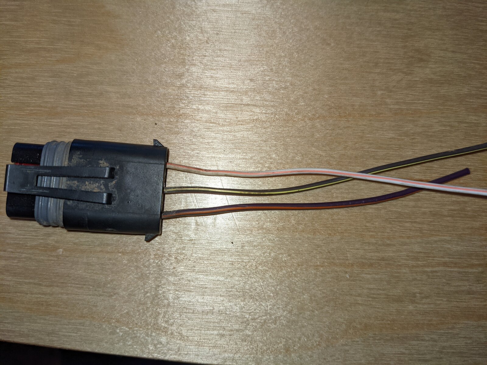

My vehicle speed sensor wiring(when adapting to super short sye) has different colors than on the JB manual and seen online.
White/orange, brown/yellow, purple/orange.

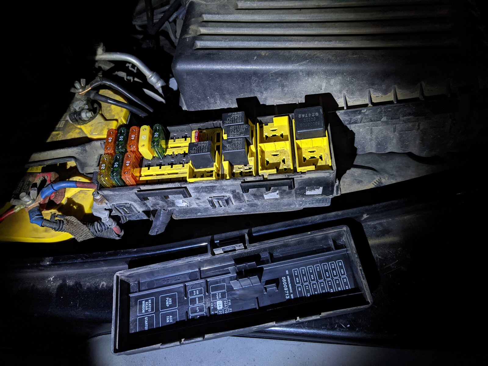

Is there a mid year split on the under hood PDC fuse and relay block? Mine snaps into the bracket with two fingers only on the inboard side, the outboard side is open. The later versions all have 4 fingers that that block snaps into, 2 inboard and 2 outboard.
I need a cover, all the ones I find for sale open from the side correctly but are not deep enough. They are also listed as 97-00 or 97-01 which is not accurate since the ones I bought do not work.

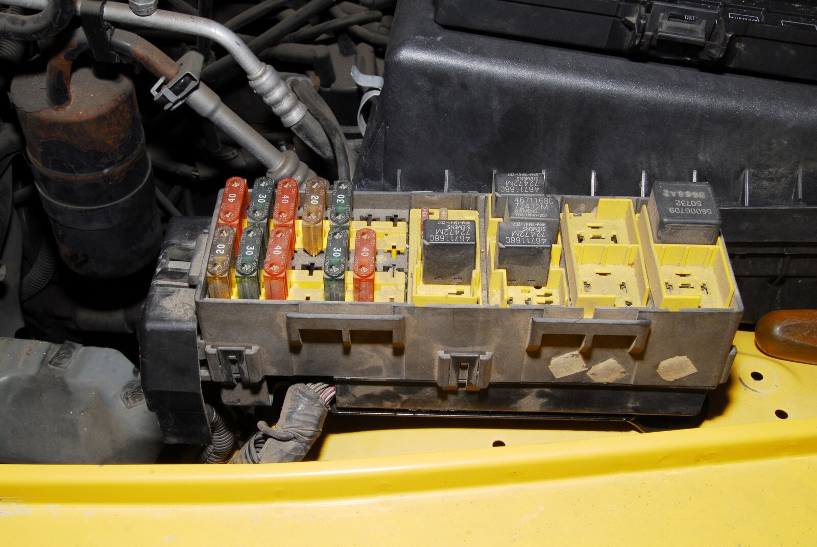

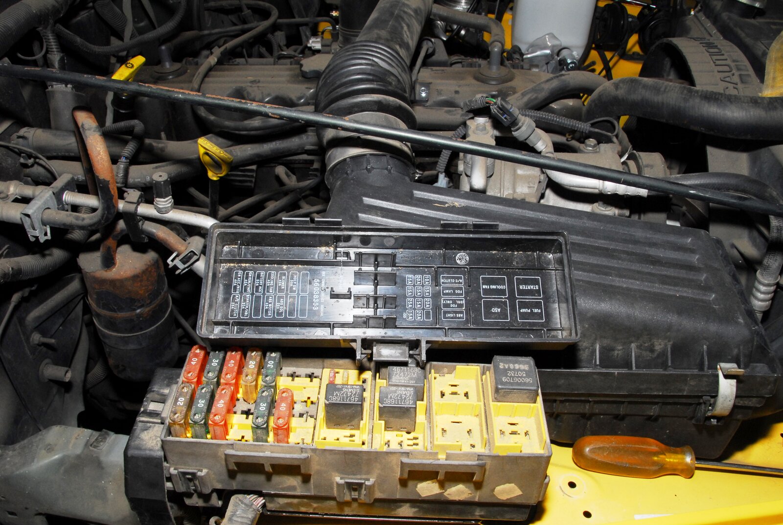

Do you have a picture of what yours looks like? It may more closely match an XJ
Here's mine.
Here's mine.
Just so I get this right when I update the original post: is this a pic of your TJ or XJ?
It is a TJ, you can tell by the air box and fender lip that the hood shuts over. XJ has a flush hood that is essentially straight from firewall to grill.
