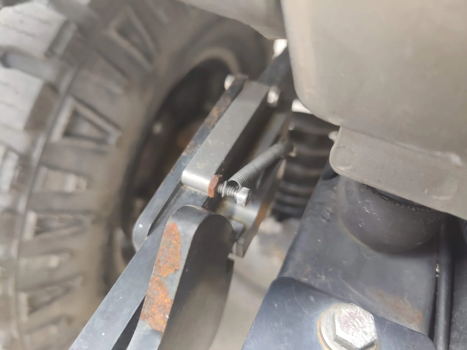

Does anyone else have an issue where the lock walks itself back after 3-4k miles until it's unlocked? It's happened to my wife's TJ twice now.
What keeps the spring from pulling the lock back in?Does anyone else have an issue where the lock walks itself back after 3-4k miles until it's unlocked? It's happened to my wife's TJ twice now.
I have the air activated version and don't daily drive mine but I would think a regular cycling regimen might help, maybe once a week.Friction due to a slightly rough surface from a few years of sand and grit. It can be pushed back by loosening the bolts 1/4 turn or a few light taps.
Mine has never done that, but I can see how it could since the slot is not square. I do have a good bit of wear on the finger, which I’ve often wondered if that could cause it to disengage. Maybe @mrblaine will chime in if he has seen this before.Does anyone else have an issue where the lock walks itself back after 3-4k miles until it's unlocked? It's happened to my wife's TJ twice now.
If the slot was square it would only stay tight until some wear developed. Then the slop would get progressively worse until the annoying clicking would require it to be replaced. If the slot is tapered slightly and the tongue has a matching taper with a shorter than full depth engagement, then it automatically compensates for any wear and the spring will maintain a zero clearance fit.Mine has never done that, but I can see how it could since the slot is not square. I do have a good bit of wear on the finger, which I’ve often wondered if that could cause it to disengage. Maybe @mrblaine will chime in if he has seen this before.
I do think it has to be kept very clean to work properly. I pressure wash my rig and that does a good job getting between the arm and the actuator.
FIFYI have the air activated version and don't daily drive mine but I would think a regular clean and lube regimen might help, maybe once a week.
