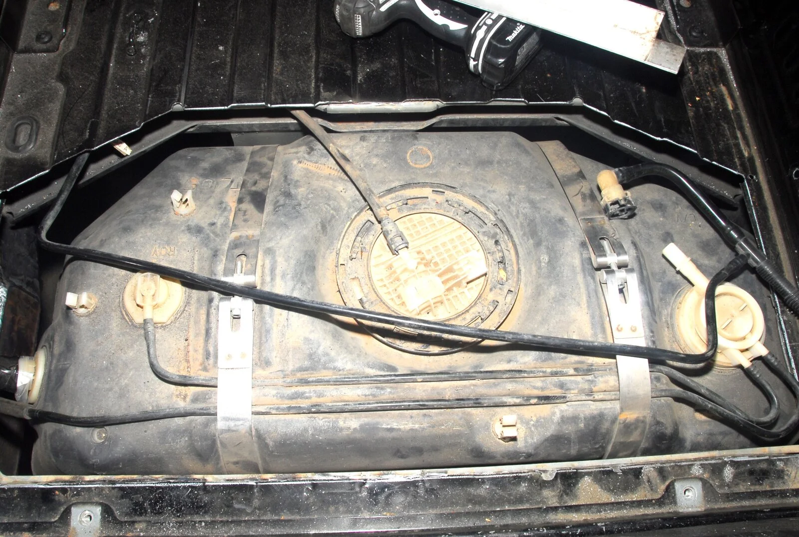

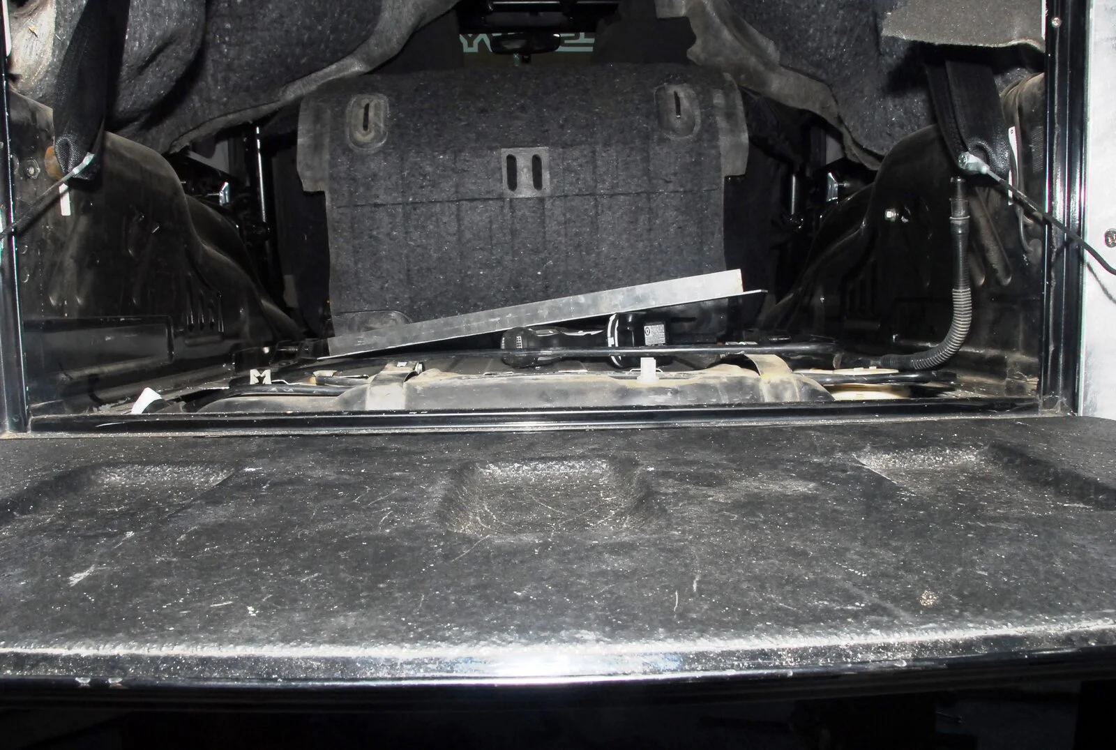

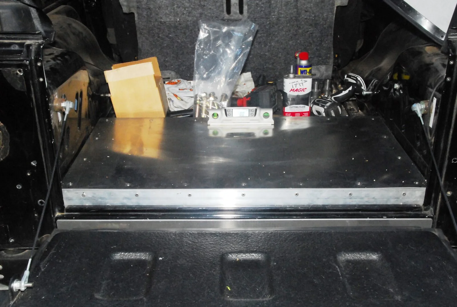

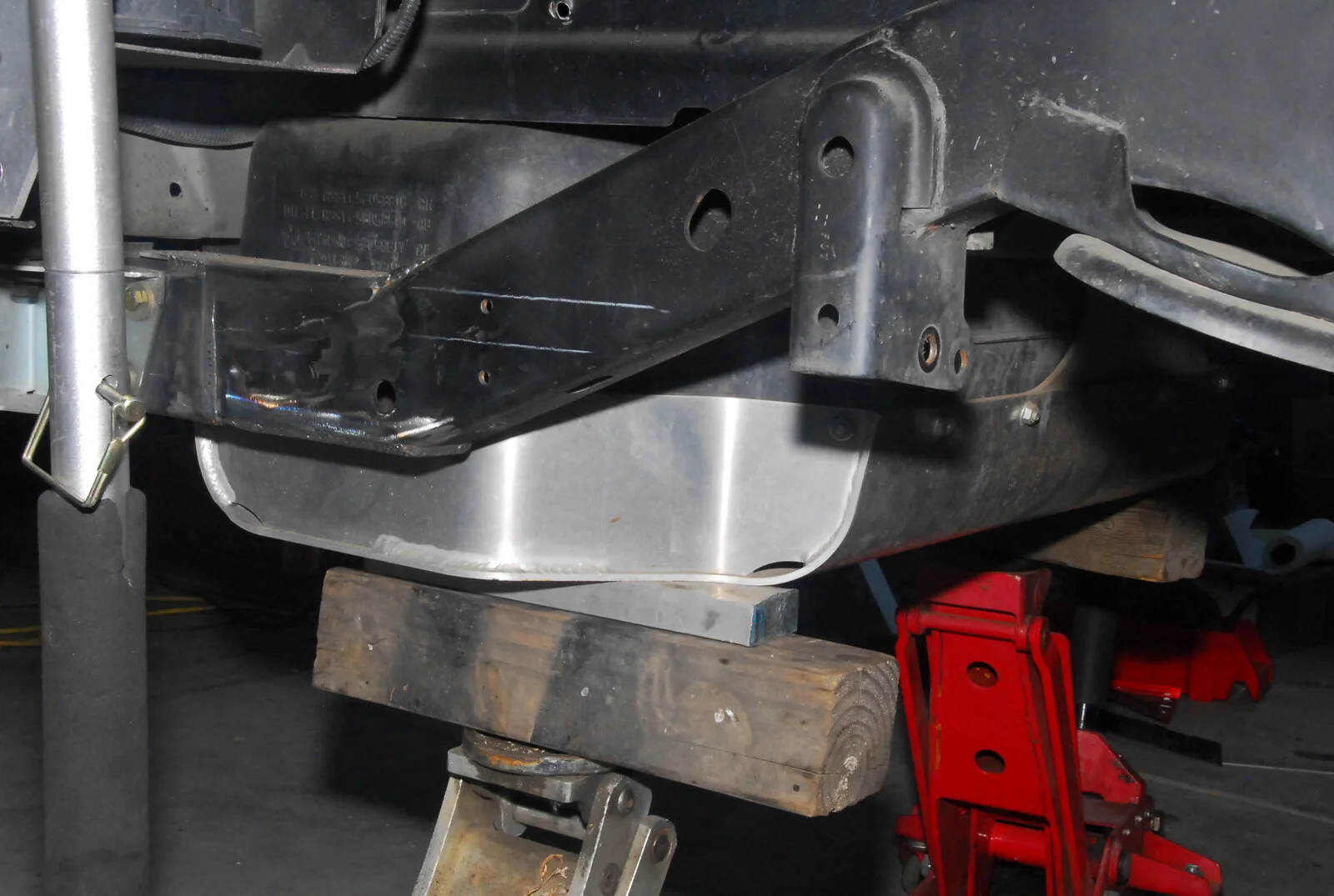

You aren't helping yourself much by moving the tank back that far if you don't also raise it. The rear overhang on a TJ Unlimited is bad enough with the tank forward. Moving the tank back and doing nothing else only makes that miserable.
Although I'm always leery of putting pics of my rig in front of Blaine, I agree on lifting the tank. With mine all the way back, I was also able to lift it almost 2" above stock. Even stretched, it definitely helps.
