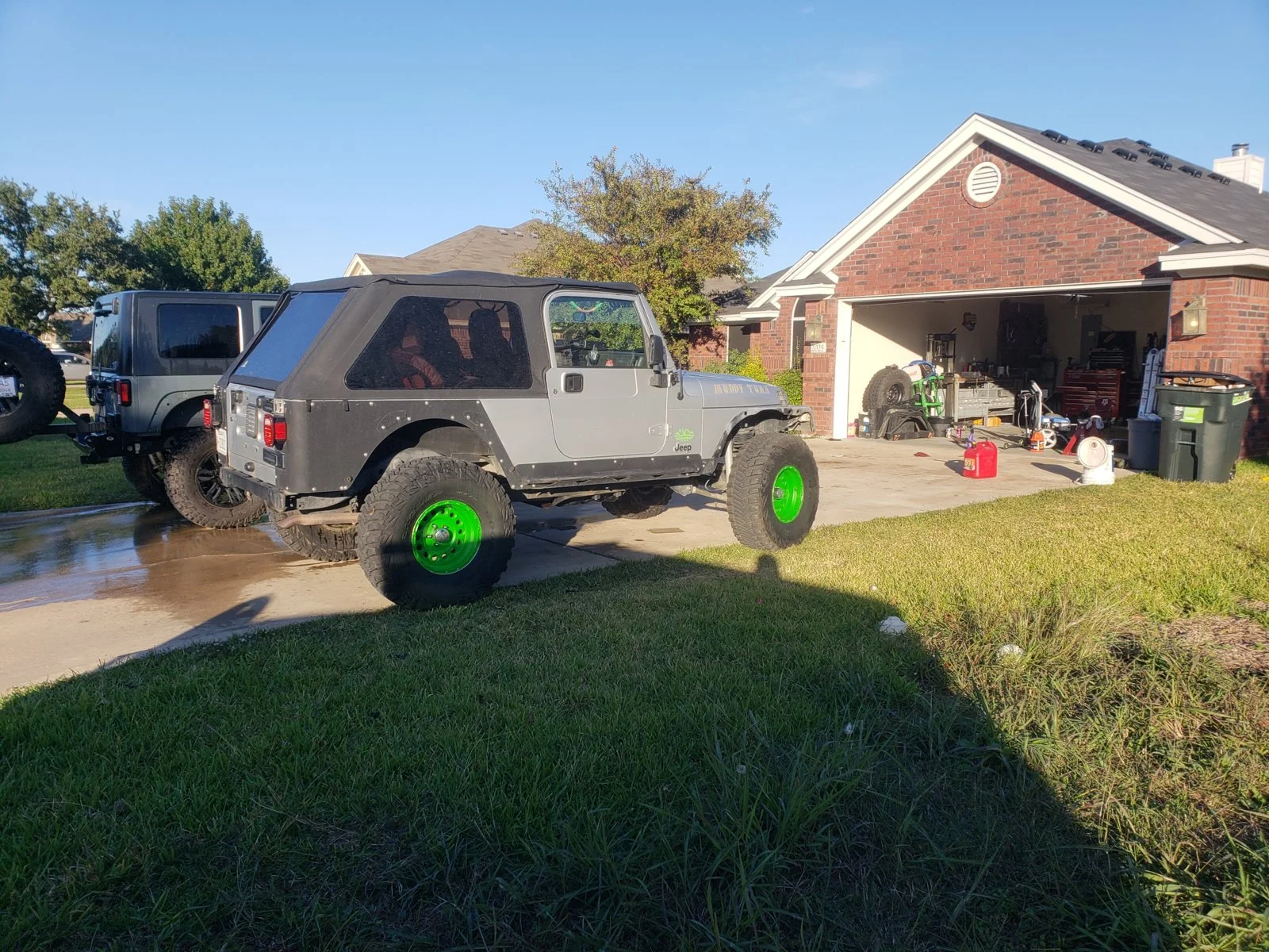

A bit of an update on the build.......
Gears are installed (5:13)
SYE and new drive shaft installed
Metalcloak 3.5” suspension lift installed
Oil pan skid plate installed
MetalCloak front and rear fenders installed
Transmission changed
New diff covers installed
Cooper 35 mud tires installed
Blue Monkey speedo healer installed
Curry tie rod and drag link
OME steering stabilizer
Left to finish:
Install rocker panel guards
Final adjustments for fenders
Still have a small vibration above 60mph. The vibe was terrible without the sye and new drive shaft. After it has calmed down significantly but it’s still there. Any ideas???
Pics will be out by the end of the week.
