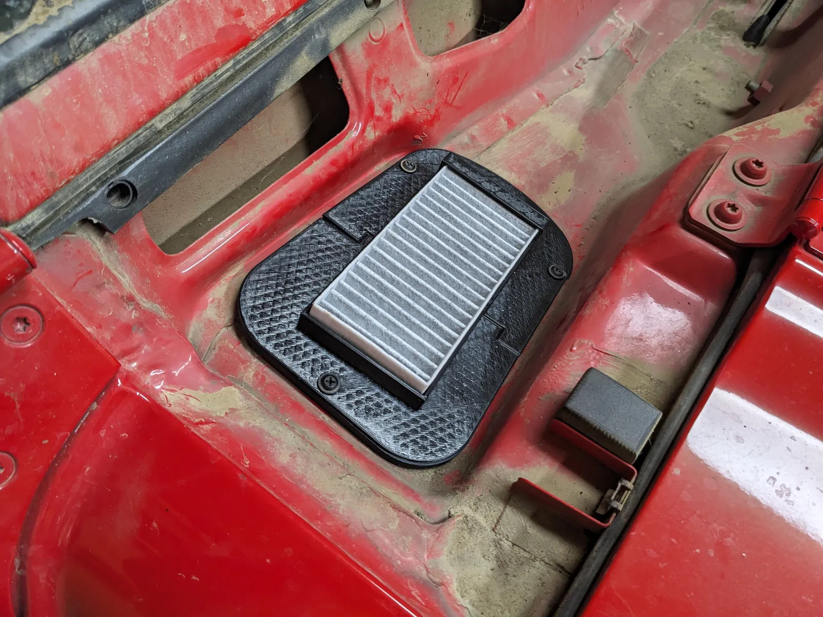

It takes the same cabin filter as a JK. The inventor created the modular version first and the files are free. He has since upgraded to a single piece version which he sells for $40 on eBay. I'm a cheap mofo so, I'll print the free version. But for those that want to buy the single piece the link is below. He also has a water shield for it, but he says it's not really necessary.
https://www.ebay.com/itm/1159138737...pid=5337789113&customid=&toolid=10001&mkevt=1
https://www.ebay.com/itm/1159898397...pid=5337789113&customid=&toolid=10001&mkevt=1
My luck with printing stuff hasn't been great. I can't print it myself so I send it to the local library for pennies per minute. But I can't ask for specific type and everything I have had them do has eventually warped. I'll pay the $49
The library is going to do it as cheap as possible so they're using PLA filament. PLA sucks outdoors. It's brittle and prone to warping in the heat.
Reactions: MikekiM
I've had a winch solenoid mount I designed and printed in PETG under the hood of my F150 for probably 5 years/40,000 miles. Printed with regular infill (30%?). No issues.
You can also get PETG with self extinguishing additives to help with fire prevention. It's a little harder to print but removes a fire fuel source.

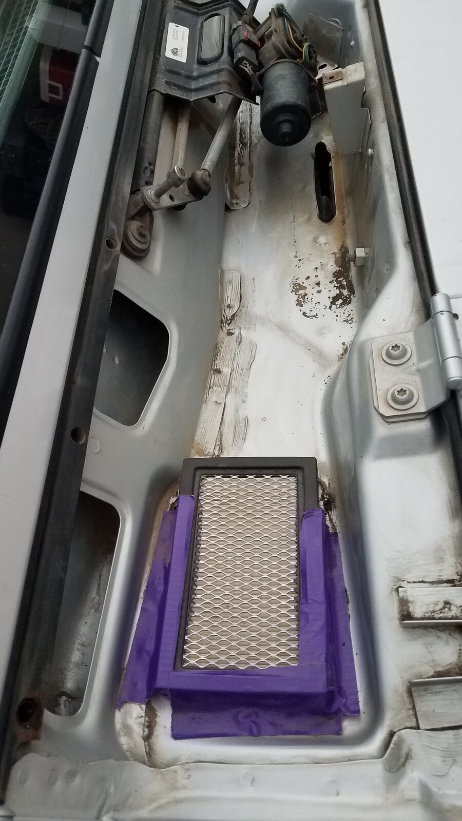

Well, there is another way...

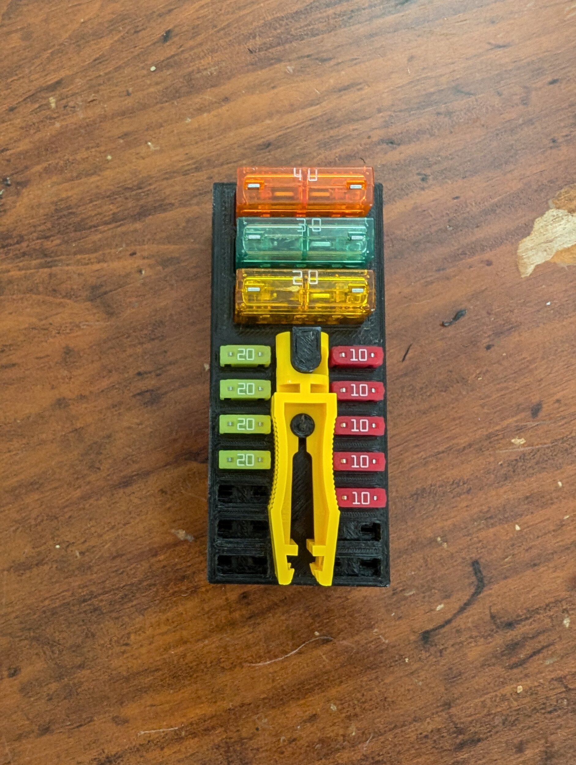

Just bought a 98 Sport and it blew the cigarette lighter fuse. At that point I learned that Chrysler didn't bother to put a spot near the fuse box to hold spares nor a puller. So I designed this up over the weekend for the Eaton/Bussman fuses and puller sold at AutoZone. Still need to tweak the size of the holes for the mini fuse blades but they hold pretty good.
Either going to toss it in the glove box, or if there's room, just double side tape it to the firewall next to the fuse box. Not sure just yet.

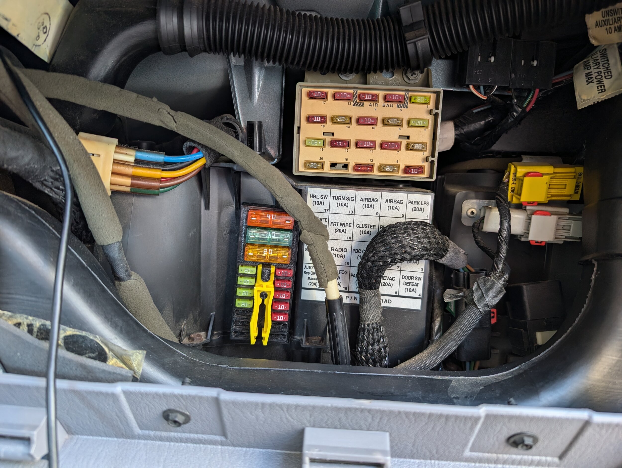

Update on my spare fuse holder. Today I had a chance to go and try to fit it in the Jeep, and by some stroke of luck, it pretty much fits like a glove behind the glove box right next to the fuse box!
The surface I stuck it on is a bit curved, so time will tell if it holds, but initial results are promising.

Now you got my gears turning…. You able to share the STL? I might be able to use my phone to scan that area and tweak it to conform to the section better.

Ha, I drew this up b/c I didn't have a tin big enough to hold the max fuses for under the hood too.
I'll do you one better, here's the FreeCAD design along with the STL (in a zip to make the forum soffware happy). All the dimensions are pretty much in the spreadsheet in the design. You may have to tweak the dimensions for the slots for the fuse blades/bodies b/c my printer is cheap and the tolerances aren't all that awesome.
I printed it with 20% infill using the cubic pattern, except the pins that hold the puller. For those I configured my slicer to make them all "walls", and also a bit down into the base for extra support.
Here's the puller - https://www.autozone.com/electrical...ler/32407_0_0?searchText=fuse+puller+bussmann
The fuses are also bussmann fuses from AutoZone..
Also, if you could explain to me how you scan stuff with your phone like that and get it to conform that would be amazing, because I am a noob at this and only really know how to draw up basic shapes.
Lastly, if you start selling this, I want a cut lol.

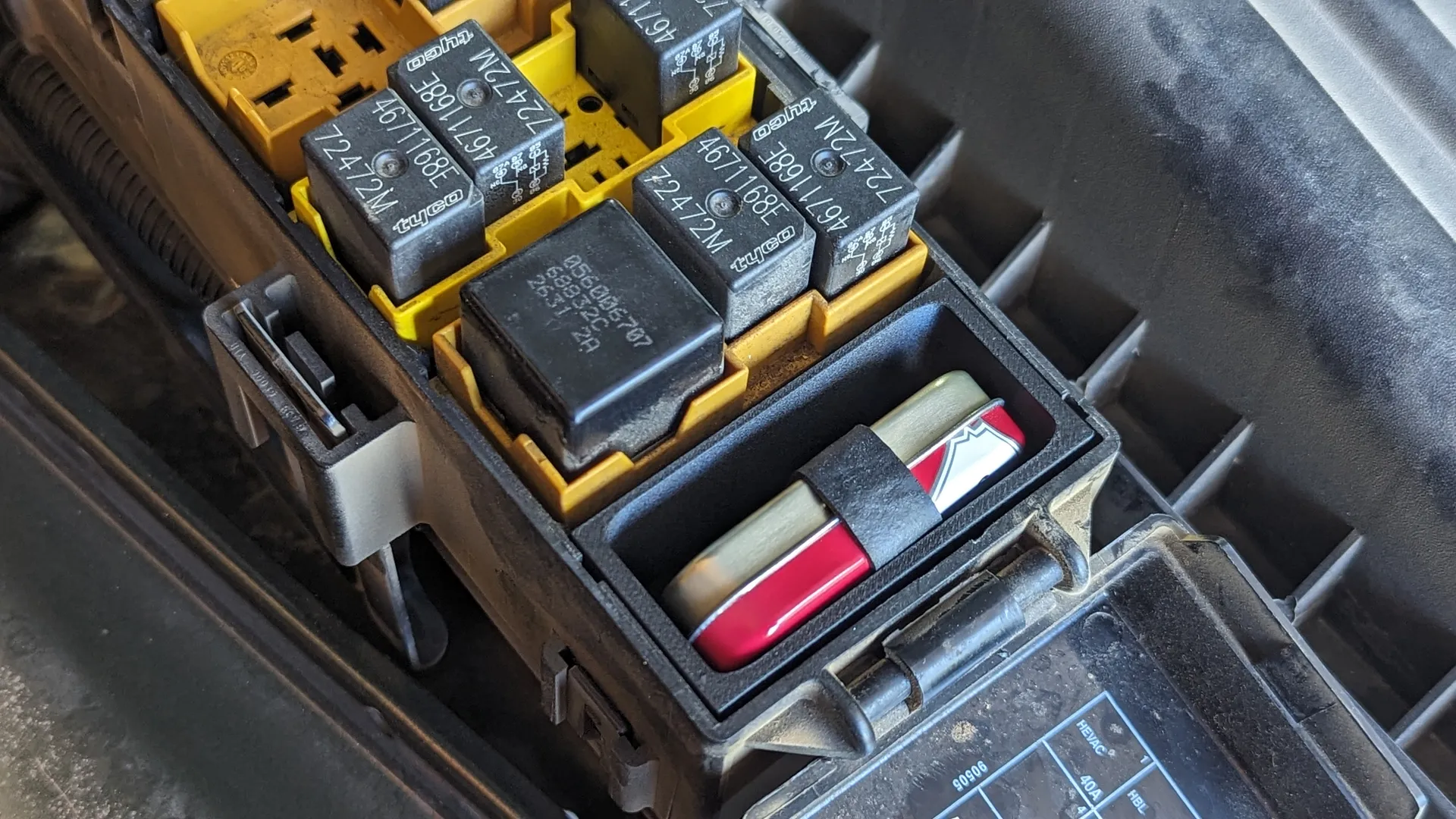

An alternative is the this small box with lid that fits in the PDC.
https://www.printables.com/model/530385-jeep-tj-spare-fuse-bin-for-under-hood-fuse-box
