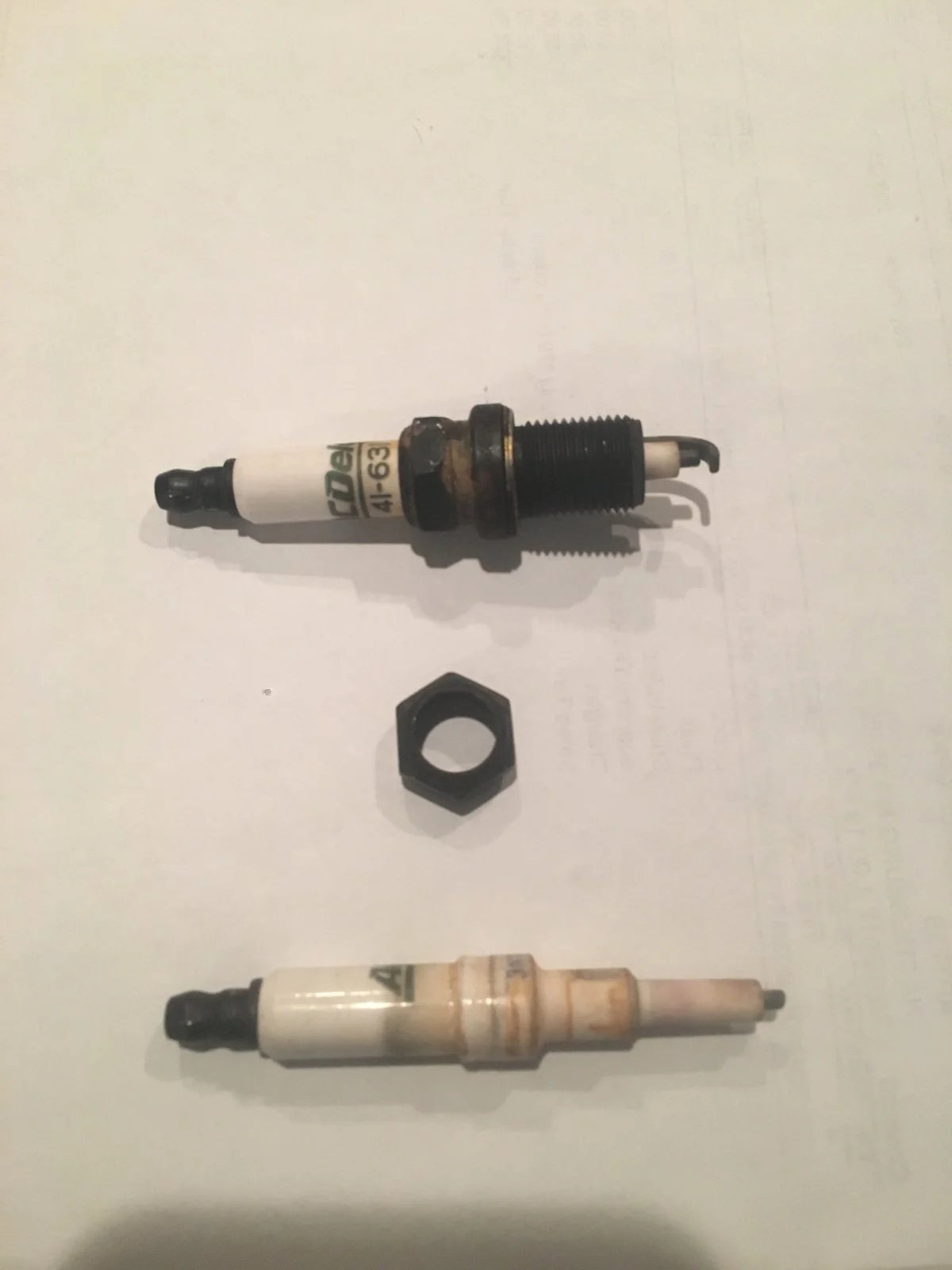

Here's an example of why you should use anti-seize on everything. The threads of the #4 plug broke off clean with the engine. Luckily, the ceramic came out in one piece and didn't drop into the cylinder.
That's not good! Were you able to get the treaded part out of the head?
It did come out eventually. Unfortunately, I had to take it to a shop because it was over my head at that point because I was working in the parking lot of my apartment. But luckily the head didn't have to get pulled to remove it.
Yikes. Have never seen a plug do that before.
Yeah, I thought changing the plugs, wires, cap, and rotor would be a nice little distraction from school for a minute. Had a huge test (4 actually) on Monday and decided to get a little down time and do some maintenance. #3 plug came out nice and easy. Got onto the #4 plug and when it broke lose, something just didn't feel right about it. Once I saw what happened, I lost my temper a bit and introduced my neighbors to some very colorful language. Luckily, she's ok.
I did have the shop go ahead and change our the rest of the ignition system. Since I had already bought the parts, I figured any other major problems could be someone else issue at that point.
I'll never forget the time I bought a car with a stripped spark plug hole. Spark plug popped out of the cylinder head while driving.
Luckily I was able to get crafty and install a hili-coil in the damage hole, while the cylinder head was still on the vehicle! I used a high powered vacuum to vacuum all the metal shavings out of the cylinder.
That's insane... I imagine that thing came out of that cylinder like a damn bullet.
Surprisingly it didn't put a dent in the hood. But I remember driving down the highway and all of a sudden it was like it was misfiring every which way. Pulled over, opened the hood, and there's the spark plug, attached to the wire, blown out of it's hole!
Some asshole who owned the vehicle before me was obviously either cross threading the spark plugs, or they were torquing them down beyond hand tight.
I bet that was quite the surprise!
