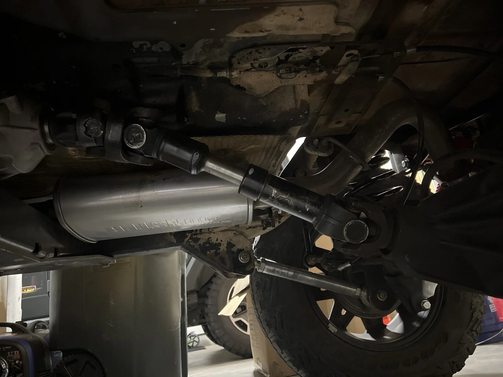

Figured this is as good a place as any to ask; how does the SSSYE vs SYE equation work with an LJ?
I'm in the process of deciding what to get for my 06 LJ (Dana 44 rear axle);
Currently installed/installing:
Savvy/Currie 4" short arm suspension lift kit
1.25" body lift
1" motor mount lift
UCF Ultra High Clearance Skid (~3.5" Transfer Case Lift)
My rough math says my driveline is seeing ~6-7" of lift with all of the above; but I dont know how the added LJ driveshaft length plays into the need to shave another 3-4" off. Should I go ahead and just bite the bullet and do the super short JB SYE and be done with it? Or am I wasting money that could be spent elsewhere?
Thanks in advance!!!
