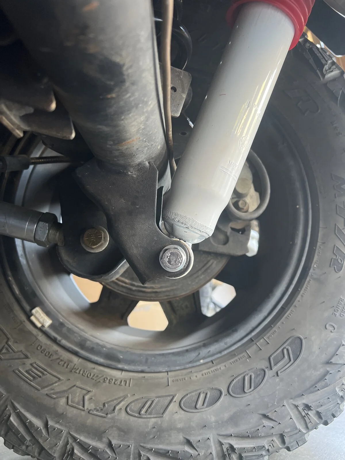

I think the biggest downside is the additional leverage whatever obstacle you smash into has on the mounts, bending the factory bracket. I forgot about this option, flip the shocks upside down. Free 99
Just cut the lower spring seat for free.
I'd trim the perch more. The brackets change travel and hang lower. They should be a temporary solution at best.
A supershort would get your driveline almost close to where it needs to be it looks like and you may not even need a new driveshaft depending on how much slip it has. You'll also need something to correct the speedometer, which I am not sure what is the go-to anymore but my bluemonkey version has been easy to use.
Those look the same as I installed 21+ years ago, only to remove them within a month or two because they kept getting hung up on the trail because they hang lower than the OE brackets.
Personally I'll be buying a shock that I can flip or trim the perch or a combination.
spring perches are cut. this winter the shock mount will have to be removed and relocated.
Reactions: SkylinesSuck
Is that at full droop?
Mine gets really close to my brake line.
that’s sitting flat on the floor.
