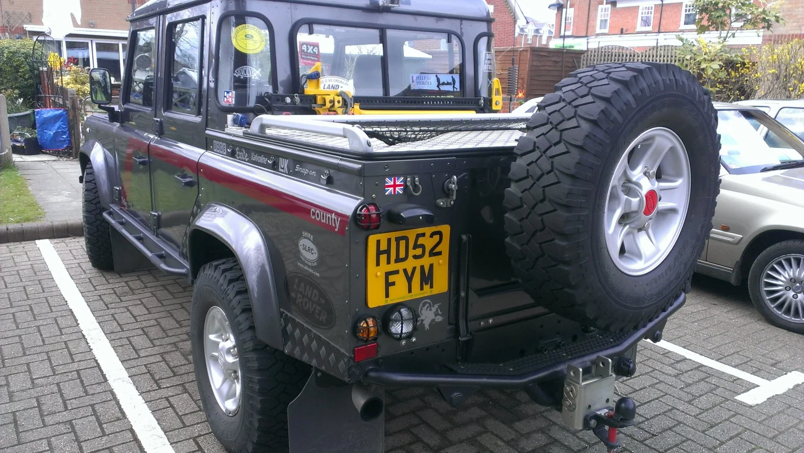

Looks to me like if you have to fit a swing out spare wheel carrier to use a drop down tailgate, you have cured the main problem with the standard gate and if you fit a simple drop down table on that you have a win win situation. I have run many Land Rovers with drop down tailgates and can only say that if you need to reach anything in the load bed, you have to climb on to it.
